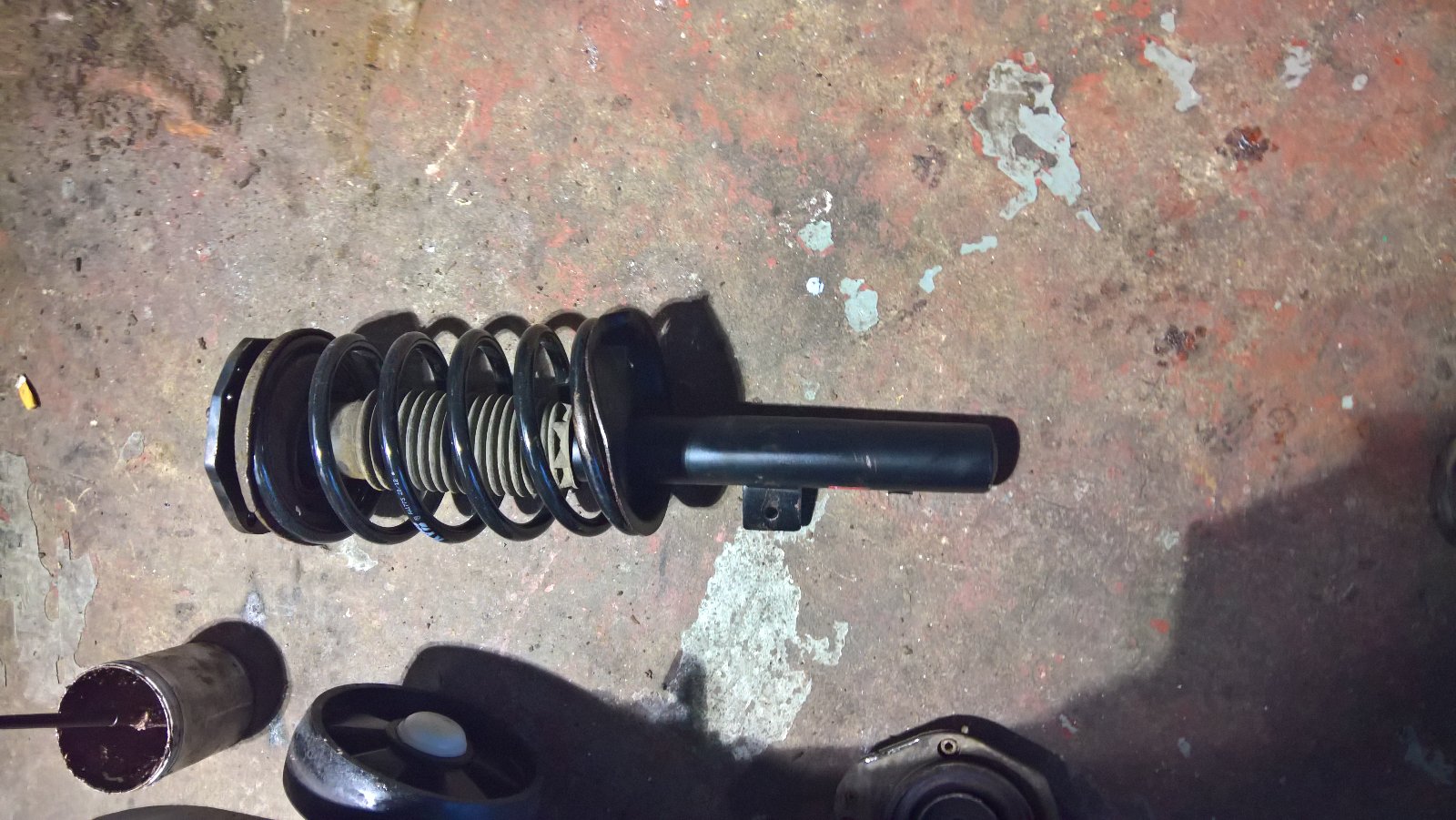

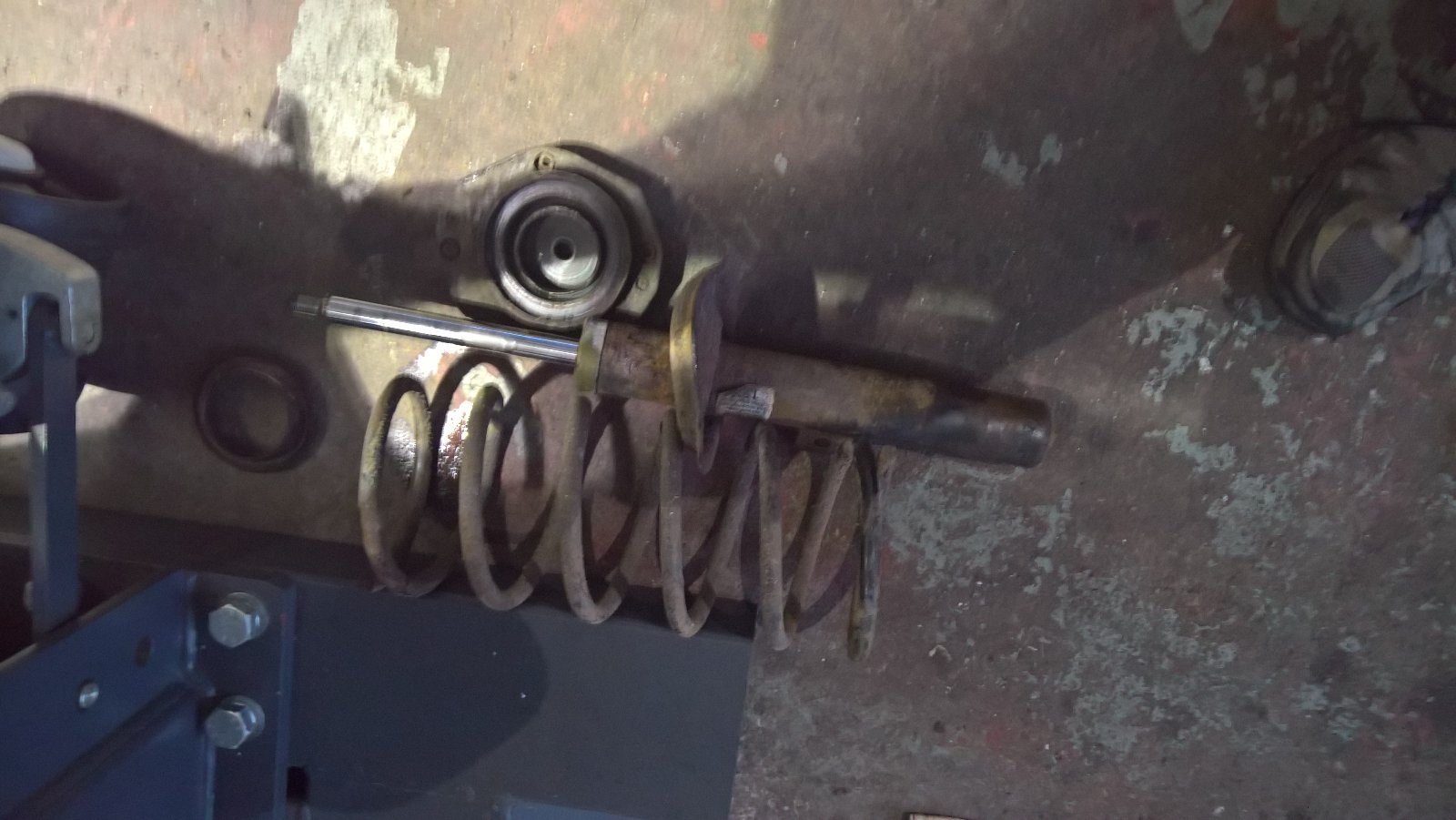

Today’s progress. We managed about 4 hours in total due to other commitments. Driveshafts back in the hubs (which I thought strange as we still had the front suspension to change, it made sense later). I removed callipers, drop links etc. and we then got the N/S strut out without drama. Although we had a new strut, spring, top bearing and a bag of bolts we needed the top plate off the old strut. Assembled new strut and it went back in OK. Callipers and pads re-attached (Quick aside; I always put a bit of copper slip on the back of the pads. The mechanic only made happy noises when I had put a lot more on than I usually do. A lot, lot more).
The other side put up a fight. The bolt that slackens the bottom of the strut (Not a pinch bolt but it clamps the bottom of the shocker if that makes sense) slackened off OK, and the strut came out but we needed the bolt out as the N/S side bolt and nut needed changed and from what we could see this one was worse. Gentle persy-watsit with a bit of heat and a hammer didn't help so it ended up having to be torched until it was glowing red hot (metal sheets held in the right place to protect the hub CV boots etc.) before it was shown a bigger hammer and eventually gave up.
Then, as with the other side reassembly was the reverse of taking it to bits.
Other than suspension, we ran the car for 15 minutes with the engine oil flush in, then dropped it and refilled with the usual oil plus a bit of slick-50 added. I think it's a discussion for another day but it was suggested to me that 5000 mile oil changes are the way forward, with added treatment every other change. In the past I've just changed the oil once a year in summer at around the time the MOT is due which works out at 9000 miles for my commute.
Tomorrow's job will include setting the tracking roughly (It will go for 4 wheel alignment after we swap the back axle) and turn it round to start on the rear end.
All the parts are now in place to complete the job, 4 axle mounts arrived today. Had a bit look over the back end in preparation and we might have some more plumbing to do (brake pipes). I also got on ebay and by the end of the week should also have a new under-tray and some more (third time changing them), crappy upper engine cover posts and useless clips to put the top cover back on.
Right, I'm going to try to upload photos. Pretty boring unless you have never seen a suspension strut before.
Before: After:
Before: After:

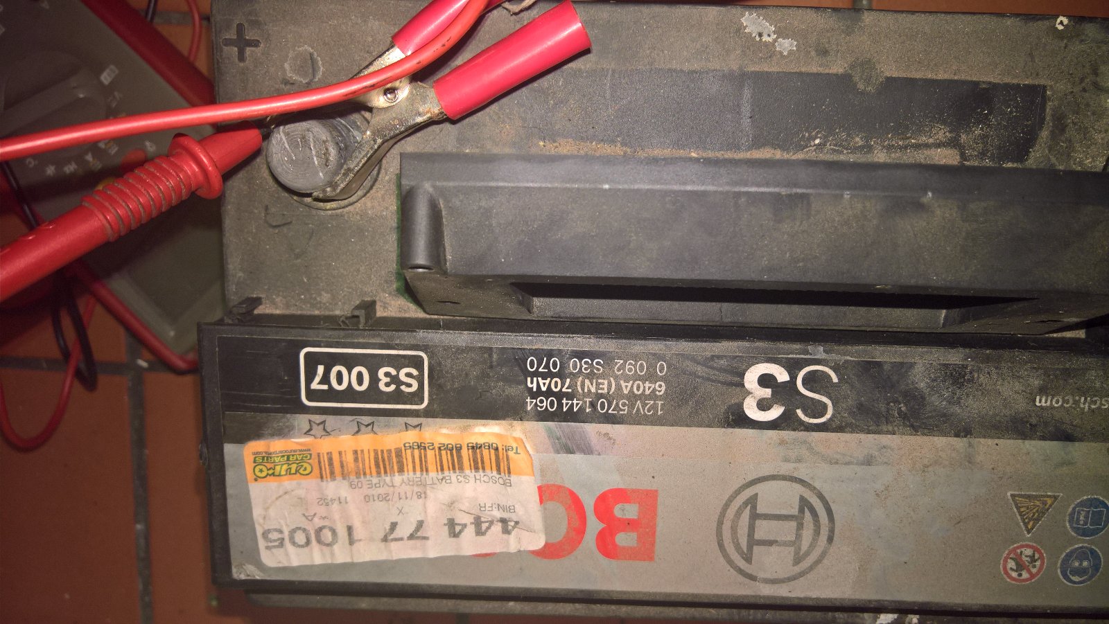

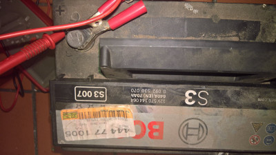

Anyway, back to the car. It wouldn't start this morning. Turning over too slow. Glow plugs have never been changed and I couldn't remember how old the battery was but I was sure I'd changed it at least once. I remember paying more than the cheapest at ECP for a Bosch. As far as I can tell the date code is August 2010, so it's done OK. Local Mechanic had a booster pack which started it no problem, and I've got the battery on trickle charge so I can get to work tomorrow, and pick up a new battery on the way home.
So I'm fine and my Car's fine. I know this is a car forum, but seriously blokes, if you think somethings wrong 'down there' get it checked. In hindsight, I was forced into it, and I might be the sort of person who never goes to the doctors. It was nothing more than 'slightly uncomfortable' during examinations. Waiting for their the results is worrying but blocking it out of your mind could be worse.
Sorry, this is a car blog. Battery photo attached
