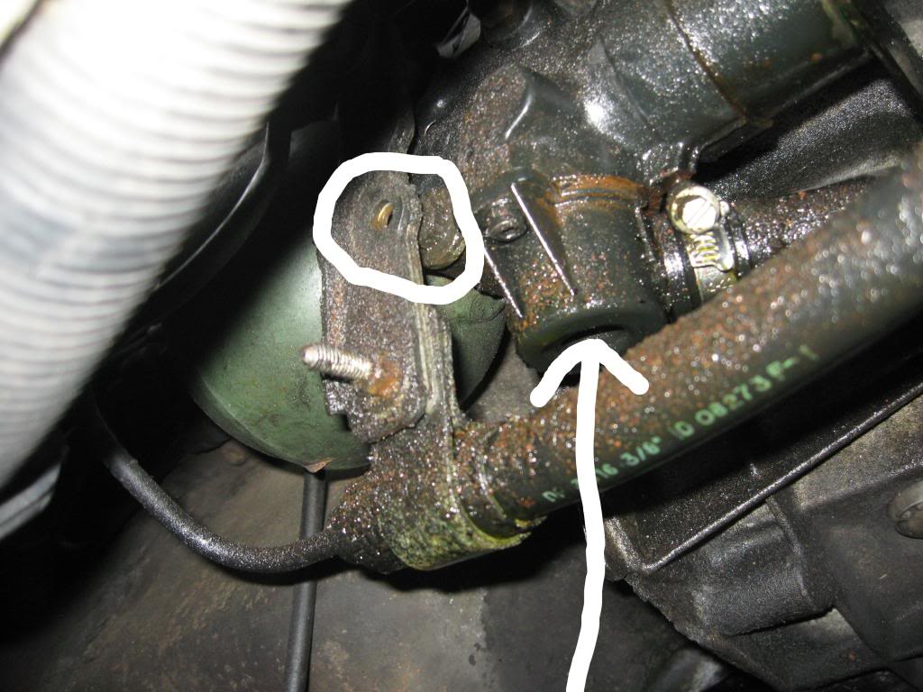

right think i got it fixed....all on my own last saturday- friend busy organising stuff and mechanics gone to bordeaux...so no spare. So far its working fine. But i still want to get it checked just to make sure.
If you have the same problem then heres an idiot's guide to fixing it without removing the part.
Anyway to fix the filter house seal leak thingy, you will need;
-An old sock (with no holes in the toes)
-lighter fluid
-evo stick Super Fix Versatile Hit tech putty- in six pieces (available from homebase under 'Glues')
-lighter fluid (can form, from supermarkets, newsagents etc)
-Possibly someone left handed
Right then clearly make sure you've got the above before you begin work and remember the car will be unroadworthy for a while so make sure its parked in such a way as will require no movement during the work/drying time.
First carefully move the fuel pipe slightly to the left away from the filter housing making sure it doesn't scrape on anything (the pipe may pop out of the plastic clip dont worry about that).
Second put the sock on your hand (left works best). After completing the obligatory sock puppet routine ( :-D what av we got here then a leak, dr sock will soon have you fixed etc), use the sock to clear deisel and oil from both the seal area (i.e within the hole around the white circular thing) and around the filter housing itself- at least the part facing the engine block, especially the nozzle. Repeat this step with a clean bit of sock and some lighter fluid. Repeat this step again with a clean bit of sock- lighter fluid may itself leave a thin film of oil. The area should now be totally clean which of course it needs to be to allow the putty to stick and create an air tight seal.
Third take a piece of putty out of the packet and begin to knead it to mix the hardener in. Bear in mind you ideally need it to retain a roughly circular shape bigger than the appature as ideally you need a flange to fix to the housing side wall. Fit putty by applying pressure to the centre of the putty centre to fix it to the white plastic of the thermostat heater thingy. Then of course make it air tight by crimping it down to the outside of the filter housing wall itself. i'll try to uplaod a photo later.
Four ignore the 10 minute claims. Firstly you are out doors in colder temperatures and it will be under pressure. And do you really want to risk it? Hour later itll be dry. Ideally at this point you should pime the system again as theyll still be some air left in (between your new putty seal and the old seal). Then itll start fine. Alternatively if you havent considered ( :oops: ) the air still trapped in the system dont worry about it as old xud will take care of that..within no time your xantia will be starting again just like it did when it had 33k on the clock.
Cost £5.00 for the putty and £1 ommat for lighter fluid if you have none in so total cost <£7.
Time: <10 mins + drying time.

Now as some of you may remember this is a sinker xantia L reg/1994. So it should have an FDV?
-i cant really see the FDV and i cant make heads or tails from the pump over the number/type of pipe weather its meant to have one??
-The pressure regulator seems to be leaking from directly underneath. I think as i havent been able to look whilst runing. also the LHM thats leaking out appears to be almost fresh/new rather than old lhm from bottom of the tank/the system.anyway ive taken some photos.
Ive circled something on the photo as im not sure its correct. The arrow indicates where i think the leak is coming from...
The rest of the photos (inc showing the pump pipes are here: ) http://s738.photobucket.com/user/Citroe ... 20problems" onclick="window.open(this.href);return false;
-also on the steering issue. At the mo i cant see anything wrong with the steering but i do remember recently it making a funny hissing noise if i went over a quarter turn on the steering? Coincidence or noteworthy as its never done it before. Im unable to find out from either manuals information about the ram on the steering rack? (could this be the cause of the funny noise and possibly small leak?). Is there a link/thread on here??
Anyway heres some photos on the links always grateful for any comments. At the mo ill have to be quick as internets playing up.

Phill
the FDV on a sinker XANT is exactly the same place as on a BX, immediately above the regulator,
Regards, malcolm.
