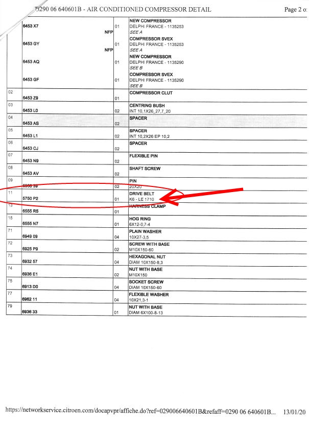

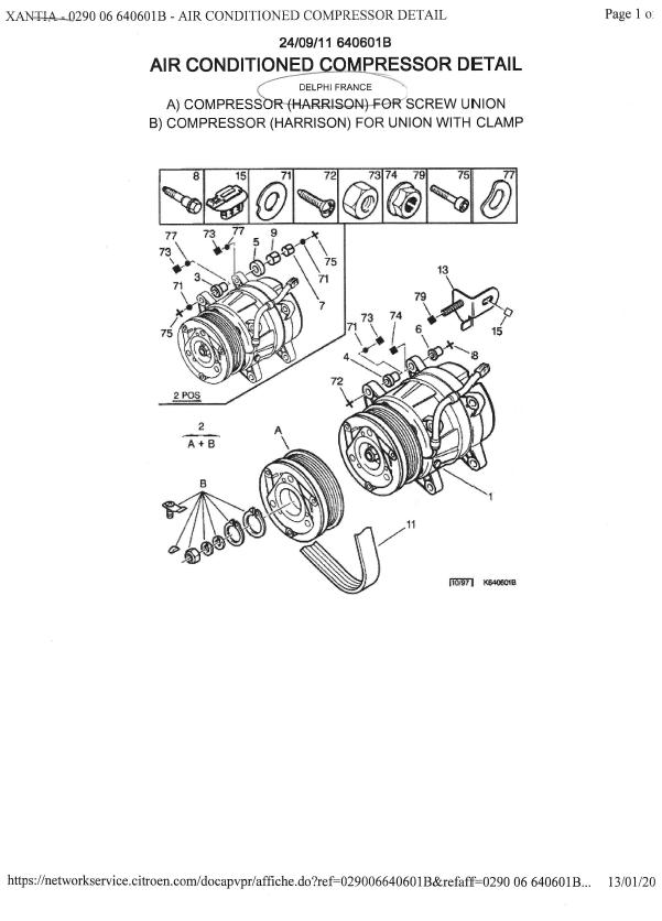

Uh.
Saying the car has air con with a delphi harrison compressor:
Citroen say the Drive belt is 1710mm long and Unipart are saying it's 1738mm long?
Both say there is only one choice of belt with the delphi harrison compressor.

KennyW wrote:Romie,
It is the 1738 belt for a Delphi pump.
Kenny
aaaaaarrrrrrrrsssssseeeeeeeeXac wrote:Whereas I normally fit a 1725
I mean, really??!!
This is what I got from Citroen.
Dunno, what to go for now?

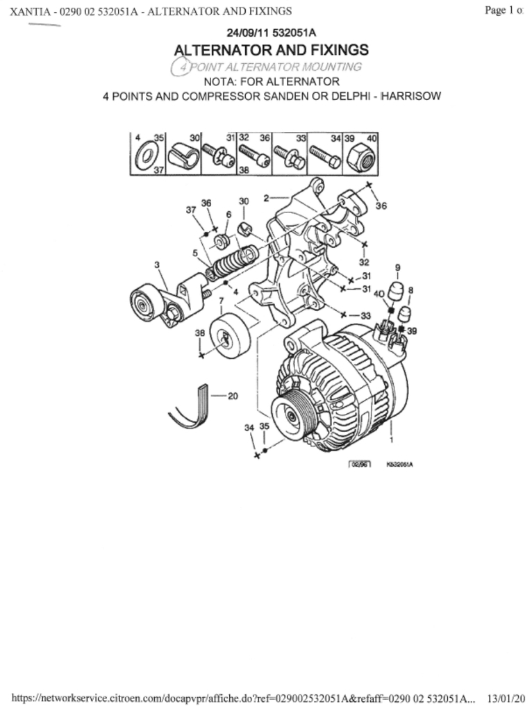

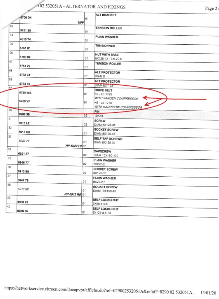

Right, this is to do with **** ANOTHER ***** option
and whether the alternator has 3 or 4 point fixings it looks like. See below:
I need to figure out how many points my alternator has.
It's a VALEO CL8 2541738C A13VI85
I'm going to try and find some pictures of new ones to work it out...

The 3 point alternator has options:
1700 with Sanden
1710 with Harrissow (their spelling)
1700 with Sanden

Romie,
What number of Delphi pump do you have 1135290 or 1135243. I think each compressor pump had different alternators fitted which affects the size of belt.
My old 1.9 TD was 1135290 comp and belt size 1738 with 4 point alt
Kenny
Kenny
