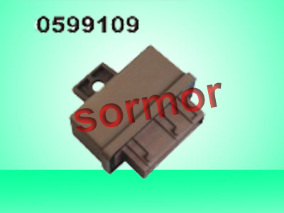

wheeler
Posts: 7927
Joined: 21 Sep 2002, 19:07
x 1056
Unread post by wheeler »
Should look like this, as addo says it may be black also, they should interchange no problem as long as they are both the same colour.
I believe is in the same box where the ECU lives on a xantia.

There's a large sliding red clip that pulls sideways off the multiplug unclipping
the relay from the loom and IIRC on the Activa the relay is brown - I've been
messing with a V6 Xant lately which has two - the lug shown in wheeler's pic
slides into a slot moulded in the ECU box.

Thanks guys, there's a black box headed 'bitron' on a bracket in the ecu box, this it? All I've got in there are a couple of ecus, small white filter looking thing and this black gizmo seated on its own bracket. Yup, I'll leave the passenger airbag alone, cheers!

superloopy1 wrote:Thanks guys, there's a black box headed 'bitron' on a bracket in the ecu box, this it?
That sounds like it, it should have 15 pins on it. does it look the same as the pic apart from the colour ?
