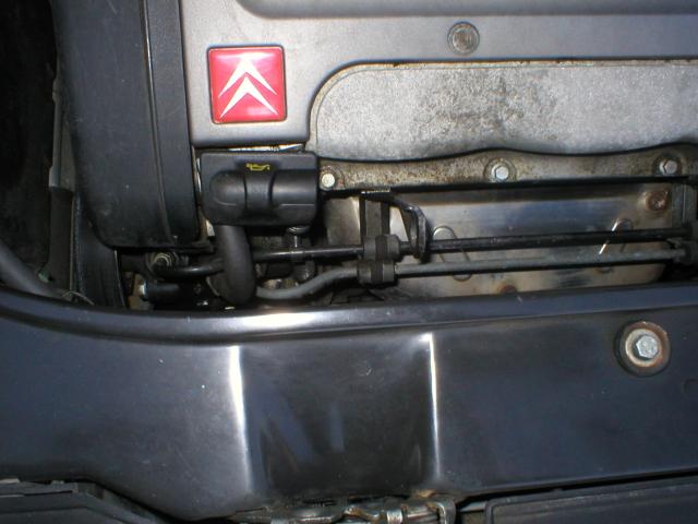

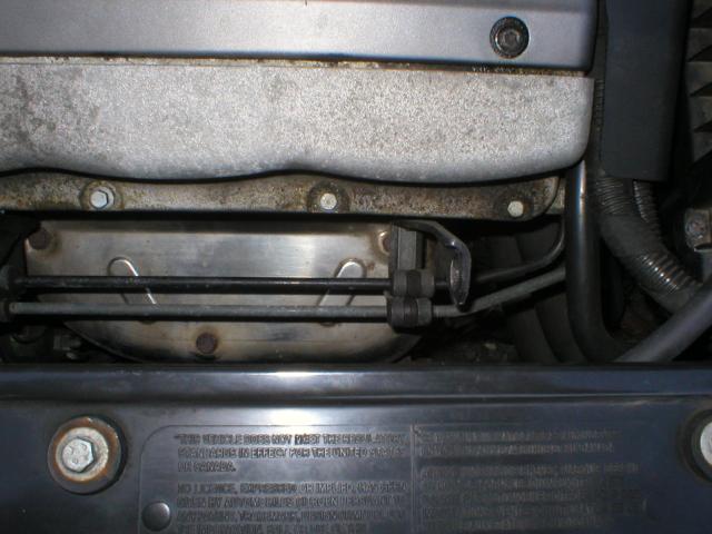

Here's some photos showing the pipe correctly clipped up. The first is the one on the corner of the front bank:
This next one is the clip that would attach to the "L" bracket above the pressure regulator body. This and the photo above were taken on a spare angine and the pressure regulator had been removed. Comparing it with your photo of the preeeure regulator top, you can see where it goes. It's help with a nut and bolt to the aforementioned "L" bracket.

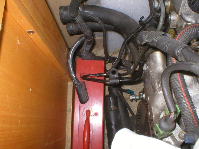

The next two pictures show the clipping route across the front bank of the engine from the pump.
Note how both the regulator supply pipe (black) and the PAS supply pipe are clipped independently but share the same hexagonal standoff mounting on the tops of the lifting eyes.
The "P" clips are available from your dealer as Part No. 1568 80 and are simply described as "Clips".
They're the same on all Xantias and can be rescued from a scrap vehicle no problem at all. The internal rubber cushion in them is critical.
Do you have the hexagonal standoffs on the lifting eyes? I ask as I've see them broken off before now; my spare engine being a case in point...

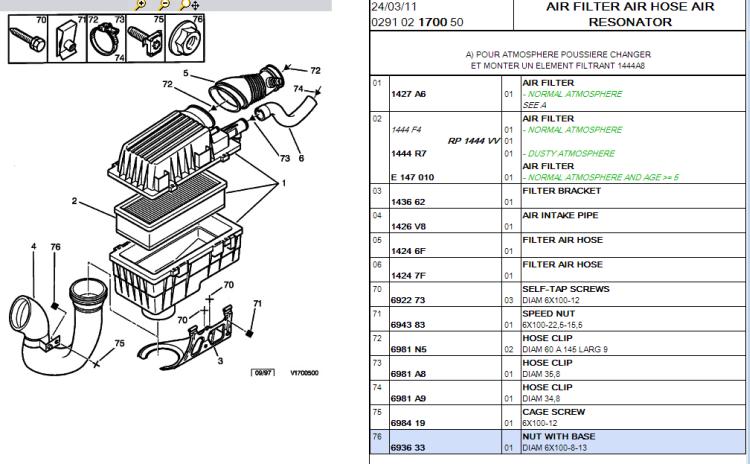

Dave,
On an earlier subject concerning your airbox...
This may be useful:
Posts: 55093
x 8394
gadgetgricey wrote: Think I'll speak to Citroën and order the conical sphere, just to make sure.
Good idea Dave. The pert number is 5280 K5 described as a Seal, 6.35mm
I thought you might get to enjoy the car, they are a bit good :D :D :D :D

Then had a look at the airbox - Now getting really confused.
Diagram on Citroen website has a large pipe exiting from the bottom of the airbox. Cannot see any pipework that this is to be connected to???
All I seem to have "spare" are three pipes on the top, and two electrical connections.
Second Question:
There are no pipes or anything visible (that I can see) underneath. Is this just the air intake point. Is the pipe needed?
What's pipe number 1 for, and the two electrical connectors. (E1 & E2)

grey connector E1 is the air temp sensor for on the air box, the other connector E2 didn't connect to anything.
1. is the breather that connects to the pipe that connects throttle body to airbox
There should be a pipe that goes from airbox down and to the front toward the radiator, took it out when this problem happened and don't remember what happened to it now.
