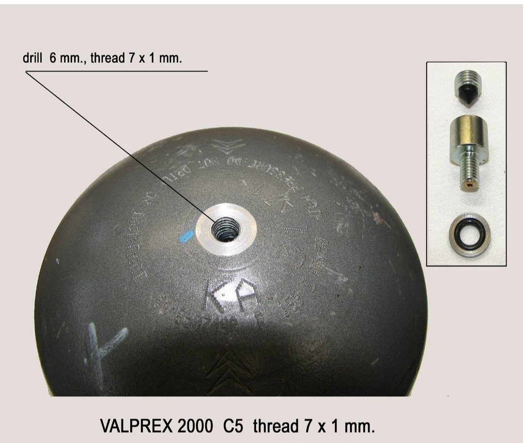

- After A Youtube troll, I watched the a Guy, modify a C5 Sphere on his lathe
[media]https://youtube.com/clip/UgkxZStMQmVGHe ... zHTZychges[/media]
- The lathe is one way, but I think a Bench of Pillar drill with a suitable Spotface cutter, before the tapping dill will work, as you only need a flat surface square to the hole for the vale to seat.

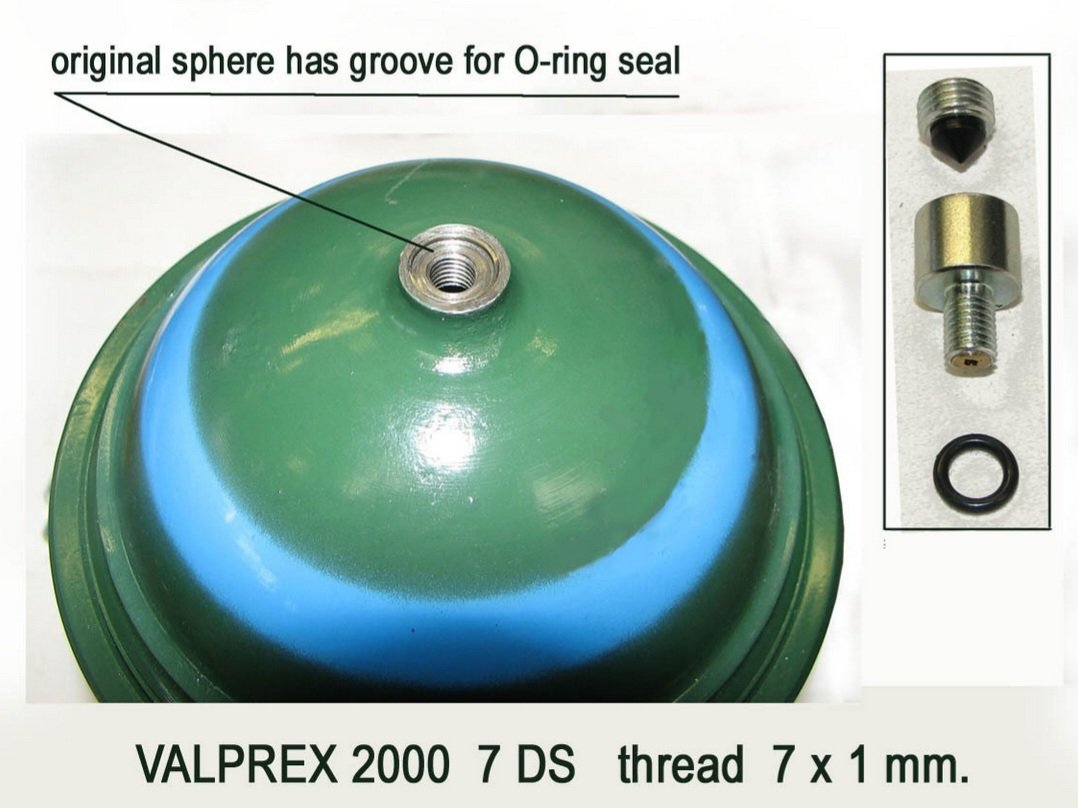

- I have found the Tecnosir website and the valves I will need (Valprex 2000-7C5), problem is I will need two sets as the X7 has 7 Spheres, unless I can get them to send just the 7
I don't expect my car to be around in another 10 years, so its likely that I will have to regass the spheres twice at most. I'm not comfortable on spending £200 on the tool I'm only going to use once or twice. As well as having a bottle of nitrogen sitting around that would be over 3/4 full!
If my local guy cannot help, can someone else help, either by using their own kit or point me in a direction of someone who can.
The modifying of the sphere is not much of a problem, I could do that, its the actual regassing that may is my main concern.
Also, I will need to make a fixture to support the sphere, I have an idea how and it would be handy to have it before I start the job. What size hole will I need to locate (snugly) thread on a sphere?

If your local guy has the official Citroen setup then he should also have the correct valves as Valprex will not work. Citroen had their own valve.
No idea how putting spheres on a lathe. I’ve no idea what you would need to modify them for. Tecnosir have valves that will fit I’m sure.

The standard X7 spheres do not have a removable valve/end plug so the sphere has to be modified, drilled and tapped, to accept the Tecnosir valve as per photos below. The Tecnosir valve assembly includes the o-ring seal found on the standard sphere.

Really? I’d like to see a photo of that. Tecnosir do vakves for different cars.
