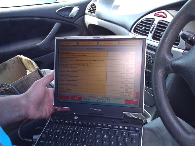

Not much progress to report.
It still takes a while to start first time each day, depending on how long since last use. Often brings on the Antipollution indicator, as it did today. Was rubbish for the first two miles, max 30mph, then as I was passing a "Slow Down" sign it shot up to 70
Been fine since and Aunty Pollution is gone (for a while, at least)
Still haven't fitted the new filter or redirected the air induction hose
There is a definite whistling now that would appear to indicate an air leak.
My excuse is recurrent illness and the sticking brakes that needed first freeing off, then new front pads, then new handbrake cables that took two days and many problems of a public transport nature, then a new offside caliper. All involving large amounts of cash
x2
Seriously considering this but having to use a telephone is proving to be a bit of a barrier. Have a buyer for my current one - my wife's boyfriend who's R19 has been more or less condemned.
- Posts: 28725
- x 5672
Had a fiddle around with it and fitted a new air filter, the old one looked like it belonged to Methusela, only a few months old. MAF was a bit green and corroded too.
Pulled the airbox and cleaned it, hoped to alter the way it dragged the air in but that wasn't a goer. Will have to refit undertray and new wheel arch liner ASAP.
Had to remove the air tube between the intercooler and another widget that I am presuming is the EGR? - throttle butterfly type thingy on top of the engine. Intended taking photo's but forgot - just remembered that bit.
The pipes/tubes were clean, just slightly oily.
After reassembly had a listen for air leaks but couldn't hear anything although it is quite audible under load.

Gave the car an early service, quick and easy, then came the fitting of the new wheel arch liner and undertray. Car has been used by my daughter the last couple of weekends so I haven't had the opportunity before yesterday.
Who'd have thought that that would be such a pain.
The clips I bought didn't work and they only had three in stock anyway.
My nuts'bolts were locked up in my other daughter's house so ended up using some odd PVC door fixings and self tappers, can't see them enduring too long but I need a lot of it off to sort the washer pump anyway.
I have noticed that after a few starts the antipollution fault clears, only to return, usually early morning when starting is slow. If the car is then used for even a few short (5 miles-ish) trips, it clears and the car runs fairly well.
Boost still only from 3,000revs and the car is still hopeless for the first few miles until it warms up a bit.
Be interesting to see if the wheel arch liner has any effect other than keeping water and grit out of the airbox.

Gave in and chucked a new battery in it yesterday, it was taking longer and longer to start despite the weather being significantly warmer.
Except for last Saturday when it started on the button, and Friday night after I had ordered the battery.
New battery on following the prescribed sequence and it started (rather slowly) and all was OK - worryingly so as the only thing it 'forgot' was the date and time, nothing else needed resetting. Maybe the radio but I never use it so don't care about that.
Will be resetting the date and time as soon as the clocks go forward - well, within a month or two anyway
Been out in it today and it does seem slightly better but still gutless until warmed up.
Even washed it. Had it done at work a couple of weeks ago, a 'waterless wash' that left some residue on the screen that made the wipers largely ineffective, car was filthy again by the following morning too.
When hosing it down it was clear that there was a waxy/oily coating particularly on all the glass, pleased that that is now gone - a good dose of Glasg'ae Brandy after the wash.

I had the cambelt replaced when I bought the car as it should have been done but there was an element of doubt.
It had been but badly and was redone with new pulleys, tensioners and water pump.
I think that my problems were initiated by the loss of the wheel arch liner and poisoning of the MAF and it hasn't helped that the second one is probably dished too, although since the battery change there do seem to be gradual incremental improvements.
The Antipollution warning appears to have been dismissed now* and the warmup is a little faster, still a rev restriction to about 3,000 most times until it is warmed up and sometimes long after that but more intermittent.
Turbo seems to operate a bit more as it should but a long way from satisfactory yet.
The car has never really been quite as lively as some I have heard described although that may have been a bit of over-enthusiasm.
Fuel economy is always rather poor in comparison to that recorded by others - 32-35 mpg around town.
Some of this is more than likely attributable to my driving, my daughter does much better when she uses it and she isn't known for dawdling around.
My feeling is that there is a common link to all these disparate symptoms.
*I tried to post this this morning but the forum became inaccessible, naturally the Antipollution sign returned when I had to leave work a while back.
Otherwise there does seem to be a gradual improvement.
There is still an unlocated whistle though that must be responsible for something.

It was working well for a while then for the past ten days the Antipollution fault has been flagged almost continually until today when it has been fine since the first two miles this morning, a bit on the sluggish side then.
Following that it has been as it should and the whistle seems to have disappeared after having been much louder the past couple of days.

Antipollution fault permanently flagged over the past couple of weeks after a few days of relatively good behaviour.
Set off for Wetherby yesterday morning and after warming up for a couple of miles the car behaved fairly well most of the time although it did refuse to go any faster than 70mph on an upgrade.
Was worse on the return journey and would max out at 80mph when it eventually got there.
Same driving down again this morning but thanks to the kind incursion by Paul (citroenxm) it is now much improved.
Still needed a warm up before it would go above 40mph but then returned home at 90+.
His Lexia diagnostic did throw up some areas that need attention.
As expected the MAF is goosed and the turbo pressure sensor appears to be that way too.
Also a very sick #3 injector - sure to be the one with the lift sensor too.
It did show the throttle was stuck - can't imagine where that came from.
Many thanks Paul for taking the time to run the diagnostic.
Injectors are said to cost around £250.
did find some for £89 but this looks like a decent price.

Here's a picture of Dr. Paul attending to the patient...
Luckily perhaps I've captured here the figures for No.3 injector. I don't know but is that really a sign of severe sickness?
It was an excellent rally today at Wetherby but oh, so windy.. The wind and sun has really caught my face...
EDIT: Figures are:
No.1 -0.43
No.2 -0.20
No.3 +0.82
No.4 -0.27
The figures were readable in the full resolution picture but not when resized and compressed...
