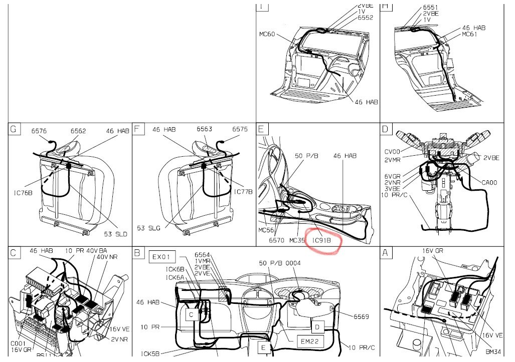

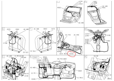

I had a quick look at a wiring diagram & there is also a 4 way blue connector (IC91B in the picture) that the passenger's airbag wiring goes through, It looks like its located under the centre console near where the airbag ECU is located. certainly would be worth a check/clean.

Re: CITROEN C5 AIRBAG FAULT+SERVICE LIGHT HOW DO I GET IT OFF
Wheeler,
thank you so very much for taking the time with this,
I have to report another success for you,
I think it was indeed the IC91B that was causing the problem,
the issue now appears to have cleared and will remain that way, touch wood,
your assistance really is very much appreciated,
right lets move on to the next problem.....
may well be seeing you again on another thread,
cheers my friend
Thats a result, i cant say i have ever had any issues with that connector at all but if you have disturbed it & the fault clears it looks like the culprit. Cleaning the connector may only be a short term solution & the fault may well come back, if this happens I would just chop the connector out & solder the wires direct. If you need to do this make sure you do one wire at a time as the colours can be different on either side of the connector.
