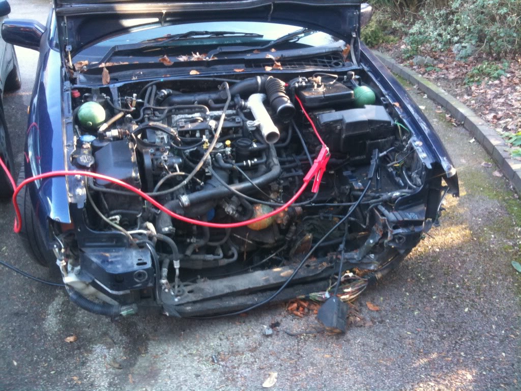

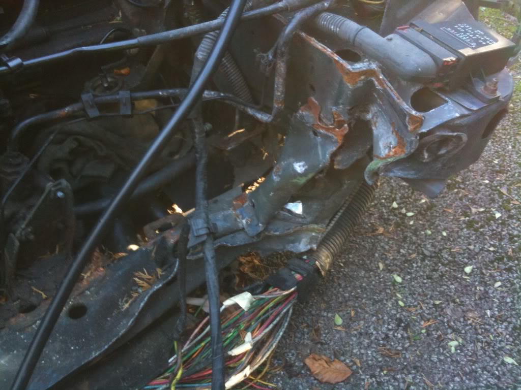

It pains me to say it but I think the Activa is going to have to be scrapped, having had more of look into the damage I think it strays into a multi skinned/layered part of the car, and while it could be repairable I wouldn't know how strong it would be in a crash or how to ensure the area doesn't rust from the inside out. And it looks to be a sod to repair the damage.
Basically there are loads of little things that I think means the shell needs binning. Such a shame as the rest was in great nick. Nothing worth saving will be scrapped so don't worry about that.
As it stands I would like to keep the wheels, possibly the interior, electrovalves and possibly the rams, especially as the front ram cost me £350-400 or something 12 months ago! Also considering keeping the head unit if I can find a way to make S1 switches work with an S2 radio.
The following pictures show the damage. And if you think this is still repairable shout at me and convince me to try and fix it :lol:
Thoughts??

Scrap it before prices fall again. Activas are worthless at the best of times, let alone accident damaged ones.
1990 XM 2.1 Turbo SD
1991 BX 16 TGS Auto
1992 ZX 1.6 Aura Auto
1994 Xantia 2.0 16V VSX
2008 C5 2.7 Exclusive
Deanxm
Posts: 3327
Joined: 18 Dec 2008, 17:57
x 87
Unread post by Deanxm »
Dont listen to him Dommo, too much whiskey has driven him crazy :lol:
On a serious note, yes of course its repairable but how much time and effort do you want to put into it? a vary good Activa may go for maybe £700/£900, most average niggled ones are £500 easy so what do you want to do? a subframe swap would be your best bet if you are not a confident welder and although the damaged bit is only really a brace to stop the front of the car pulling in it would have to be a proper job, no patches or silly stuff.
but this is all unimportant as it will cost damn near what another one would, buy another and have a spare to give you cheap activa motoring iuf you not attached to the car.
Of course if you are after a good project it is certainly achievable.
