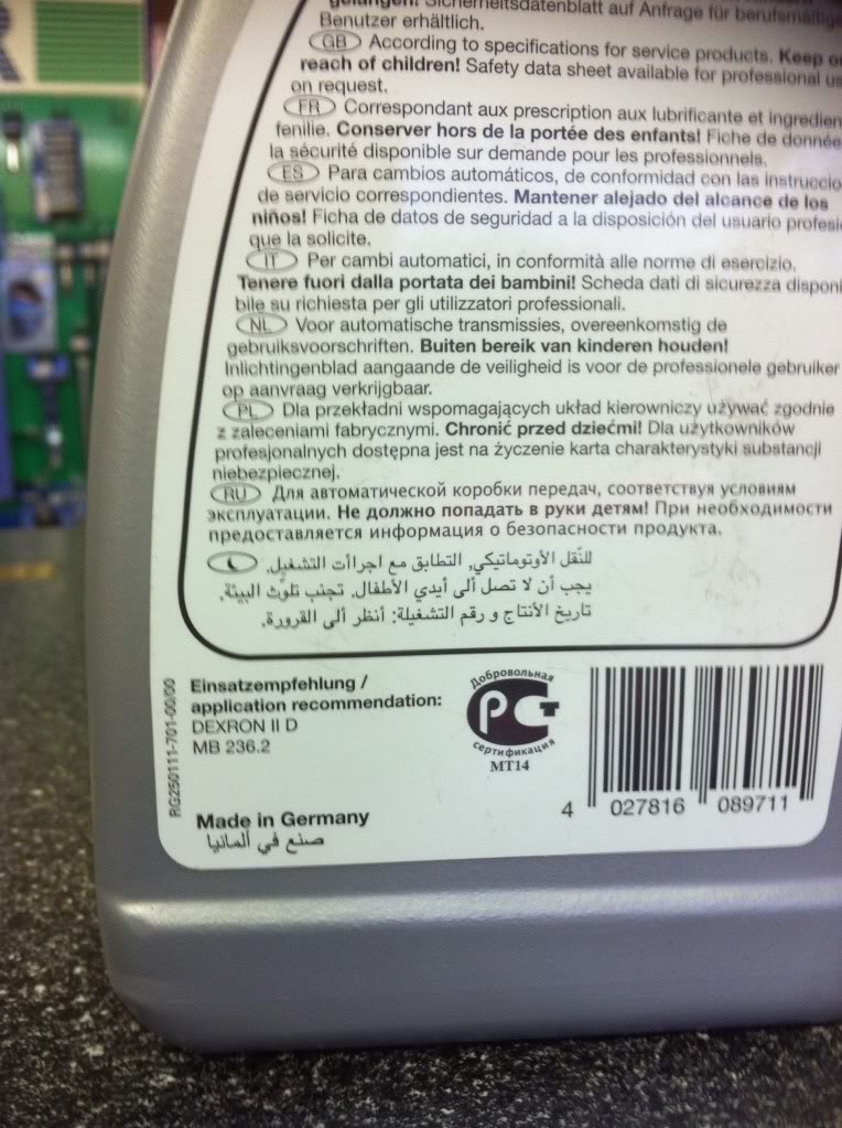

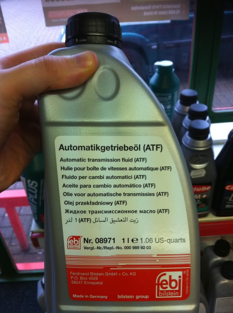

Something very interesting I found out today during a visit to GSF.
This is a bottle of Mercedes ATF, according to the gsf employee recommended for ALL Mercedes automatics even the current ones.
Nothing sounds to strange about that, same thing Honda do ATF-Z1 for all Honda gearboxes... well nothing strange until you look at the back of the bottle..
Yes thats right its Dexron 2D!
More proof that Dexron 2 is not Dexron 3!
I mentioned this to the GSF employee, he was already well aware that Dex 2 & 3 are very different oils. Which is quite refreshing to hear compared to the usual auto parts dealer ignorance.
Just thought y'all might be interested.

It's an amazing can (or bottle) of worms that's bee opened up here
It is most valuable that the truth is revealed!
I think in conclusion, if you have a 4HP20 or an AL4 there remains only one fluid to use and that's genuine Esso (or the Mobil branded) LT71141.
I trust GSF will make some indication that their ATF is not suitable for use in the gearboxes of a lot of late Citroen, Peugeot and Renault cars...
