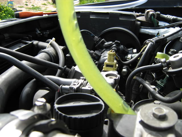

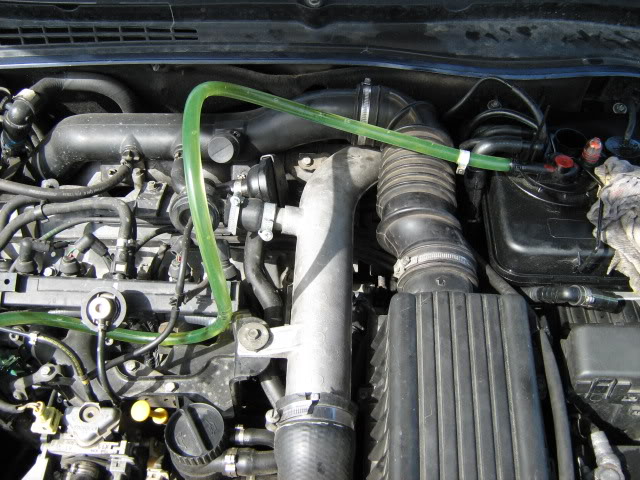

I decided to fit a transparent tube to the pump, and feed the circuit sinking the tube directly in the LHM (I mean Hydraflush). When the car was low and the 12mm bleed screw open (the circuit depressurized) the LHM war clean and without air. When i closed the screw and the car started to rise and the LHM level in the tank started to getting low, the air started to show in the feed hose, as the main return pipe (next to feed pipe returns foamy LHM.
After that i sealed the plastic lid with red silicone and fitted the clear hose to its normal position on the tank, the result was when the engine revs high some big bubbles and millions of tiny ones appears.

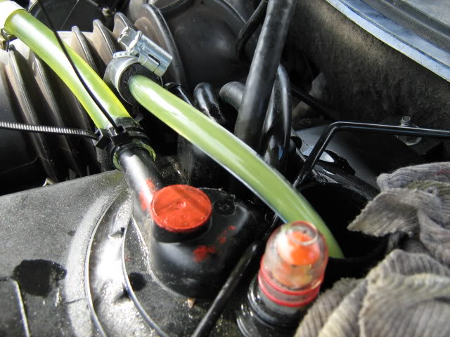

Here is the returns from the brake valve

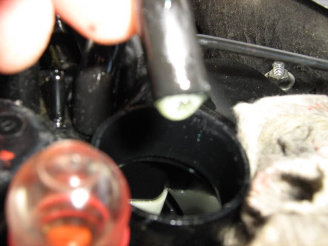

and here is the foamy returns from the main return pipe
When i start steering the steering wheel some huge bubbles appears in that pipe.
So i assume that as the LHM gets in the tank with lot of air that air gets in the feed pipe ant the problem wets worse and worse.
I believe that if somehow i manage to find the air leak and stop it my problem will be solved. I think that the steering ram is the prime suspect here, but i don't know how to check it .
All those photos were taken with the car low and depressurized (I think that with the bleed screw open the only thing that works is the steering ram as the rest of the circuit is disconnected and the LHM returns directly from the pump to Tank through pressure regulator.)

Air in the LHM. Yes, you are right that how you have tested, the air is coming via the steering system.
One potential place is cracks in the return pipe from the steering pinion return valve. In an RHD car, this pipe begins as a metal pipe and a rubber pipe joins it. In fact the opposite end of the pipe you have disconnected showing the air. Often this pipe cracks where it is joined to the metal pipe. I would assume a similar arrangement on an LHD car. That rubber pipe is serious fun to replace. I had to replace it on my V6 and access is rather difficult :twisted: It is nearly hidden but will give the game away by being wet and making the subframe wet.
The steering ram leaks when it fails and is usually obvious.
Less obvious is leaks in the steering pinion valve. This is the assembly attached to the steering rack just below where the steering column joins. It has two seals and can either leak externally by the steering wheel universal joint or internally into the rack itself. This leak can go unnoticed for a while until the rack becomes full of LHM and it leaks through the steering rack gaiters.

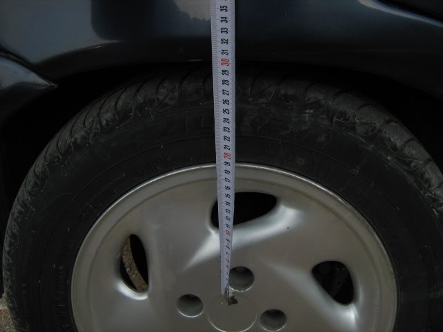

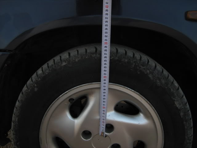

Can any one mesure the distance shown in the following photos for me so i can adjust the front and rear height more easily?
For the front
For the rear
I think that the front is a bit high
Regards
