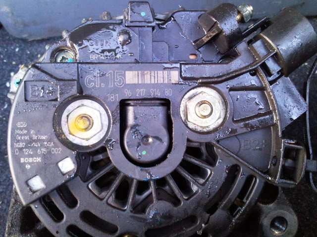

heres a picture of the regulator or what i assume is the regulator and the alternator.
If anyone could shed any light if this can be replaced seperately then that would be great.

It's the top bit on the pic.
This is the one you want :-
http://cgi.ebay.co.uk/NEW-BOSCH-ALTERNA ... 45eb0a1833

Your alternator part no is , 0 124 615 002

ooooh, £39.50 off ebay? Thats steep for half an alternator, maybe you'd be better off getting the whole unit? Just an idea. I thought they were changable, but whether it's worth the hassle is another thing.
It says made in great britain as well, a bosch item made outside of germany, thats gotta be rare right?

Hi Stuart
Thanks for posting those photos of the burnt out wiring.
It looks to be a very interesting example of a blown out battery connector.
The Citroen battery terminal crimps are not the best design and have a habit of going high resistance. Normally this only introduces a bit of voltage drop to cause odd starting and other electric problems. In your case with the serious altenator fault my guess is that it actually turned out to be the highest resistance bit of the circuit and acted as a large fuse. This saved the battery from exploding. It also probably saved the car from catching fire.

scoles, nice pics (=1000 words)
Your alternator'S (Voltage 12, Amperage 150) reference numbers are clearly seen.
BOSCH: 0124615002
CITROEN: 9621791480
I checked from www.woodauto.com but they don't have it in the stock at the moment. What about ebay.

Most alt regs are replaceable , how easy is the question ! Most modern regs are easy though , I've done quite a few Bosch and they are a doddle.
You may find a reg cheaper than that , I just posted the ebay one to start you off !
Bosch have had manufacturing in the UK for years.

bxman wrote:I am intrigued by the sugar like granules in the photo.
Are they small balls of copper?
It looks like a dry/loose/high resistance battery connection that could well have been sparking for some time. I suspect the intermittent loss of battery connection (capacitance) may have caused the regulator to short out whatever else no-one can say the alternator and it's belt were not up to the job.
If you post a photo of the regulator and PM me your address I will willingly send you one for the cost of the postage.
