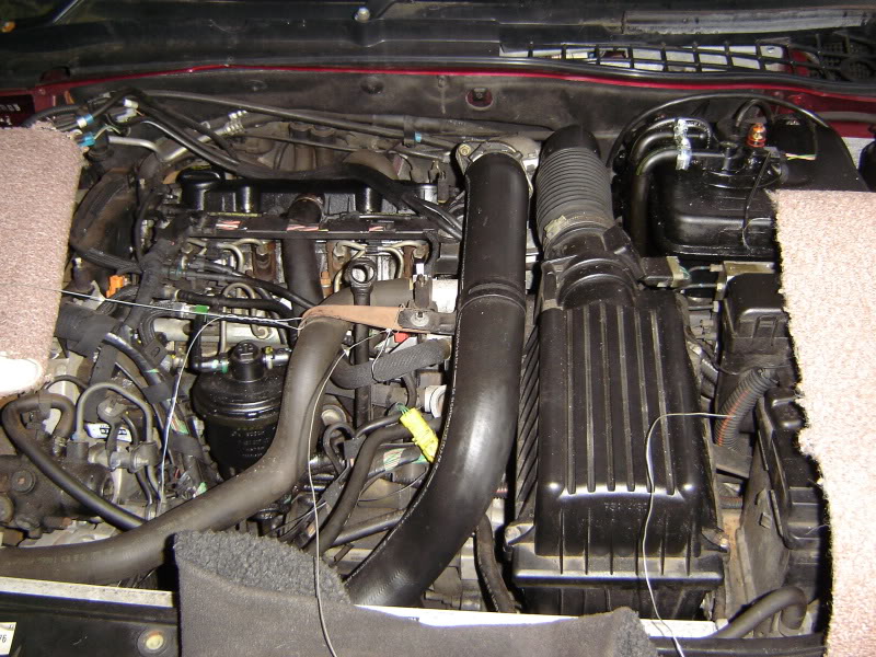

Third and last issue for MOT. excessive smoke at high revs.....I mean really high revs . My Mot man said it may be a build up of oil in pipes.
Course it could be a seal on the turbo but it doesn`t seem an issue on normal running. Any HDI 110 owners had this ?. Is it a common issue?.I mean can it be cured with injection cleaner and a blast down the Motorway before Mot ?

I have a 90hp hdi xantia and she can be a bit smokey at mot time i get it real hot and it goes through,just rev the bits of it just as you hand over for gas test :D ,been told to blank off egr valve [exhaust gas recycler] as at this stage in its life its just clogging up the head with soot, can anyone confirm?

Thanks ML. Can anyone confirm the EGR problem and where is it to blank off.
Cleaned out turbo hoses today.......just a light film of oil.

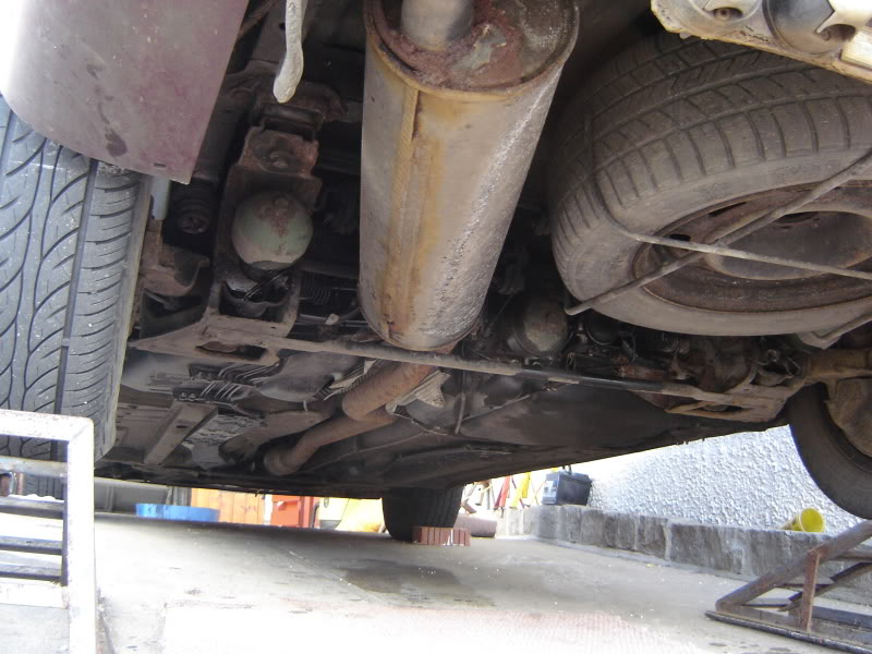

Is this a standard exhaust set up on Xantia HDI 110?
I thought it had a three part Cat? I don`t see the dog bone item for height corrector. Shouldn`t there be one in there?

The dogbone should be there, but certainly visible from that angle. The lower bar is not your ARB; it's just a stiffener.

Of course Addo ........it`s the ARB at the front I worked on.
Car is on a steepish slope Mike. You are rolling back if anything. There is a wedge at front N/S wheel anyway. That slope is brill for reversing up onto ramps.
So only one big Silencer box at rear? And is that a Cat at the front?. There is no heatsheild on it although tunnel has some on it.
