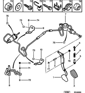

So does anyone know what the deal is with the hydraulic clutch on the
Peugeot 406 and could this be made to work with the Activa system?
OK, if not, how would a clutch get plumbed from the V6 unit into an
Activa and would the Activa subframe be man enough if the V6 active
ram strut was fitted?

lol..allmost at the same time :-)
Anyways..here is the cluth for RHD..although a Phase 1
ES9J4 is very compact, so low profile that the oilpan is more like a small dish, rather than bath tub size from the XU-series, crankshaft is deep in the engine alloy case
There is one thing odd, the 240 mm cluth vs. the 230 from the XU10J2TU and different part number in the cluth-slave kit..bellhousing, but looks very similar.
