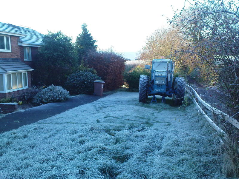

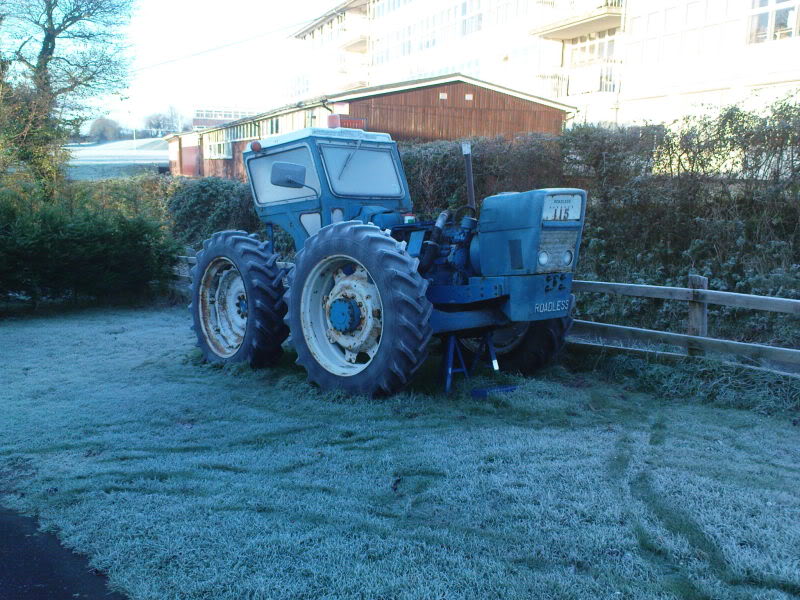

I took some photographs a couple of days ago of the Xantia and the tractor and thought I'd share them!
The tractor ones where taken fairly early on Saturday as I began work on again, it does look nice with the covering of frost :)

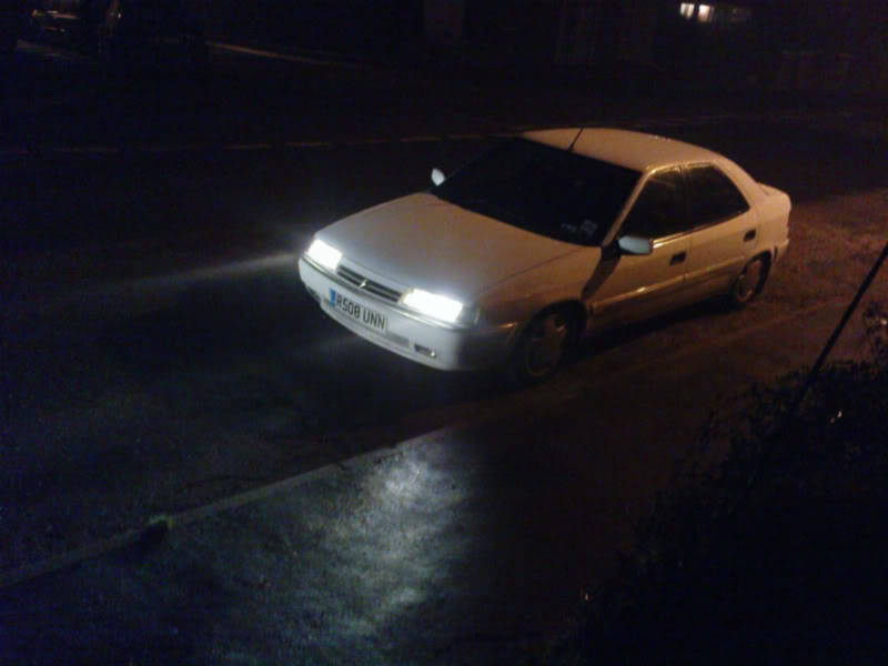

Took this one last night on the way home from work. The first couple of takes didn't look quite right but then a car came up the road and gave the front of the Xantia just enough illumination to focus the eye to the chevrons :D
I was doing my weekly check of the Xantia on the weekend and found that the inner side of the OSF tyre is nearing bold...looks like the tracking is out. That may also explain why the car vibrates a little at 70 mph. I think thats how it works, someone please correct me if im wrong :wink:

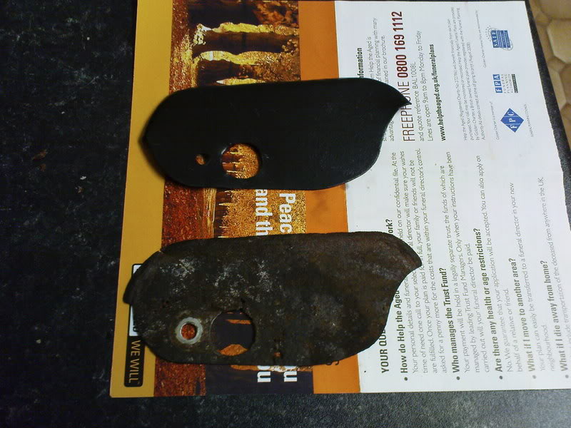

Yesterday I managed to hack off the OSR ABS sensor after shearing the three bolts that hold on the disk brake protector. Malcolm (citronut) was right about the ABS sensors being impossible to get out, had to resort to the drill and chisel it the end :lol:
Today, the grandparents were around so didn't have much chance to look at the Xantia. I did have a look at trying to get those darn studs out using a combination of left hand drill bits/right hand drill bits and stud removers...I ended up actually snapping one of the latter :shock: Thats even more to get out of holes...
It seems the best way now, will be to take the brake caliper and disc off and try drilling the studs out, then popping into GSF to pick up a new sensor. Might also try and get hold of a new accelerator cable as mine is fraying, can't think of anything to buy while im there...
When I did get the sensor out I found that the sensor heat shield was rusting badly with holes appearing in some places, so I spent an enjoyable evening in the shed making up a new identical part from the sheet metal I had left over from replating the tractor bonnet. Quite pleased with the outcome, just need to splash a bit of paint on it to prevent it rusting again.

I've taken a photo of the thin, rusty, holey ABS Sensor heat sheild and my new, improved design, complete with the stuff they use to paint tractor exhaust pipes :wink:
Considering Im just starting out in the whole metal work scene im quite proud of the result 8)

Yes, absolutely, a jolly good effort Kev :D
That's the stuff, out working in the frost :lol: Dedication!

superloopy1 wrote:Wahey ...
Now i know where to get a couple of heat shields when i need'em :wink:
Certainly :) if a forum member doesn't have the kit to duplicate/make something thats not overcomplicated, im always up for a challenge :wink:
superloopy1 wrote: Looks good ... and to think I thought only the Chinese can copy to those standards :lol:
You're not, are you? Chinese that is ...
:lol: Nope, I hope the Hungarians build good quality stuff though, that appears to be where our ABS sensors are being produced :D
citrojim wrote:Yes, absolutely, a jolly good effort Kev :D
Cheers Jim! 8)
