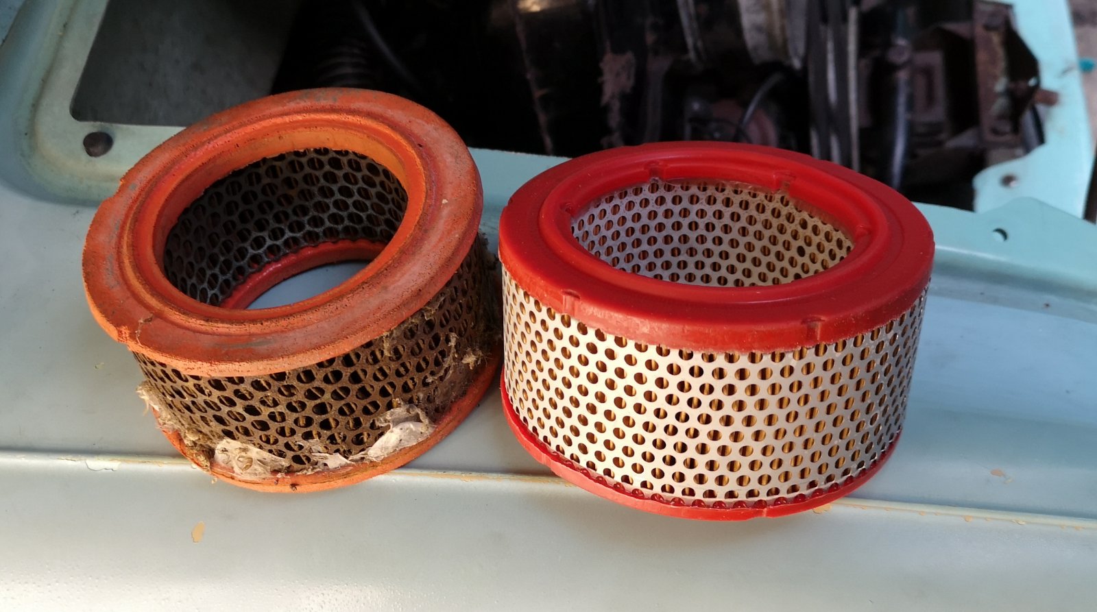

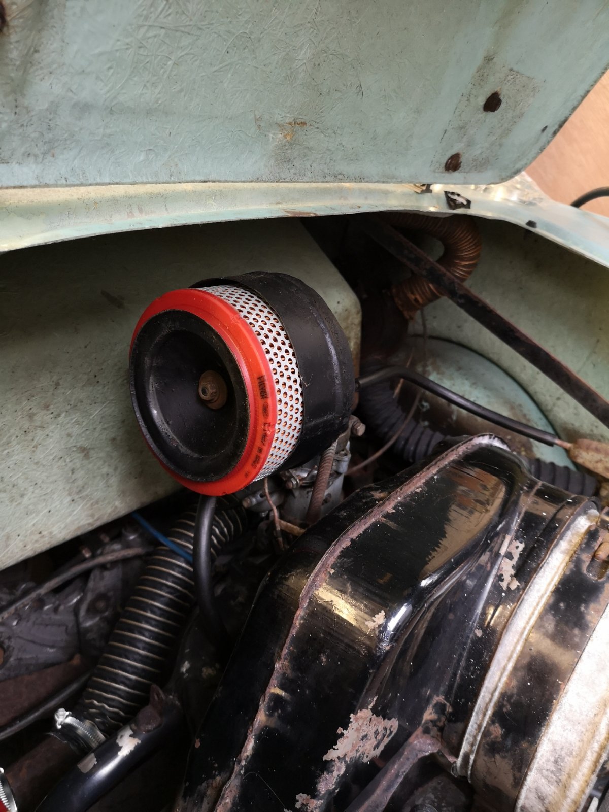

Today's first task was to fit the air filter which arrived yesterday. I think it's fair to say that the one that came out was "due for replacement" in this case!
Much better.

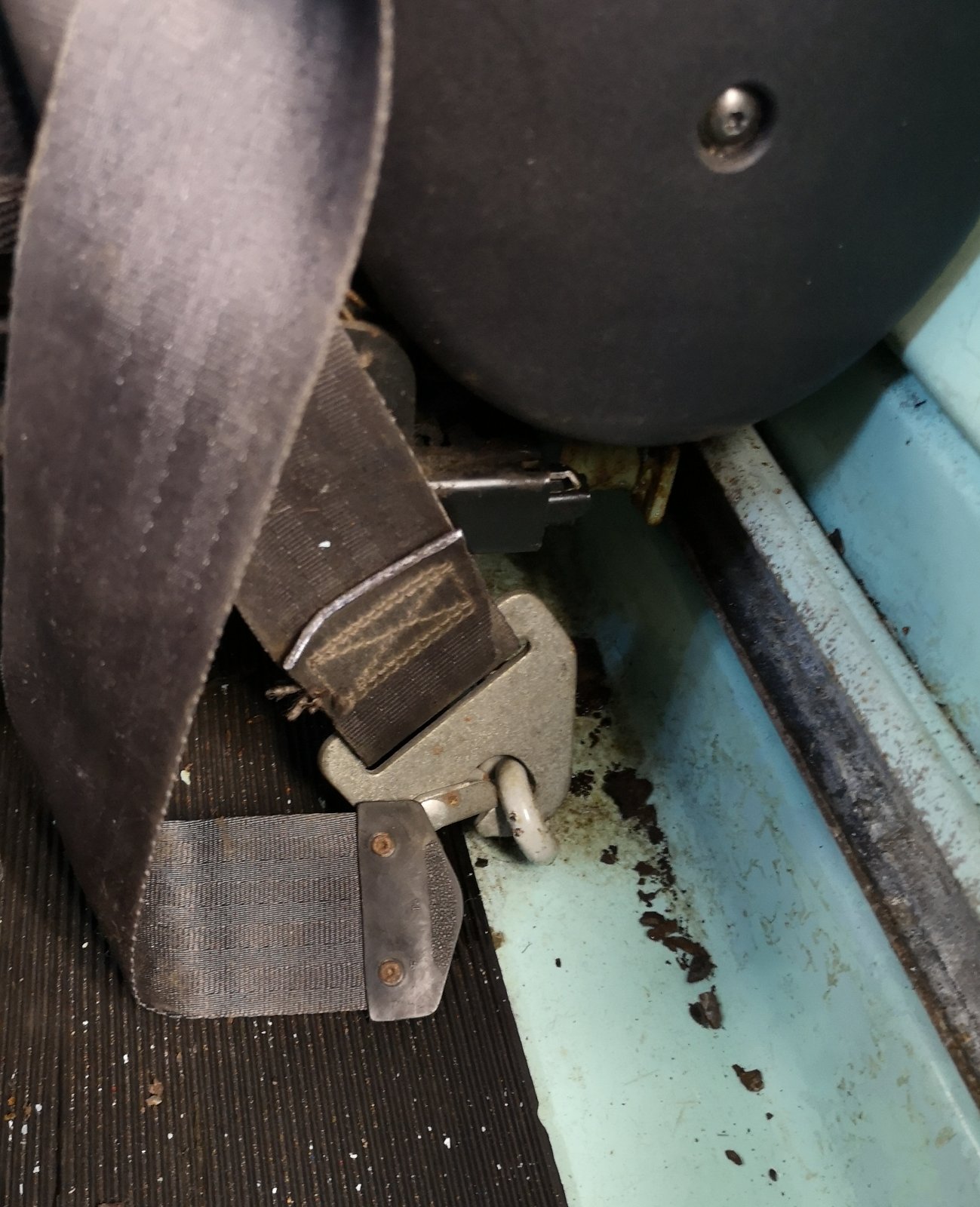

The rest of today's jobs came under the general heading of "unexciting but important" I think.

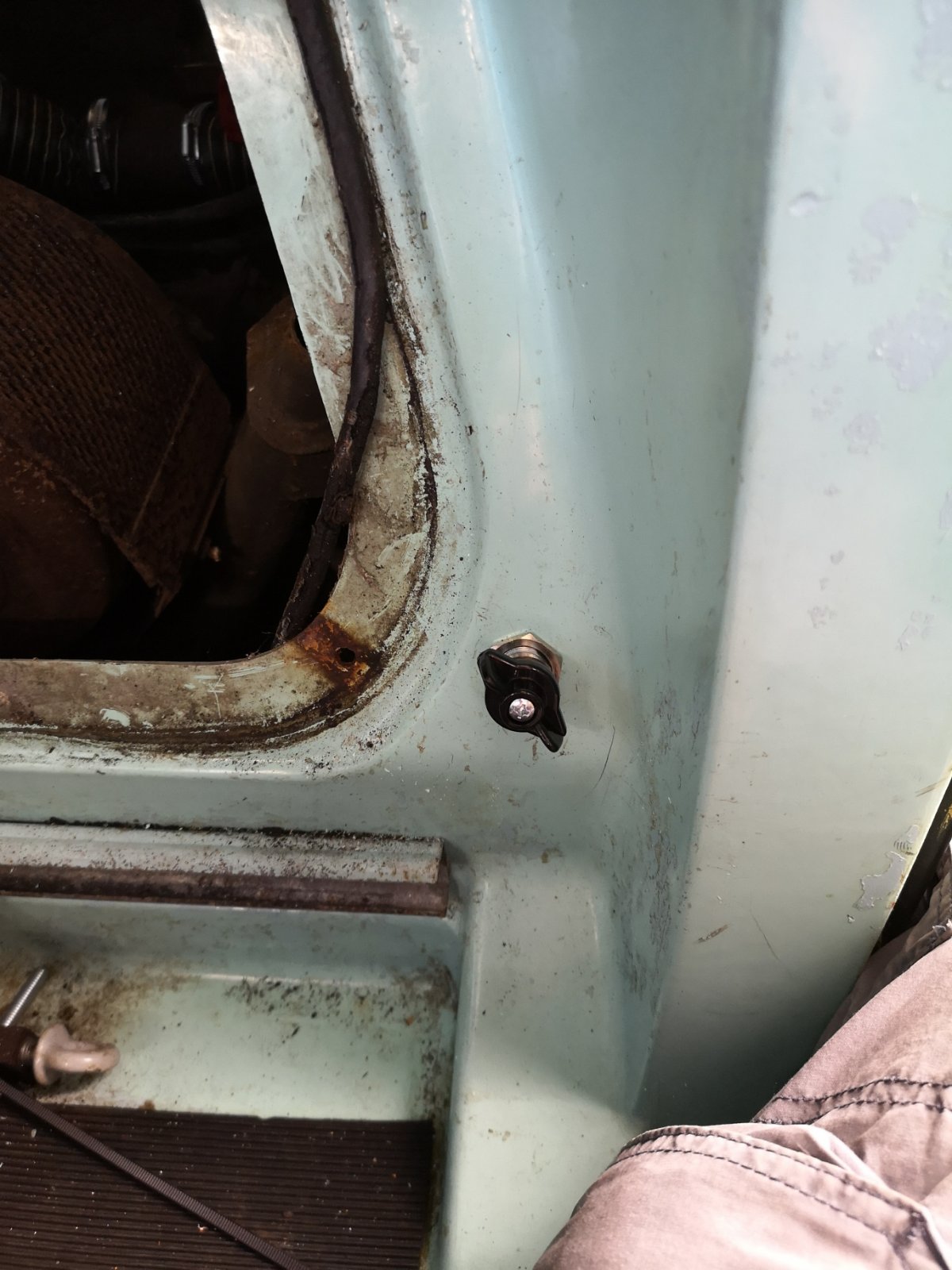

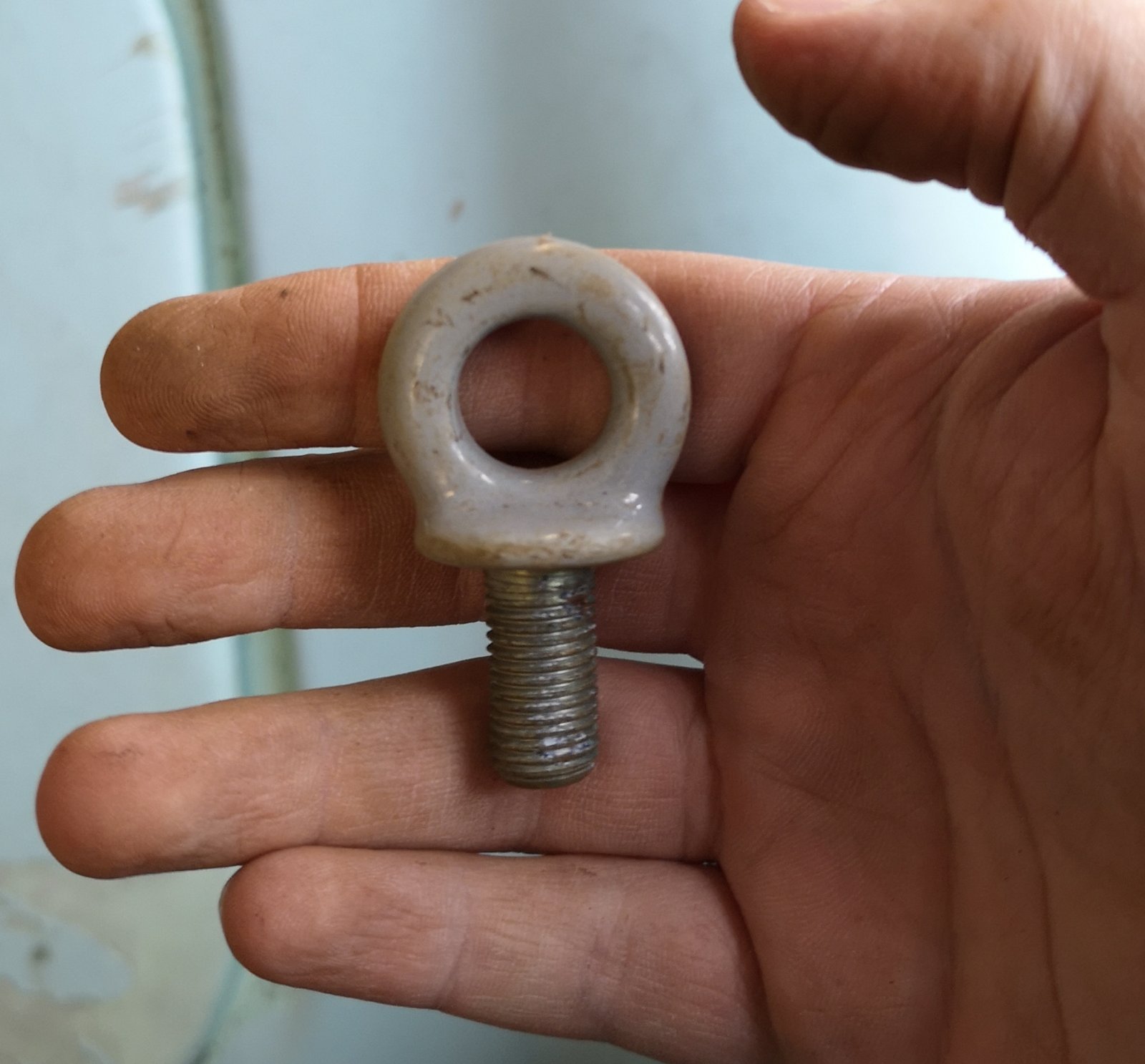

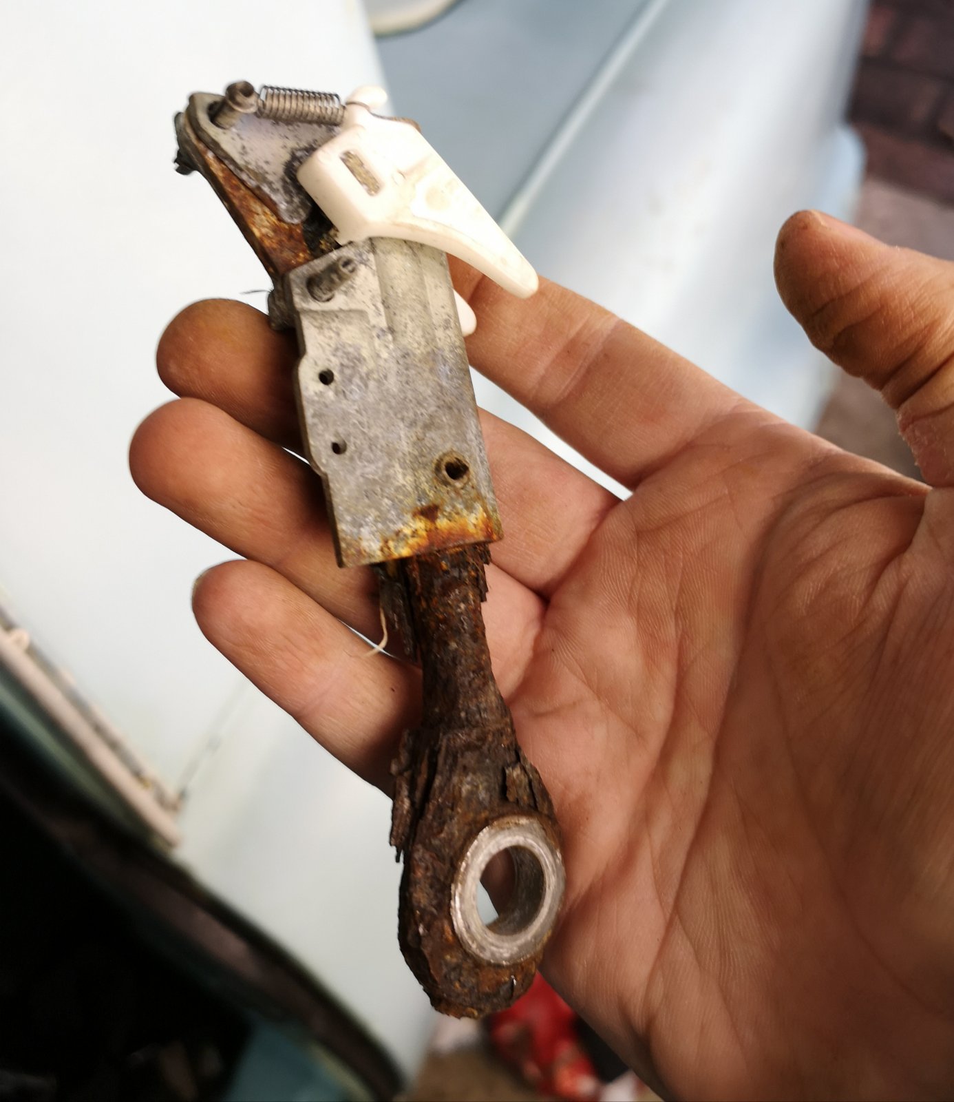

The redundant seat belt buckle and pretensioner were removed from the driver's seat (anyone need a spare for an S2 Xantia?) which meant that the seatbelt could actually reach to the correct attachment point without that getting in the way. It also meant that it was time to get rid of the mangled, rusted remains of the original seat belt attachement point...which I was somewhat staggered to get to unbolt without too much of a fight.
Obviously the only place that was going was the bin.
This was replaced with a nice new old stock eye bolt for the earlier style seatbelt I've got.
The belt then clipped nicely in place, without any bits of Citroen getting in the way (which it turns out also has made getting in and out a lot easier as I don't have to carefully avoid sitting on the seatbelt buckle any more).

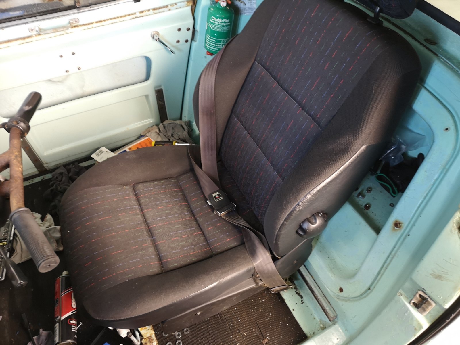

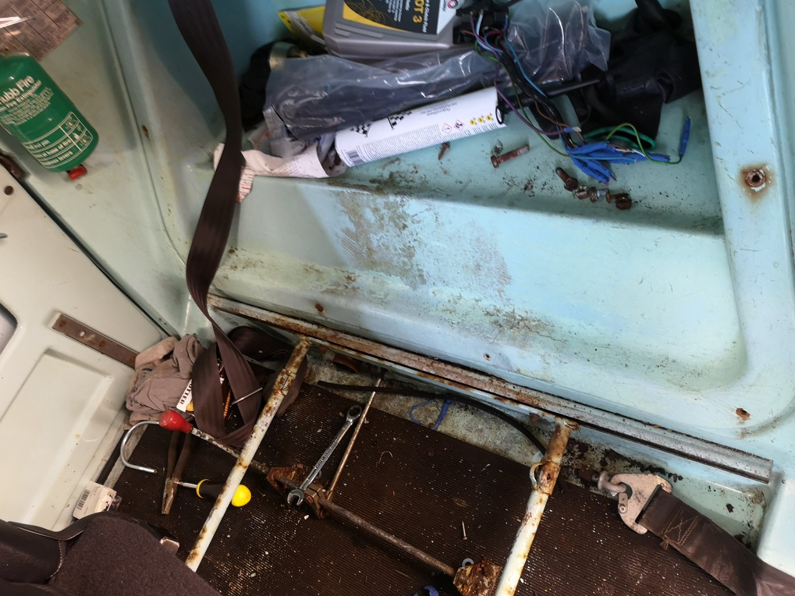

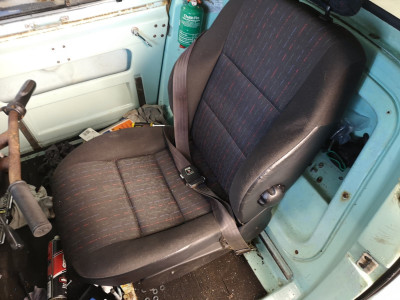

I figured that having done this it made sense to sort the seat out properly as well (it wobbled). The issue I had was that the U-clamps I'd used to clamp it to the original seat frame were slightly too big so couldn't be tightened down far enough as I ran out of threads. I was originally going to get some more clamps before having the bright idea of just using a bunch of washers as spacers to take up the 1/8" or so extra I needed. Job done...Seat is now far more secure than the original one in the car ever was. This done I was then able to rettach the trim which helps keep the somewhat ugly mounting hardware out of sight.
Only other item of note done today was that I found the correct size of screw so was able to reattach the offside interior door release which can also be seen in the above photo.

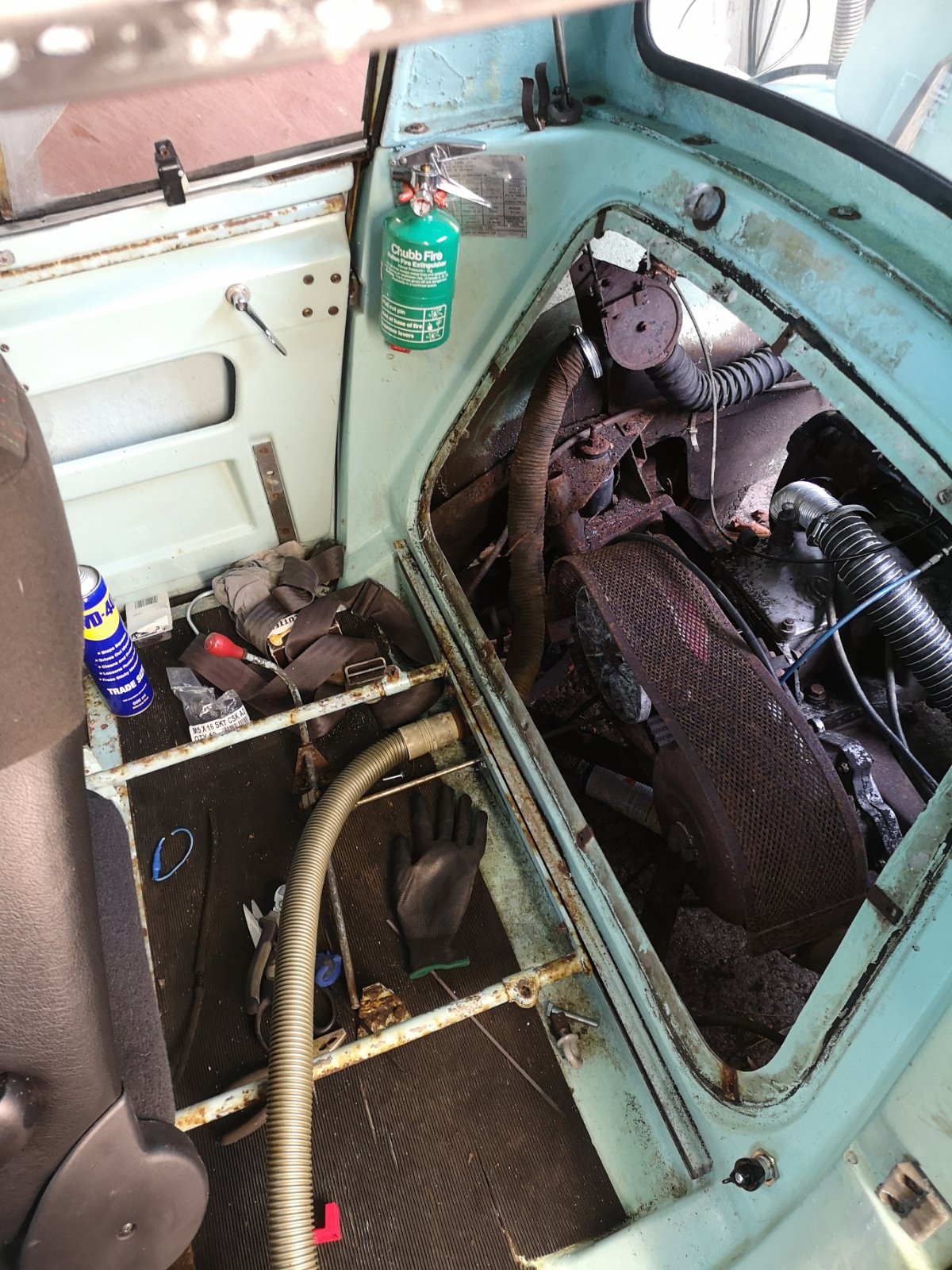

You know that thing I did bolting the seat in place yesterday? Yep, went and pulled it out again today.
To be fair I knew I was going to be doing that, I've got a list of things on the whiteboard which basically come under the heading of "stuff I bodged when I was wanting to just get the car going" and "stuff I couldn't get at earlier."

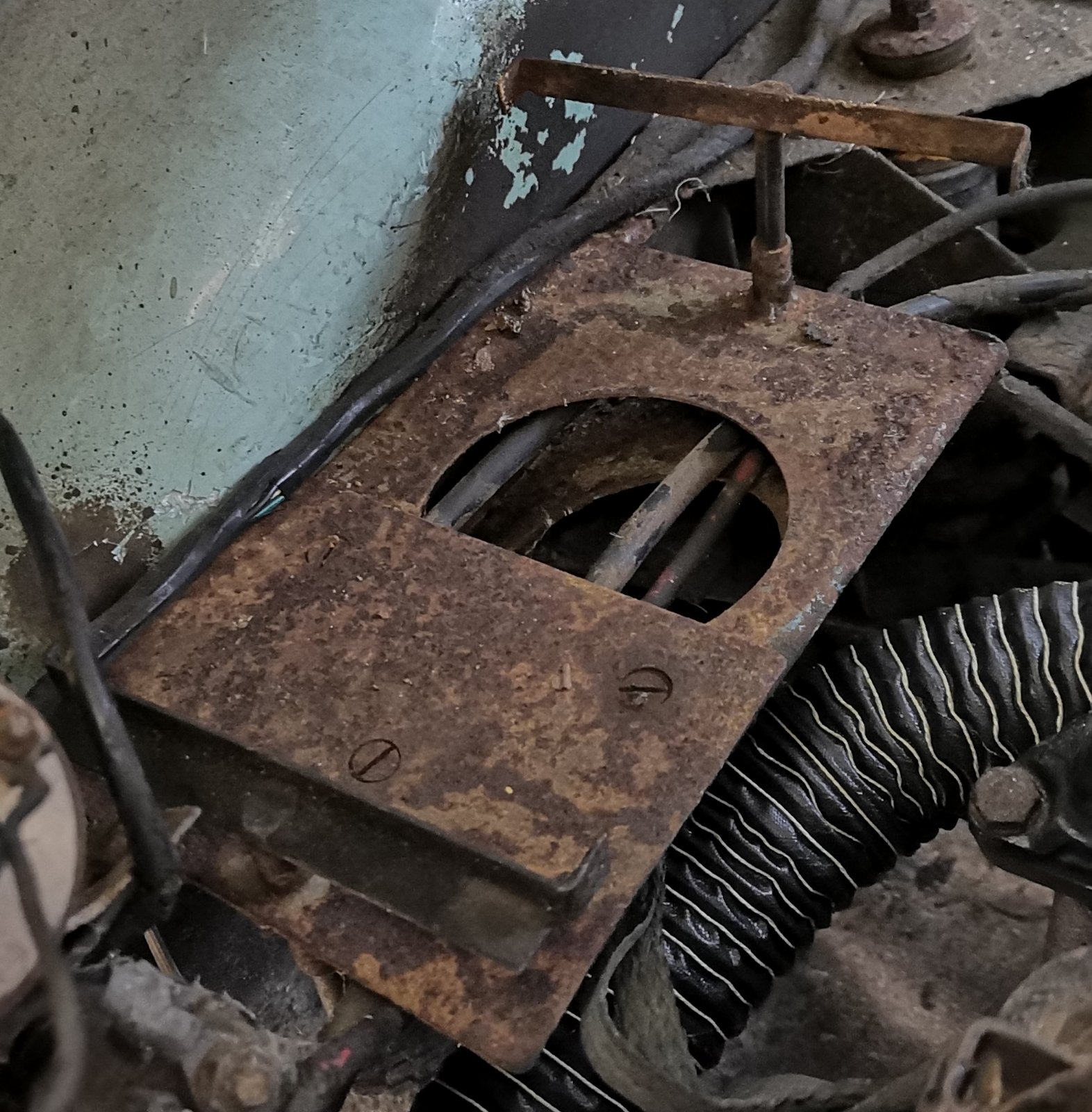

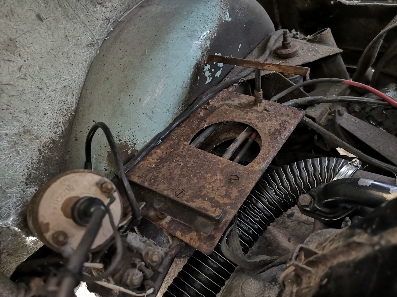

The transmission access hatch needed to come off. Of course there was the obligatory *one* screw that wouldn't come out. There's always one.
Out with the drill again. Then half an hour of very, very carefully peeling the gasket off as it was well and truly stuck to the bulkhead.
So there were a few things I wanted this off for.
Firstly, the offside engine mount. I'd only managed to get one bolt into it when the engine went in, and the nut wouldn't do up fully because the bolt was partly cross threaded. Access was awkward from the back of the car, but a doddle when approaching from inside the car. Note to self: next time you need to change one, do it from that side.
While I was back there I rerouted the throttle cable properly through the eye on the gearbox which has helped stop it sticking. Also took the opportunity to adjust the gear selector which is far easier with the seat out the way.
While rummaging around I found two battery clamps, so have replaced the missing one.

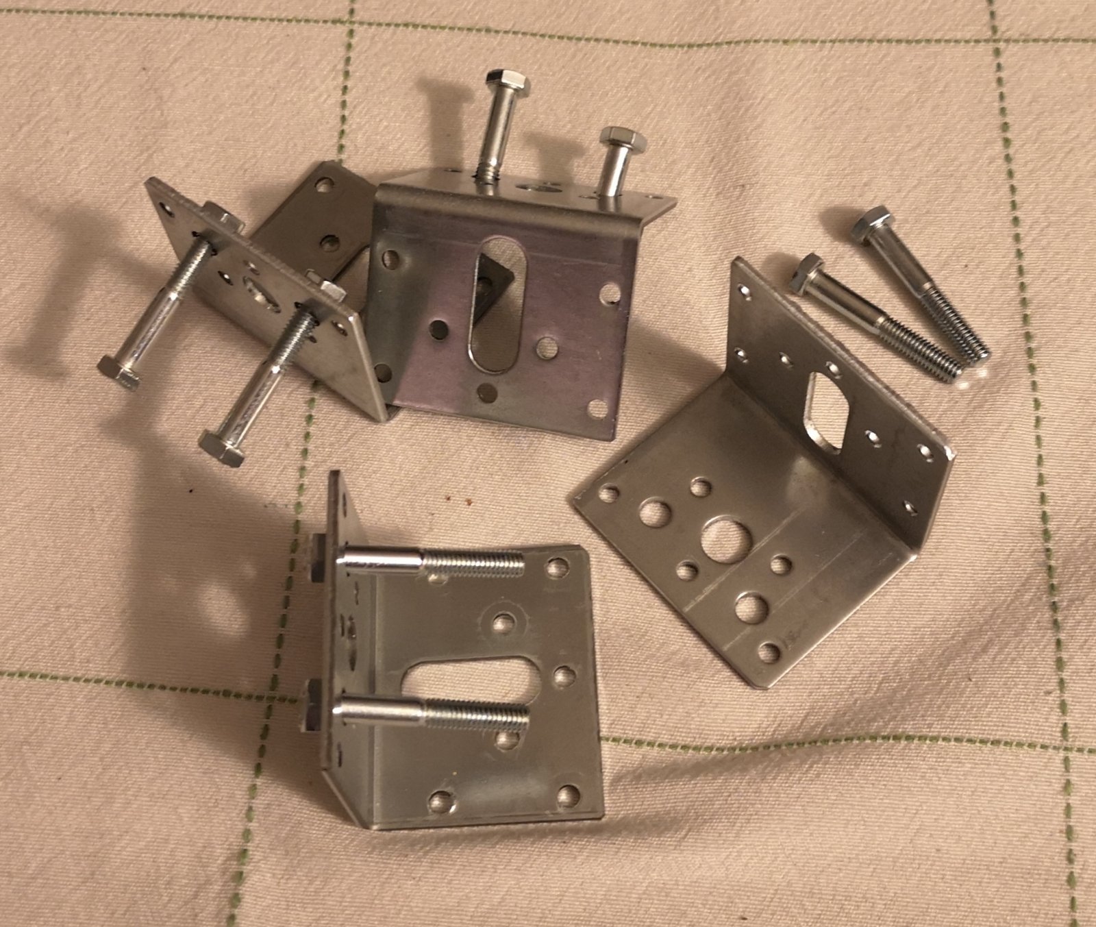

I've also been pondering my seat attachment setup and reckon that I can improve on my original solution...which worked but was exceedingly inelegant. I can do better.

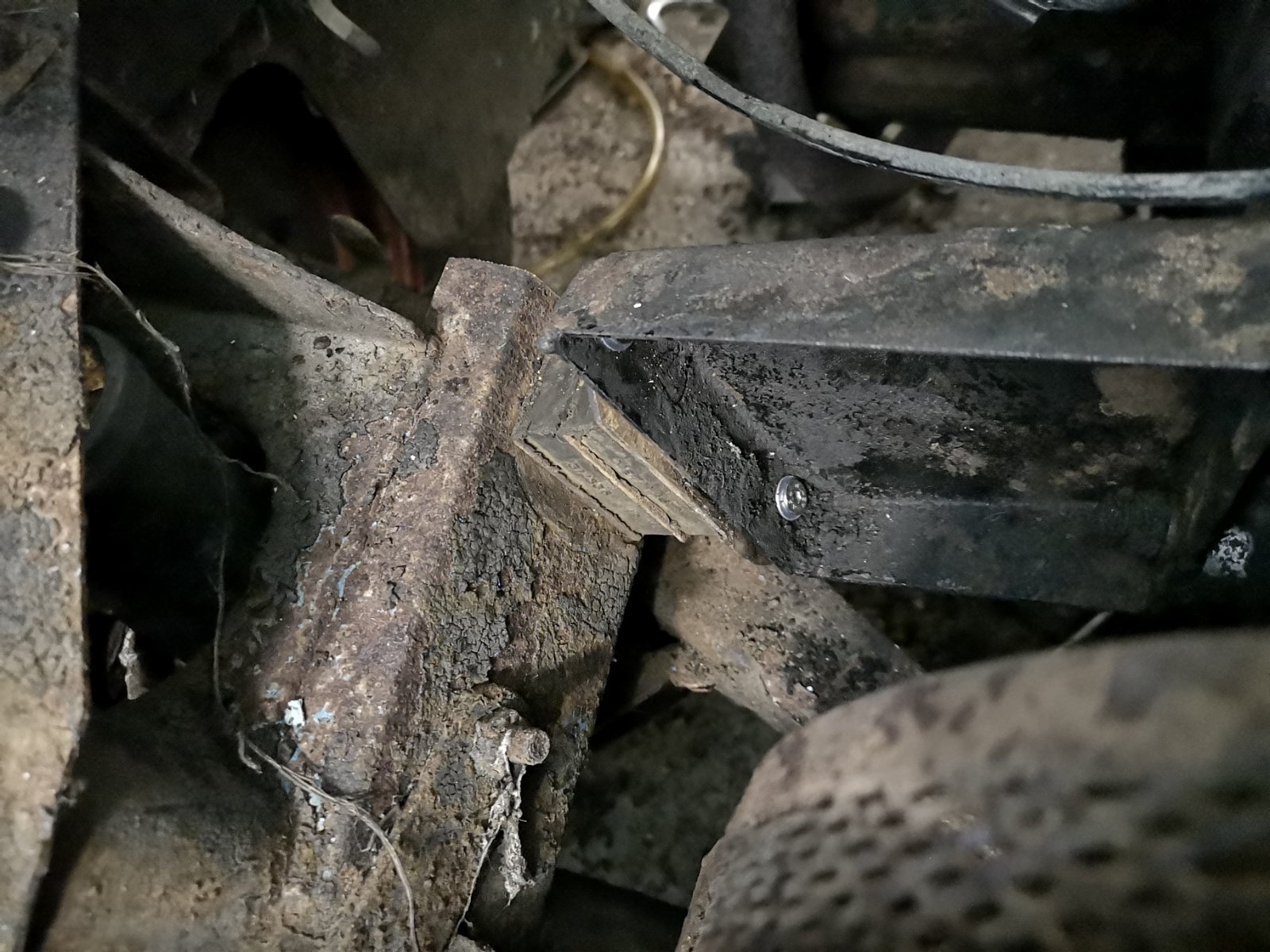

Other reason I wanted that cover off was to get better access for routing the rear axle brake lines. Once that's done everything will be getting buttoned back up.

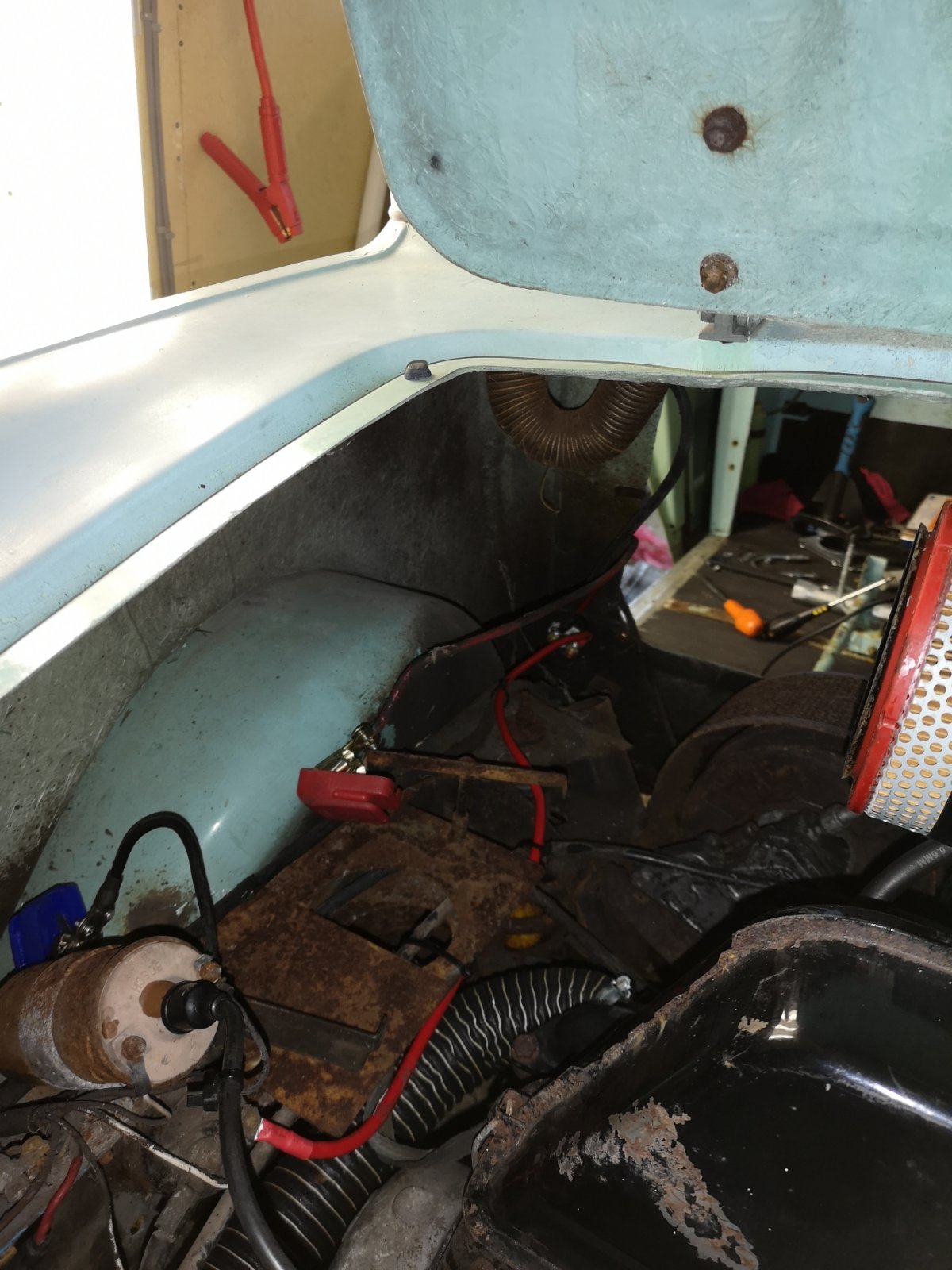

One other reason I needed access to the engine bay from that side was to make a simple common sense addition to any car of this sort of age - a battery cutoff switch.
Given the minimalist approach to fuse protection in this thing it was pretty essential I thought and will save me having to physically remove a battery terminal every day before trusting it not to burst into flames in the garage overnight.

Today I've been trying to work out what battery I need for the Invacar. It's currently got an 038 in (read: nicked from the C5) but that's too long to be secured by the battery clamps.
The hard limits are the distance between the two posts which the clamps fit into at 210mm (8 1/4") and the width at 140mm (5 1/2") as the brackets wrap around the end of the battery.
Looking through my extremely dog eared battery cross reference table, it looks like the 054/5 size is the best match at 187mm (7 1/3") long by 127mm (5") wide and 220mm (8 2/3") tall. Height is irrelevant as there's bags of room above.
Longer term I'll be looking at moving the battery up front to provide some additional front wheel ballast, but that's at least months if not years away yet!

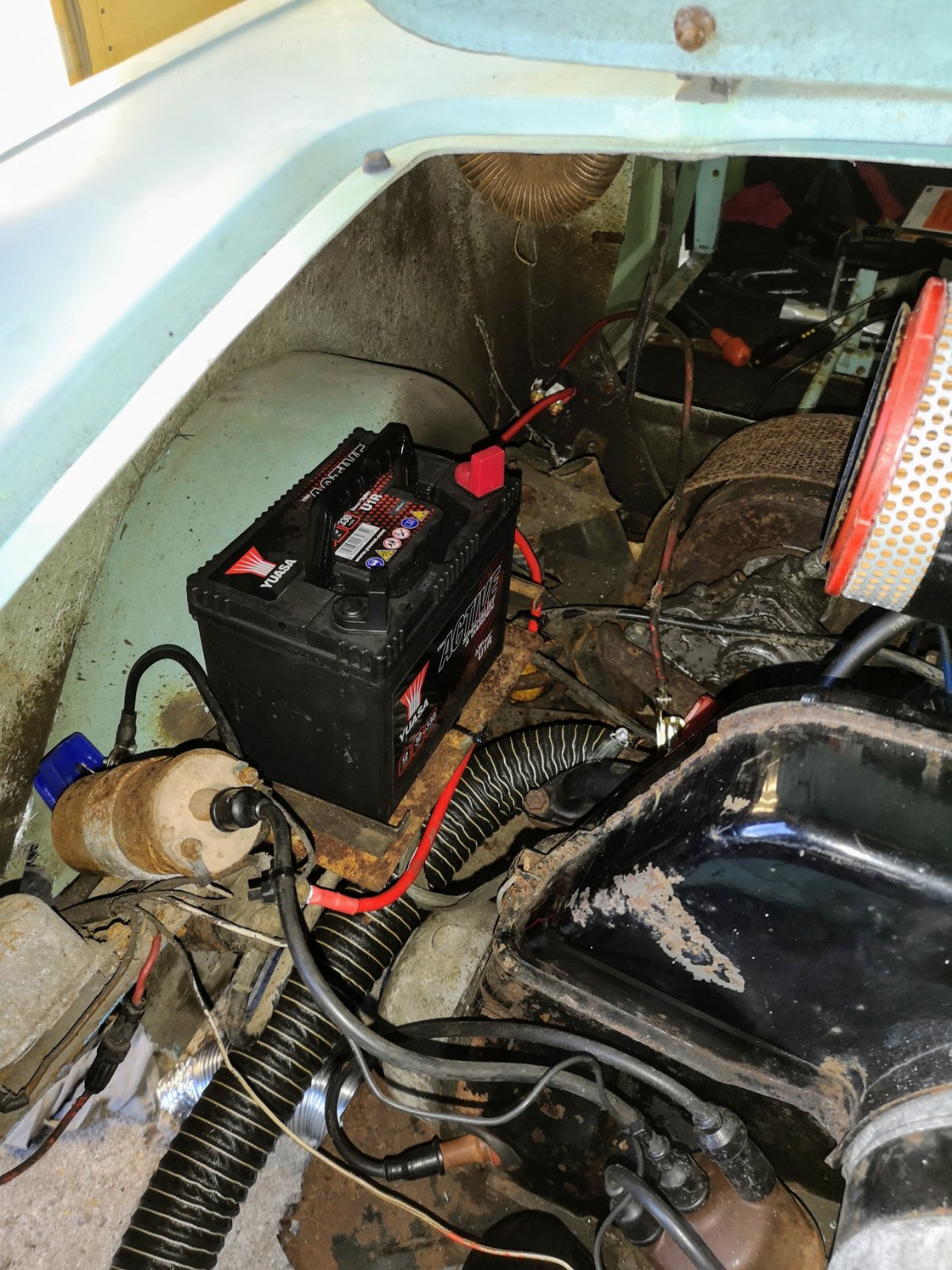

So today I had a rummage around at a few places locally which stock car batteries.
A 063 would do just fine if the measurements were to the extremeties of the mounting flanges at the base...sadly they're not, they're the body size. Result: It's way too big. Likewise I couldn't find anything which was capable of fitting both the length and width...I could have either one, but not both.
Eventually wound up just going for a U1-R for a few reasons.
It looks like it's pretty much the same size as the original - save for the original one having a flange around the base which the U1 lacks.
Electrical specs are identical to what's listed in the manuals so that should do just fine. Weight is a big bonus as well, as the U1-R I've picked up weighs in at just under 8kg. The 038 I've been using up until now is around 12kg. Given that we're talking about a car with just under 20bhp, every gram counts.
I'll need to make up some spacers to go between the battery and the brackets, but that shouldn't be a problem. As this lacks a mounting flange around the base I'll probably use some scrap metal to make a strap to go over the top as well.

Not had a particularly productive day.
While digging around I discovered that the hose routing air to the cabin outlet was actually hanging off and the last inch or so had disintegrated. Thankfully there was just enough left to trim it back to sound hose and reattach it.
Next step was trying to get rid of the crud in the various hoses in the interests of not getting crud in the eye halfway down the A509.
Sealed the inlet side of the system off...
...Then switch both the heater and demister on, and attach a vacuum cleaner.
This setup resulted in air being drawn in through the demister vent, then via the control box and out through the cabin heater outlet. Once this was set up I turned the vacuum on and then basically went and battered all the ducts with the handle of a screwdriver until I could no longer hear stuff rattling down the hose, and declared it done at that point.
This is basically the point at which progress stalled as I decided to change the fan belts. Which was fine until I got back from the motor factors and it immediately became apparent that the two belts they had given me were in fact not identical.
Got back there to discover they didn't have a second longer one in stock, so will have to go back tomorrow. Blarg. By this point I'd wasted an hour on that and immobiliser the car as the starter motor was no longer attached to the engine essentially.
I did get more planning done on the seat securing plan. Not least taking some measurements and getting these picked up.
Basically these will be bolted to the seat frame by two bolts each, and the seat rails will then be bolted to these brackets. Aside from being rigidly attached to the frame, this setup will leave both the longitudinal and height adjustment to still work normally.
