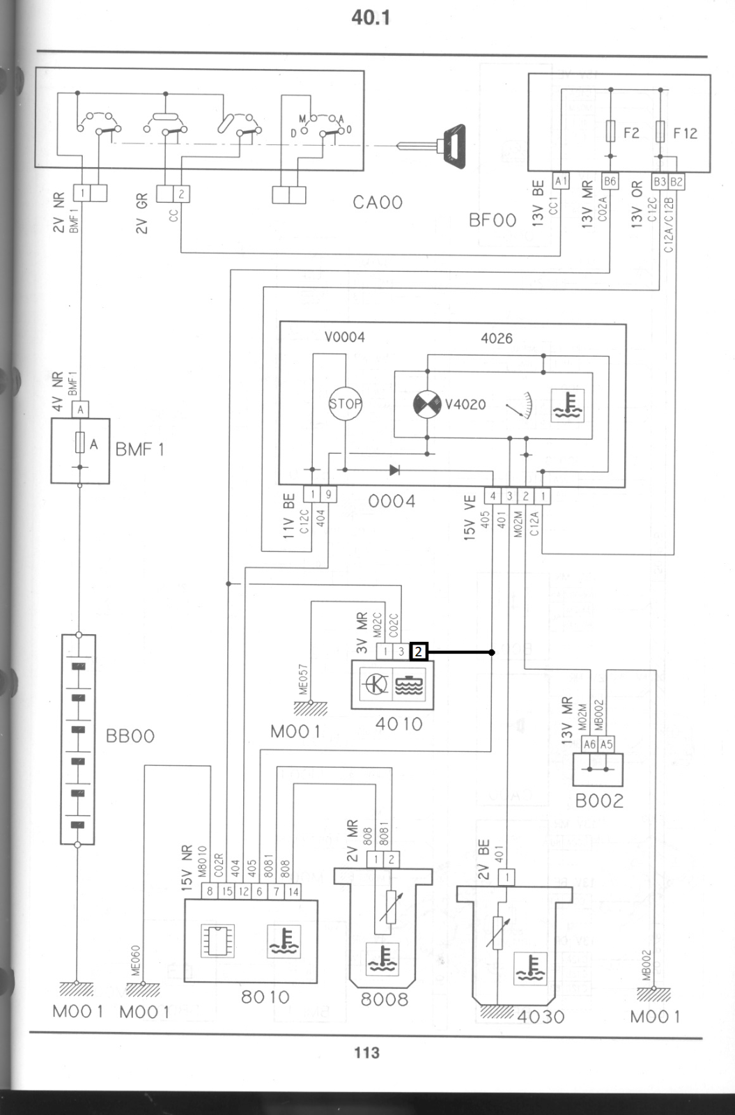

Does anyone have a copy of the wiring diagrams for the Bitron (S1 V6) to help me find where it actually is and trace the wiring for the level sensor mod ?
I suspect it has been posted in this thread before but with the thread now hitting 200 pages I doubt I could find it!

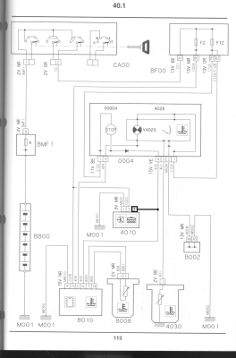

Try this from Citrojim 2016, page 54
NeilCitroJim wrote: 10 Oct 2016, 10:50 Here you go Simon...
Level Circuit
Level Harnesses
Level Locations

Note that those diagrams correctly show the incorrect wiring. The missing wire runs from pin 2 of the level sensor to pin 6 of the Bitron box.

Ahhh....the fabled missing water level sensorxantia_v6 wrote: 06 Mar 2024, 02:35 Note that those diagrams correctly show the incorrect wiring. The missing wire runs from pin 2 of the level sensor to pin 6 of the Bitron box.

Just to clarify,xantia_v6 wrote: 06 Mar 2024, 02:35 Note that those diagrams correctly show the incorrect wiring. The missing wire runs from pin 2 of the level sensor to pin 6 of the Bitron box.
4010 is the coolant level sensor and 8010 is the Bitron ? So I'm doing this ?
Pin 6 of the Bitron (if I am correct about it being 8010) also goes to pin 4 of "0004" - what is this module ? It's not shown on the location diagram. Just wondering if this is easier to run a wire to than running it to the Bitron.
Edit: On disassembly I've just noticed that there is no pin in the plug for pin 2 to attach a wire to ! How did other people get around this ? Did you have to find a 3 pin plug from somewhere else to use ?

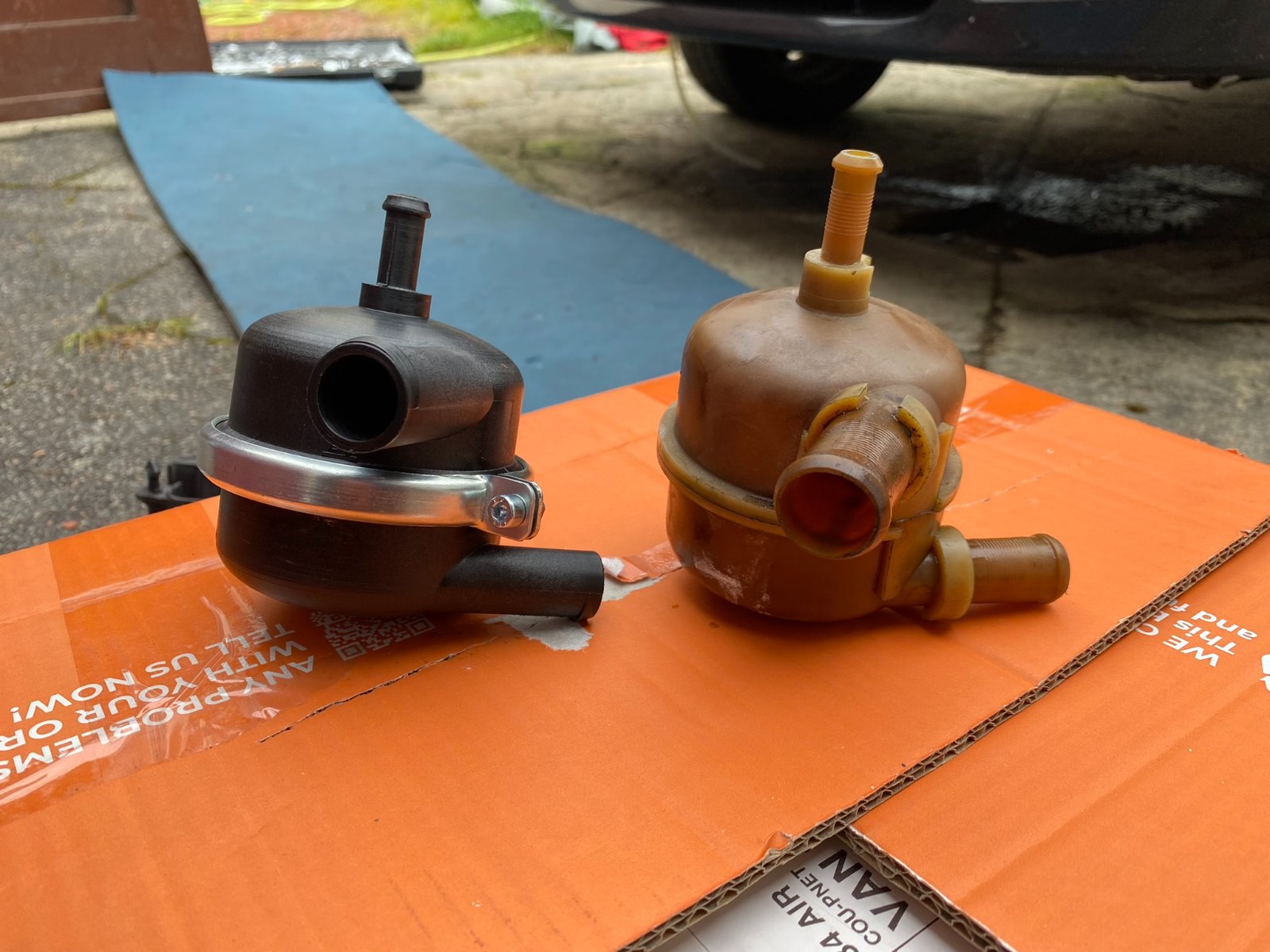

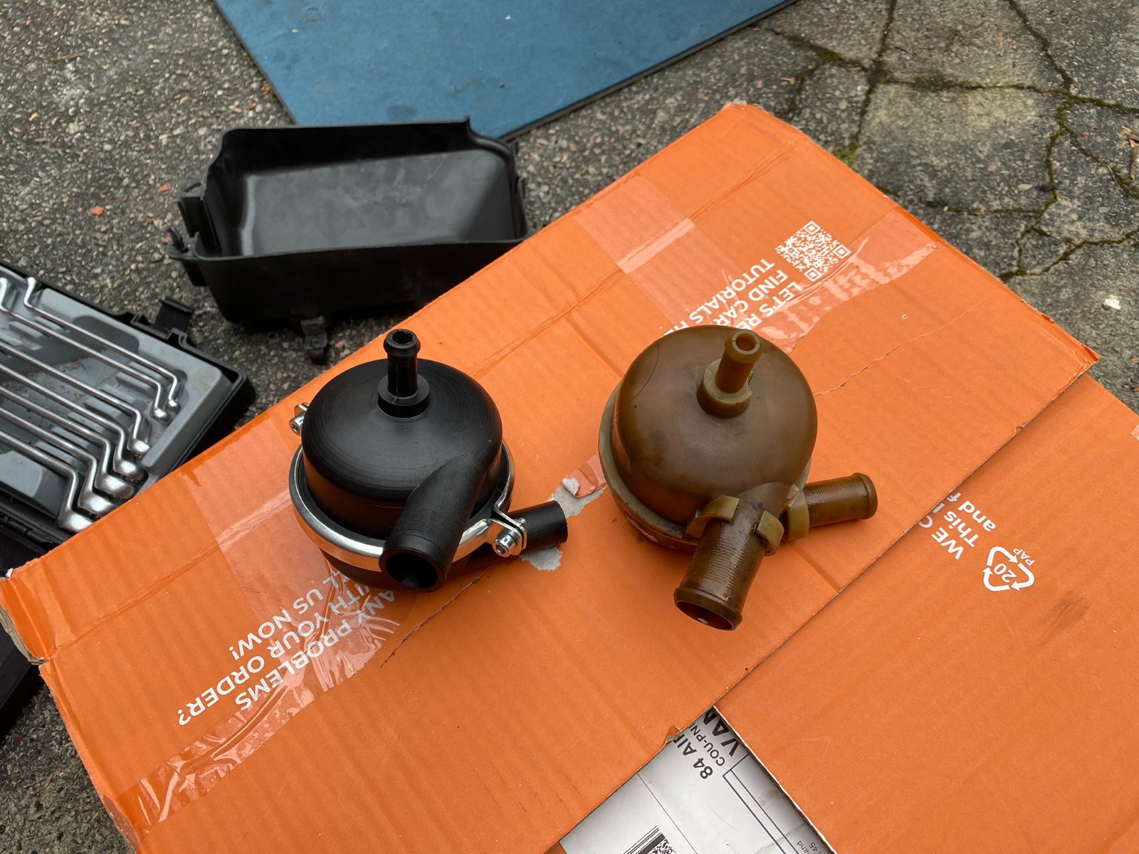

Here's the old and new pots:

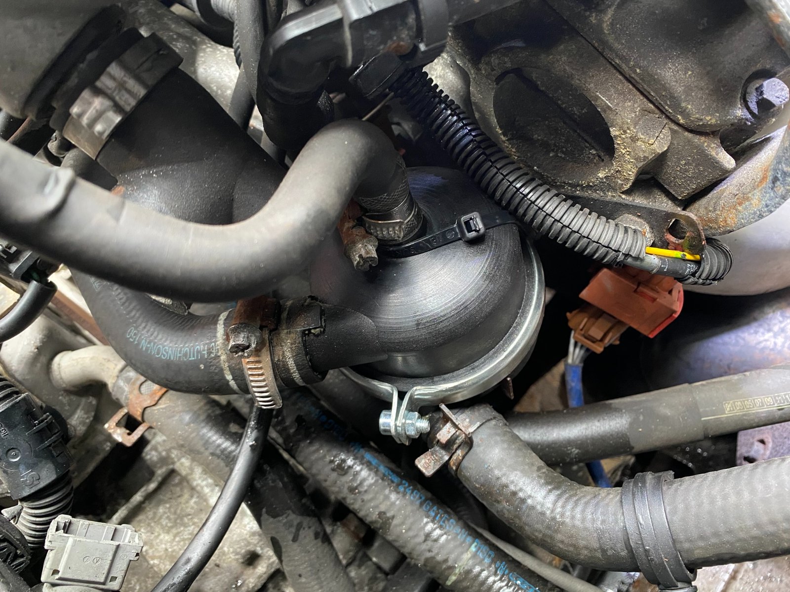

And here it is installed before the ICV went back in:
I had to bodge it a little to fit - the original spring clamp doesn't fit the new swirl pot so I had to break off the upper "finger" that normally goes above the seam, and to compensate I ended up adding a cable tie to pull it down into the clamp to keep it from moving around.
I got as far as installing this and putting the ICV back in and was about to reinstall the expansion vessel when the rain started.
Looking at the photo above it looks like I have wires with a broken conduit that I will need to remember to tape up to avoid chafing!
I think I'm going to have to skip the coolant level sense mod this time as I don't have a plug with all three pins fitted to allow me to wire it up.

The new swirl pot looks good following your 'mods'. Fingers crossed it's good when in use and under pressure.

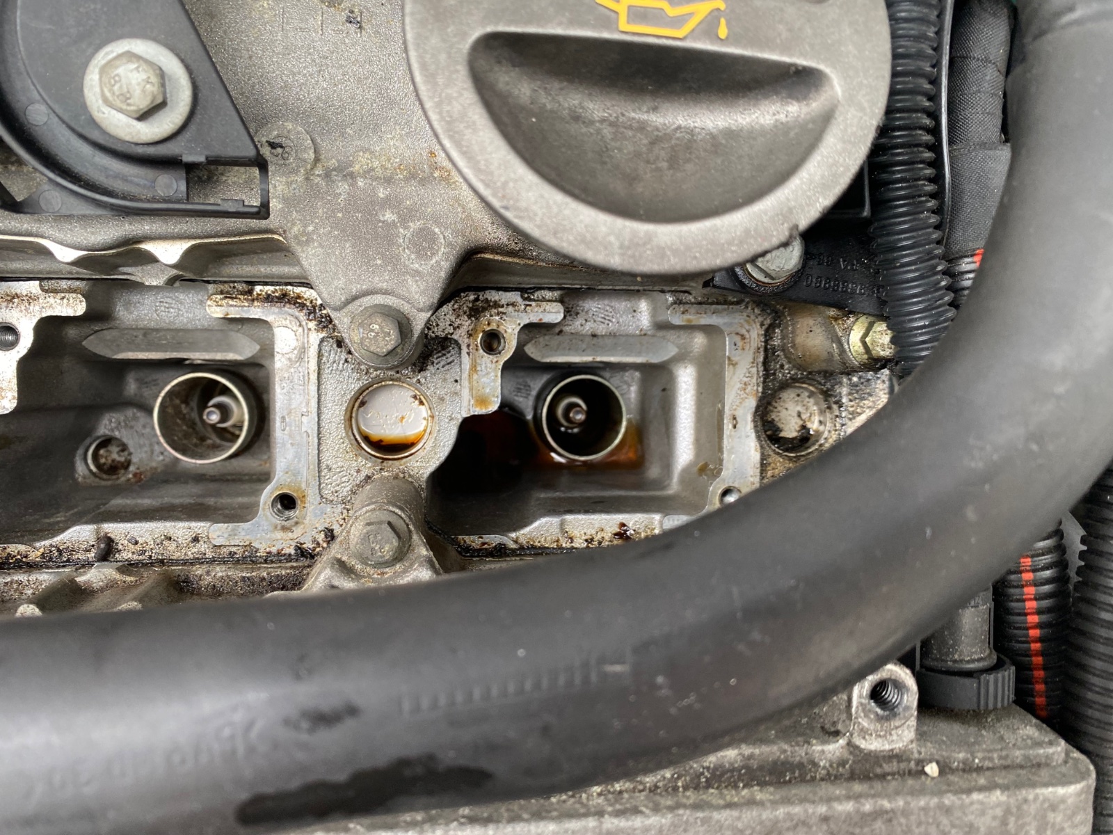

The spark plug below the filler cap is drowned nearly to the top electrode - I'm soaking up as much oil as I can with paper first so a big gulp of oil doesn't go into the cylinder but I'll want to remove it and degrease/clean it and refit it...
Edit, some sketchy sources (after market parts suppliers
) are suggesting 25Nm or 20-30Nm - does this seem reasonable ?
