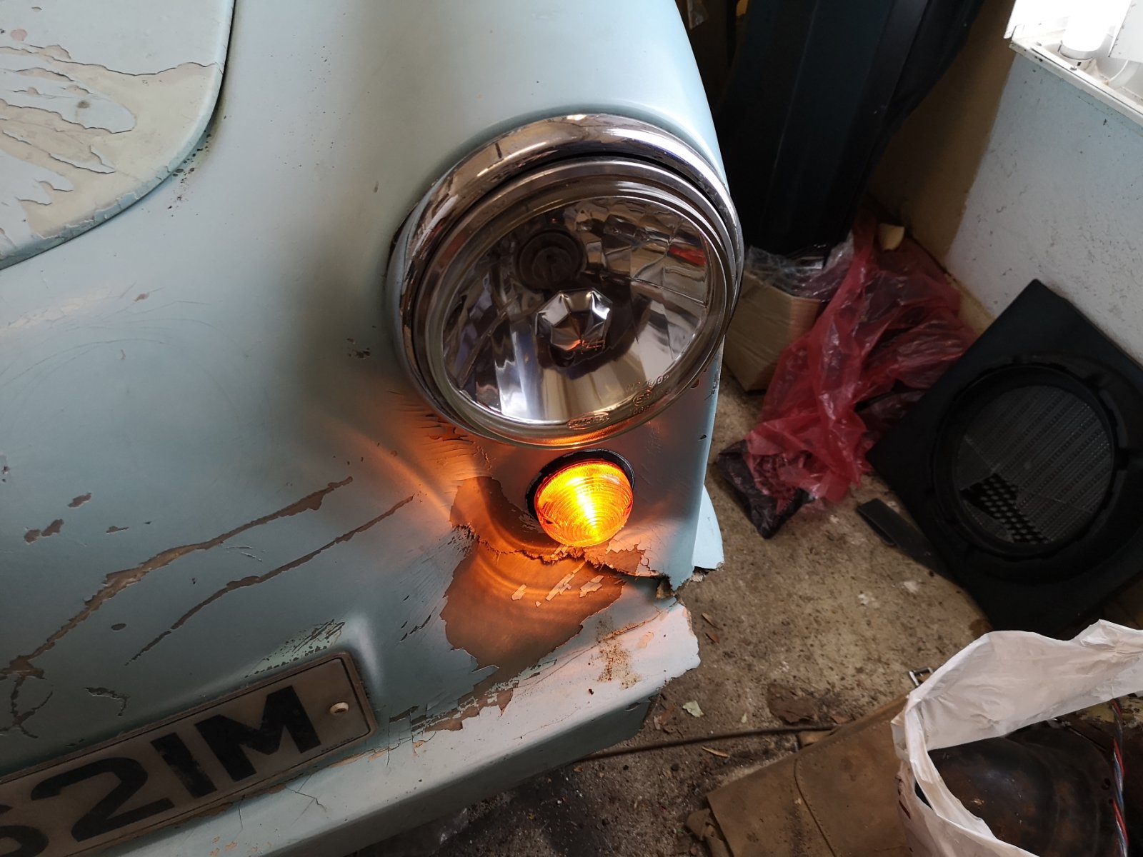

Front indicator lenses after a thorough clean have now been refitted. Output is much improved now they're not full of insect nests.

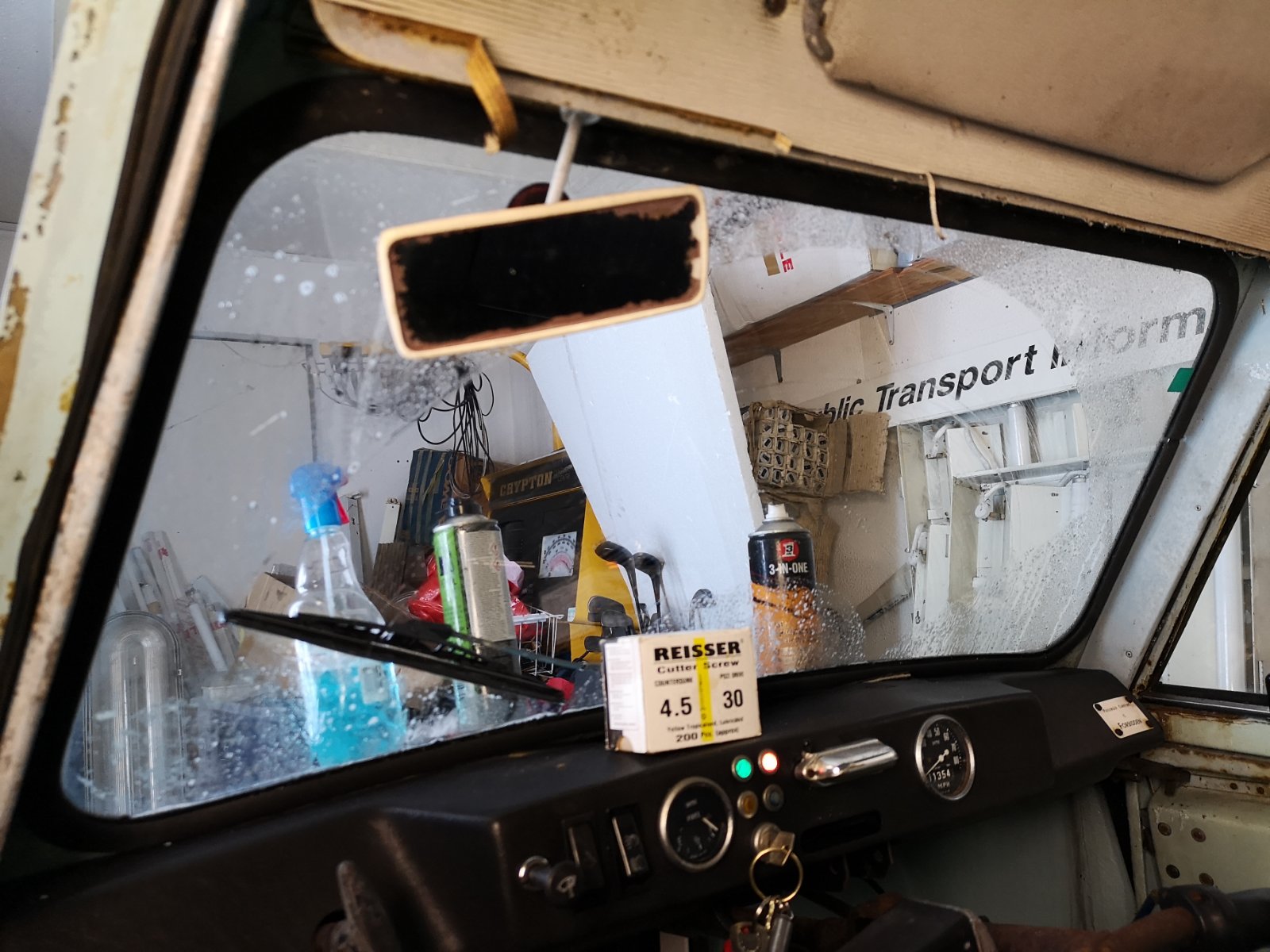

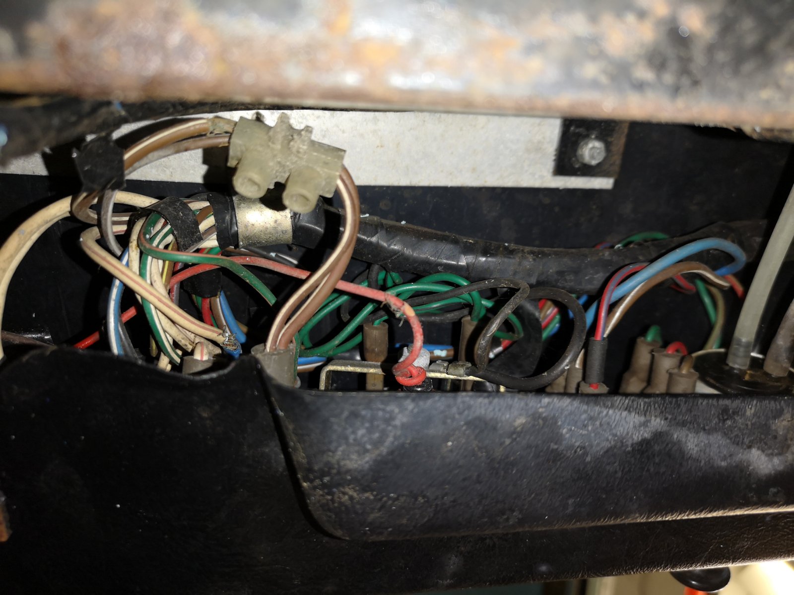

Turned my attention then to the non functional windscreen wiper. I'd already released the spindle from outside the car and the highly fiddly bracket inside the car. You would think that working in the footwell of a car with no pedals and a flat floor would be easier...no, it's just as horrible as always.
Quick meter test showed that power was indeed getting to the motor. While still standing on my head I figured out that I could just about slide it out of the bracket without unbolting that...which was necessary as the bolts to into non-captive nuts on the other side of the bulkhead...in such a location as to be really hard to get to. Sure enough it did slide out relatively easily, only showering minor amounts of rust from the dash frame in my face. Then I went and spoiled it by dropping the whole motor assembly on my head. Ow.
Cover off showed healthy brushes, but clear evidence of the motor having overheated at some point but still looked fine according to the meter. Poking it with power revealed that it did now run, however the gearbox was locking everything up at one point as the cable running to the spindle is seized in the outer channel. Spindle itself is locked up too.
I've left both of those things soaking in penetrating oil overnight. If they don't free up overnight I'll swap the motor out for the one in KP as I know that works.

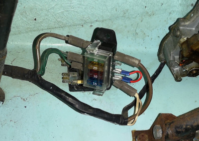

While I was standing on my head under the dash I noticed a couple of things.
Oh look... I'd totally forgotten that I still need to sort the fuse box out...
There are going to be quite a few long term wiring changes but I'd like to get things hooked up properly and secure the fuse box in the interim though. It's now on the whiteboard so I can't forget it again.
The question of whether the dash needs to come out at some point so I can properly inspect and repair the wiring behind it has been answered.
That very crusty terminal strip holding together those brown wires with the white trace is in the main switched ignition feed if I remember rightly. I can also see a distinctly shoddy looking crimp terminal on the back of the ignition switch - which carries every milliamp pulled by everything aside from the head/tail lights. Especially in light of the "minimalist" approach to fusing, that wants properly sorting.
Also gives me a good opportunity to swap the dash out for a non-cracked one, as there's a stinking great crack in the top of the one in the car just now.

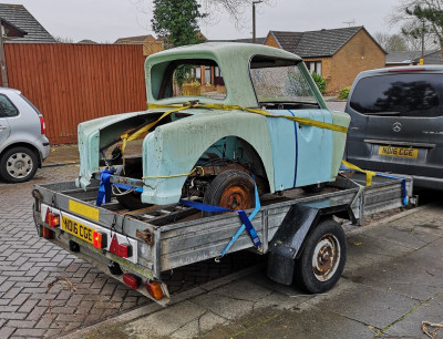

Now you mention it, I wonder if that's what mine was originally...I've no idea as it came with a toolbox full of random stuff many years ago.

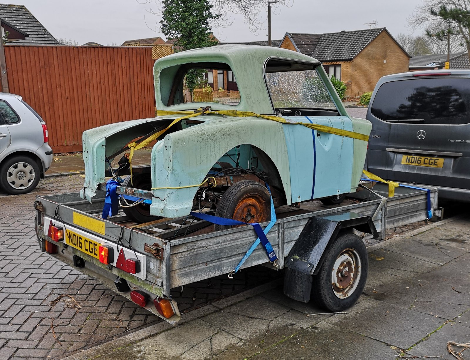

From my side I've now one less Invacar and a bunch of duplicate parts less here as KP is off to a new home.
Guy who has taken her on reckons he can get panels made through contacts he has, so is in a far better position to achieve success than I was.

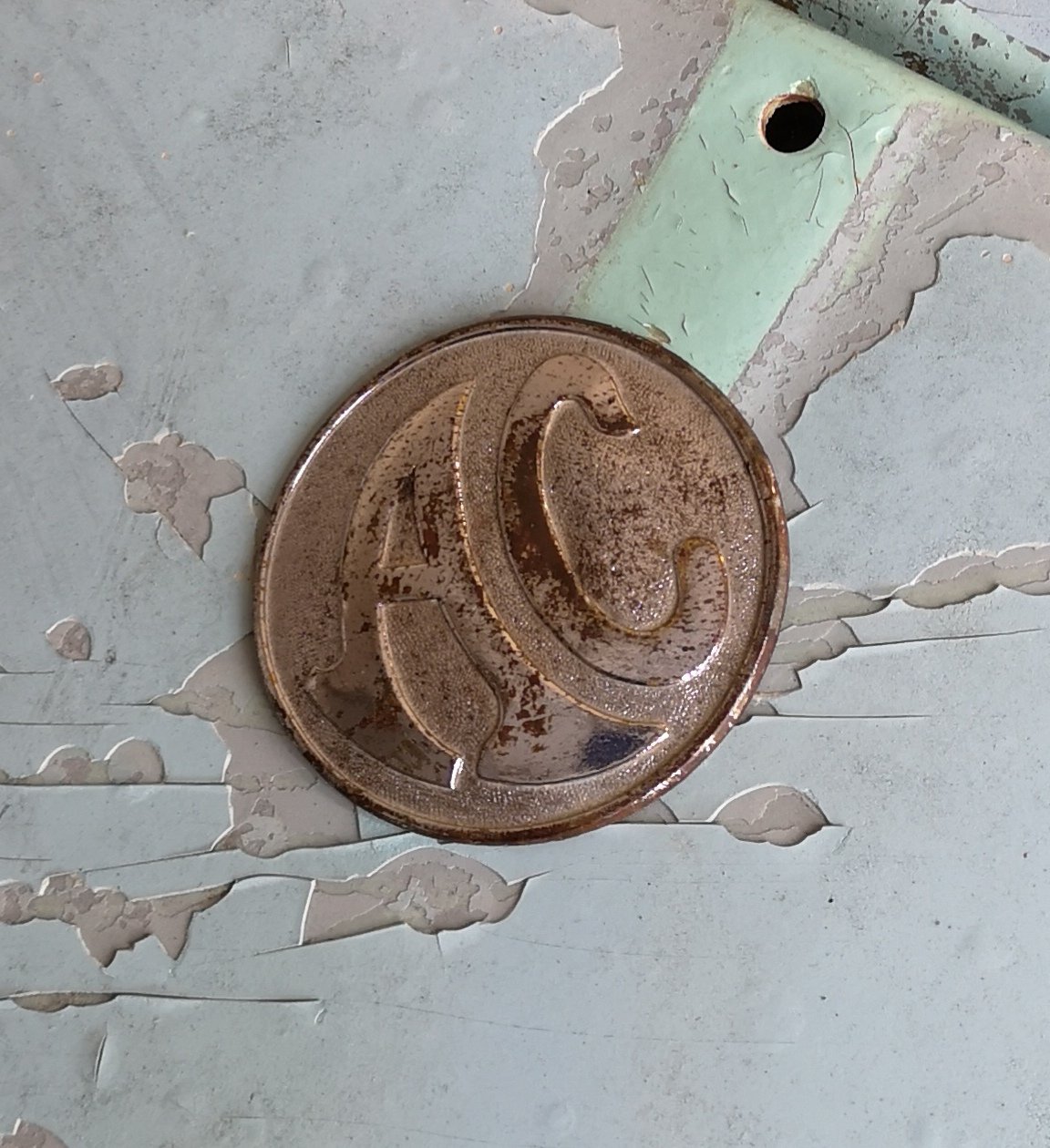

While digging through the boxes of Invacar bits I came across something very important, which I knew was safely stashed somewhere.
Will get that returned to the rightful place tomorrow.

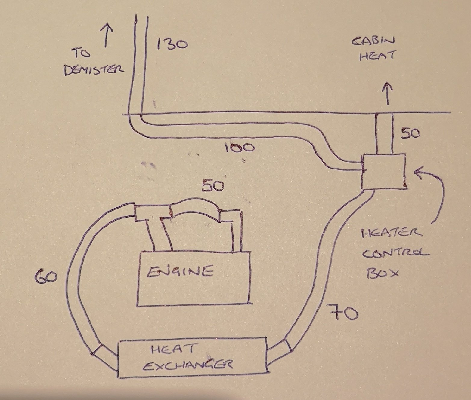

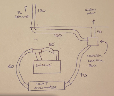

At the request of another owner I went out this afternoon and drew up a highly* precise diagram of the heater duct routing for the Invacar.
* Not actually at all precise beyond a resolution of about 10cm...purely intended as a guideline.
Measurements all in centimetres as that's what the measuring tape I was using was marked in... I'd normally have used feet. Though buying the ducting is by the metre, so all works out. Looks like I'll need 1.1 metres for the bit that's currently missing, so having ordered two should work just fine to give me a bit of extra spare.
