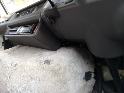

Cold has meant that productivity has been low. Only thing I've really managed was sorting out the wiring behind the stereo and slotting the engine cover back into the van.
Turns out it clips in a lot easier when you've not caught a bunch of wiring under the cover.

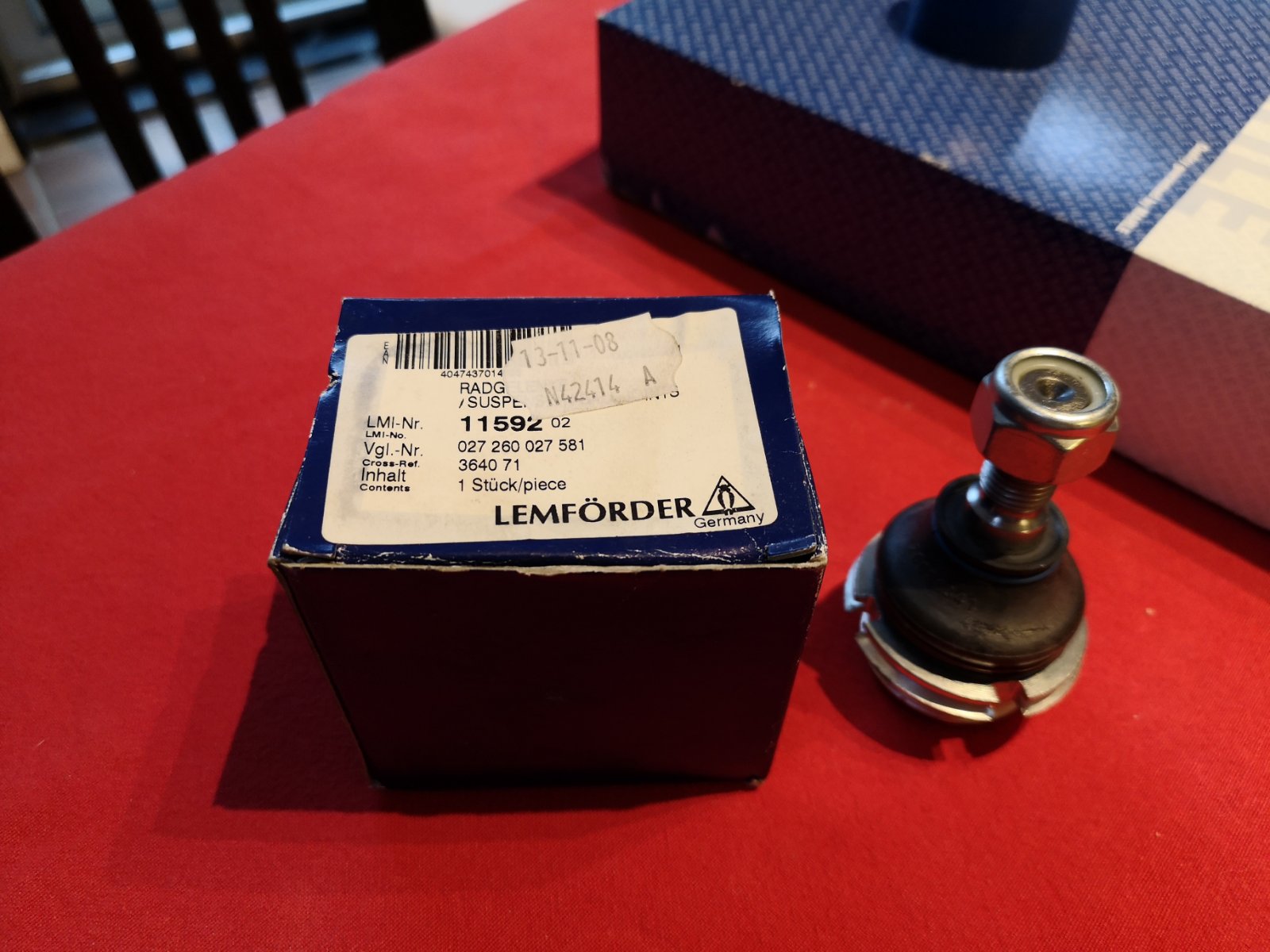

Can someone confirm that this is the correct part?
Edit: struggling to get the image to display for some reason.
We have a Lemforder part with the following numbers on the box.
LMI-NR 11592 02
Vgl-Nr 027 260 027 581
Cross-ref 3640 71.
With a paper sticker also reading
13-11-08
N42414 A
Though I'm guessing that's just a stocking label from wherever it was bought from.
Edit to my edit, poking Google suggests that this is indeed the right bit. Armed with this info I've now had it booked in to be sorted on Friday.

Unread post by RichardW »
I hope it relents easier than the one Mandrake and I did on his V6 last year!!
364071 appears to be the right part no for all Xantias so you should be good to go.
PS.... looks like it has failed on the B-J before in 2013, only 17k miles ago.... Might be worth getting a new heat shield as well - we looked last week and they were still listed as available.

RichardW wrote: 20 Nov 2018, 12:22 I hope it relents easier than the one Mandrake and I did on his V6 last year!!
Will double check that the shield is still there and intact...if they're still available probably worth grabbing a couple from Citroen anyway as we know what they're like! Anyone got a part number?
Worth noting that just before last year's MOT she was converted to V6 spec brakes, which will have hopefully reduced temperatures in that area somewhat...even though it is generally driven in a spirited manner. Let's face it... that's the whole point of the Activa isn't it!

Definitely get a pair of heat shields (they should also still be available), as they protect the ball joint. I will see if I have the number.
EDIT; Found it! 3623 06
