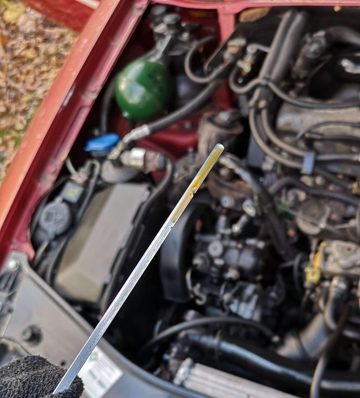

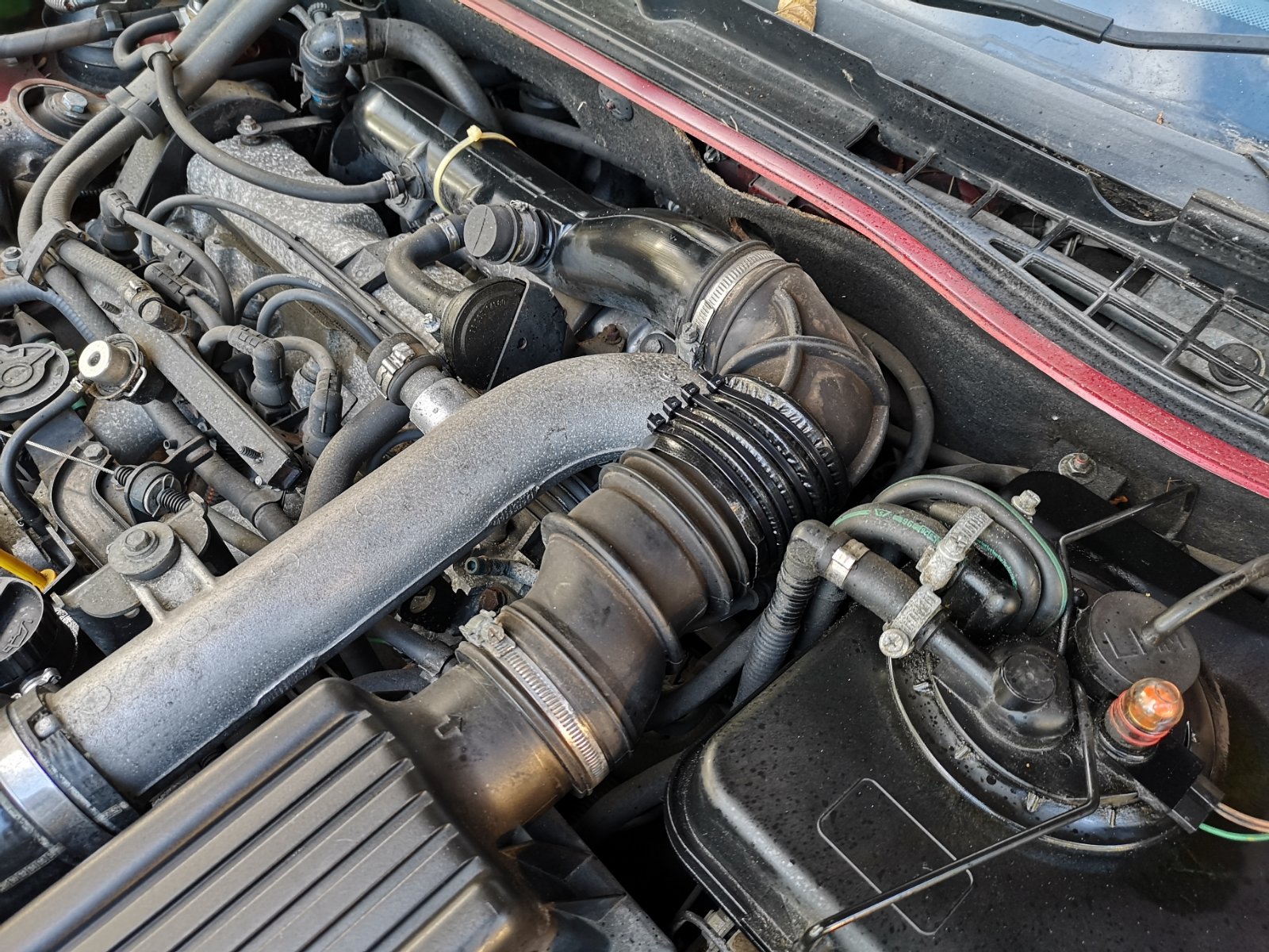

Okay...first off drain the oil, five minute job with no mess because I'm lazy and use a pump. Oil filter required 15 minutes of faffing around to get off simply because it's a royal pain to get at, even when you've already done it twice.
It would be easy if there wasn't a boost pipe in the way to the left and a million high pressure hydraulic lines to the right.
Once I convinced it to move it was a simple matter of spin it off, spill oil all over the front of the engine because it's mounted the wrong way up, and stick the new one on. Then fresh oil in, start up and check the level. Having measured what came out, this was where we were first try.
While I was in there I checked that the crankshaft pulley bolt hadn't unscrewed itself, it looked fine. So put the wheel arch liner back in.
Managed to snap one of the clips getting it out. I'll sort that shortly - liner ain't going anywhere as it is.
While giving things a wipe down (having managed to flick oil all over the place from the dipstick) I spotted something that obviously wasn't as it should be...

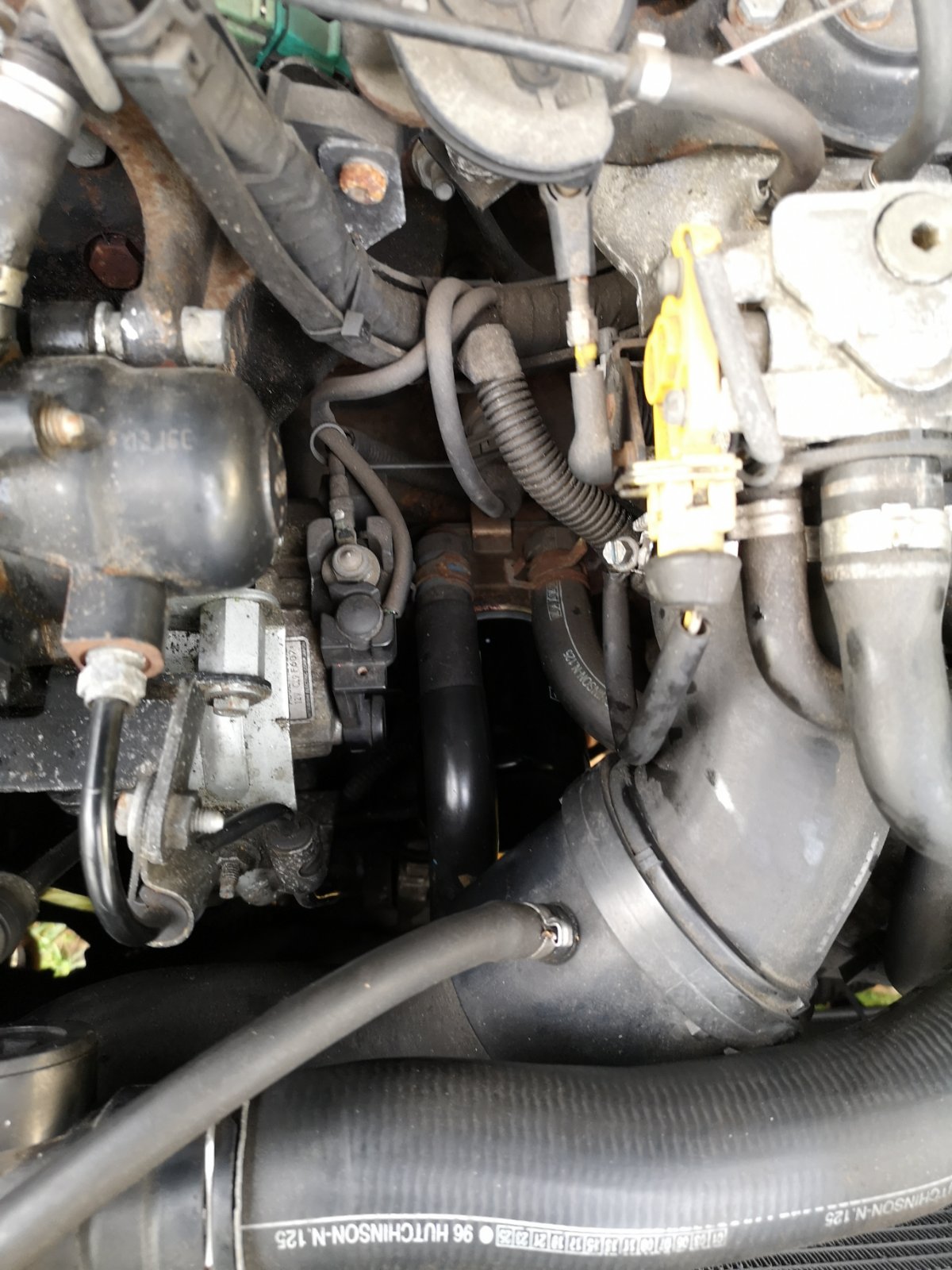

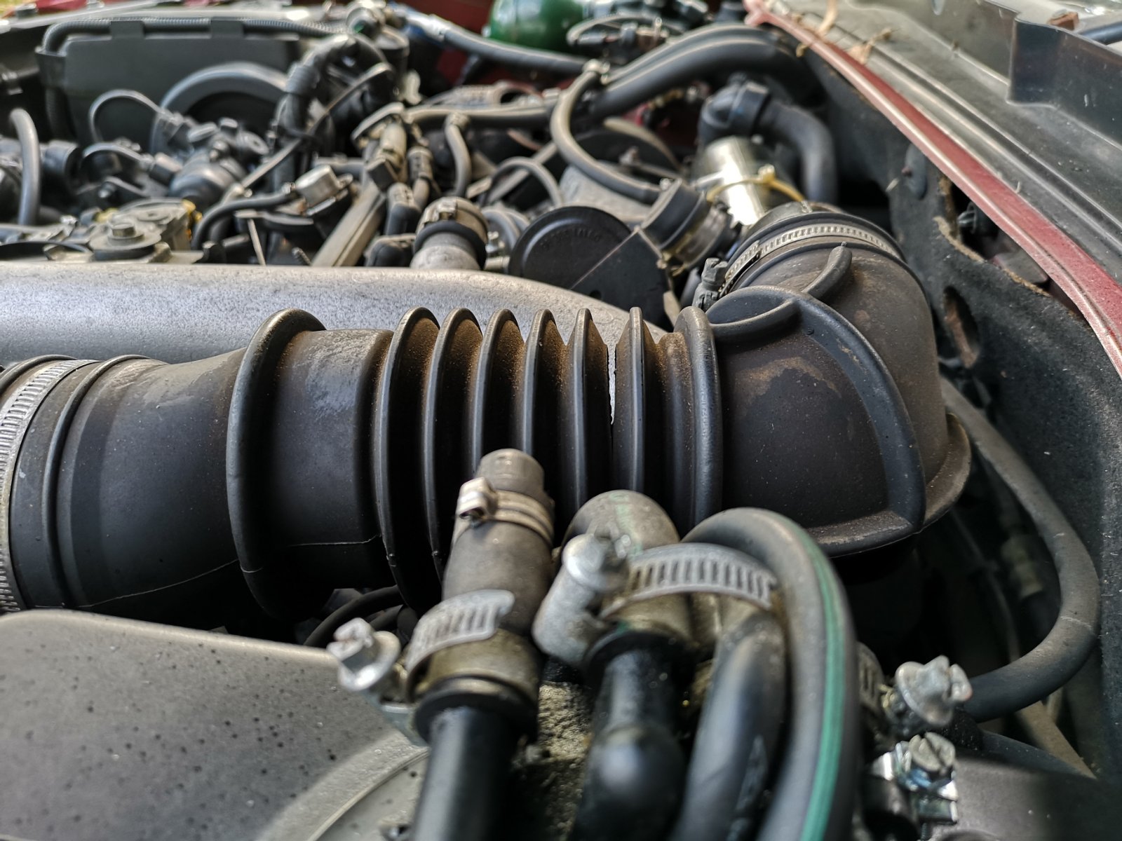

So *that* would be why a little while ago I suddenly started to be able to hear the turbo wastegate going *pssschooo* on every gearchange.
Nothing for it with a trip halfway up the country the following day, pulled it off, got some good quality duct tape in there and wrapped some cable ties around it so the tape can't unravel.
Better solution would have been self amalgamating tape, but I couldn't find it. So duct tape it is. The hose has gone very hard, so replacement is probably the only long term solution. It's basically just a glorified elbow though, so I'm sure a silicone replacement could be sorted easily enough (as knowing PSA the original hose will be long since NLA).

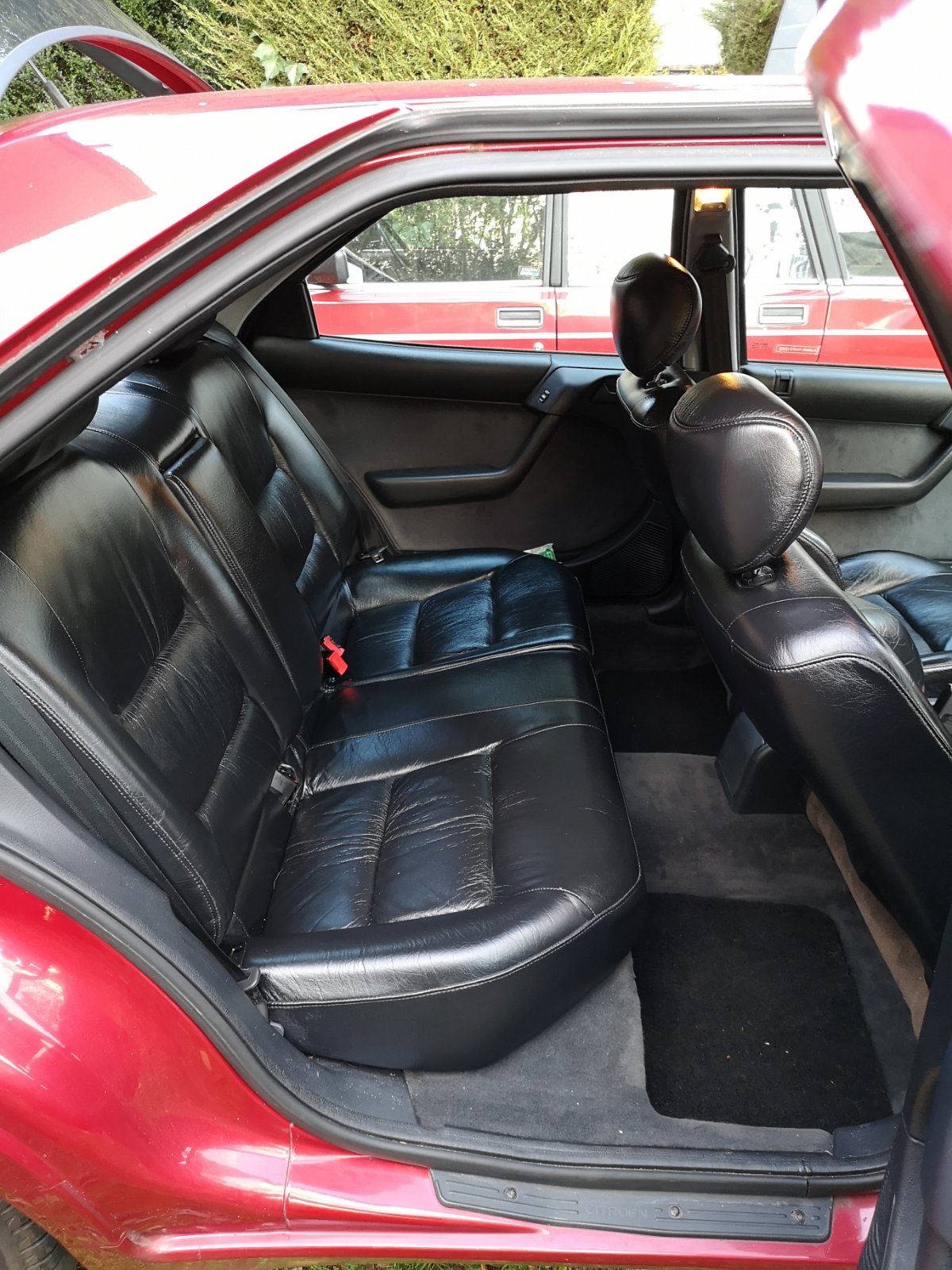

Last task for the day was to clear the detritus out of the boot and to give the leather a quick skim over with the leather conditioner.
Looks better.
Really need to get some new floor mats for the front.
If I've got to spend several hours stuck in a queue on the M6, I may as well do it in a clean car interior that smells nice.

Good work Zel and pleased the Activa was good on the trip
Those intake pipes splitting is now a very common problem and I believe they are like rocking gorse poo now... I may have one here...

Was sure I'd read on here about them splitting before.
Given it's essentially just an elbow with a stretchy bit in, hopefully it shouldn't be too massive a headache to find something off the shelf that will do the job given the tendency for the Motorsport enthusiasts to replace anything and everything made of rubber under their bonnets with silicone. Obviously I'd stick with black so it wouldn't stick out like a sore thumb.

A custom Silicone one would be a lasting and attractive replacement Zel... It's what I'd now go for...
Michel
Get a silicone one Zel, anything else is simply a false economy. They're all going to be nearly 20 years old and brittle. Both of my Activas had split ones. I found silver duct tape to be an effective fix.

To be honest, if I spent a bit more time on it I could do a tape repair that would be far less conspicuous - it really needs replacing long term though.
Interesting that it's the bit right next to the LHM pipes that has gone, wonder if that's got anything to do with it. Probably not...just 20+ years of flexing.

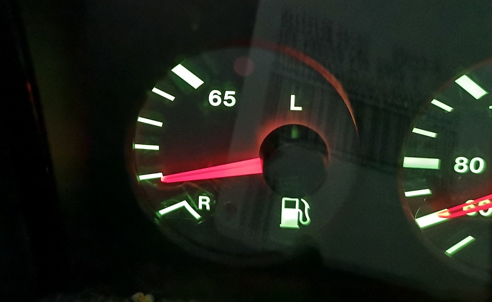

Oh, still reckon having this on the fuel gauge of the Activa after 370 miles ain't bad going given the usual thirst I see boosting it around Milton Keynes.

The fuel economy of a TCT Activa on a long run can be very good... I once got 39mpg out of one on a run from Dover to MK along a remarkably clear M2, M25 amd M1!!!

We made just over 32mpg on the way up here. Probably would have been a bit better if we hadn't got stuck in stop/start traffic at quite a few points on the way up.
