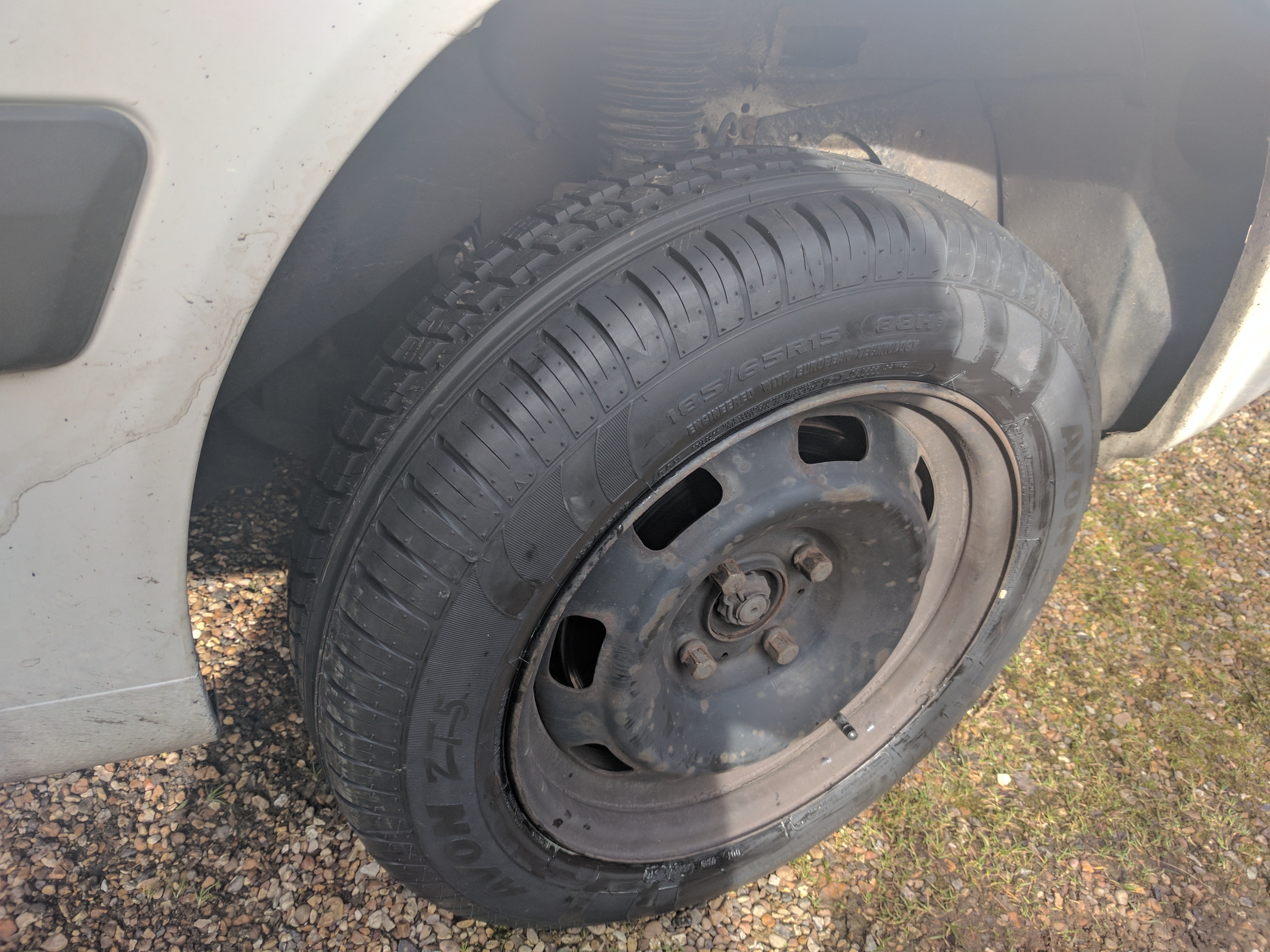

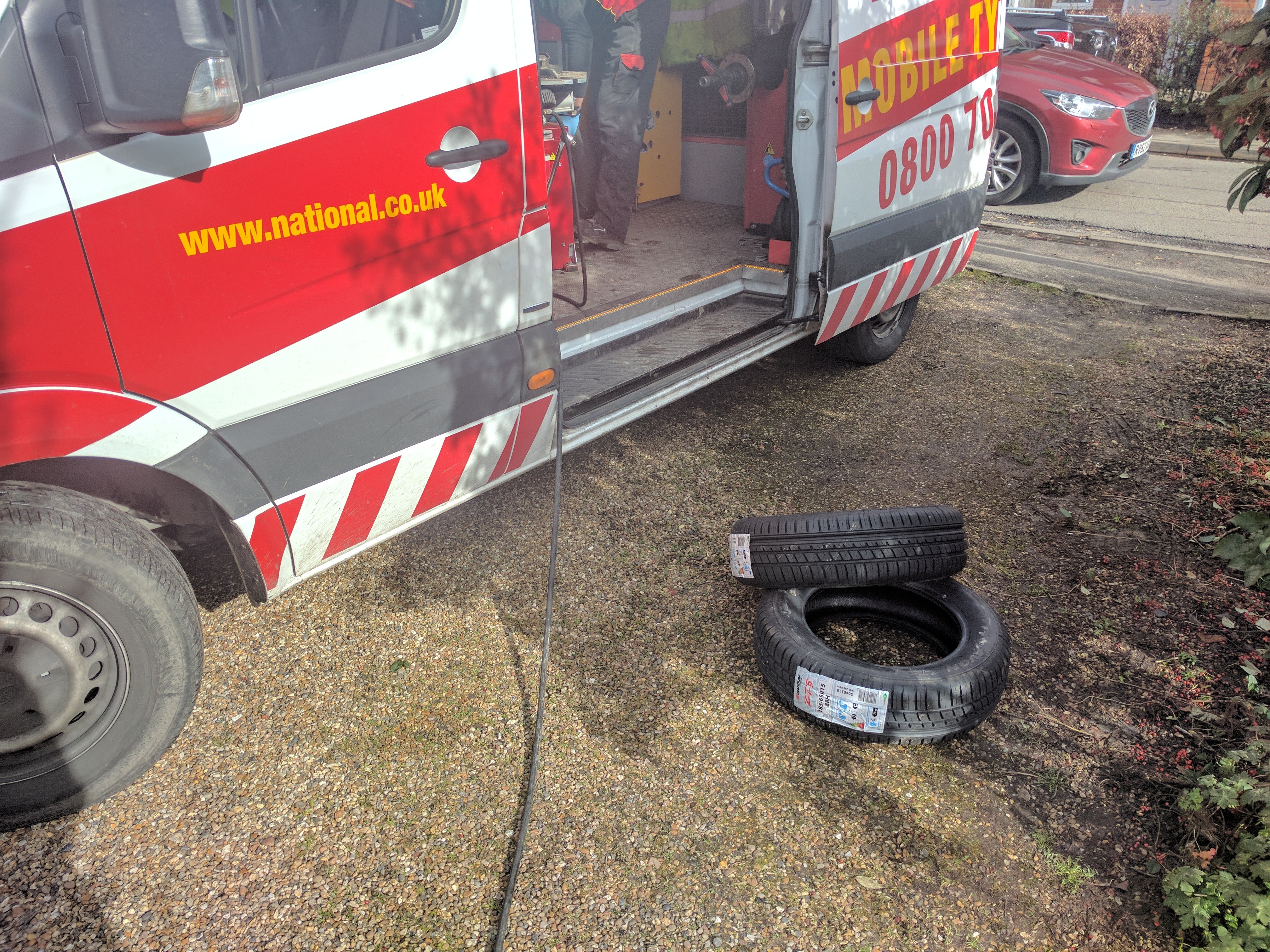

The tyre fairy came to visit today
and in under 15 minutes I had 2 new front tyres. Instant difference over the old tyres is the sidewall is so much firmer, even inflated to a few psi over standard the old tyres looked a bit flat.
He swore at the perished Mohawk, and when it was off he showed me how bad it was by pushing the perished bit out from inside and it opened up to the canvas. Meh, it didn't explode whilst driving...
He was, however, utterly thrilled to see a 'hydraulic' citroen! He said 99.9% of his work is on company cars, so he never sees anything interesting. I let him drop it down to normal and it made his day I think. Hopefully they send him out to do the rears next month, he was an ace chap. Seemed genuinely shocked when I explained the issues I've had and the work done, in my eyes it's part and parcel of owning an old, cheap car, he seemed very impressed that I did a cambelt change and engine re-time, fitted my own exhaust and other such bits. Different world!
Hopefully tonight I'll not have wheel shake or dodgy handling. I eyed up the ARB links with the wheels off too and their not broken, but properly crusty and perished, the rubber on the drivers side close to full collapse so I'll lob a pair on at some point just to say their changed.

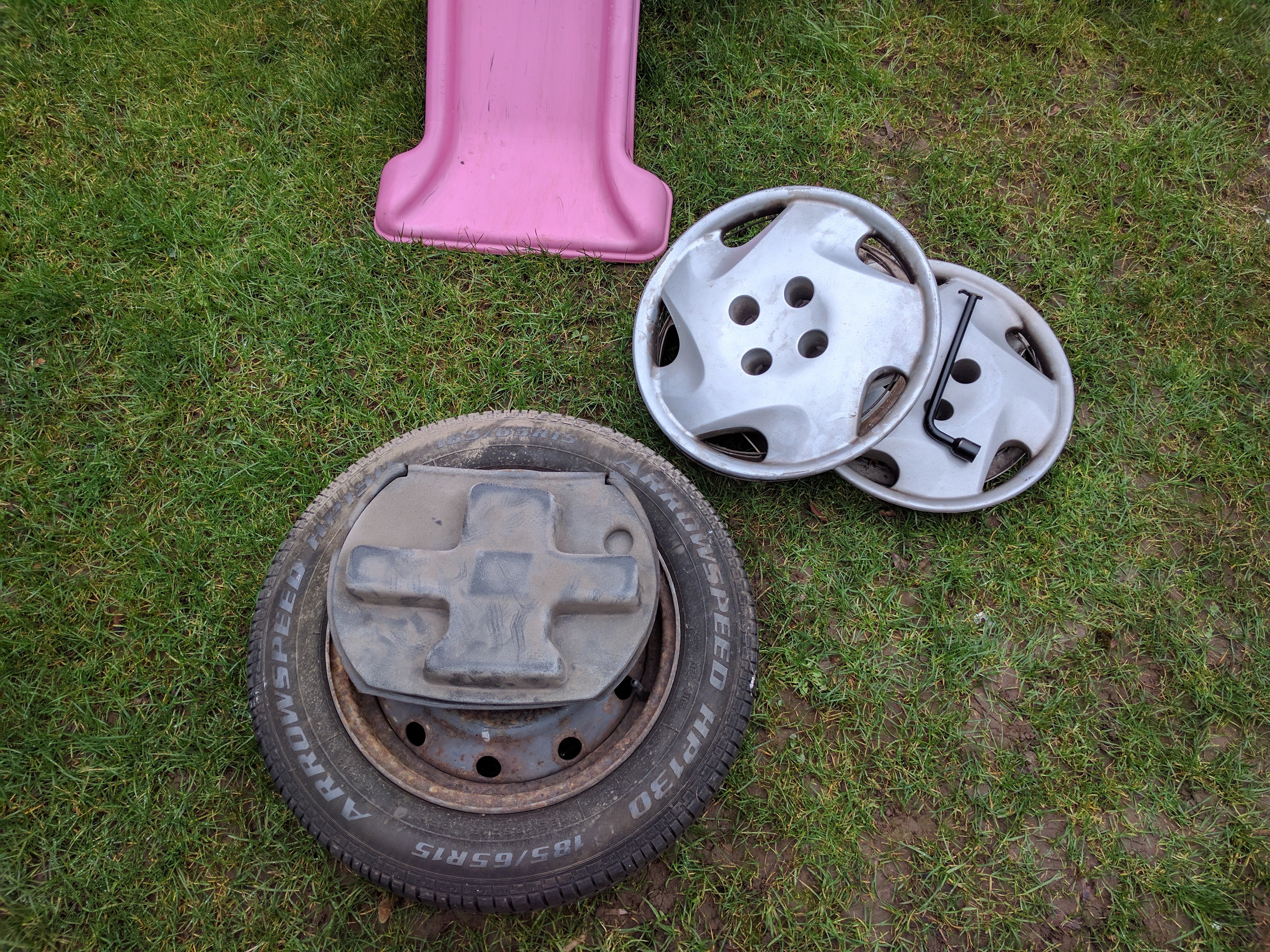

Hit post a bit soon on the previous one, the bloke we sold Amys old car to gave me some goodies from his scrap Xantia
I can't get the image to link, it worked fine in the post above... http://www.ultraimg.com/image/pivy if anyone wants a gander at some second hand spares lying on some grass...
4 nice wheel trims (he did say what they were called but I've forgotten)
1 decent spare wheel with an OK tyre on it (may change it, will see how flush I feel when I order up the rear tyres next month)
Jack and jack holder
Wheel brace/wheel holder un-doing thingy
The car can have a spare wheel again! (well, when I get round to fitting it, it's all sat in the garden at the moment...)
Ironically the bloke we sold the Meriva to only bought it as a cheap stop gap. He has a white 1.8 that has engine issues, it's running too rich and killed a new cat in 6 months. It also needs drop links. I said I would help him fix it, as he's an older chap, with muscle issues. He only bought the Meriva as the MOT was up on the 20th, and he knew he wouldn't be able to fix it but needed to get to work. I'll post up when I get over there to properly give him a hand, but what could make a petrol run so bad it kills a cat? Spark plugs or something less simple? He drove all the way over to my mums to hand me tools and give moral support when I did the clutch cable clip so I feel I owe him the favour back. He's offered me his front seats too to replace my pug seats, but tbh they are more ruined than the seats I have, although more comfy for the brief time I sat in it, maybe seat covers would help me there...

All the wheel shake is sorted up to 80,and the front end feels more planted! I didn't push it as its been raining and their not worn in, plus the backs are probably in worse condition than the old fronts were.
The jittery suspension is now more apparent. I must sort the rear height corrector out now so the back end sits right, and remove and strip it, then book a day with Jim to cast his magic eyes and ears over it so I can have a to do list to get on with.
