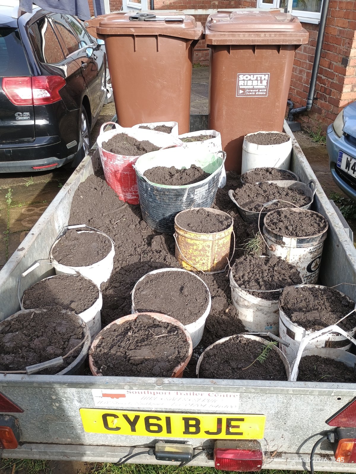

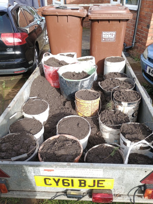

Unread post by MattBLancs »
CitroJim wrote: 21 Feb 2026, 05:34 Looks like you have plenty to keep you busy there Matt...
Busy, nah!
500kg of soil shifted today.
How do I know it's 500kg?
I measured it!

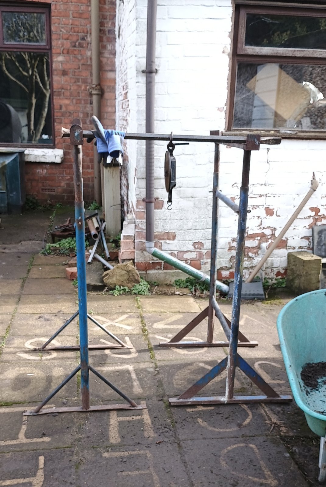

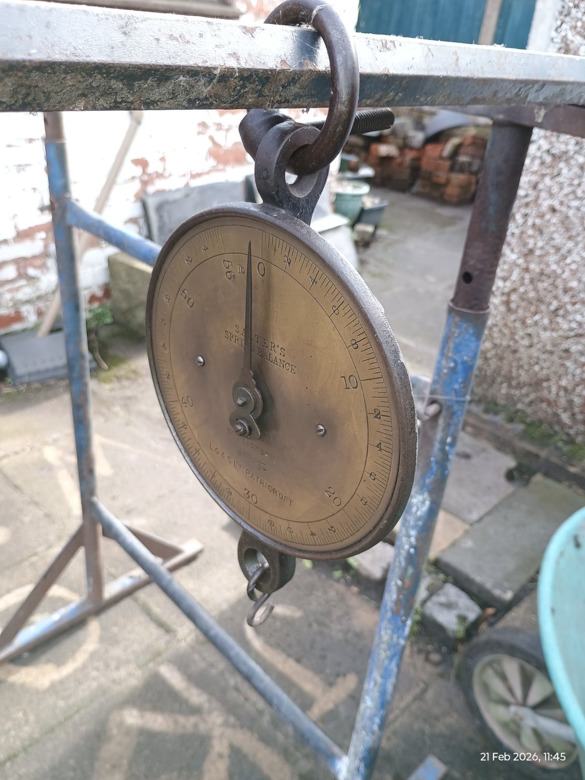

Spoiler: show
bucket weighing setup:
Why bother weighing?
Because last time this trailer was "filled with soil" I seriously underestimated how dense the clay soil is (and retrospective calc suggested it was over a tonne :shock: )
The trailer's frame, since replaced, did not take kindly to that treatment!

Well done for weighing the soil , and yes soil can be deceiving. A hole dug 3 x 3 x 3 would only take just under half to fill it back up , nice weight set up there

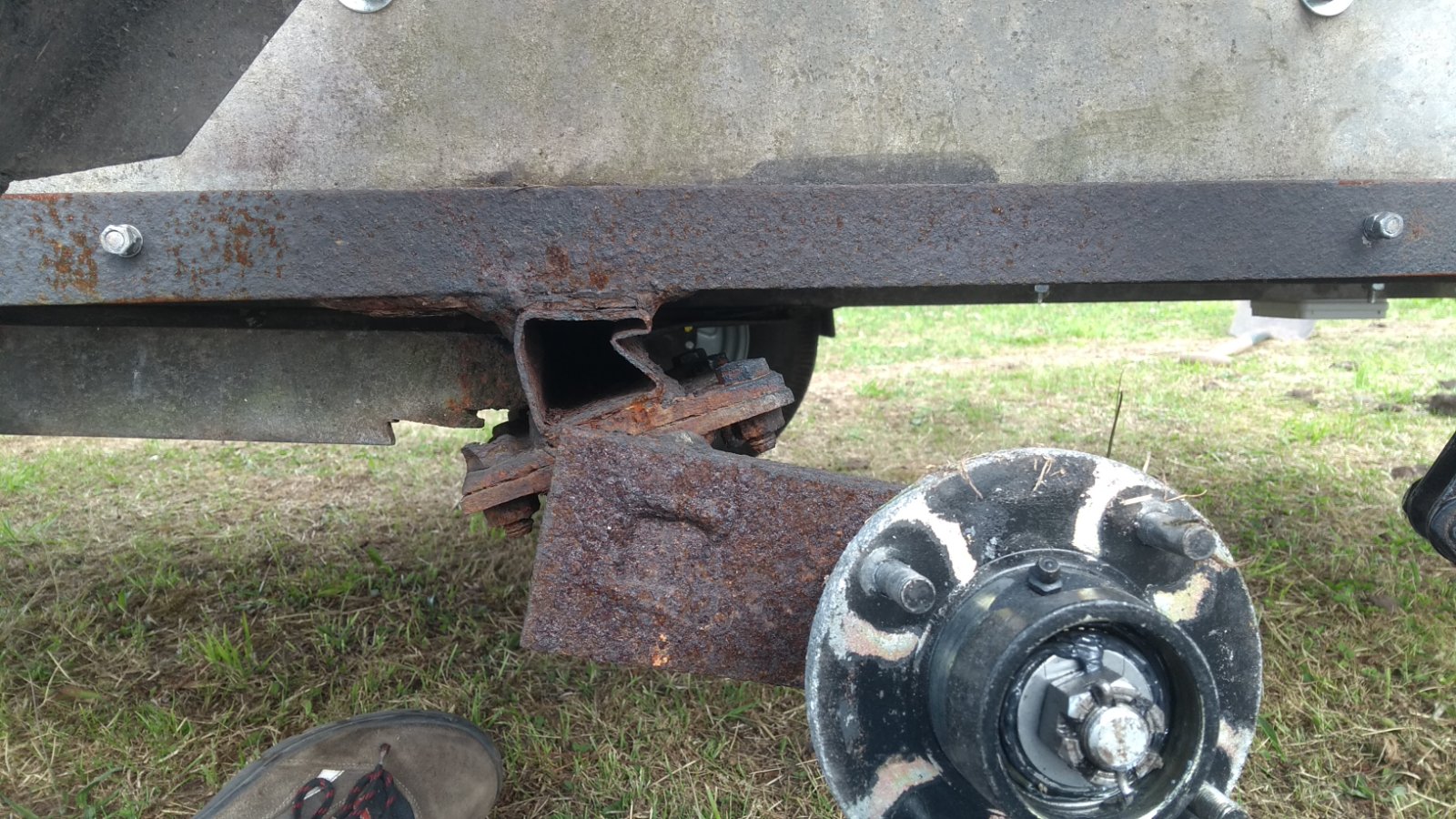

Trailer now again emptied of soil / mud **
In a word: knackered!
** We'd plenty of rain mid afternoon onwards yesterday and more overnight. Despite tarpaulins over the trailer contents they'd took on some water. Quite muddy in several of the buckets and bottom of the trailer too!

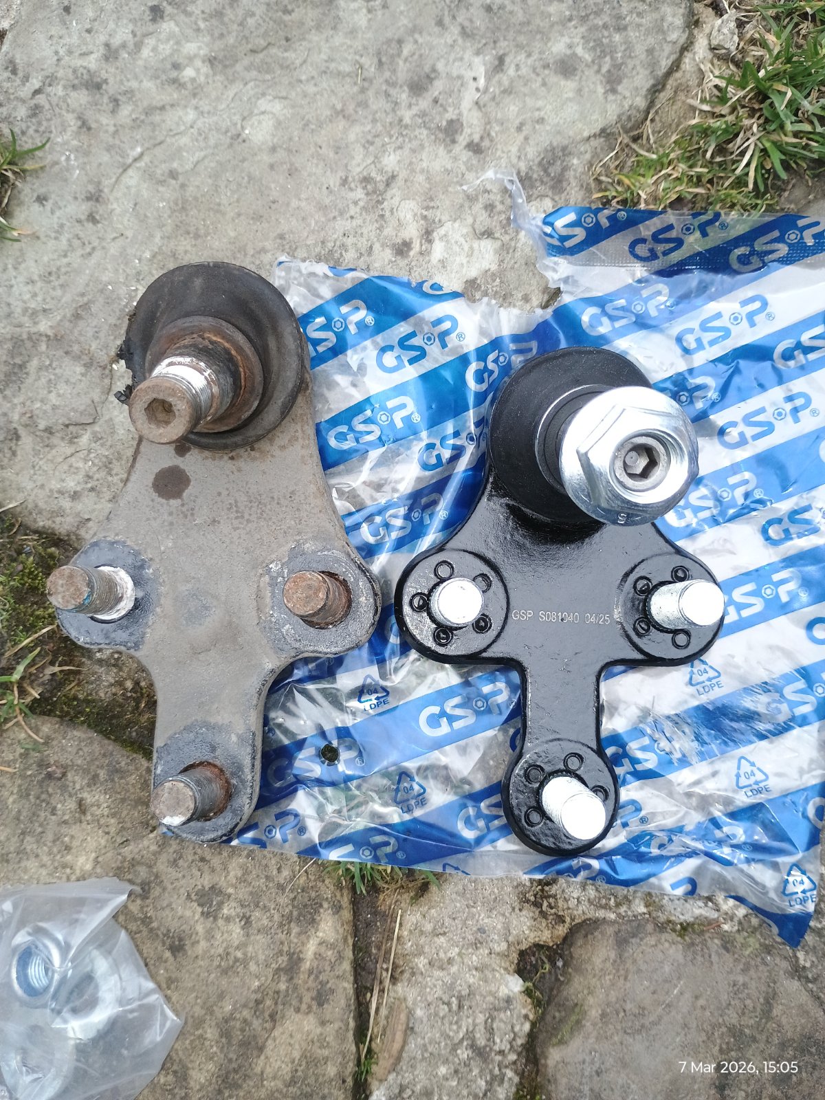

It was all going so well!
Spot the difference, level 1, Beginner
Posts: 21017
x 8073
Derrr!! The smaller one has a nut on it!! :-D

Is the new one designed for a short wheelbase model ? :-D

Narrower!
Seems the fun I had when I got these wishbones:
viewtopic.php?p=808583#p808583
And in detail, here:
viewtopic.php?p=808586#p808586
Was nothing to do with the wishbones, or rather the only difference is the bolted on bottom ball joint is the length difference!

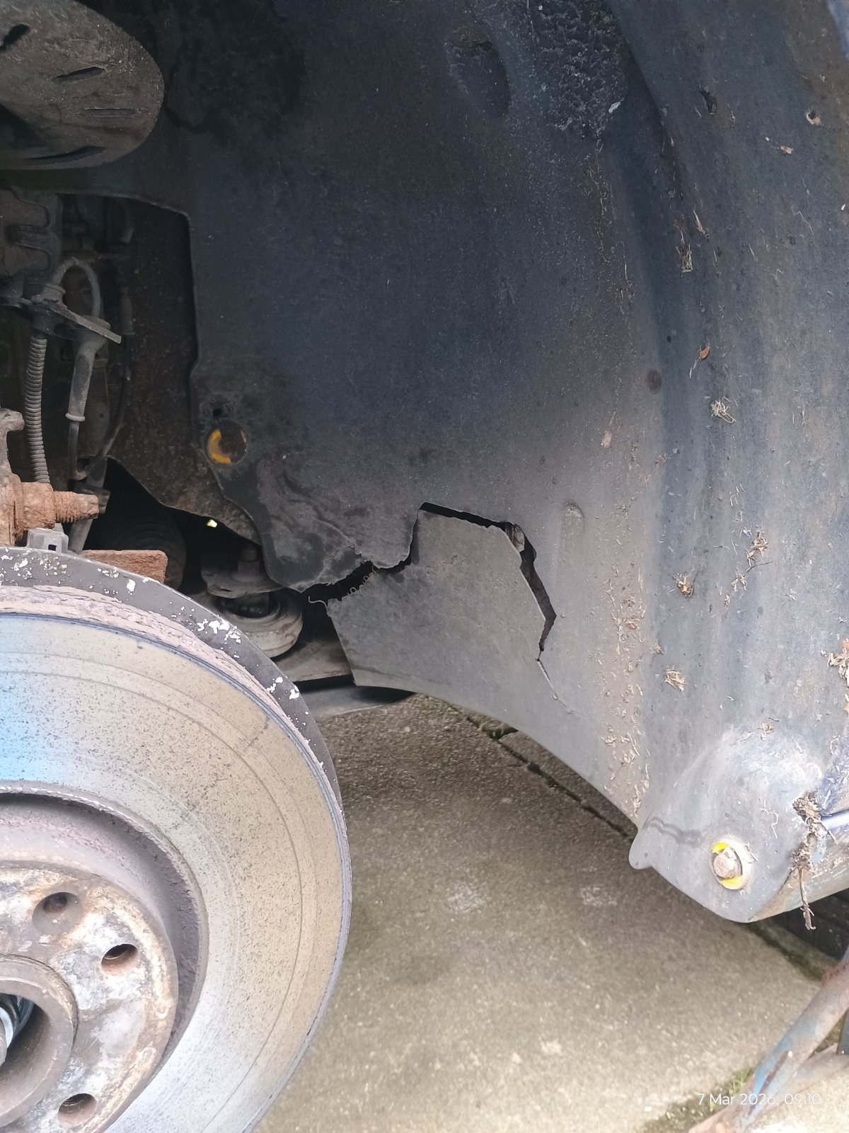

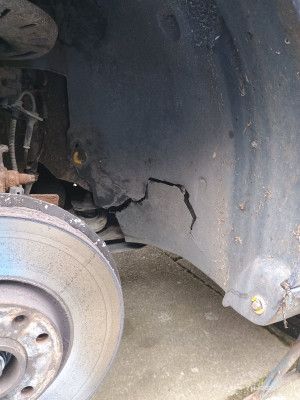

Few pictures, will add waffle tomorrow:
Arch liner.
Existing item, hot stapled but failed again. Too brittle

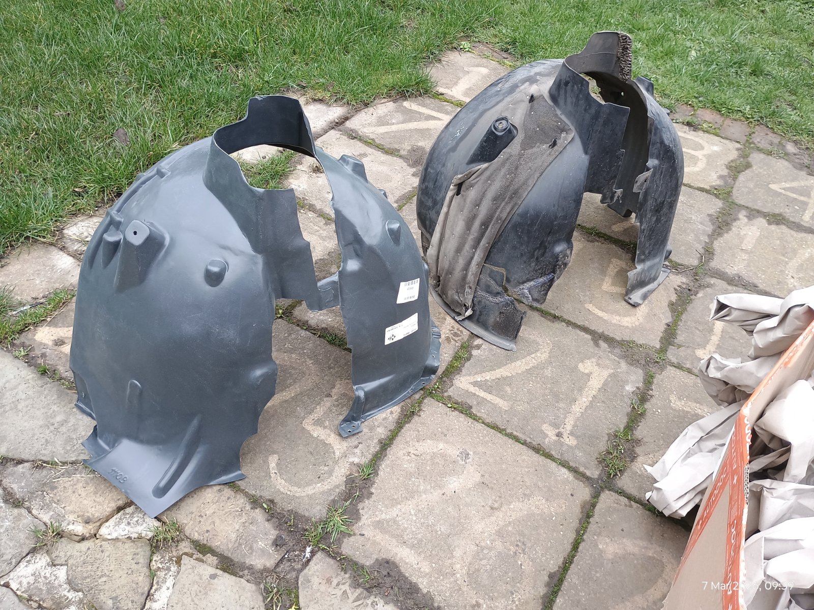

New liner, Autodoc. About £25. Not sure how durable it'll prove to be. Definitely more pliable than the ten year old brittle item it's replacing but very thin.
Original has a fabric acoustic mud collector fasten to it, no provision to mount that in the new but will live without it.
Need to transfer the fixings across (well, ideally source new ones but that's for another day)
New and old
New and old
