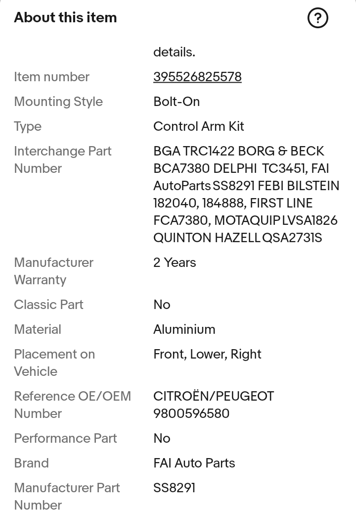

Unread post by MattBLancs »
MattBLancs wrote: 05 Aug 2024, 15:16 They reckon the arms are longer,
Difficult to find any figures!
eBay advert for what I've put on says:
FAI Front Lower Right Track Control Arm Fits Peugeot 308 2013 - 2022
From eBay advert
From eBay advert
Vehicle
PEUGEOT 308 SW II (LC_, LJ_, LR_, LX_, L4_) 2.0 BlueHDi 150
Body
Estate
Fuel
Diesel
03/2014 06/2021
Drive: FWD
Valves: 16
BHP: 150
KW: 110
Fitting Position: Front Axle Right; Fitting Position: Lower
Autodoc has a range of lower arms, most without any dimension data, only ones (other than package sizes!!) with anything useful, suggests
Alloy:
length: 384mm
RIDEX Suspension arm in the AUTODOC app https://m.autodoc.co.uk/ridex/14760066
Steel:
length: 366
TRISCAN Suspension arm in the AUTODOC app https://m.autodoc.co.uk/triscan/12830733
Can't find any more to compare, but above suggests 18mm extra length per arm.
