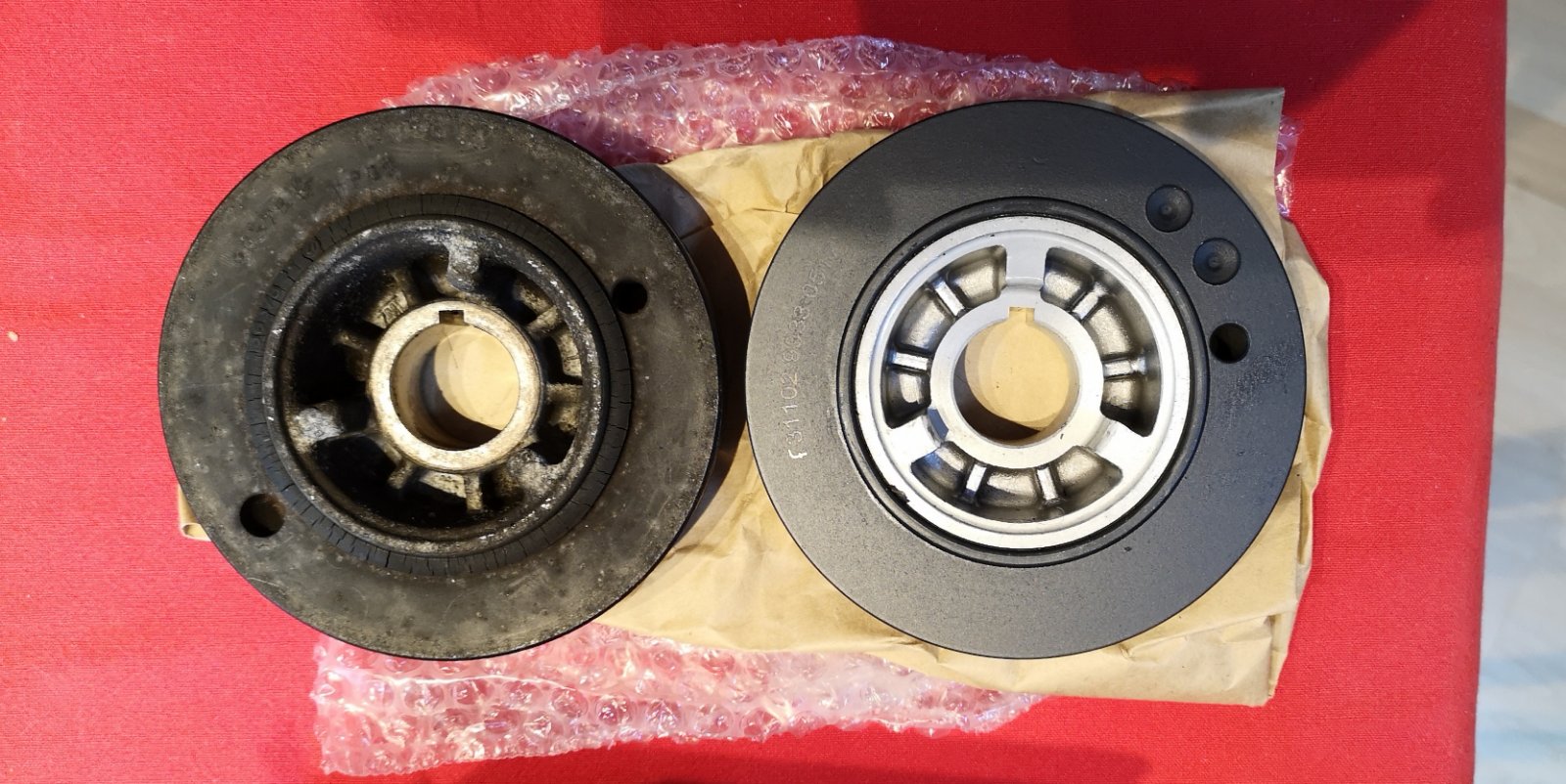

Stupid question of the day before I make an idiot of myself:
Is the bolt a normal or reverse thread?
Current fleet:
- Posts: 55178
- x 8439
Normal
It'll be reassuringly tight... Use a dab of Loctite on the thread on reassembly...
Zelandeth
- Posts: 5328
- Joined: 16 Nov 2014, 23:36
- x 1607
Thanks, knowing that for certain before starting is a definite help!

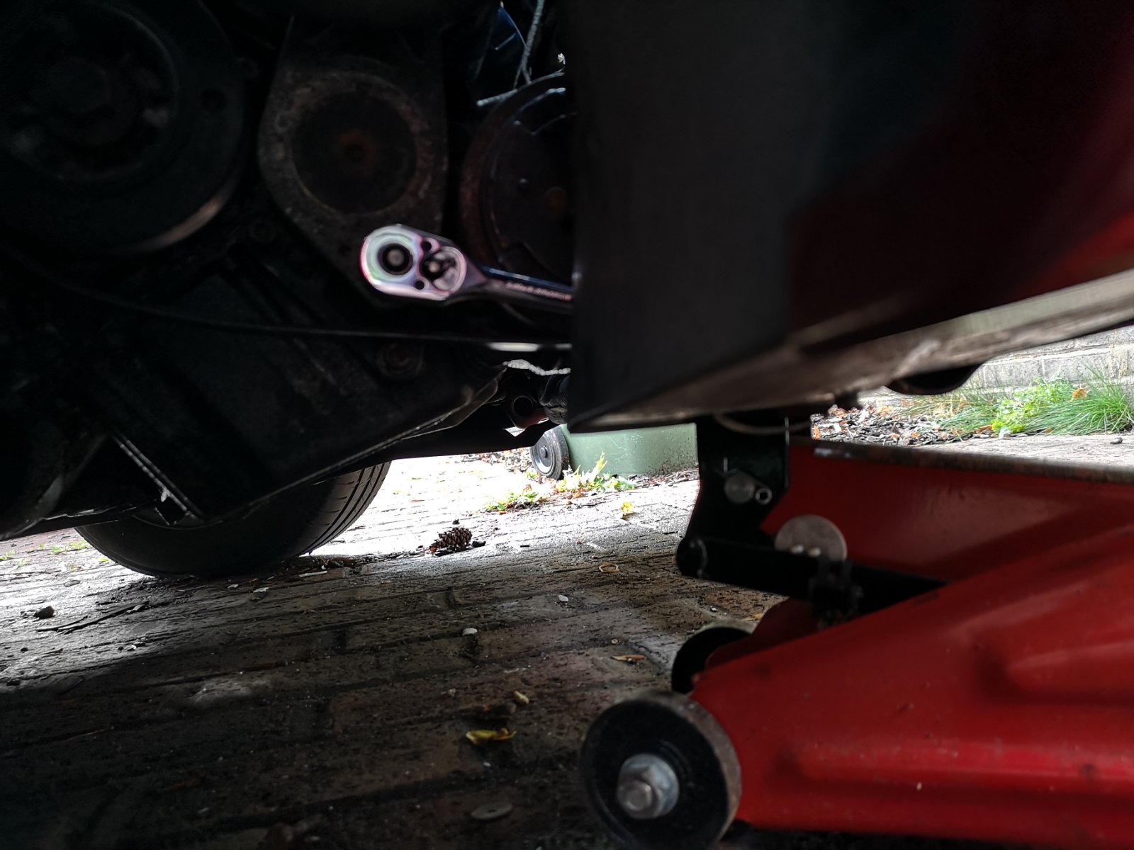

This has become my default method of releasing the belt tension...
Way easier than on the XUD as the tensioner is readily accessible.
Old pulley came off without too much fuss (I really need to get a long extension so the breaker bar is easier to use in such settings).

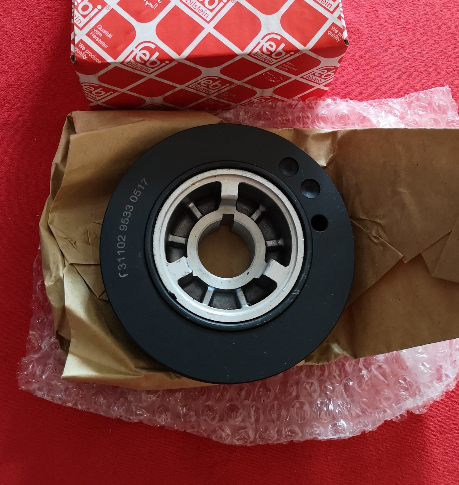

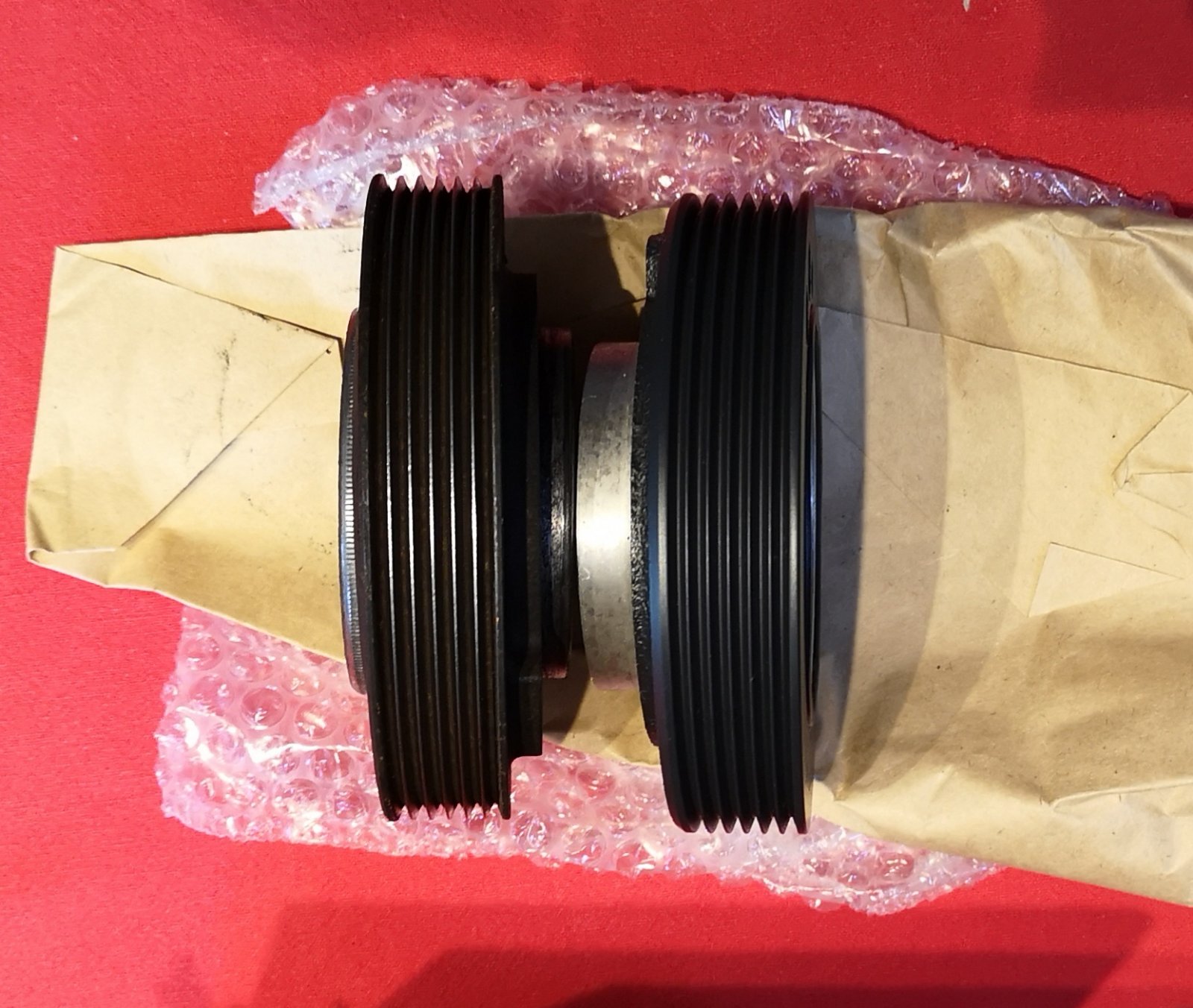

The outer has rotated slightly as evidenced by the timing hole, but not as massively as some I've seen...
However looking at the edge reveals quite how knackered it really is compared to the new one.
That definitely won't have been helping anything.

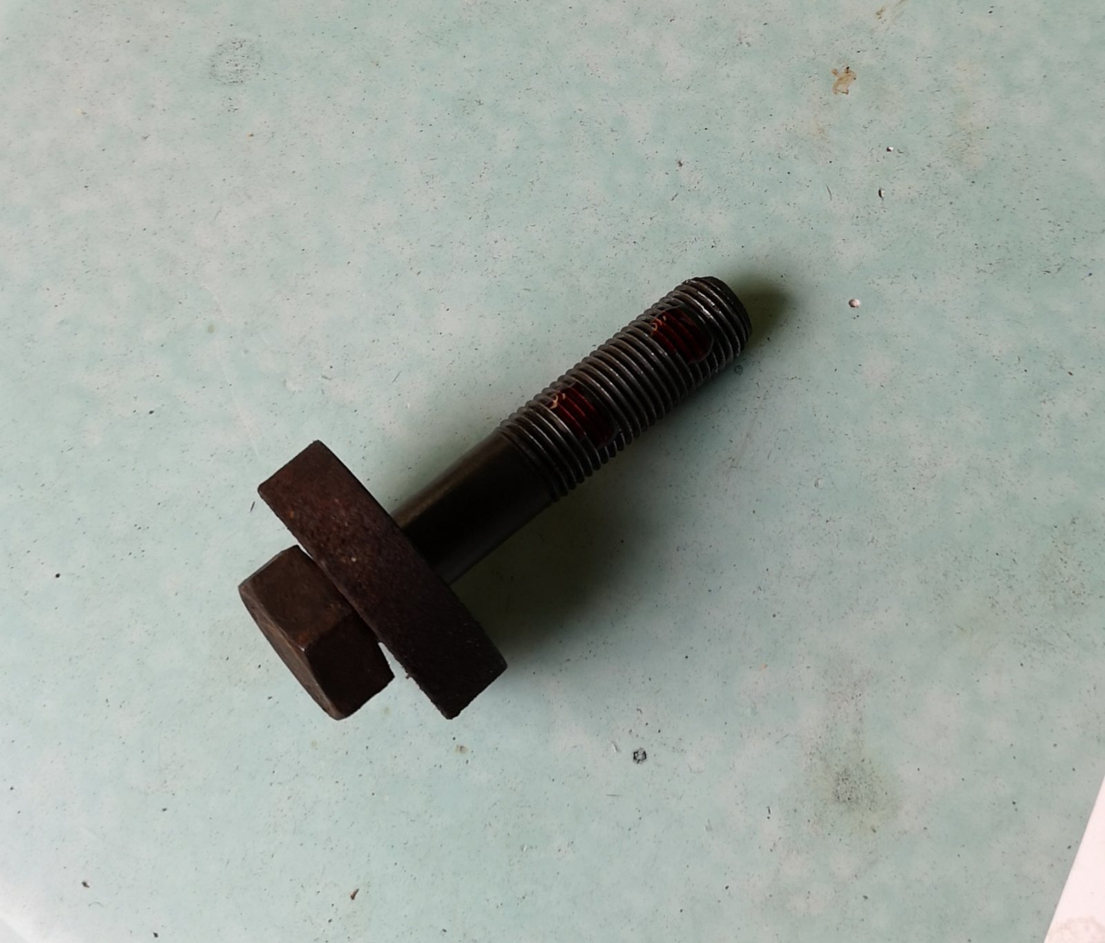

Bolt given a quick wipe down before a couple of drops of fresh thread lock were added...
Before slotting the new pulley into place and bolting it up.

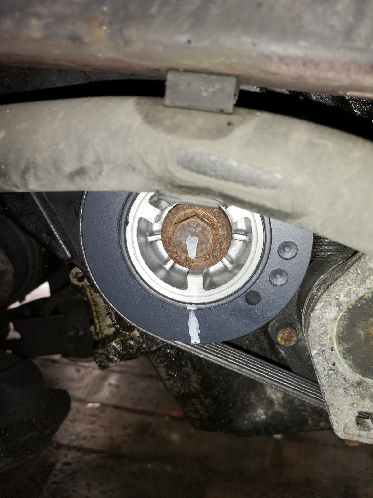

I've marked the bolt and face with a paint marker so I can keep an eye on it for a week or so to make sure it is indeed not unscrewing itself, then I'll put the wheel arch liner back in.

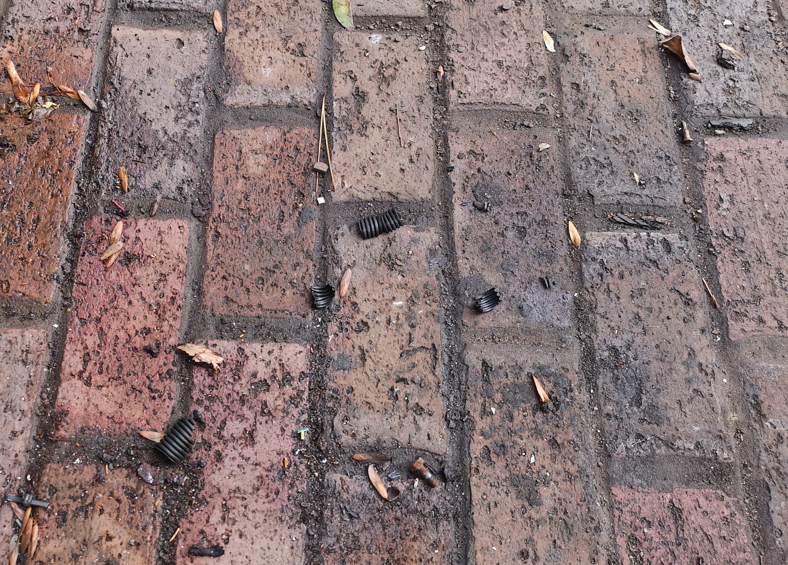

It wouldn't be a job on a Xantia without leaving some shattered bits of conduit behind would it...
The belt now does appear to be running true again. It does seem a bit noisy though, in the same breath though it's a brand new belt and the battery is quite low, so the alternator will be pulling a lot of power from the belt. I'll keep an eye on it for a few days and see how it goes - being honest I'm probably just being overly suspicious.

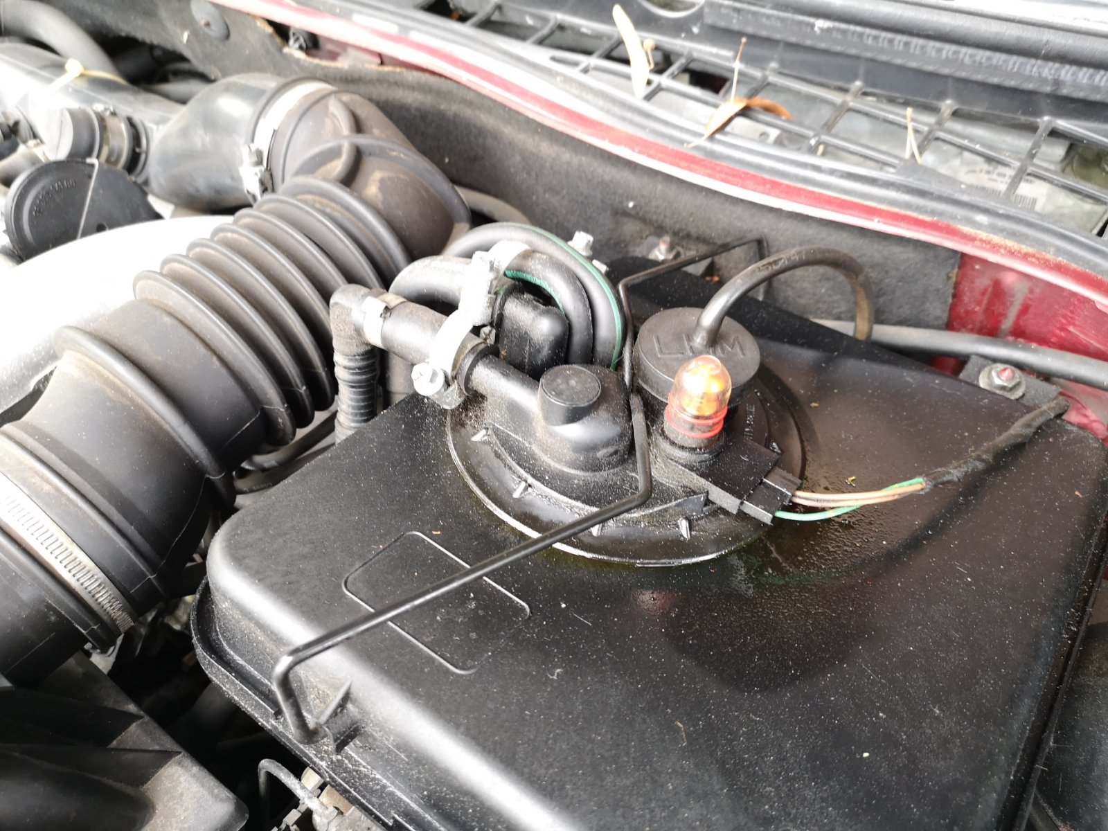

Next task is going to be going after the LHM tank top with some good quality hose clips. I know I've got a bit of a fluid aeration issue, and one of the returns obviously weeps a bit as the top of the tank always looks like this a few days after it's cleaned.
Hopefully a new set of hose clips will solve both of these issues.

The puddle of LHM on top of the tank is usually caused by the spring bar that holds the lid on the tank deforming the tank so that there is a gap under the rubber sealing ring, and the LHM just splashes out when cornering and braking. I have had 80% success rate of fixing this by applying a bead of a suitable silicone sealant to the underside of the rubber ring.
- Posts: 55178
- x 8439
xantia_v6 wrote: 17 Oct 2018, 17:28 I have had 80% success rate of fixing this by applying a bead of a suitable silicone sealant to the underside of the rubber ring.
But choose your sealant carefully as many are not LHM-proof and rot spectacularly into a gooey mess

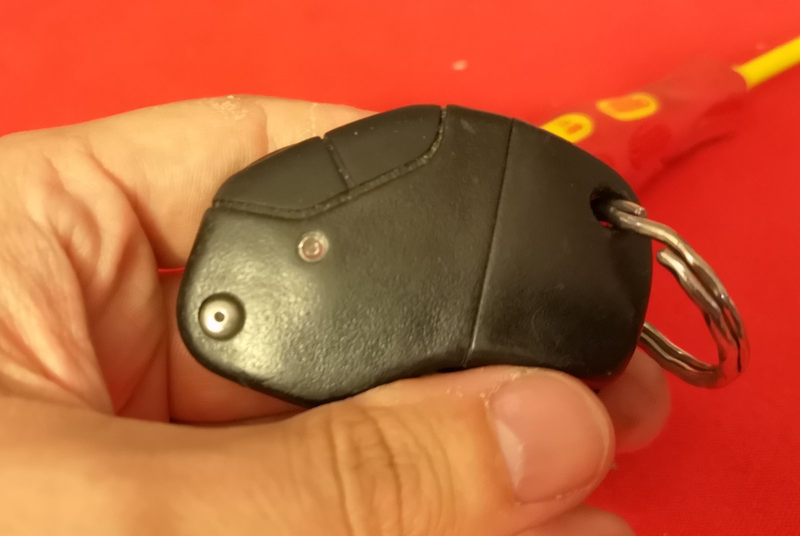

Oh, and fixed this, which has been on the to do list since about May.
Took all of 30 seconds to do...
