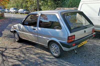

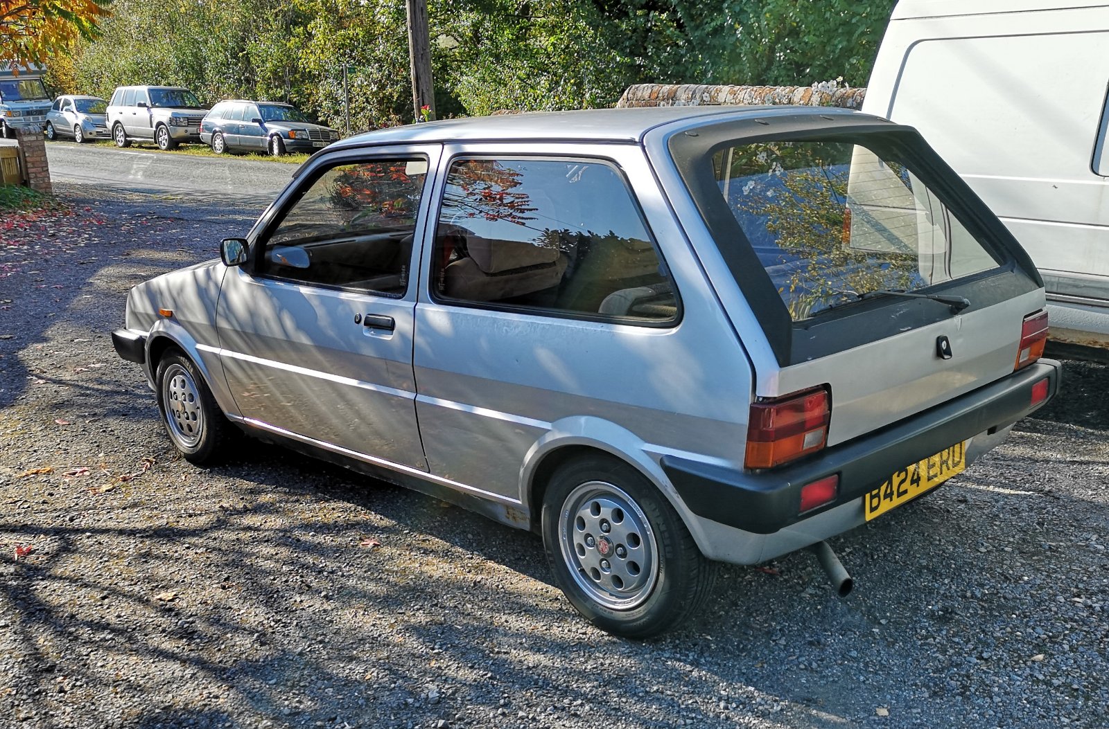

Got to take this out for a spin today...
It's a good 15 years since I last drove one, and I was prepared to find that the driving experience had filled somewhat compared to my memory in that time. Nope...still just as I remember. Only differences in this case being due to that one being a few years newer and higher specced than mine. At 1984 this was one of the last Mk I Metros. Main difference that was obvious? The gearbox is waaaaaaay quieter than mine was.
Still feels like you're sitting in a go kart and changes direction in a way only the Activa can challenge.
For all they took a lot of stick for trying to be a replacement for the Mini and some typically BL build quality issues, they were fun little things to drive. Provided you're no taller than me anyway!
Until a couple of days ago when the leak finally got worse when it decided to go through half a reservoir in a day. This meant that I could find the leak at least, the offside front caliper has become incontinent.
I'm not going to faff around trying to sort that. Based on my knowledge of Lada parts pricing, a pair of new calipers for the front will be on order soon to resolve that issue. The brakes have never felt the best (even by Lada standards) so not a bad idea anyhow. Have already got a full set of flexible hoses for it on hand too, so may as well do the lot at once.

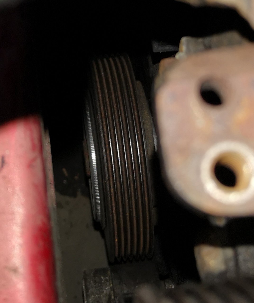

Have also started looking into the belt issue I've had with the Activa, which looks to be down to a stuffed crankshaft pulley - a first in my fleet - so shouldn't be a tough fix.
... especially once I had the brainwave of sticking my trolley jack under the driver I was using to hold the tensioner off. Made routing the belt actually easy. So hopefully it will be back on the road in the next couple of days.

Zelandeth wrote: 13 Oct 2018, 23:43 Have also started looking into the belt issue I've had with the Activa, which looks to be down to a stuffed crankshaft pulley - a first in my fleet - so shouldn't be a tough fix.
Did the rubber bit between the inner and outer annuli break up Zel?
Are they still available new or are you having to look at having the old one refurbished?

That's my current theory. The belt is running out of true and off the inboard end of the pulley on the alternator and hydraulic pump. It looks like the outer part of the crankshaft pulley has shifted and that's what's pulling it to one side.
I'll pull it off as soon as I get a chance and take a closer look.
At least the belt is a million times easier to get on/off than on an XUD as the tensioner is easy to get to.

TCT pulleys are well-known for this Zel, which is why the timing hole on the outer annulus is never to be trusted... I have a solid pulley for this purpose but unfortunately it is no good for regular use as it can only take a 3PK belt...

No worries, a new one is on the way.
Really can't complain - aside from routine service consumables this is the only attention she's needed in nearly a full year and 5000 plus miles. It's impossible to complain at that.
The pulley has probably been going for a while, may even be why the original one squeaked at idle when I got the car for all I know.

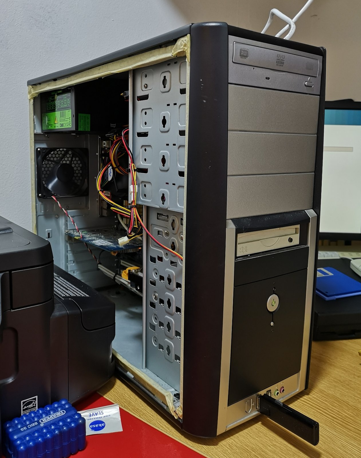

Yesterday evening and this morning I distracted myself with this.
I have history with this machine. I built it back in 2008 or 9, and it's the one lemon I've ever created. It's just always refused to run stably, with Windows randomly blue screening with utterly unhelpful stop codes which basically translated to "something unspecified went wrong with a driver." Eventually it got stuffed in a corner when a new laptop replaced it.
Basically everything save for the motherboard and CPU had been robbed from it over the intervening couple of years, so it was reassembled using random bits and pieces I had laying around.
It's been running for nearly 24 hours now with everything flat out and hasn't fallen over yet... we'll see if it's actually sorted I guess. If it will behave, it's actually slightly more powerful than my current desktop I think, so some part swapping might then happen...
