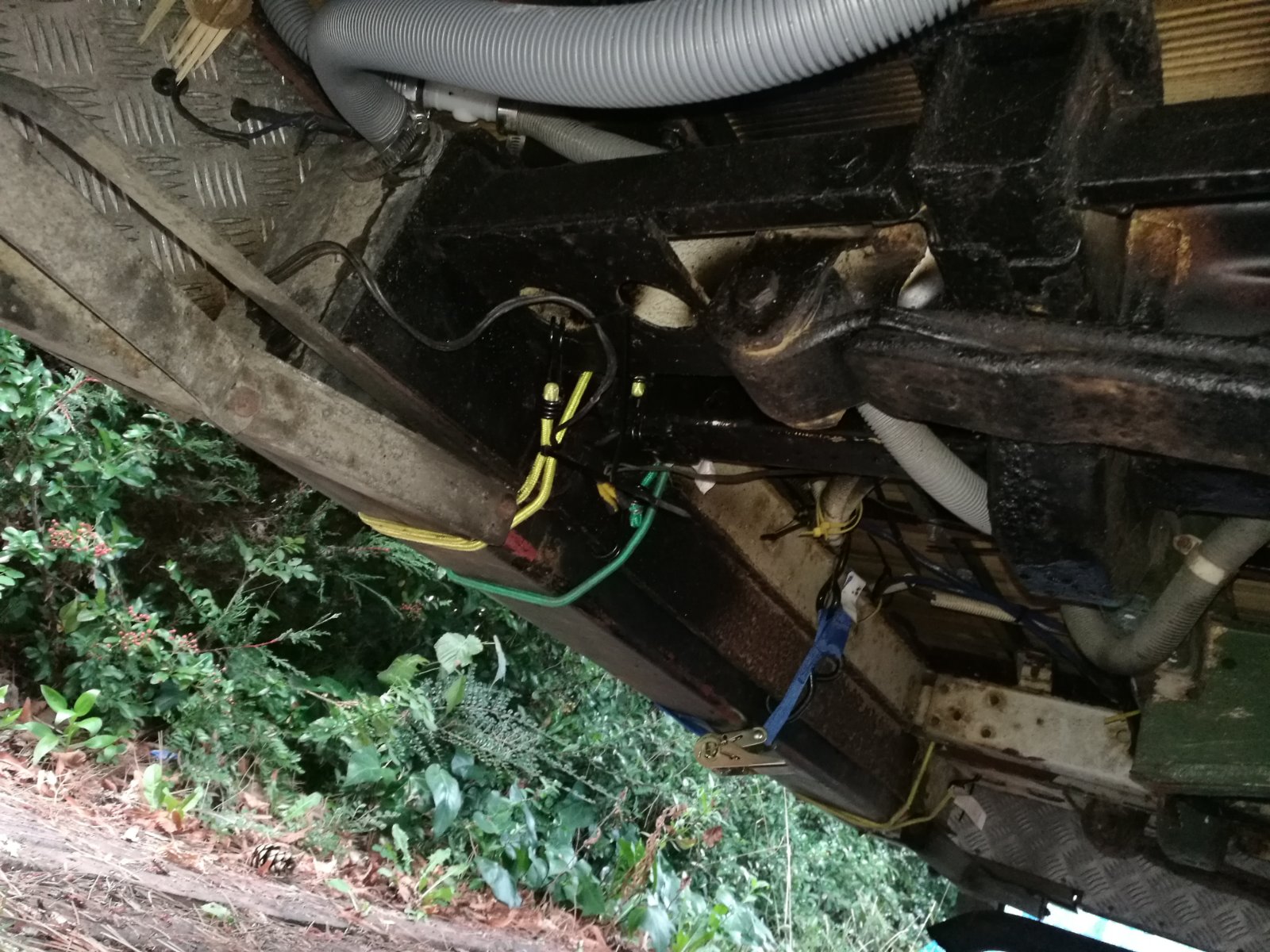

The fresh water tank has been refitted to the van and plumbed in.
The attachment is currently temporary - bungee cords and a ratchet strap - as I will want to take it off again soon to paint the area above it. Plus it won't have water in when on the move anyhow so I'm not worried about it going anywhere.
Slight weep from the fill hose connection, but it's otherwise behaving. It's currently filled with a system cleaner to be left to sit overnight. I've also spotted one leak in one of the grey water lines that will want a spot of self amalgamating tape applied when it's dried out.
To be fair the main reason for doing this was that I was fed up of tripping over the tank, and finally managed to get the cap off the filler port yesterday (the lock was previously seized).
Have also adjusted the pressure cutout on the water pump. It was previously set high enough that it was 50/50 as to whether it would ever actually stop pumping. It now behaves as expected.

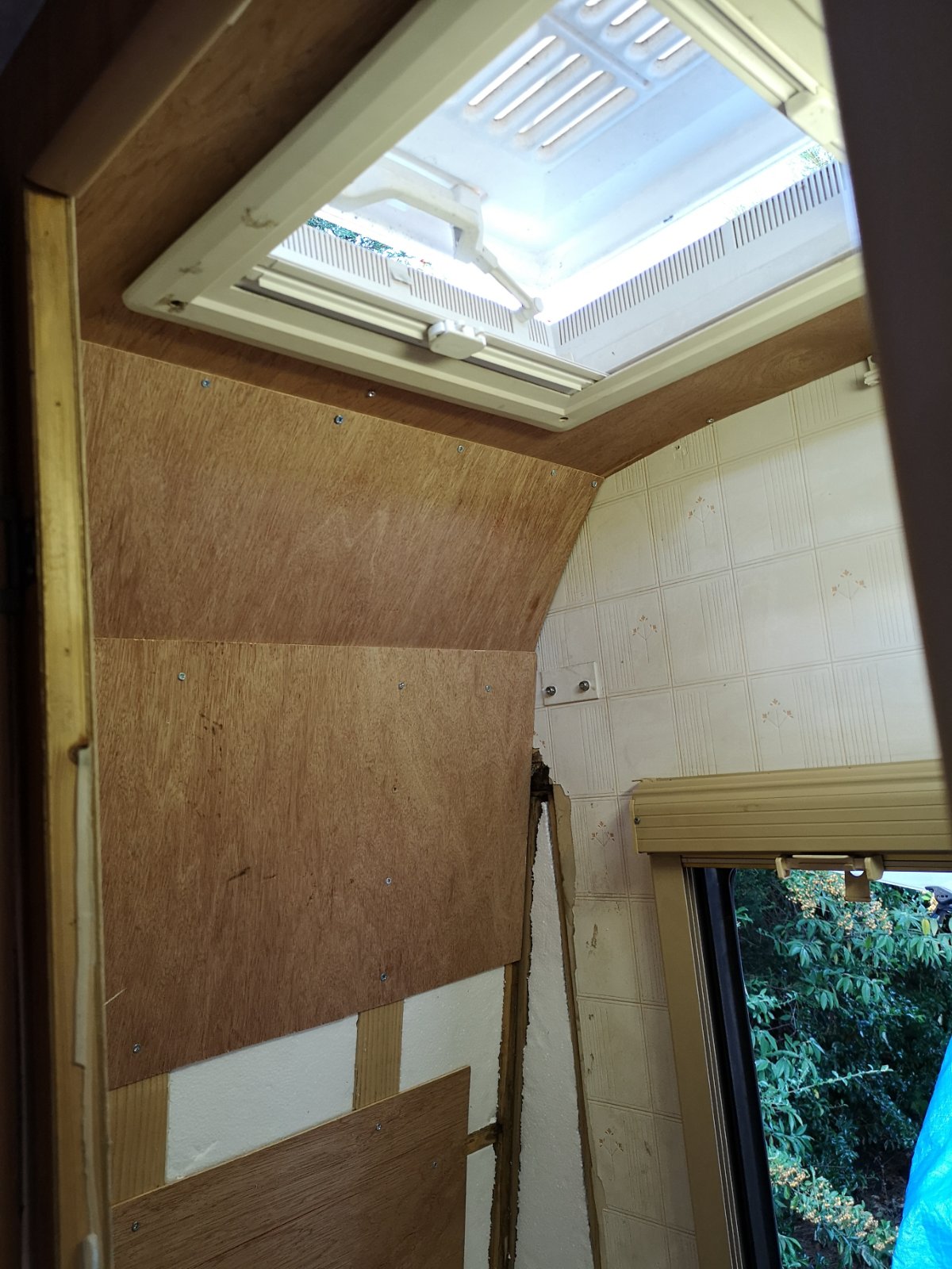

Main progress last couple of days has been in the bathroom. Doesn't look like much at a glance, but sorting out the ceiling and coving at the top of the rear wall took forever. Especially when I realised that the skylight was only held together in one corner and that there was no sealant between it and the roof. How the rain wasn't pouring in I've no idea! Easily enough sorted, but it of course cost me time.
Also spent quite a bit of time tidying up and securing the pipework (the feed from the fresh water tank to the pump and the supply from there to everything (and the hot water line coming back to the bathroom) all go through that space. So I didn't want stuff moving around and rubbing through. Or just moving and rattling...lord knows there's enough to do that anyway! I was lucky to find the original piece of wood that used to cap that area off, as it would have been fiddly to make up.
I've decided that I'm just going to board over the nearside wall up to the level of the window. While the lowest part of the wall has been pulled to bits, the ply above ankle height isn't interested in moving, and if I'm to do it properly I'd really need to remove the window...and I don't have the patience for that right now! I'm not really worried about a few bits of plywood, not as though it's heavy!
It's an absolute pain of a room to work in. It's plenty big enough for *you* to be in. However the moment you've got a few tools you start tripping over them, and trying to manhandle things like plywood sheeting it quickly becomes a maddening three dimensional puzzle. Most of the awkward stuff has been done now at least - the triangular piece to go in the corner between the nearside and rear wall has already been cut out (yay for using cardboard templates!), just ran out of time and energy at the time.
Have had a shot at getting a better driving video using a different camera, so will see how that's come out tomorrow. Hopefully there will be less anti-shake algorithm failure than the on the last one.
My plans to get out to more shows this year really hasn't happened so far!

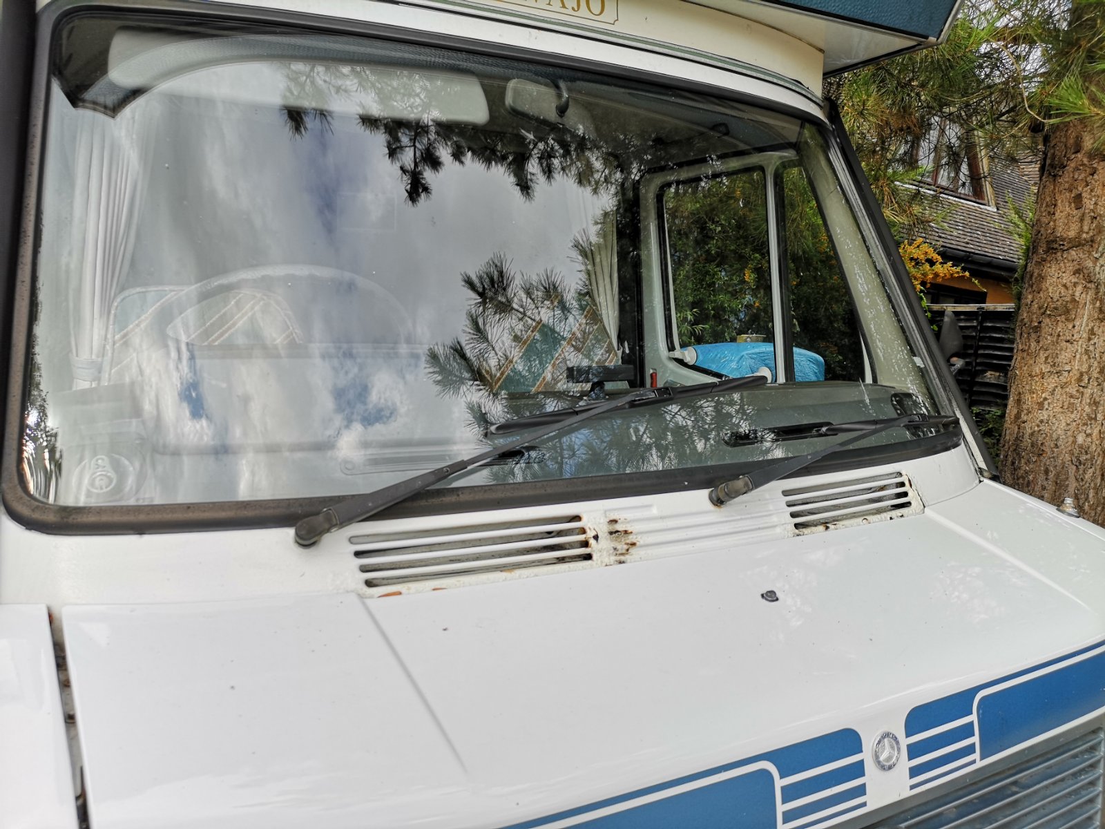

Having been out a couple of times when it was drizzling lately I had ascertained that the wiper blades on the van were fit only for the bin. It was borderline dangerous to be honest, so a new set had to go on. Though having checked everywhere I could think of locally I couldn't find anyone with traditional wipers in 20" - so had to go for one of those hybrid aero-like ones.
The parking positions were laughably out of kilter and it was really annoying me. There seemed to be a lot of variance as to where they should sit judging from photos online - however conveniently there's a nice illustration on the front cover of the handbook.
I was prepared to find the arms rusted onto the spindles but was pleasantly surprised to find they came straight off...so five minutes later had things tidied up a bit.

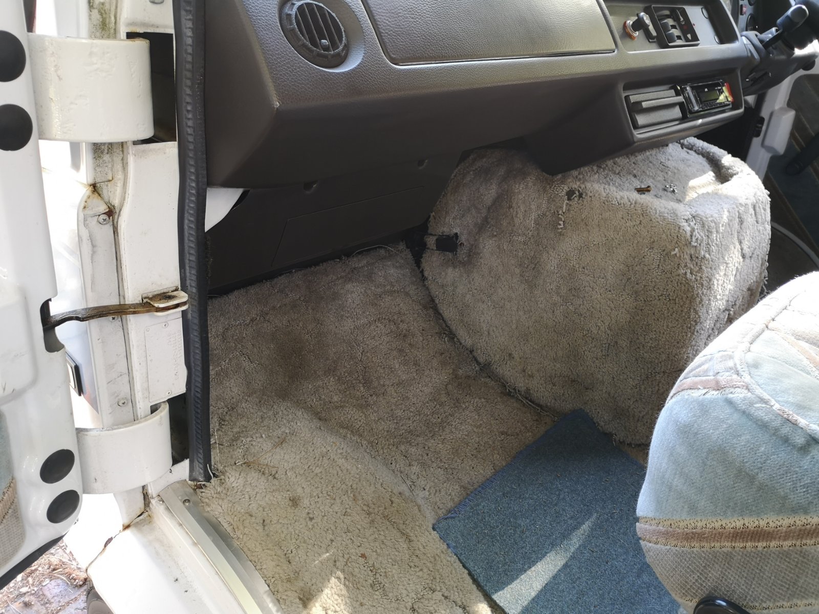

Moving into the cab I decided it was time to investigate the rattle from the nearside which had been driving me nuts.
Doesn't look like much has been done here...
However I can vouch for the fact it has...
There should be four bolts holding the trim panel under the dash in. Two of these are shared and also secure the kick plate under the carpet, and there are an additional two nuts that bolt it down to two studs protruding from the floor panel.
A grand total of *one* of those fasteners was present.
Oh...and I also discovered that the bracket behind there which all the relays are attached to should be screwed to the back of the panel just below the fusebox. However because the original screws for the speaker that used to be down there got in the way they had just left that dangling by the wires.
So a whole bunch of fasteners from the random box of fasteners were added to this area - result being about an 80% reduction in rattles from that side of the cab.

Really need to get some proper floor mats...
