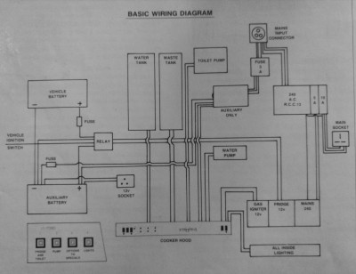

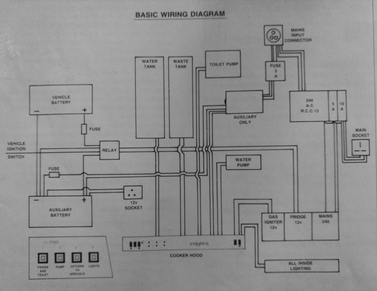

My task for this evening is to figure out why the onboard charger doesn't appear to actually be connected to anything on the DC side.
I have a sneaking suspicion this is going to result in me rewiring half of the above diagram!
Apparently there should be a split charging relay somewhere too... haven't found that yet.

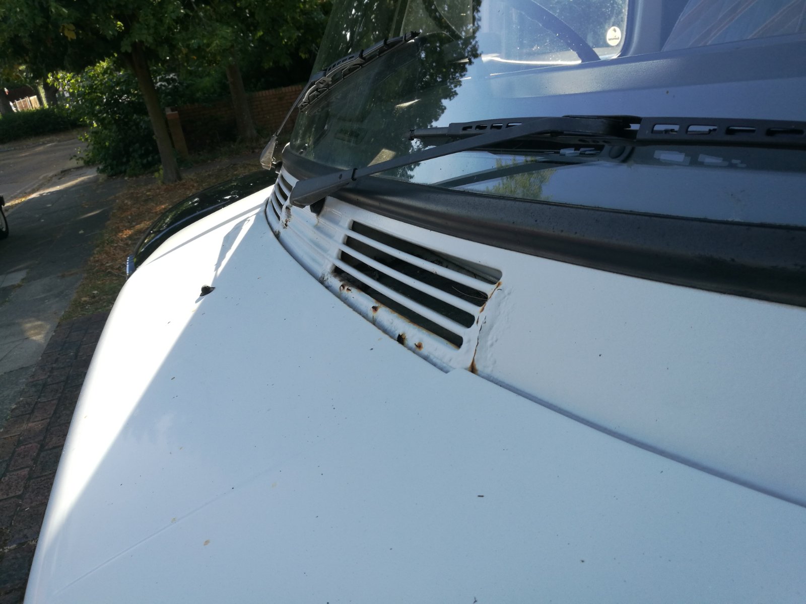

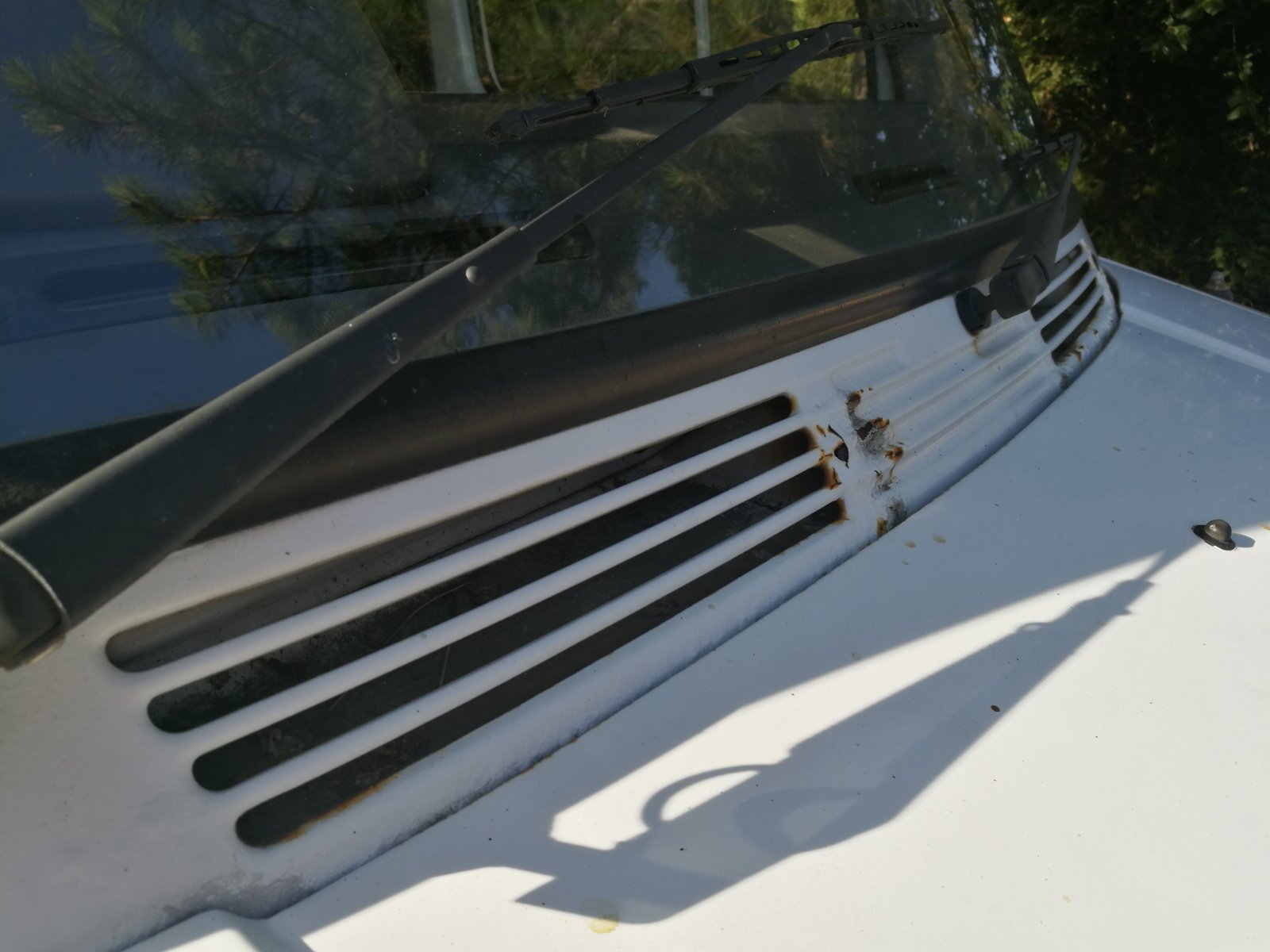

Just for the sake of clarity, here's the area beneath the windscreen that's in need of sorting.
If it was just flat it wouldn't be too hard...sadly the ridges make that more problematic.

Good to have pics of those windscreen vents with the rust issue.
Couple of thoughts from looking at them
1: don't let the rust travel vertically 'up' any further: as it stands, you might get away with leaving the windscreen in. Clean it up, KuRust it and brush on some white Hammerite temporarily.
2a: just delete the vents altogether and then, like you say, it should be reasonably simple.
2b: do they serve any cooling or similar purpose? How much heat's coming out of there in the course of a slow Urban run, traffic lights and constantly going up & down the box.
3: the highest point of rust I see is by the NS wiper mount, there appears to be a rusty tell-tale there, but that might be all there is.
4: how many panels does it meet at the base, ie the rear channel of the engine bay and how far does the rot go at that point? If its spread far enough, might you need to have the lump out?
5: it'd be interesting to take an angle-grinder to another T1, rotten or otherwise, to see how that area is constructed if the rot's spread far enough to merit that sort of investigation
6: the contours for the Drain Channel and/or Windscreen will be the problem, but if you only need the former (at the top of the engine bay), maybe you might be able to use something like the side channel from from a bolt on wing allied to a flat section of steel, in much the same way as I did my bit of sub-structure
