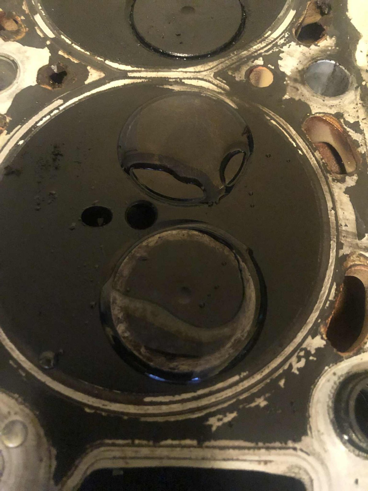

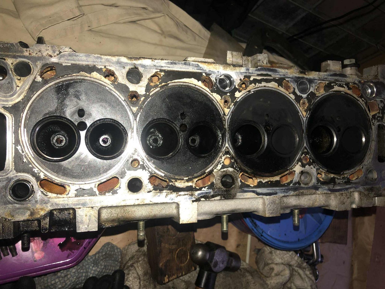

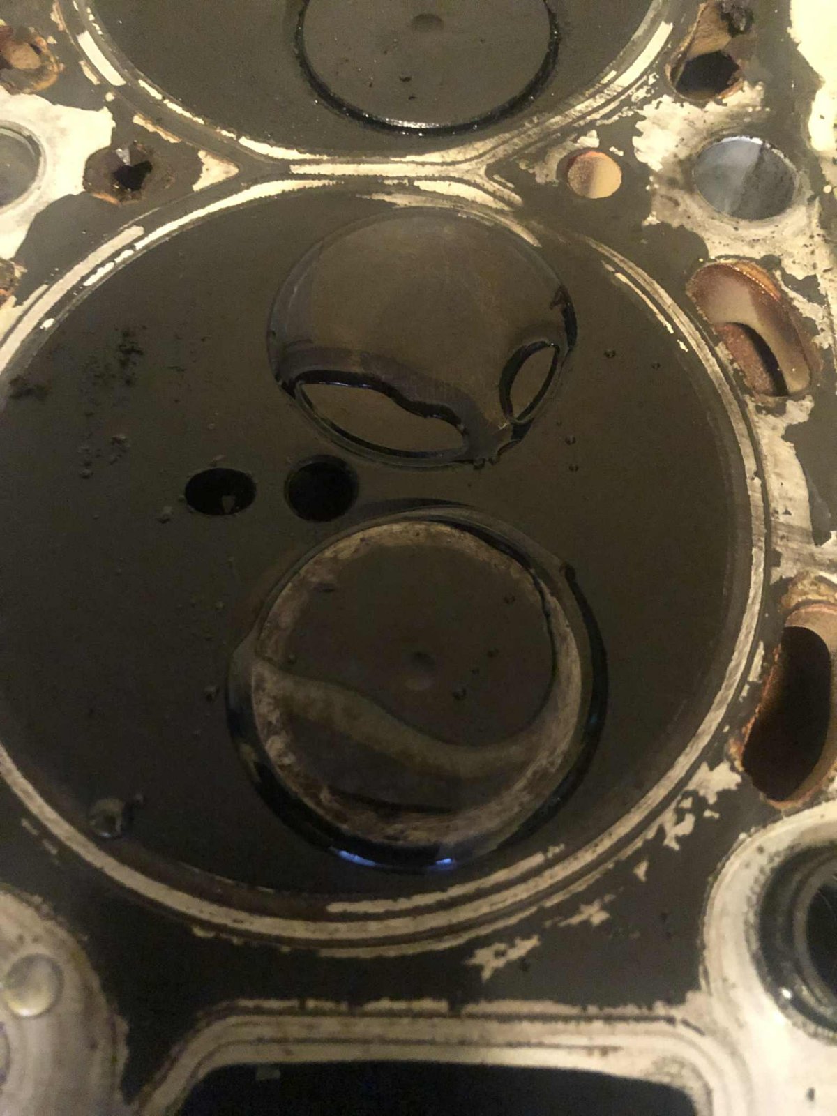

Hi Rothgear - the head is off and awaiting cleaning, got the valves out eventually, there doesn't appear to be anything visually wrong so I'm going to do a clean up/de-coke and re-assemble, my gasket is a 2 notch (1.35mm thickness).
The mirror falling off
was a dumb move - there was no way it was going to come out of the hole it went in and meant the head needed to come off
I'm not planing on engineers but I'll know more once the head and block are prepped....

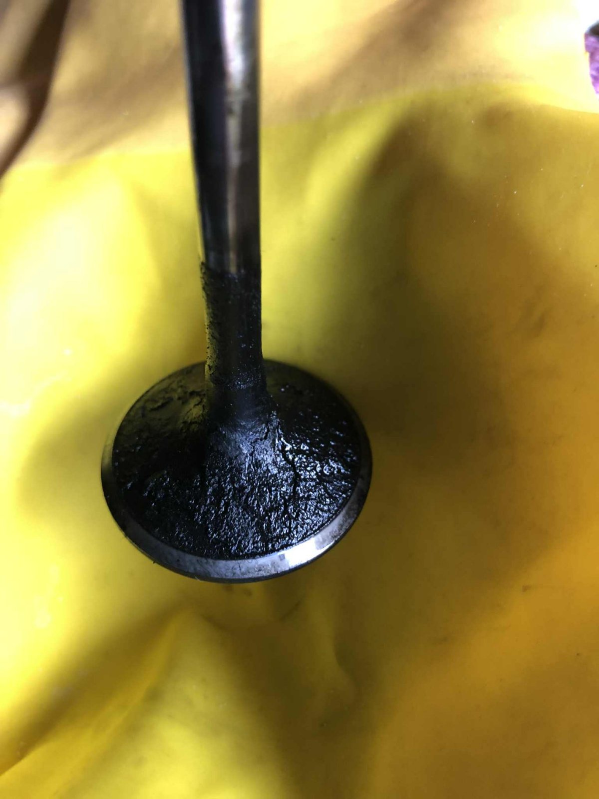

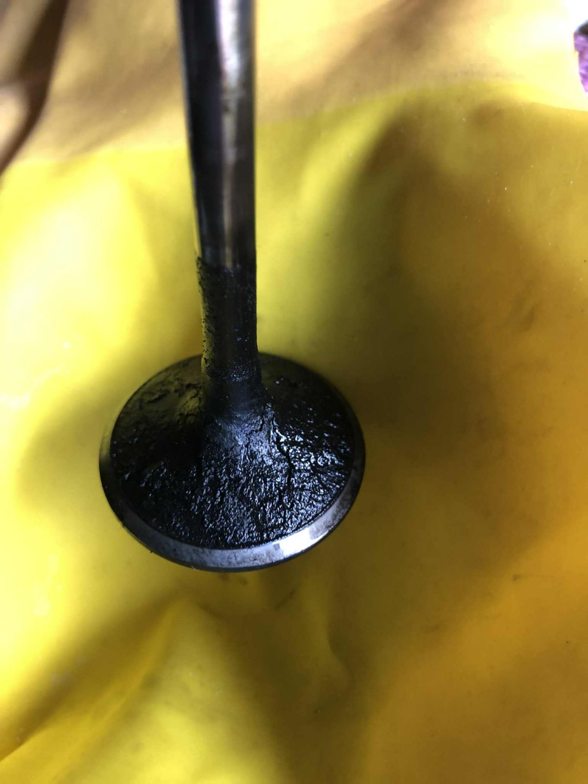

Yes I have fair DIY skills but haven't done a de-coke for 40 yearsRhothgar wrote: 10 Jan 2026, 11:12
It sounds as though you have the necessary skills to do the work yourself so I guess it's a case of whether you want to do it.
Valves removed and I also managed to remove the long Exhaust bolt threads from the block with the double nut and a hammer on the spanner, there was no room to do that in situ so that should make the head easier to go back on squarely.
I only looked at the prices of a recon head as I was expecting some damage somewhere
I've been busy cleaning ....
Inlet valves seem the worst for build up but still not bad for the mileage @168K (last 45K on Supermarket grade diesel)
....and then more cleaning ...
Job delayed slightly - My old hand valve lapping tool has done a runner so I've invested £9 into a drill attachment that will hopefully speed up the job when it arrives....I've still got the engine block and pistons to do while I wait for the tool ...ohh more cleaning
Once Valves are lapped and new Valve Stem Oil Seals are fitted assembly will begin ....

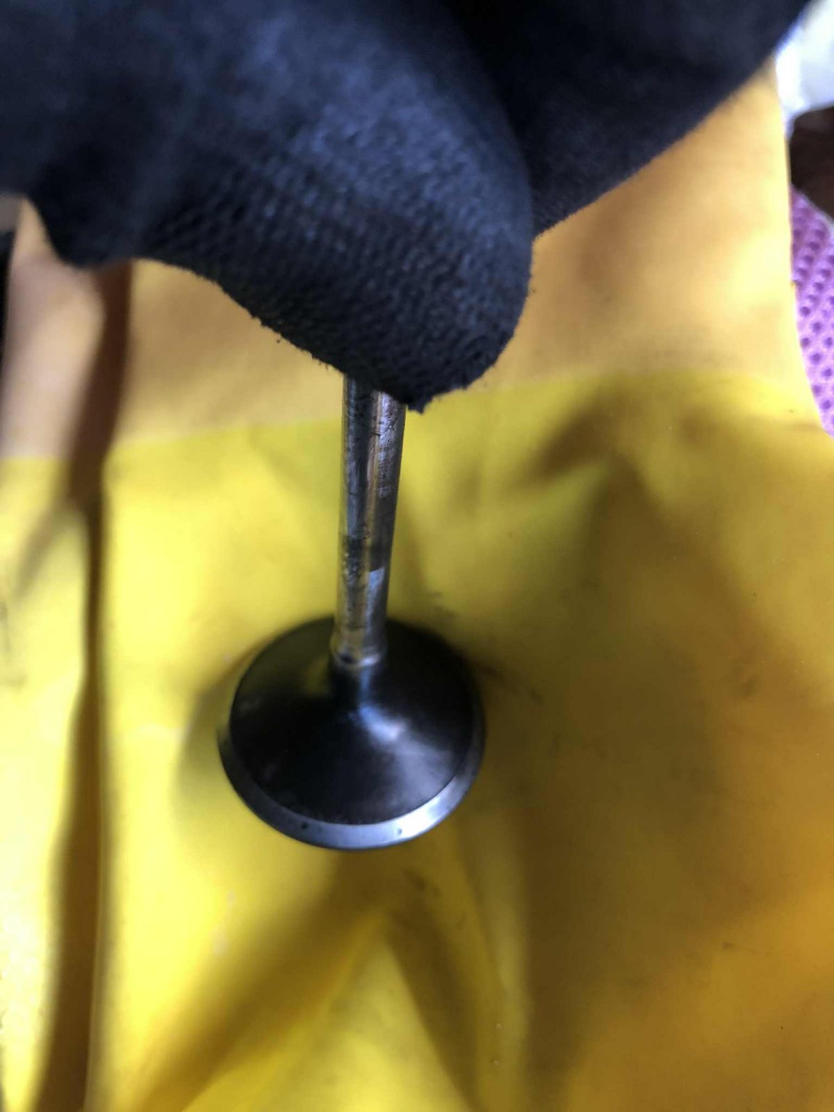

Did you note which cylinders each pair of valves came from?
Also, while they're out it would be worth checking they are straight, dti them on v blocks (or v blocks made from lego). Especially the one from the damaged follower. There is also a 'wobble test' that although isn't fantastic, gives you an idea of valve guide wear.
I can't give you specs for PSA but can for a big old kwak which would be in the right ballpark.
Pete
- Posts: 11776
- Joined: 28 Mar 2013, 21:05
- x 1981
Re: XANTIA HDi RUNNING ROUGH
Put the valves in a drill and spin them......you will notice any slight bend that way
Skull
- (Donor 2026)
- Posts: 1369
- Joined: 02 Aug 2013, 13:35
- x 373
At great expense I have them numbered in an egg box
Yeah that's about my technical limitStickyfinger wrote: 19 Jan 2026, 15:01 Put the valves in a drill and spin them......you will notice any slight bend that way
To be fair I'm pretty sure they are in 'spec' as they made a lovely 'plonk' noise once the valve springs were removed and I slid them in and out a few times
