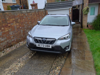

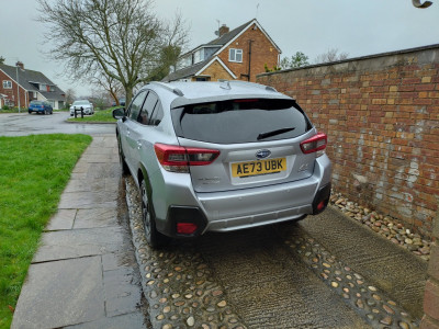

Well the Legacy went back to the dealer today for them to rectify the failed console lighting. They lent me a different car this time, a Subaru XV eBoxer. Considerably more up market than the one I had last time. This car was so full of tech I was wondering if I should have a pilot's license instead of a driving license!! :-D
I think the story is best told with pictures and the single video which shows the functions of the auxiliary screen! :-D

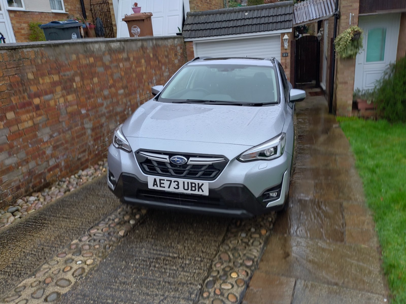

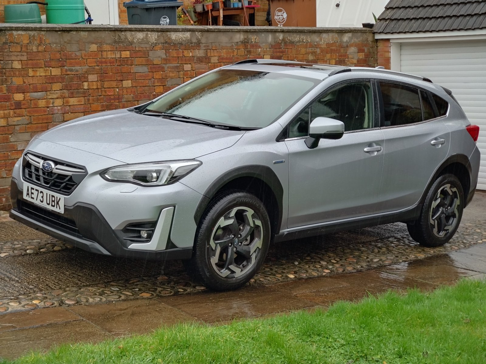

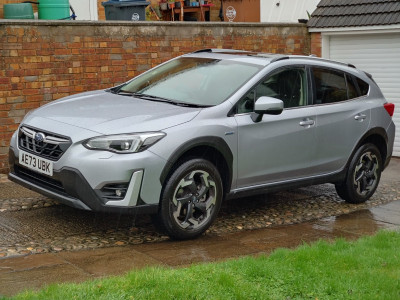

On the drive
On the drive
A reasonable front design, for an SUV
Not too bad
Not too bad

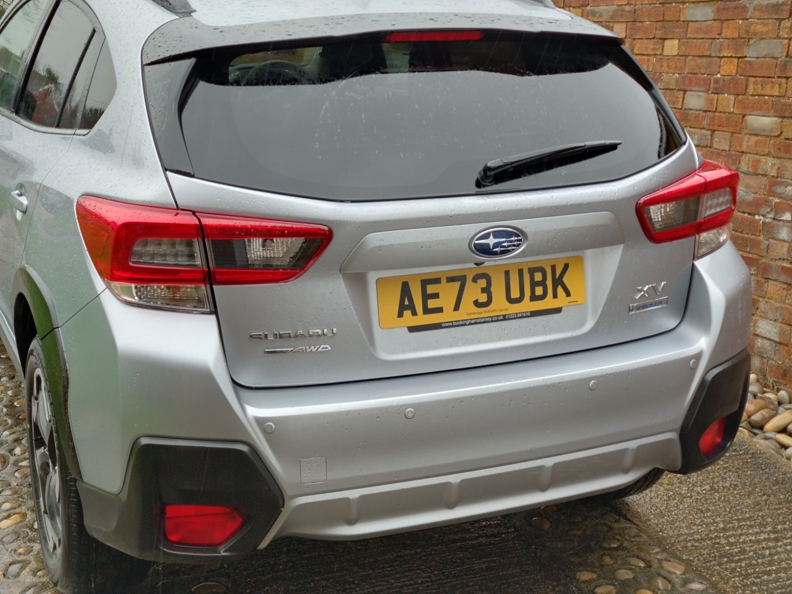

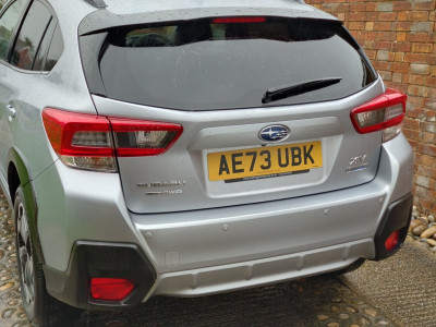

Just to show the badging

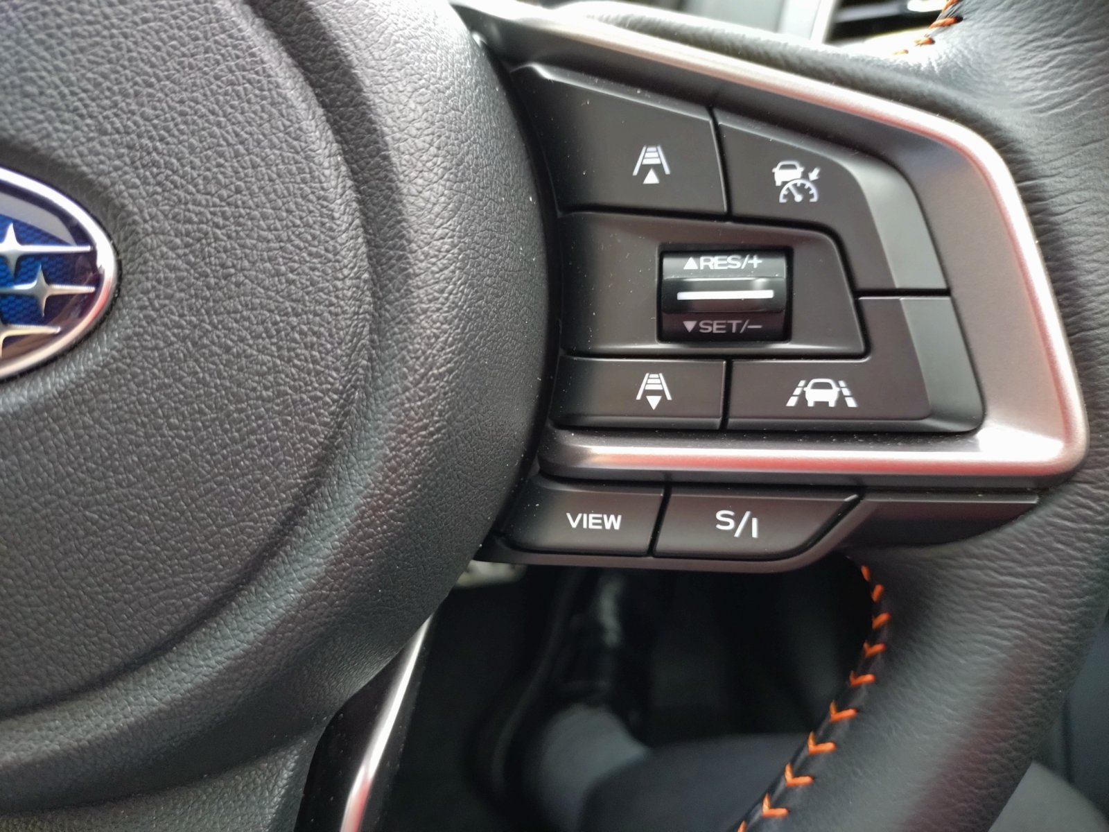

However as soon as you turn it on and survey your controls you begin to understand how complicated things can be when, in my view, they just don't need to be:

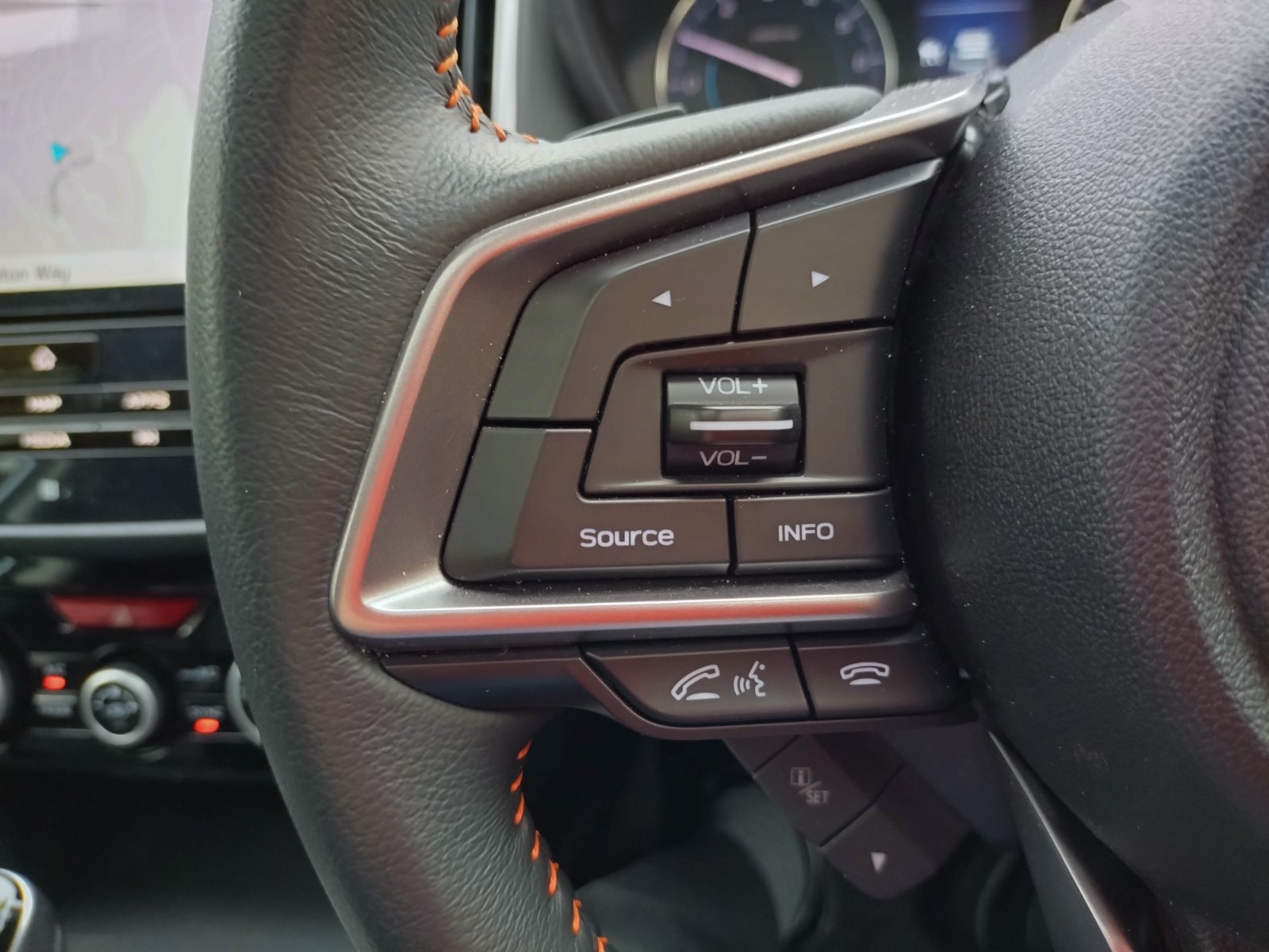

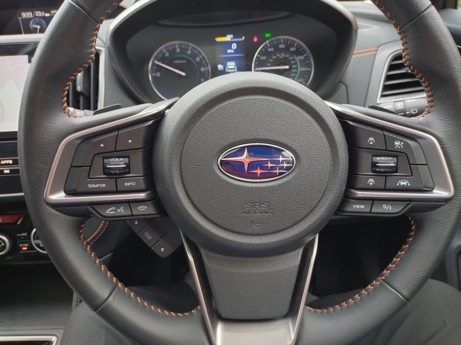

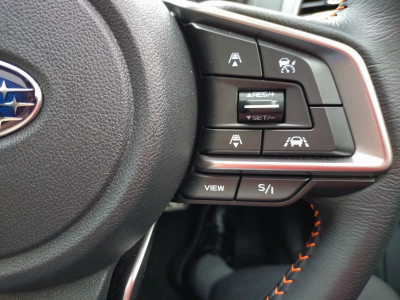

The steering wheel controls with hidden flappy paddles

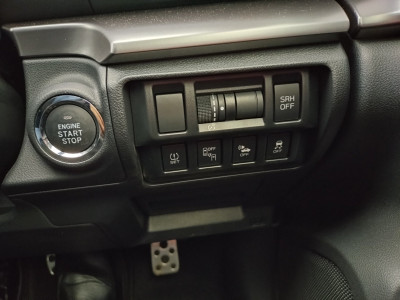

Aux switches are to the right of the column
Auxiliary controls
Auxiliary controls

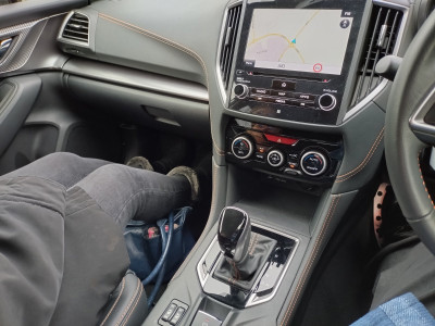

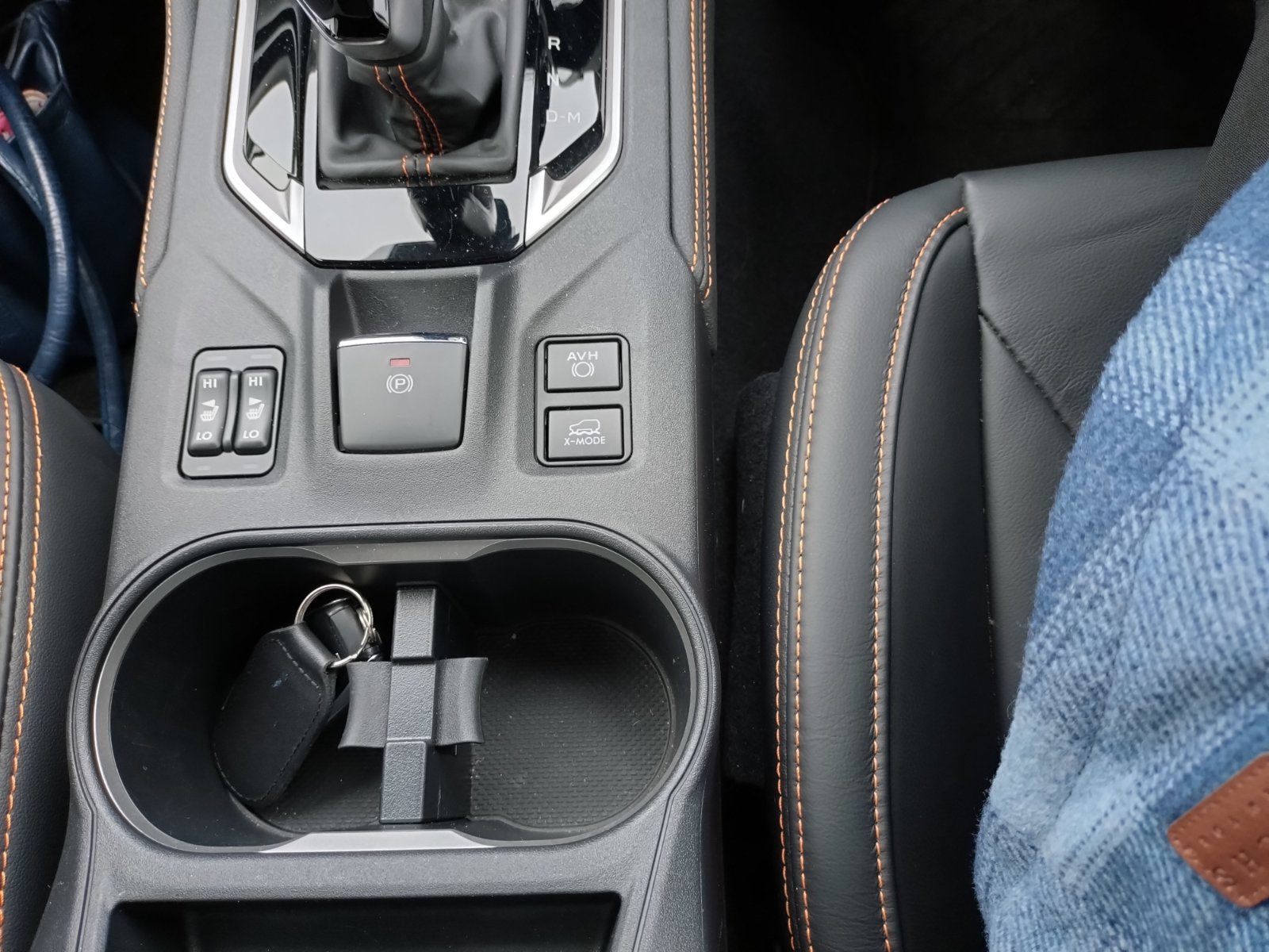

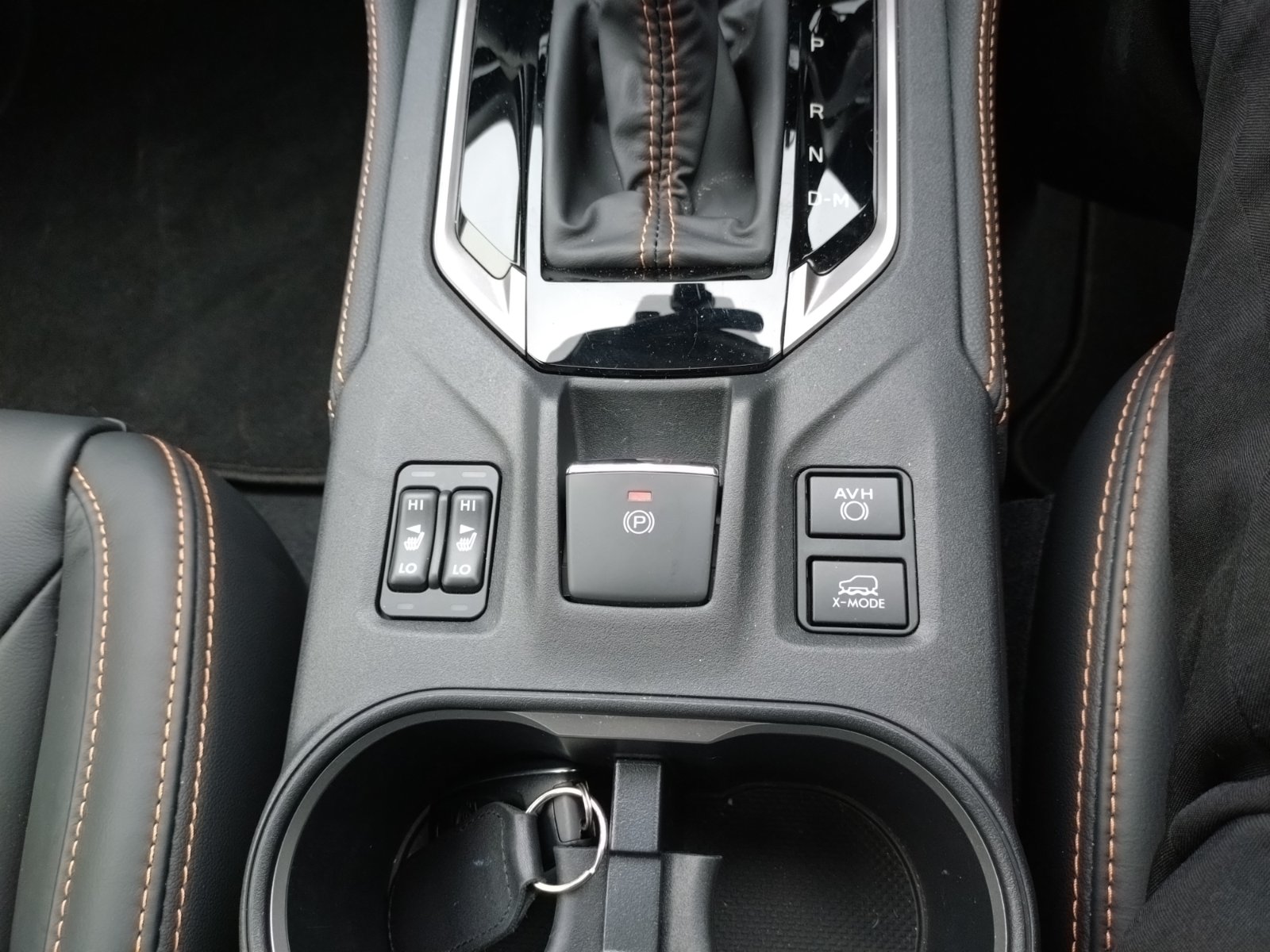

Centre console switches

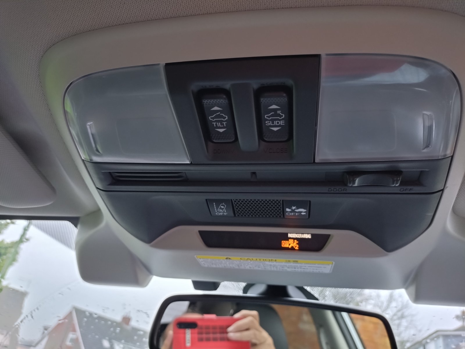

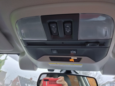

In the roof
In the roof

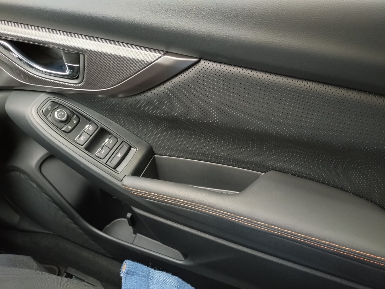

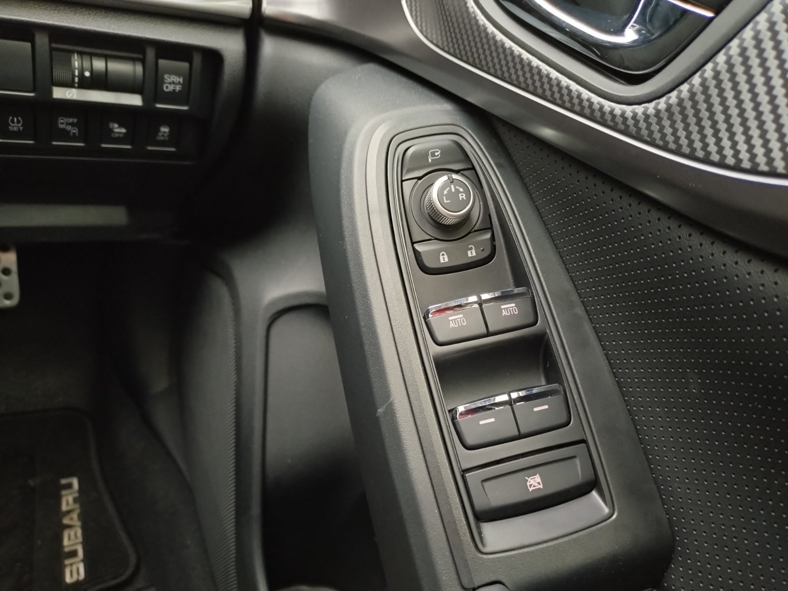

In door controls
In door controls

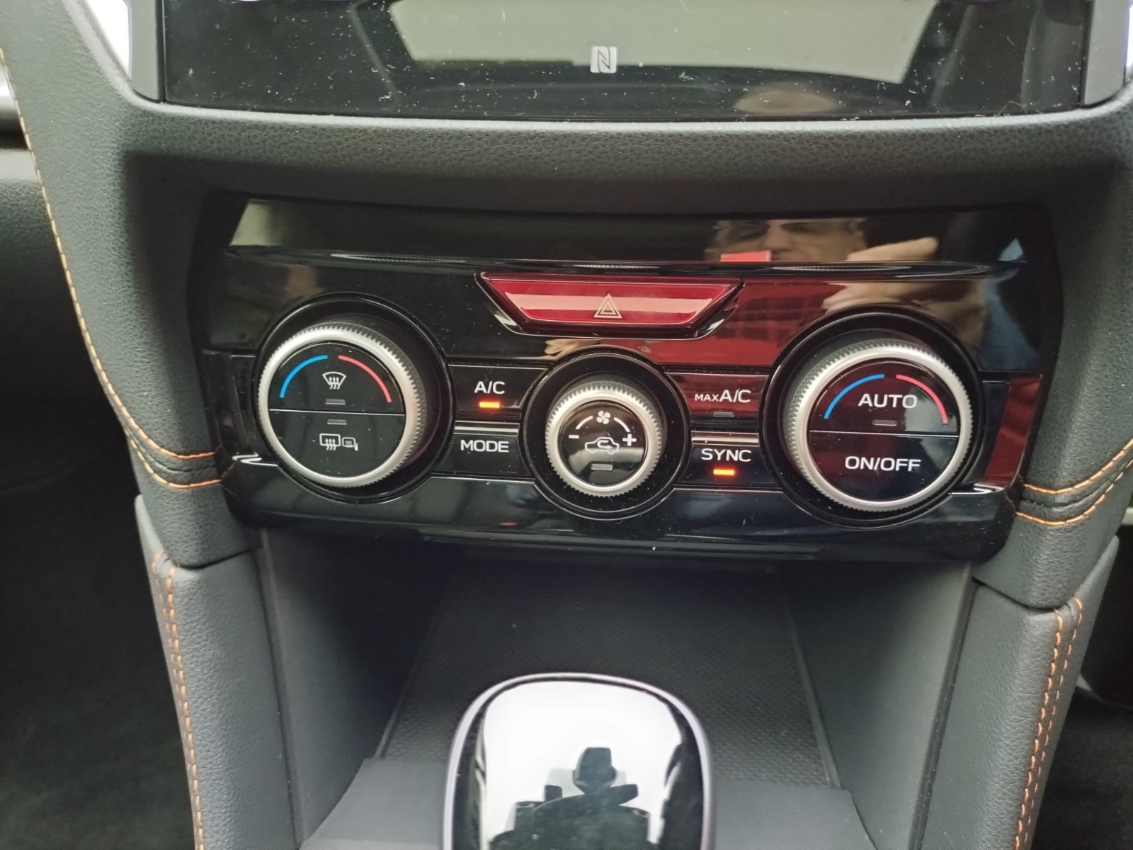

Climate controls
Climate controls

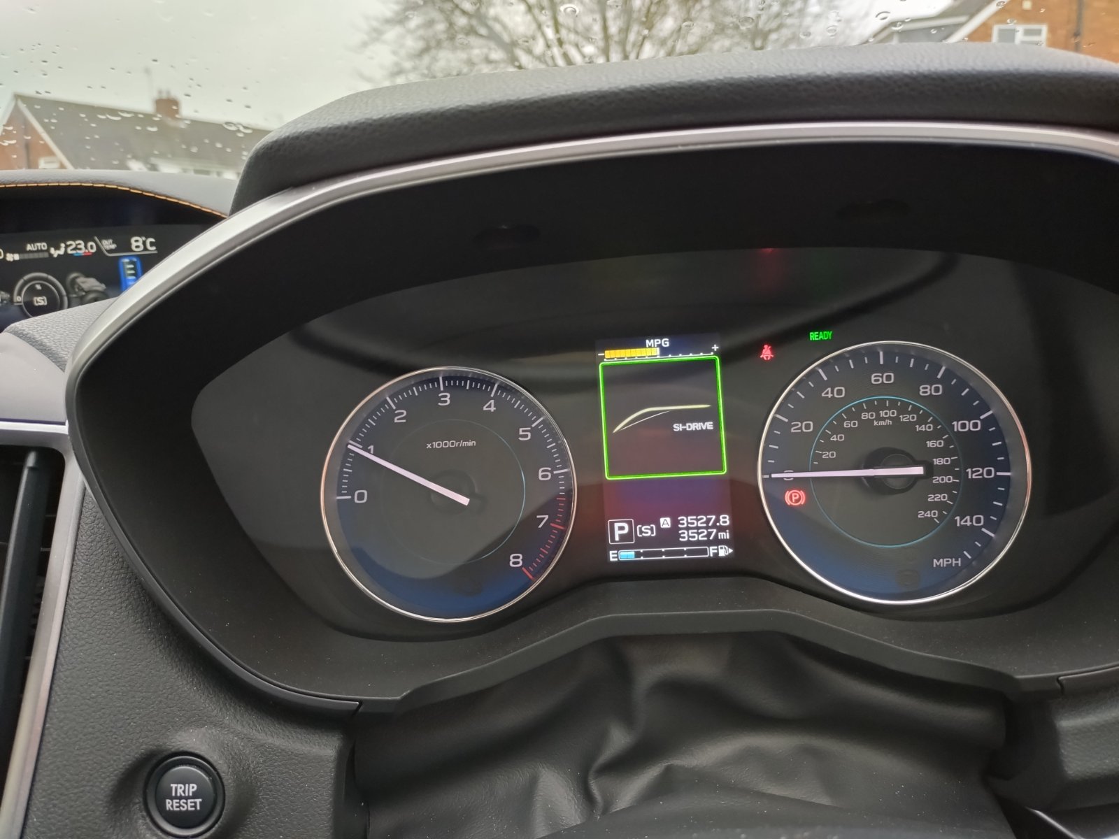

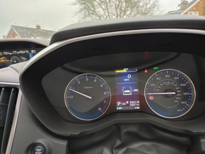

Then of course you begin to survey the screens, there are three, one in front of you as the 'dashboard', here showing the driving mode selected together with lane assist and cruise control information
Centre screen showing Sport mode
Lane monitoring
Lane monitoring

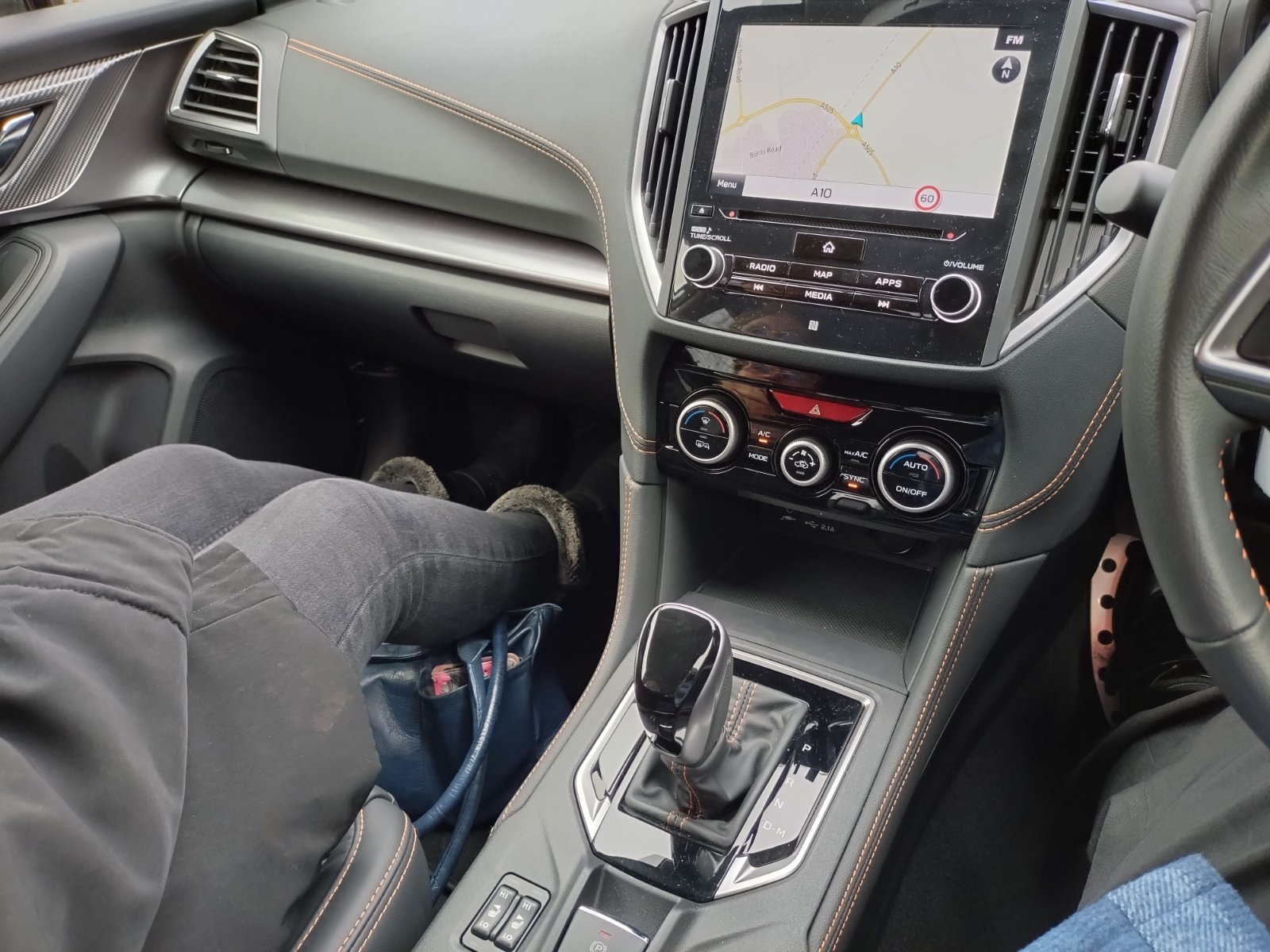

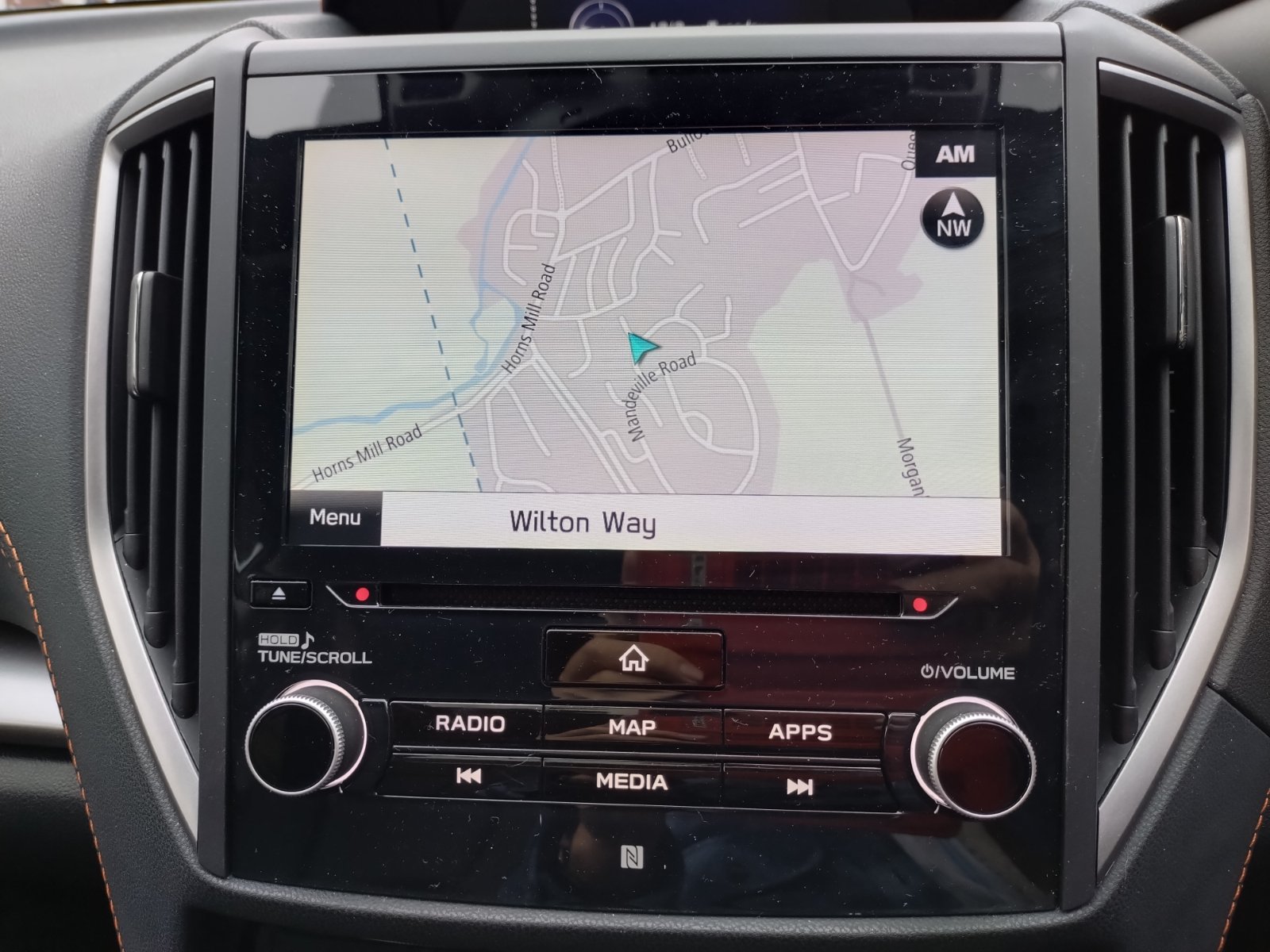

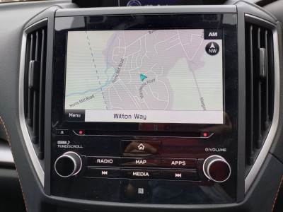

Then the main infotainment screen for doing your washing and making the beds, oh and showing radio and sat nav and numerous other apps which I did not have time to play with:
Map screen
Map screen

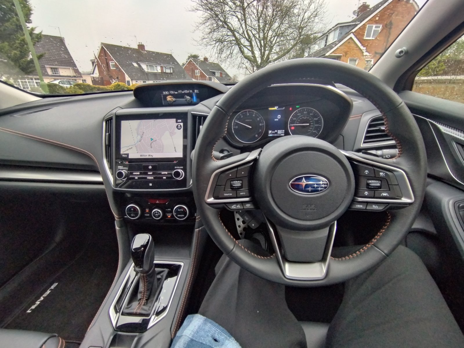

However the one good thing was the improved driver visibility over the previous loan car:
The driving position
All in all a comfortable ride though a tad too stiff for my liking, adequate performance but not great economy for a hybrid. I averaged 36.4 mpg over 100 miles. However if cars keep getting more complicated like this I shall definitely consider buying my next transport from Mr Delaney!! :-D

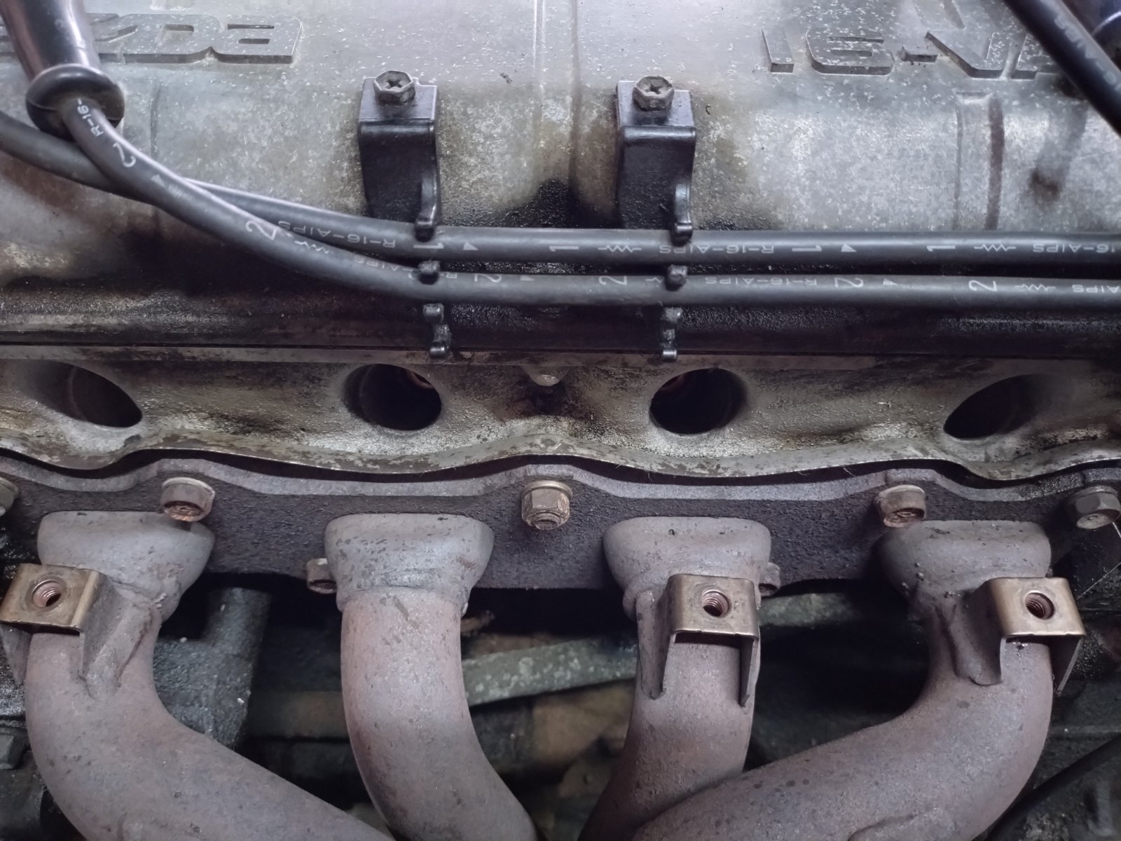

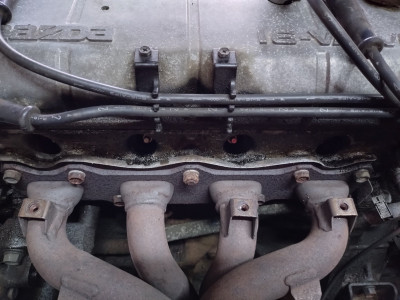

I then turned my attention to the MX3's coolant loss and discovered it was leaking from the top hose to radiator joint. I fitted a new clip and ran it up to temperature and no leaking. However it still has a random misfire which I think may be residual moisture from the leak. I'll investigate that further on the next dry day! :-D

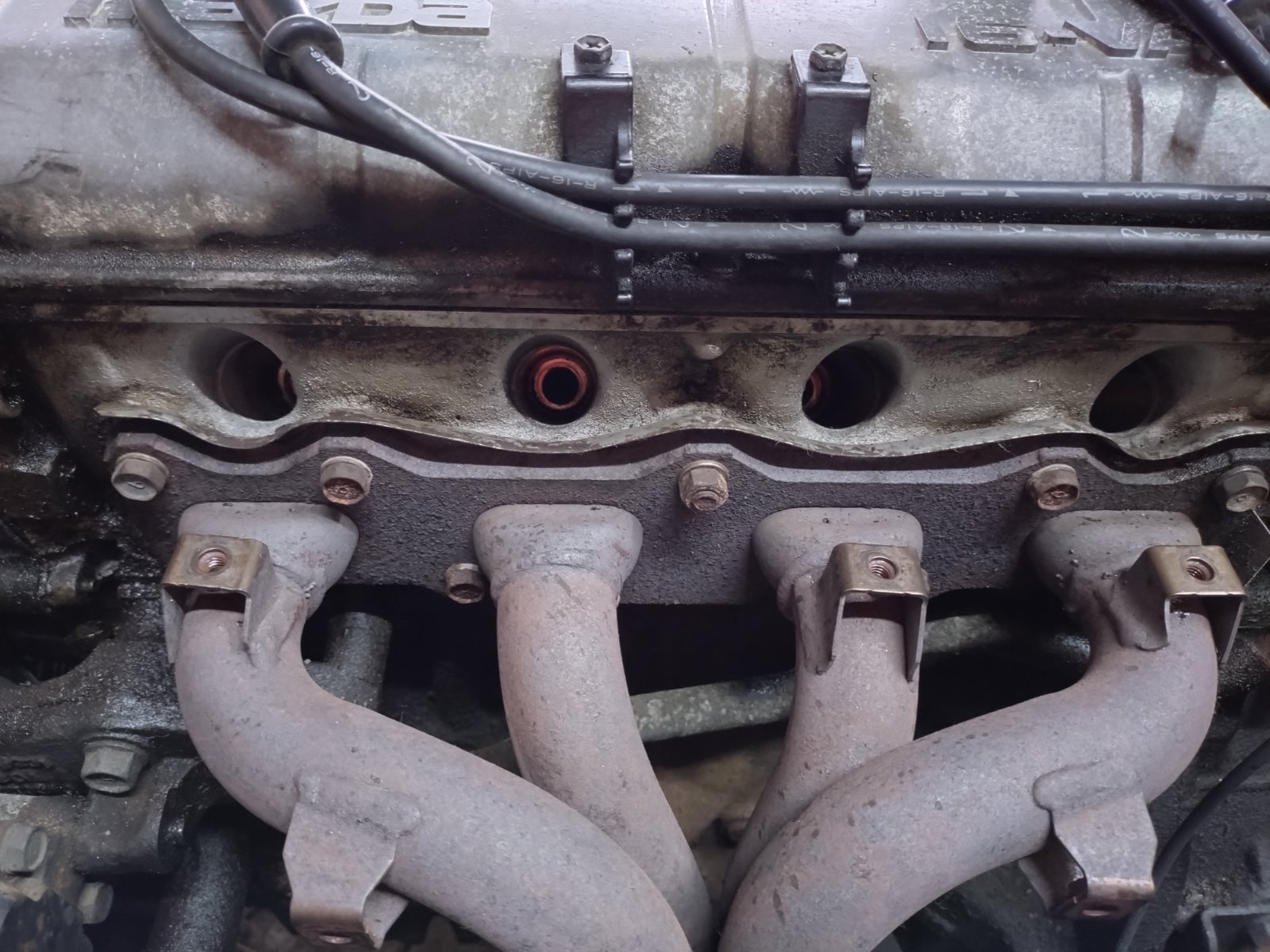

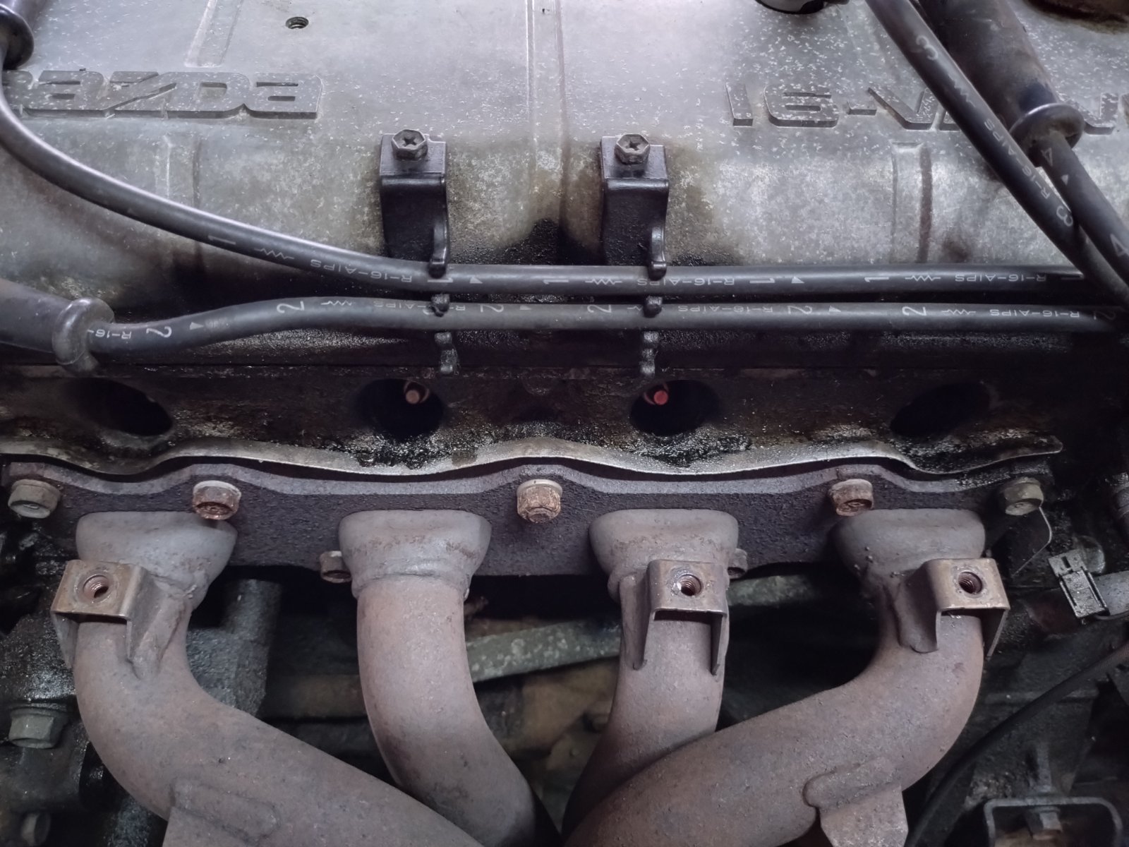

Today was the next dry day so I pulled the MX3 into the garage to investigate, I opened the bonnet and removed the heat shield to reveal much as I had suspected:
What I found!
What I found!

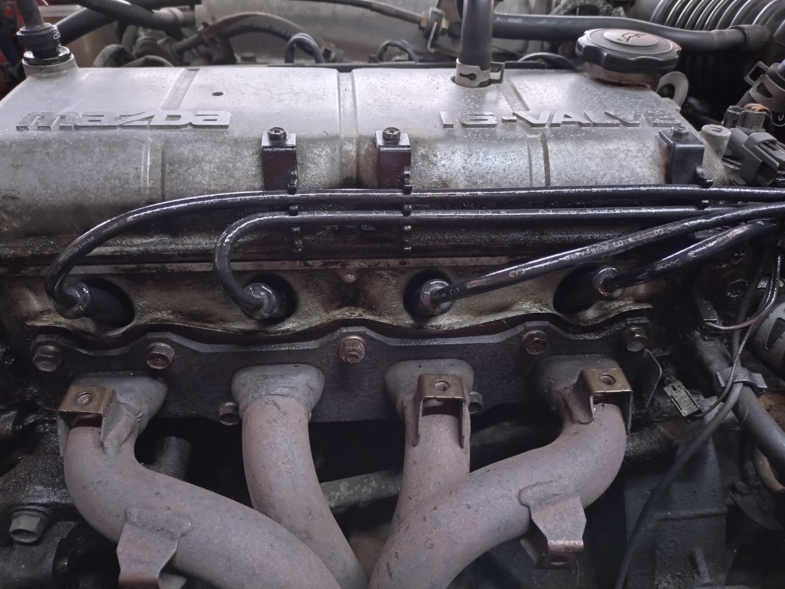

The surrounds to the plugs were well gummed up with coolant soaked grease.
I began the rescue by cleaning up the surrounds:
Cleaned surround
Cleaned surround

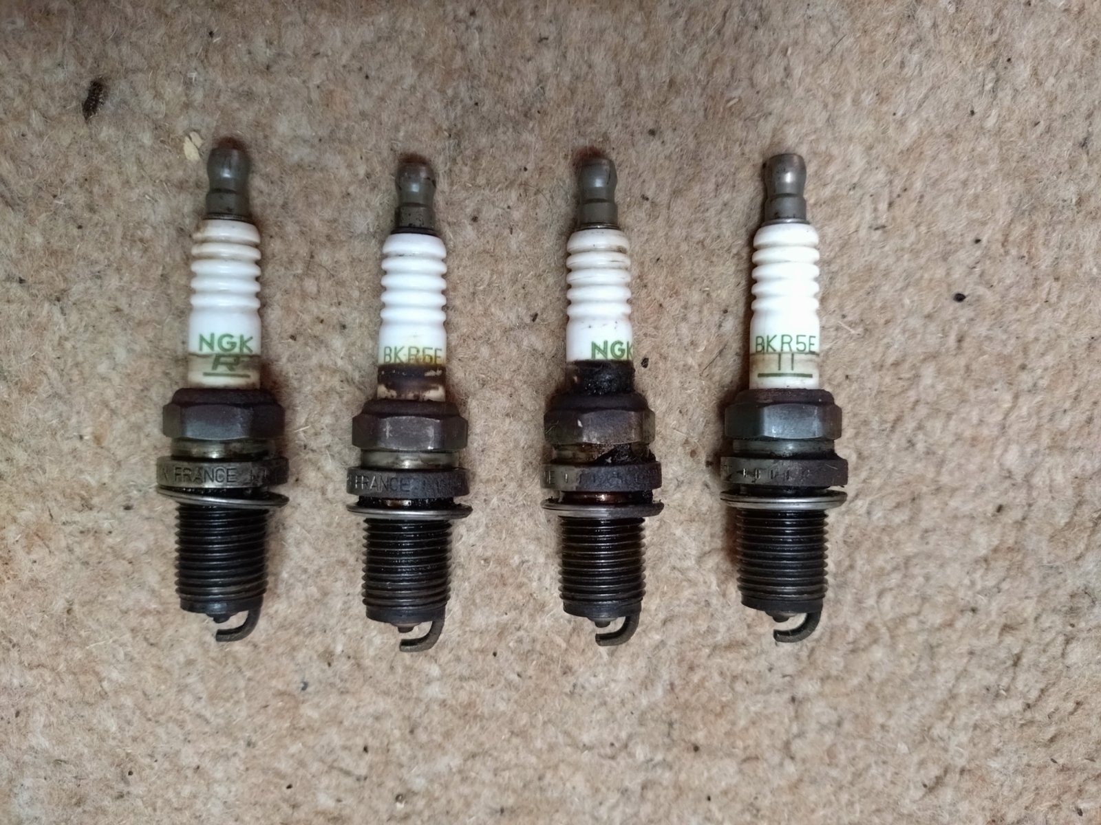

I was quite pleased to have discovered the plugs at this point:
Old plugs
Old plugs

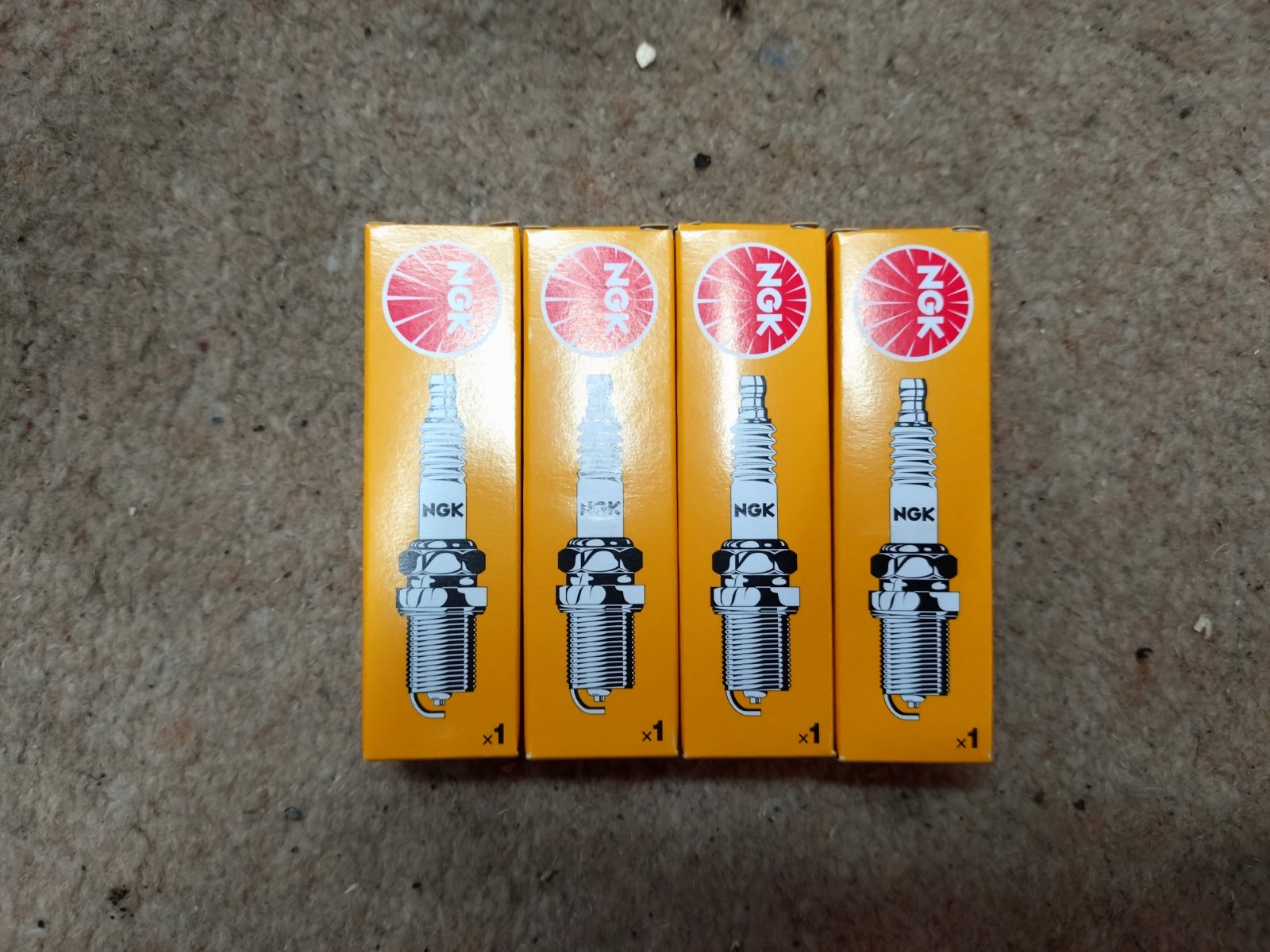

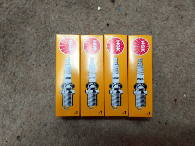

So I asked SWMBO to pop in to our local factors on her way to Tesco and half an hour later she returned with these (and collected her shopping list! :) )
New plugs
New plugs
So I installed them, cleaned, reconnected and damp proofed the leads and it was job done! :

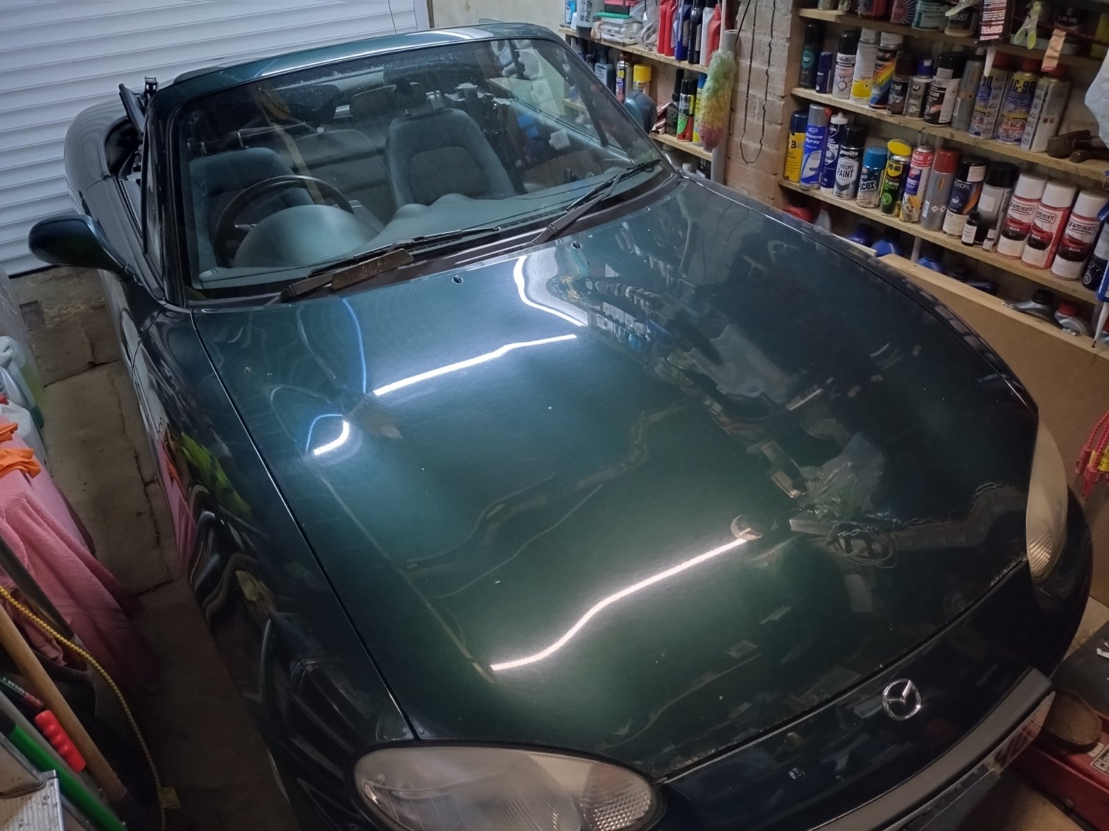

I have a visitor in the garage at the moment which I am doing some preparation for sale work on. Nothing too complex and so far so good but it only just fits in!! :-D
Mazda MX5 Mk1
Mazda MX5 Mk1

I have a bit of a liking for the MX-5 :D I could have had one a few years back but whilst one might just fit your garage Mick, no way will one fit in mine and that ruled it out..
Back when I had a Saxo I found that wouldn't fit my garage either!

What an interesting cylinder head the Mazda (MX3) has! A 16 valve, but the plugs not appearing to be central (i.e. over to one side) but also seems in line with the exhaust port. Wonder if two separate passages which loop around the plug and combine just before transitioning to the manifold.

MattBLancs wrote: 16 Mar 2024, 18:49 What an interesting cylinder head the Mazda (MX3) has! A 16 valve, but the plugs not appearing to be central
8 of those valves are in the radio Matt ;) :lol: Seriously, yes, agreed, it does look a little unusual... This needs investigation. Can you shed light Mick?

I don't have the car here at the moment, it is at the MX5 owner's house. From the plug exchange I can say that the plugs are deep set at around 45° and from the manual appear to emerge down the centre line as you'd expect.i'll put up a pic later! :-
