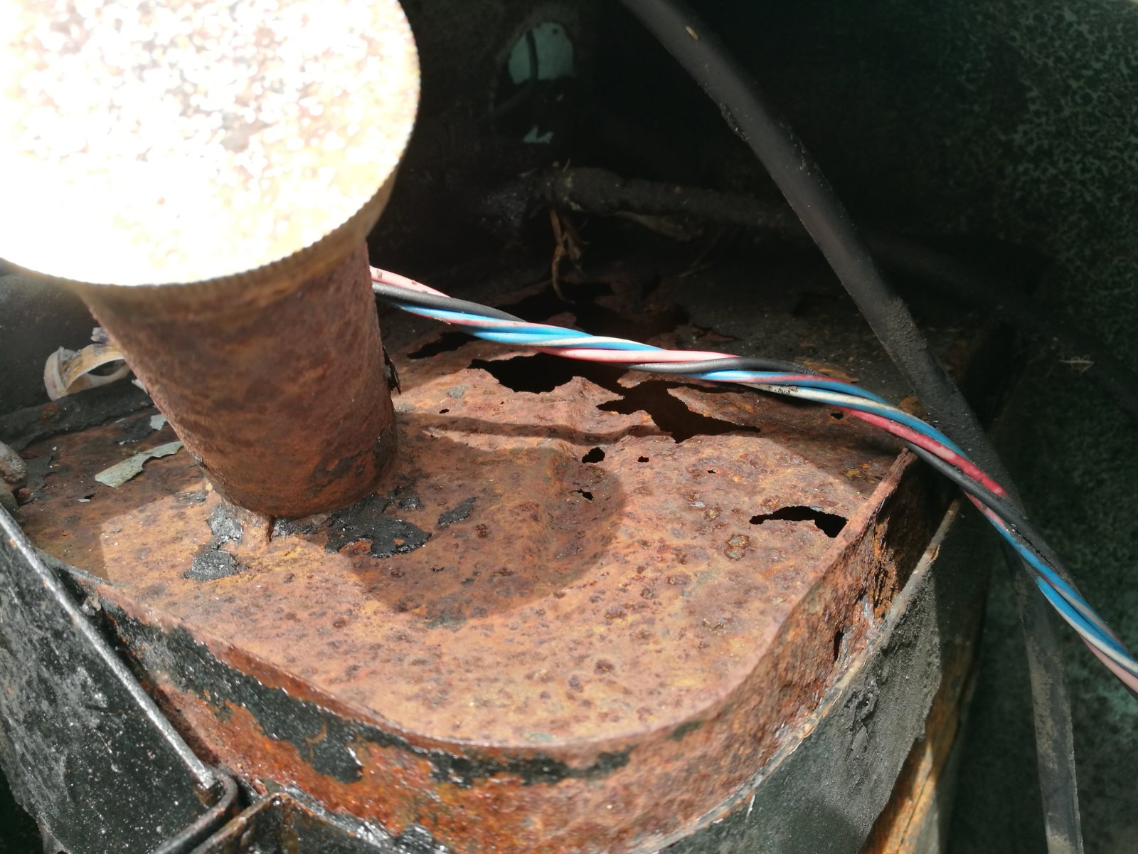

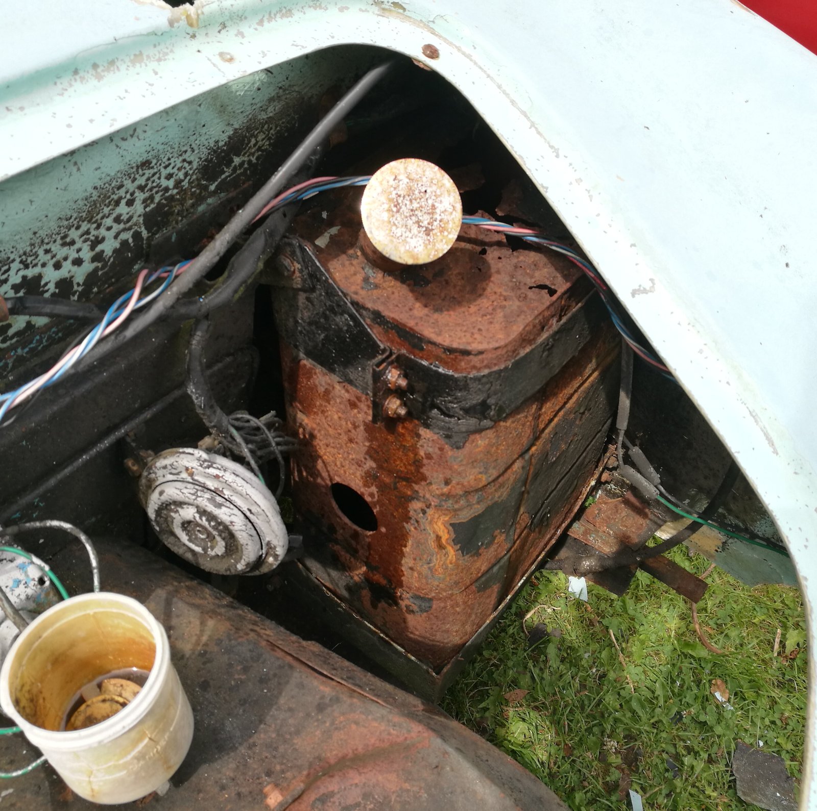

Not sure about the rest of the tank - but the top is more hole than metal.
Here's a couple of photos.
Anyone recognise it?

My first thoughts are that they originally fitted a somewhat standard and universal tank and modified it. If you rotated the tank 90 degrees clockwise to have the gauge opening at the top, and didn't have the fill point at all (i.e. never manufactured that way), then what is currently the gauge hole would have originally been a fill point (with a suitable boss welded on). My point being - they originally got hold of a horizontal tank, and turned it into a vertical tank. It's the sort of thing that could have been fitted to a dumper or large ride-on mower or similar. Much smaller, but very similar design, petrol tanks were fitted to Briggs and Stratton engines - but nowhere near that size.
Is the petrol gravity drawn from the bottom of the tank or is it sucked via a dip-tube from the top ?

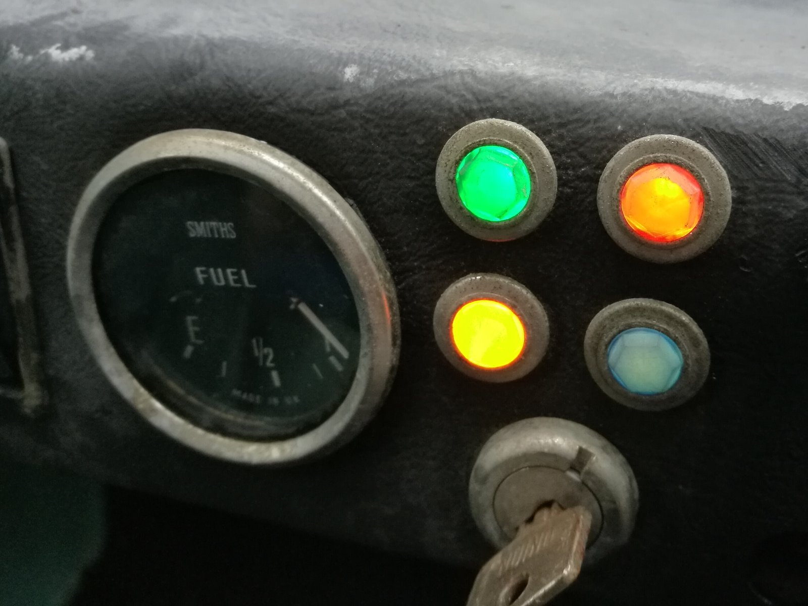

The tank is probably custom for that installation, but the gauge sender probably a generic smiths from something else with a fairly vertical tank. I would suggest the Triumph Herald one (still readily available) http://www.jamespaddock.co.uk/fuel-tank ... rew-type-3, although it depends on the type of guage (for the correct resistance range) What sort of gauge do you have? Smiths or AC? magnetic or thermal?

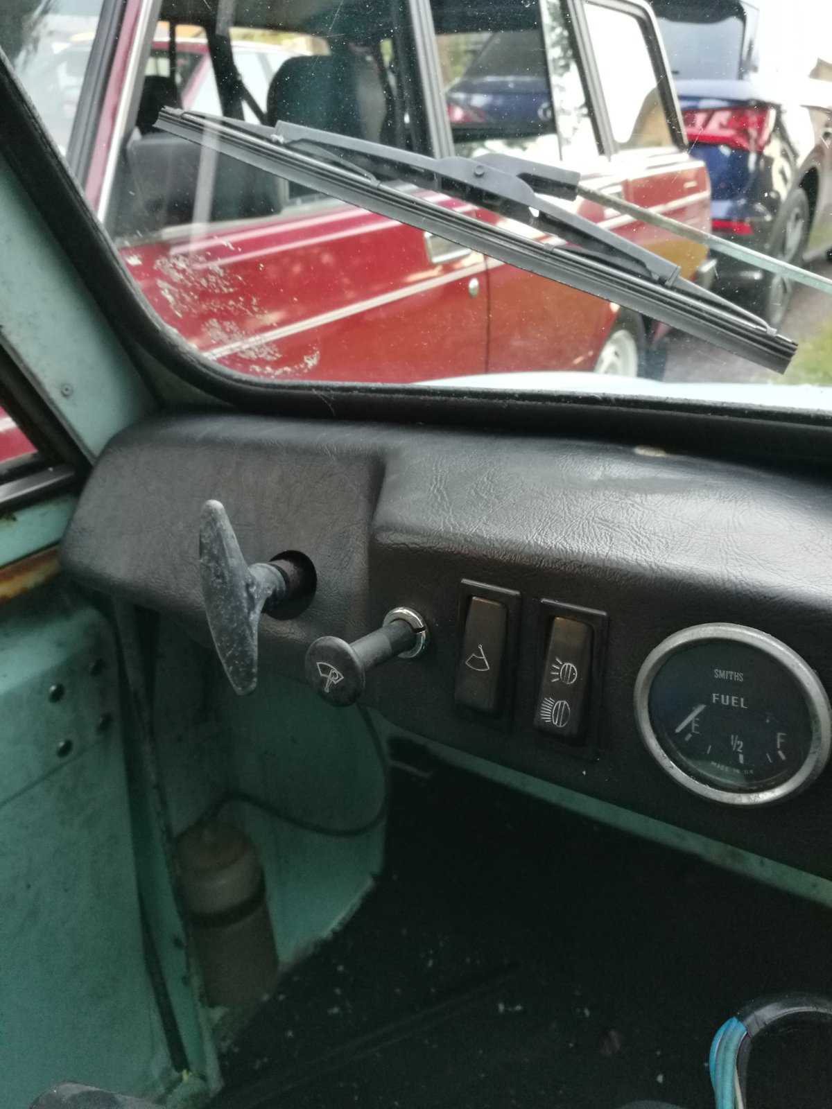

Smith's gauge, same one as used in the MGB among a zillion other applications. Magnetic, and with zero damping for maximum fuel sloshing reading oscillation while moving.

That appears to be a Smiths "moving coil" gauge, which was fitted to most UK vehicles in the 1950s, but was seldom used after about 1960. They were distinctive in that with the tank sender disconnected, they indicate Full.
You need a sender for a moving coil gauge, I think that the different senders of that vintage only differ in the length and angle of the float arm, and whether they have contacts for a low fuel light.
This: https://www.holden.co.uk/displayproduct ... de=070.236 would seem to be the right part, but maybe you can find one cheaper from another 1950s vehicle (e.g S1 landrover or ...).

I'm pretty sure (based on my faffing with the gauge in KPL) that it will show empty with the sender disconnected. I've not gone hunting for the wire for that yet, but my guess is that it's grounding out on a chassis rail or the tank in the absence of a sender.

Apparently I'm speaking rubbish - found the gauge sender wires today and they're dangling in mid air. So the earlier comments about a moving coil gauge appear to be correct. As stated...no two of these things seem to be the same!

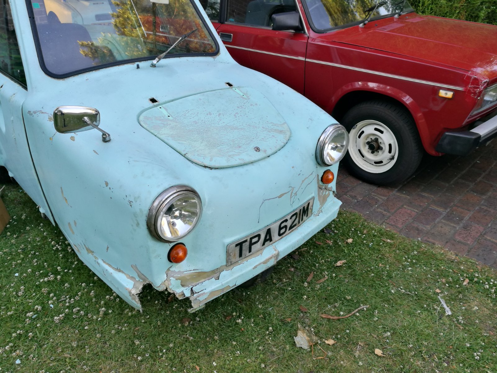

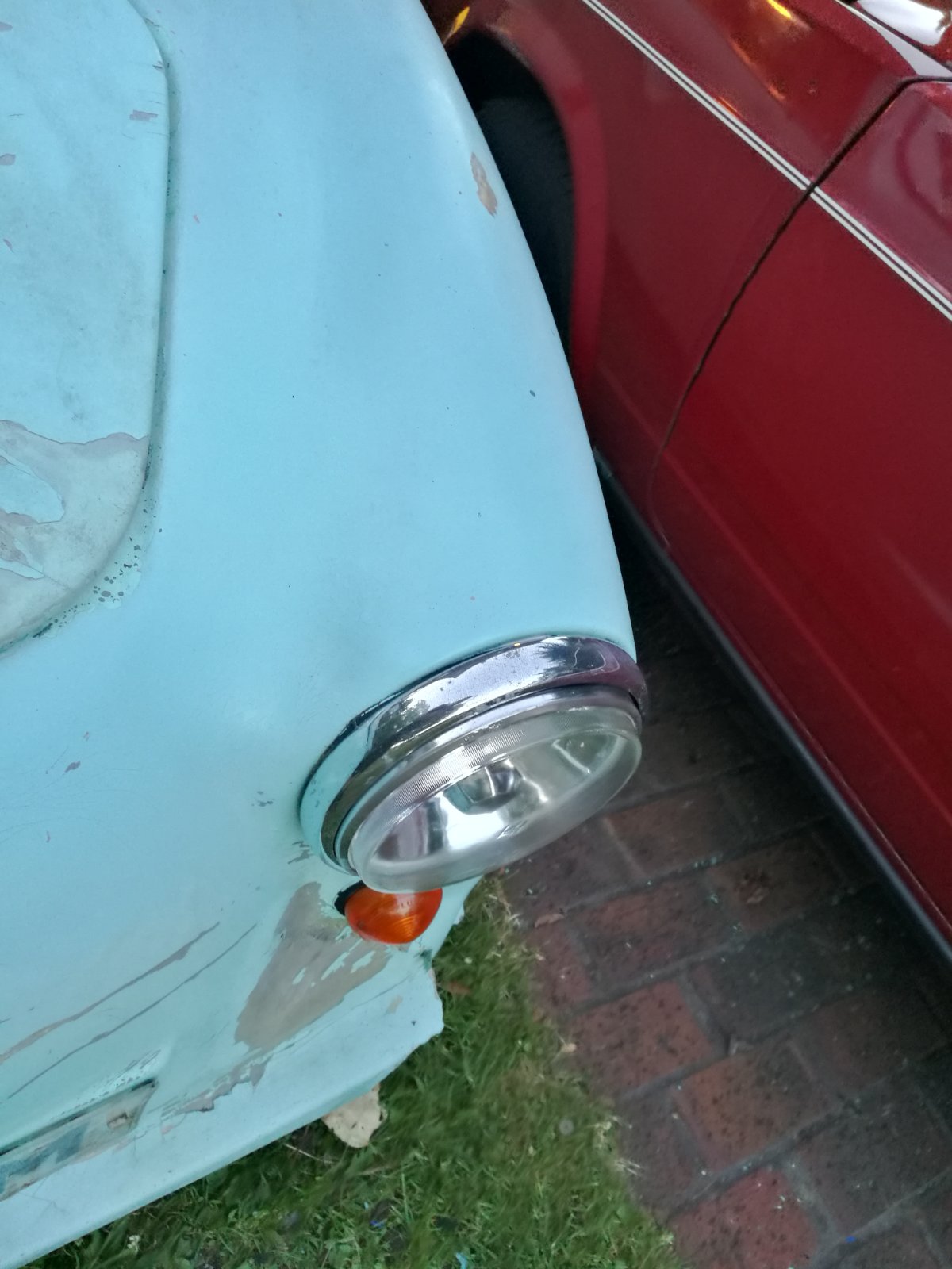

I did however find time to replace the smashed headlights. This made use of a set of modern clear lens equipped lights I bought in error a few years ago. While they look out of place, they'll get us through an MOT and will work until I find a set of H4 units in a more period style. H4 headlights are a necessity I think, as while I'm not planning on a world tour in this thing, I'd rather be able to see if I do wind up driving after dark.
I reckon for now, a pair of intact slightly period inappropriate headlights look better than two smashed ones. They're proper halogen ones and are E marked, not some silly LED or HID nonsense.

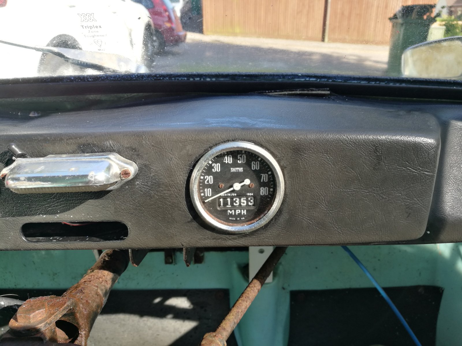

Next up, I took the speedometer out and dismantled it to allow me to remove the large number of dead spiders that were previously filling about a third of the space behind the glass.

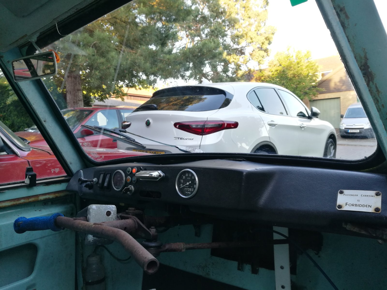

Ignore the Alfa, it's just visiting.

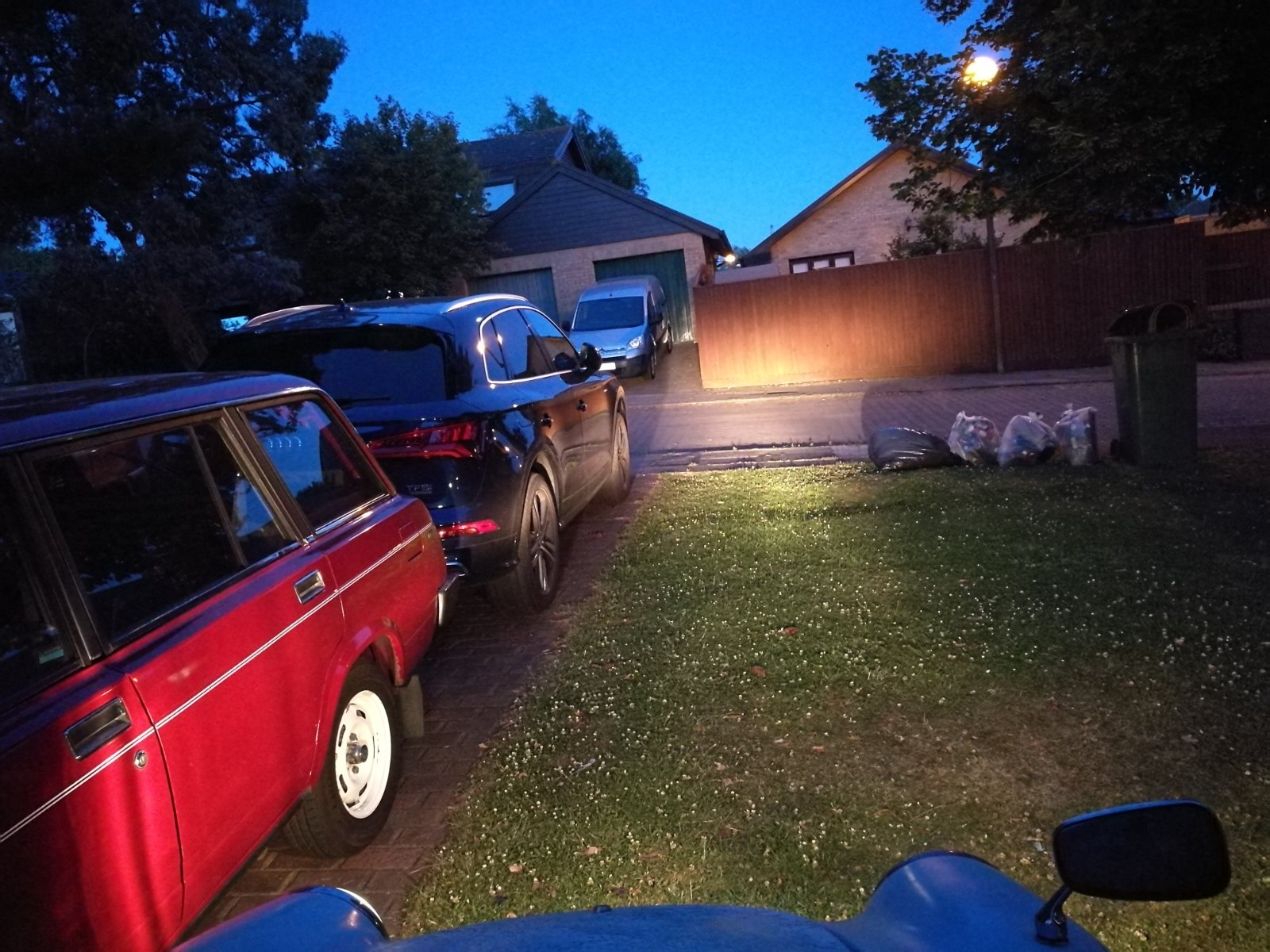

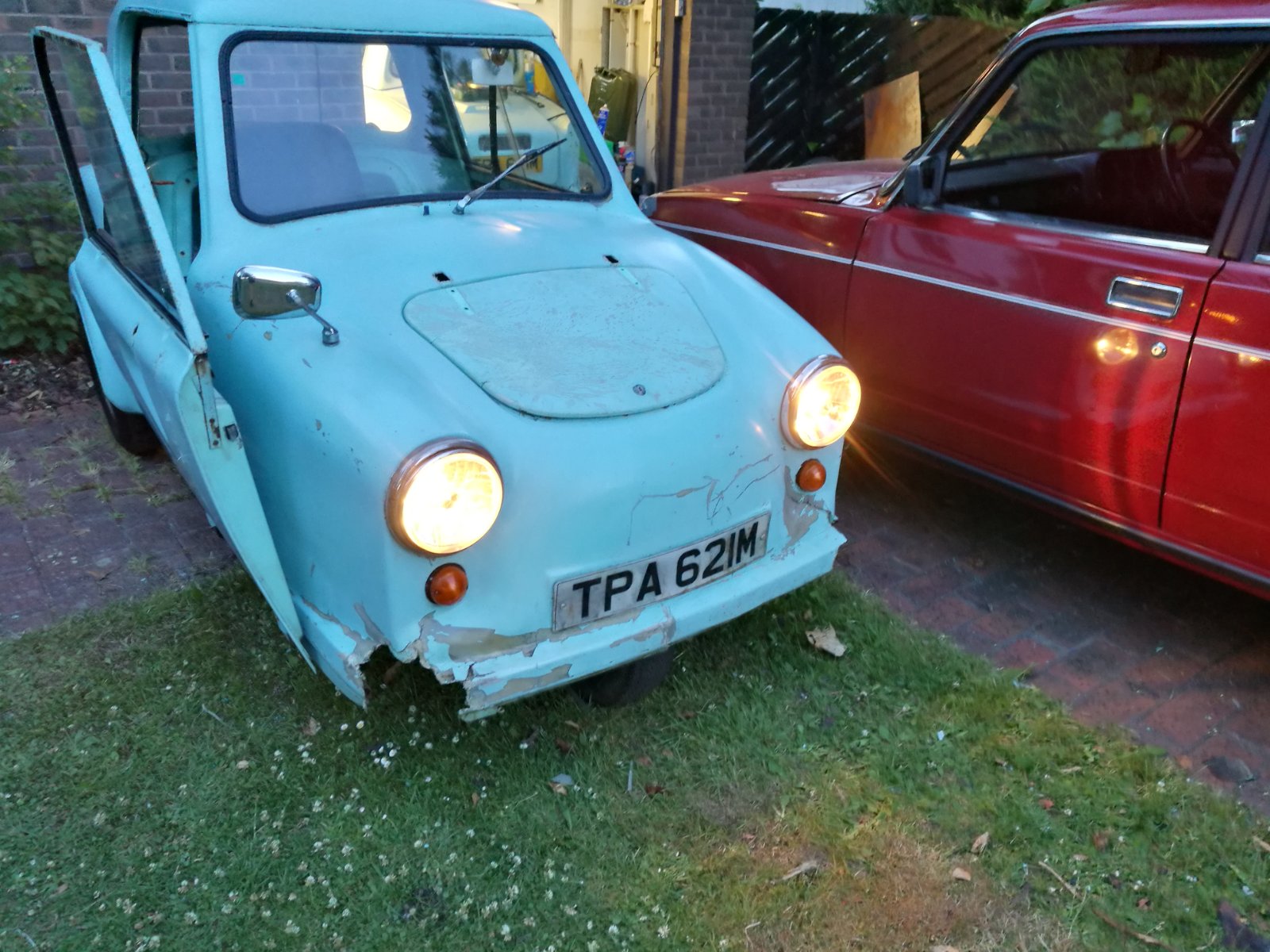

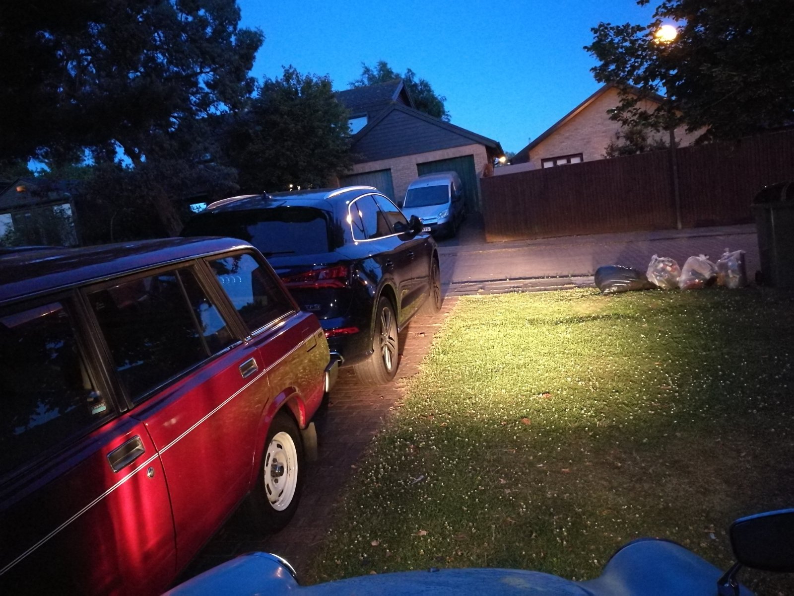

The new headlights were wired up and tested. While I'm not a huge fan of the look of them, even with my eyeballing the adjustment and running from battery only, they're rather more effective than I'd have expected - to the extent that they may well stay there.
I do plan to use this thing, so I've no adversity to the odd upgrade that's there purely to improve usability.
Like actually being able to see at night.
Dip beam:
Main beam:
A fair upgrade from standard 60s Mini headlights.

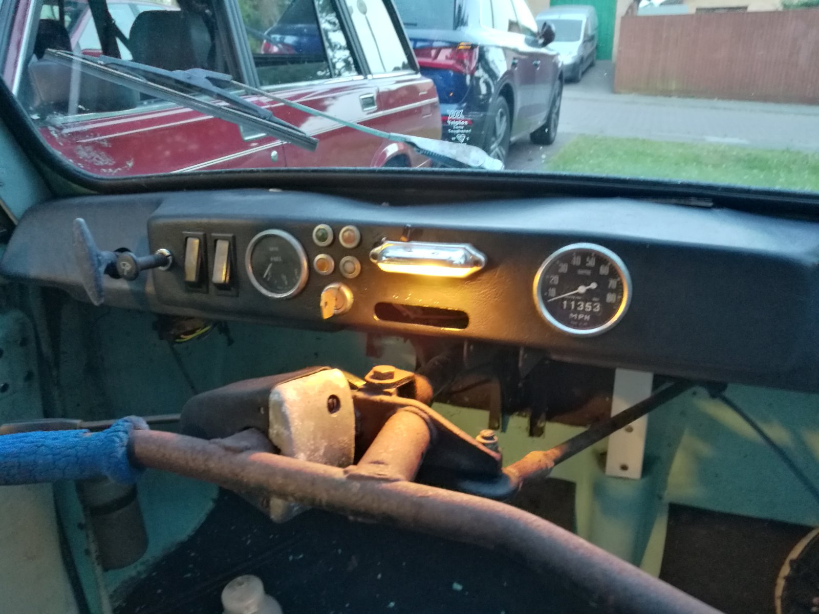

While on the subject of fixing things on the dash, I also got the courtesy light working. This was easy, just needed the lampholder contacts cleaned up.

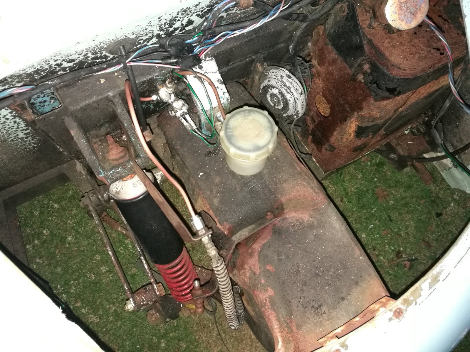

The brake master cylinder has been swapped with the one from KPL (may well be swapped again before the road, but I'd at least like to be able to have brakes around the yard in the short term). I couldn't get the mounting point for the front brake flexible hose off (the hose was torn), but as the two cars had it attached in totally different ways, I just moved the whole assembly over.
The mudguard has been pretty mangled at some point, so was bashed back into vaguely the right shape. I'll probably pull it out at some point and do a better job, but it will do for now as it's no longer actively in the way of anything.
The spring was improperly seated when I got the car, offset to one side. Quite *how* I've no idea. This was easy enough to sort though by taking some weight off it then clubbing it with a 4lb lump hammer. Cue an almighty "bong" and the spring settling back where it should be. I do have to admit to being slightly puzzled by the presence of adjustable Spax gas shocks on all three wheels...I know they tended to over engineer these crates, but still...

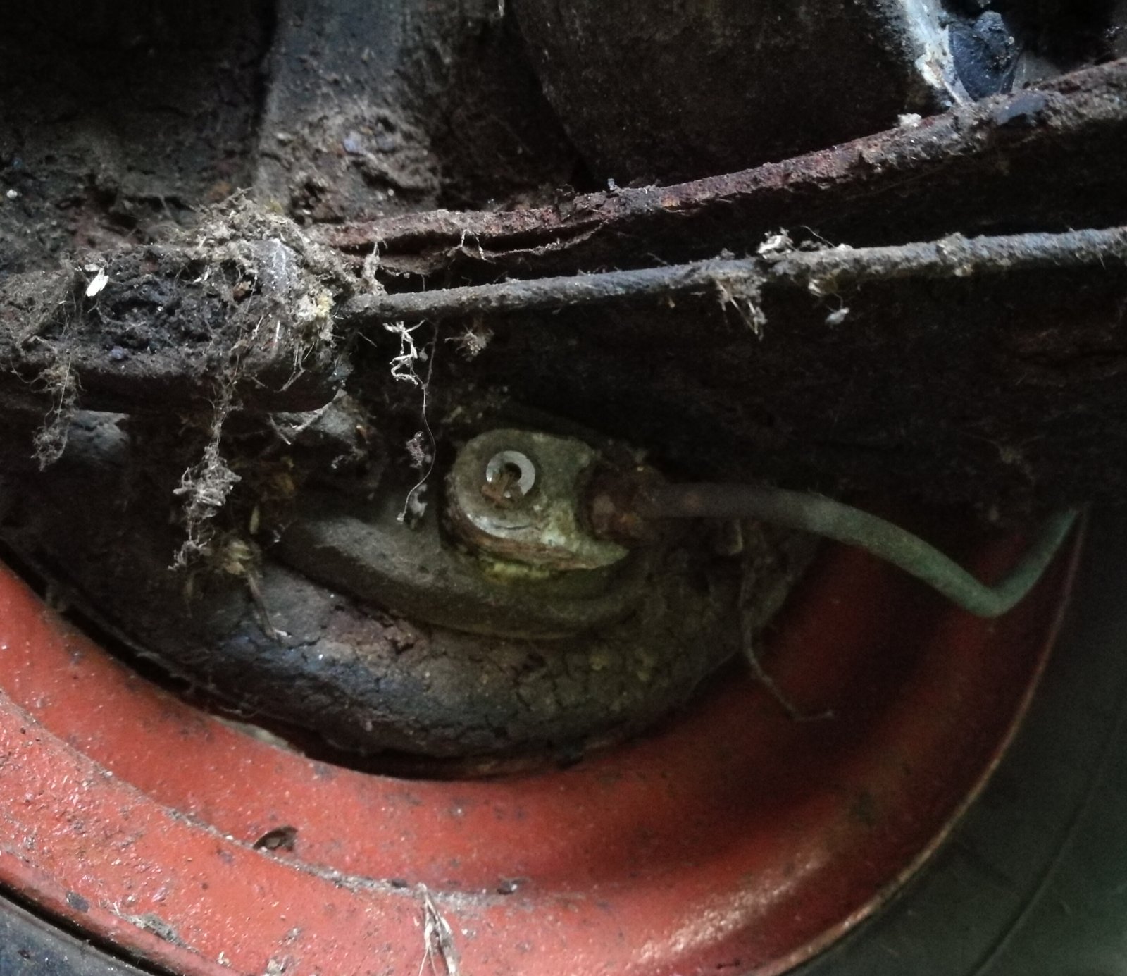

Slightly more annoying however was getting the last wheel back together this evening, only to have this happen.
Yep...bleed nipple sheared clean off.
I've got the front cylinder off the original one, but it's a bit sticky. I've got it soaking in penetrating oil overnight. It'll either work or not...if not time for a new one.

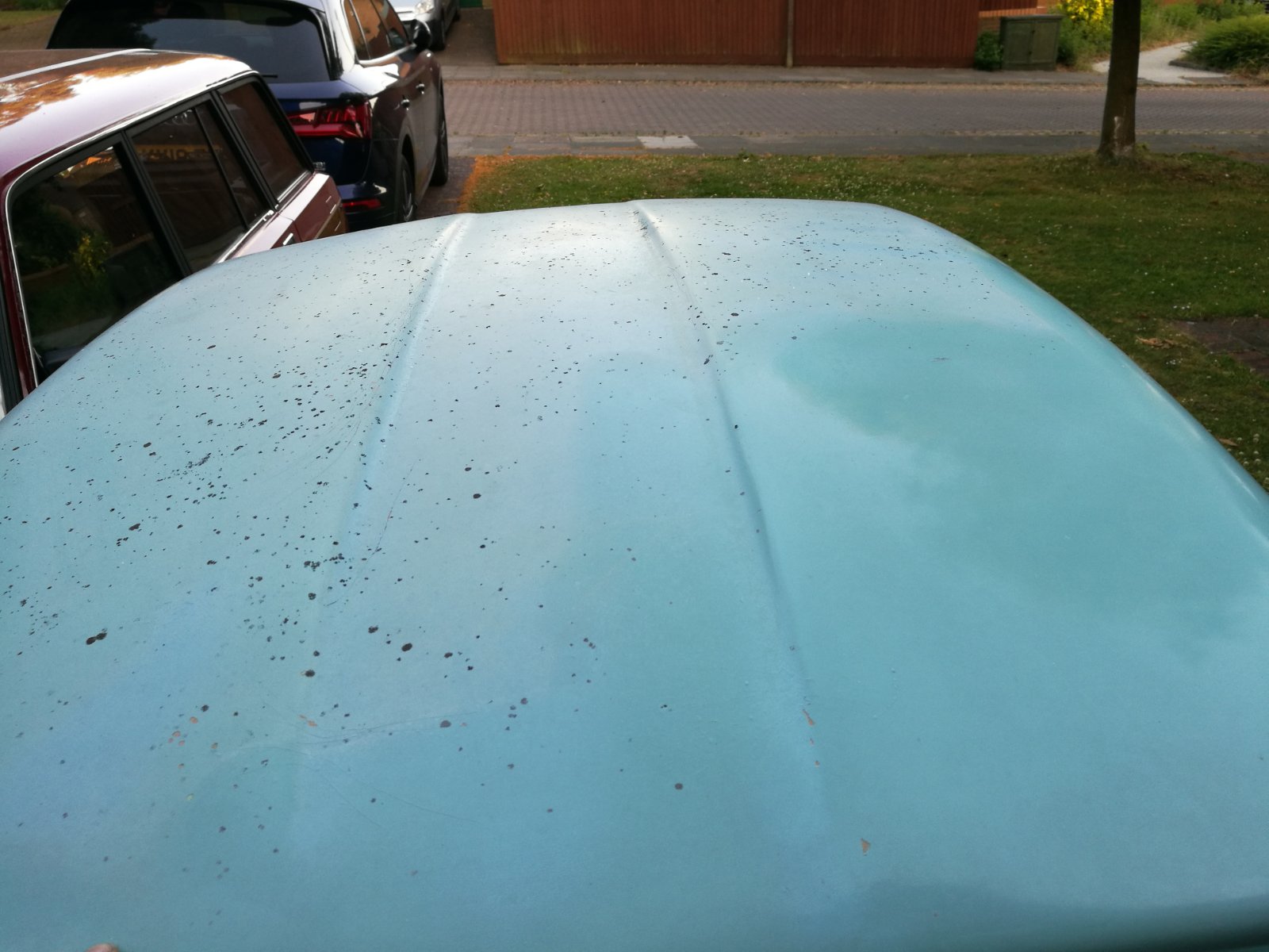

Did a quick experiment though to see if the black grime would shift from the roof.
Yep...it will! Looks like the roof might actually survive without needing a complete repaint - only panel that probably won't.
