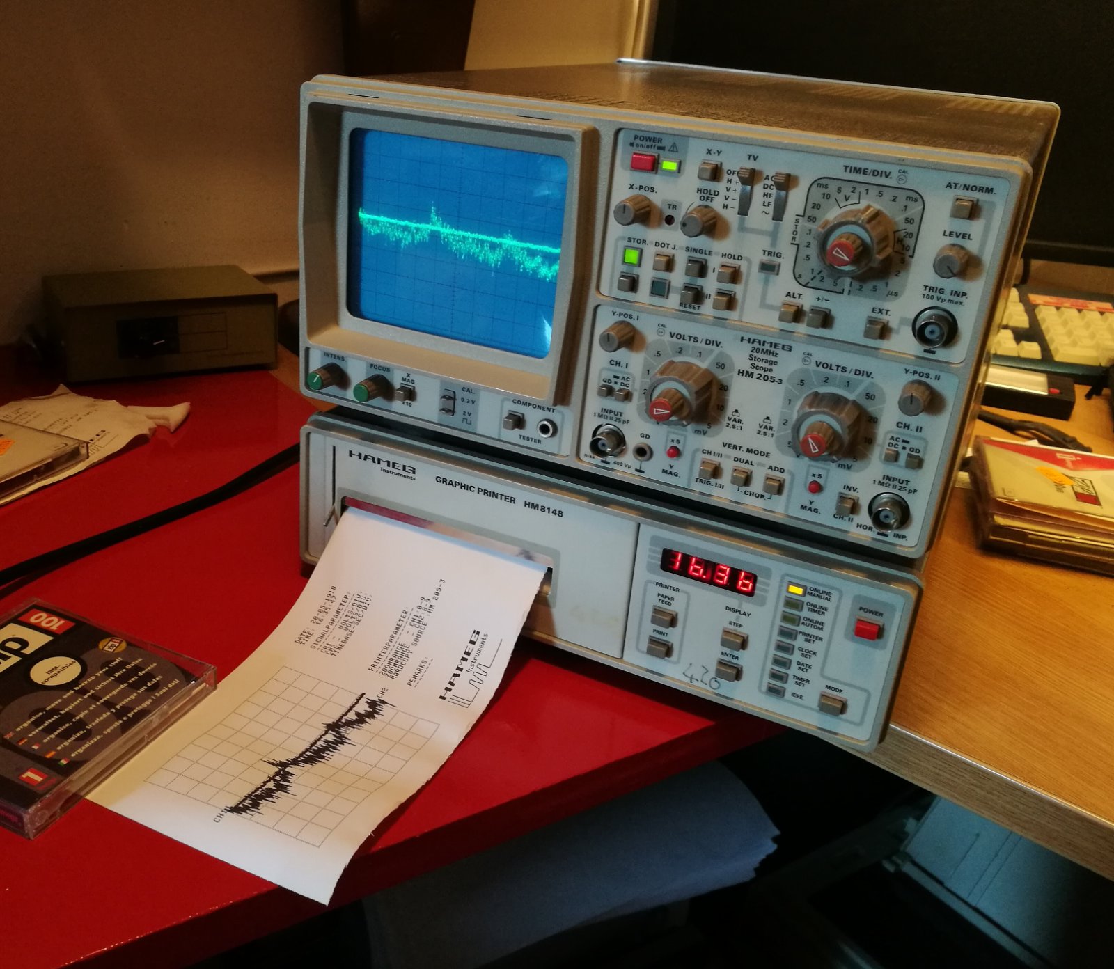

A nice little upgrade was slotted into my workstation today.
While this isn't exactly a modern DSO, it's streets ahead of the scope it replaces.
The biggest step forward is that the new scope has some basic storage facilities, which will be an absolute godsend if I'm dealing with anything digital, or anything where I need a really low sweep rate. I'd love a modern DSO, but don't have a couple of grand to throw at it...this was less than fifty quid.

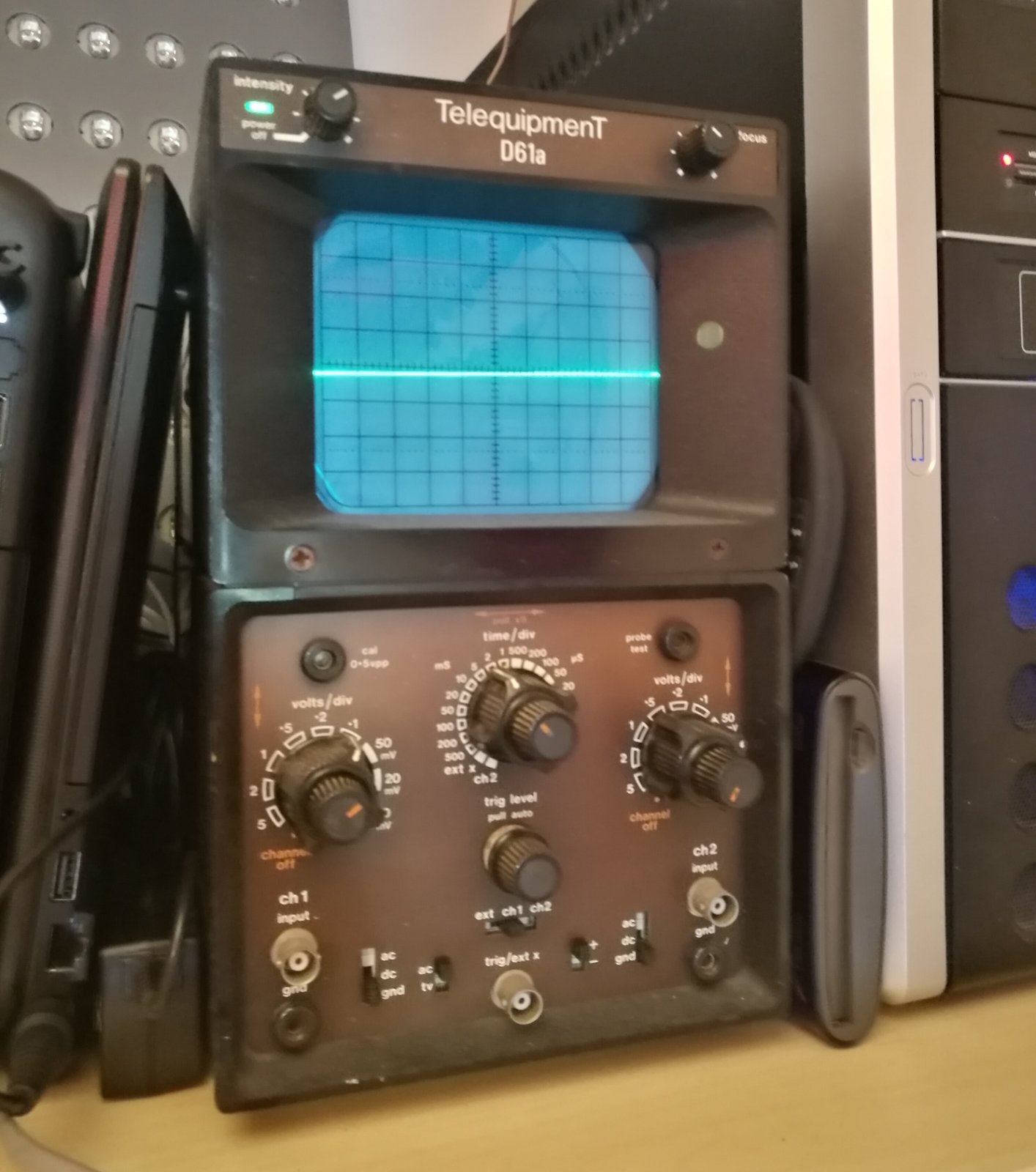

I hope to pass the old Telequipment D61a on to someone else who's getting into electronics as I was when I was given it a long time ago. It owes me nothing whatsoever, and should be fine for someone working on just radios and TVs etc.
Hard to believe given the amount of old tat I own that this is the first thing with a thermal printer in I've owned!
Tried to pick up a BBC Master, however the seller had clearly seen what they go for on eBay, so waaaaaay too rich for my blood. Likewise the ZX81. Both machines I want in the collection...but not with three figure pricetags. Which given how commonly they turn up is ridiculous... especially as they seem to spend most of their time in cupboards in folks collections.
Ps. I really need to get the scope you lent me back to you Jim!

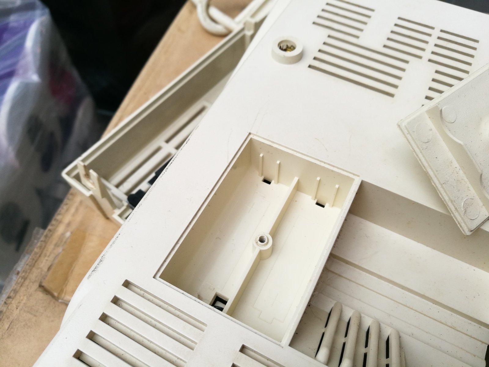

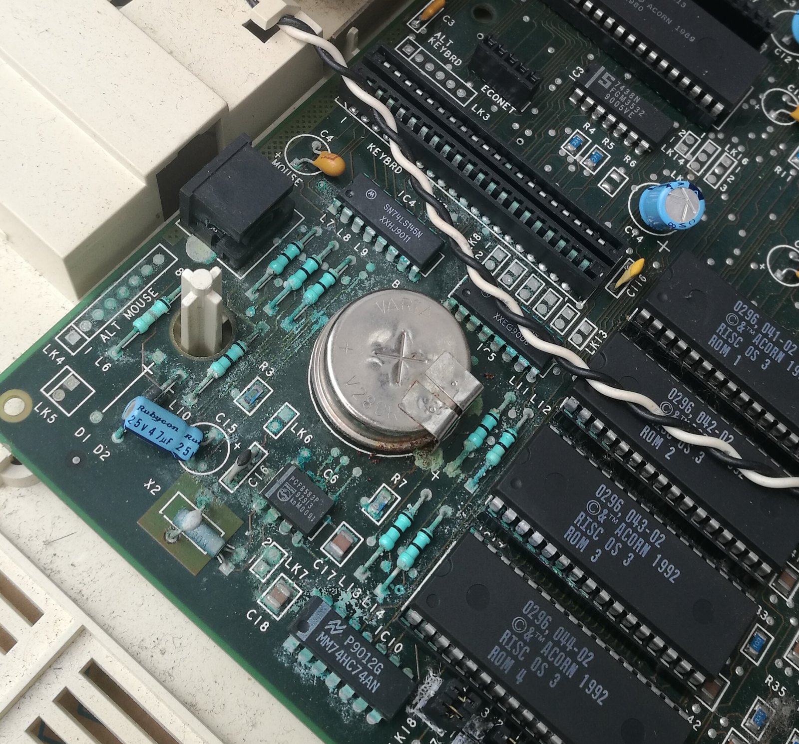

Here's a lesson: if you're putting old computing equipment into storage for a few years, don't forget to take appropriate precautions to prevent any inbuilt batteries from leaking. This problem has killed countless Amiga 500s (often totally beyond repair given the proximity to the main memory bus), and done a number on my Acorn A3000 pictured below.
Thankfully the damage appears to be pretty localised in this case. Generally just the handful of eaten traces you can see. The mouse port is an unknown quantity - but I've got a scrap machine I can Rob that from if need be. Nothing has actually rotted itself off the board - unlike on the aforementioned Amiga where I found a couple of capacitors rolling around in the case when I opened it up.
Suffice to say, if I do succeed in reviving this, a remote battery holder will be fitted so this doesn't happen again! ...easy in fact given the A3000 has an unused AA battery holder in the bottom of the case...
Fingers crossed there's not damage to internal traces on the motherboard or it will likely be beyond repair...nor easily replaced as these machines seem to fetch good money now.
Good advice that !
We have a Spectrum and an Amiga in the attic, been there for years so the damage is probably done but will check them some time in the next couple of years and see :(
I don't think the Spectrum has a battery though.

Spectrum should be fine, it doesn't have a real time clock or anything like that - so no need for a battery.
Amiga depends on which model. The A500 is the one with issues, as it has an identical Varta NiCd cell to the one that's caused this on my Acorn. I've also got an Amiga A500 Plus sitting here that's suffered the same fate. A1200 is fine as there's no battery on the motherboard - there often is on the accelerator card if fitted - but they're usually CR2023 lithium primary cells and I've never seen one leak.
The Amiga 500 is usually far harder to repair than the Acorn pictured above simply because of where the battery is situated on the board. From memory on the Amiga it's right next to the main data bus between the CPU and the ram...and the traces under the memory soldered to the board usually get nuked. Usual fault mode is a green screen on power on (which is the system telling you there's a memory fault). I still need to take a proper look at mine...

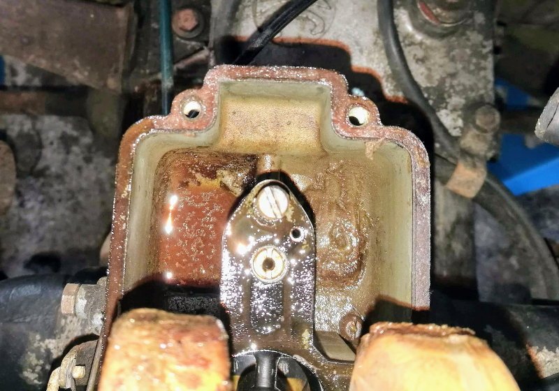

I did however get to the bottom of why the Invacar was being a nuisance last time I ran it though - this being in the bottom of the float bowl of the carb I reckon has a lot to do with it!
It's been left spotless now, and all the jets have been cleaned out again. It's not being run from that fuel tank again.
It will probably be left alone for the most part until a few weeks time when hopefully I'll have the donor vehicle here - at which point there will be some frantic activity.

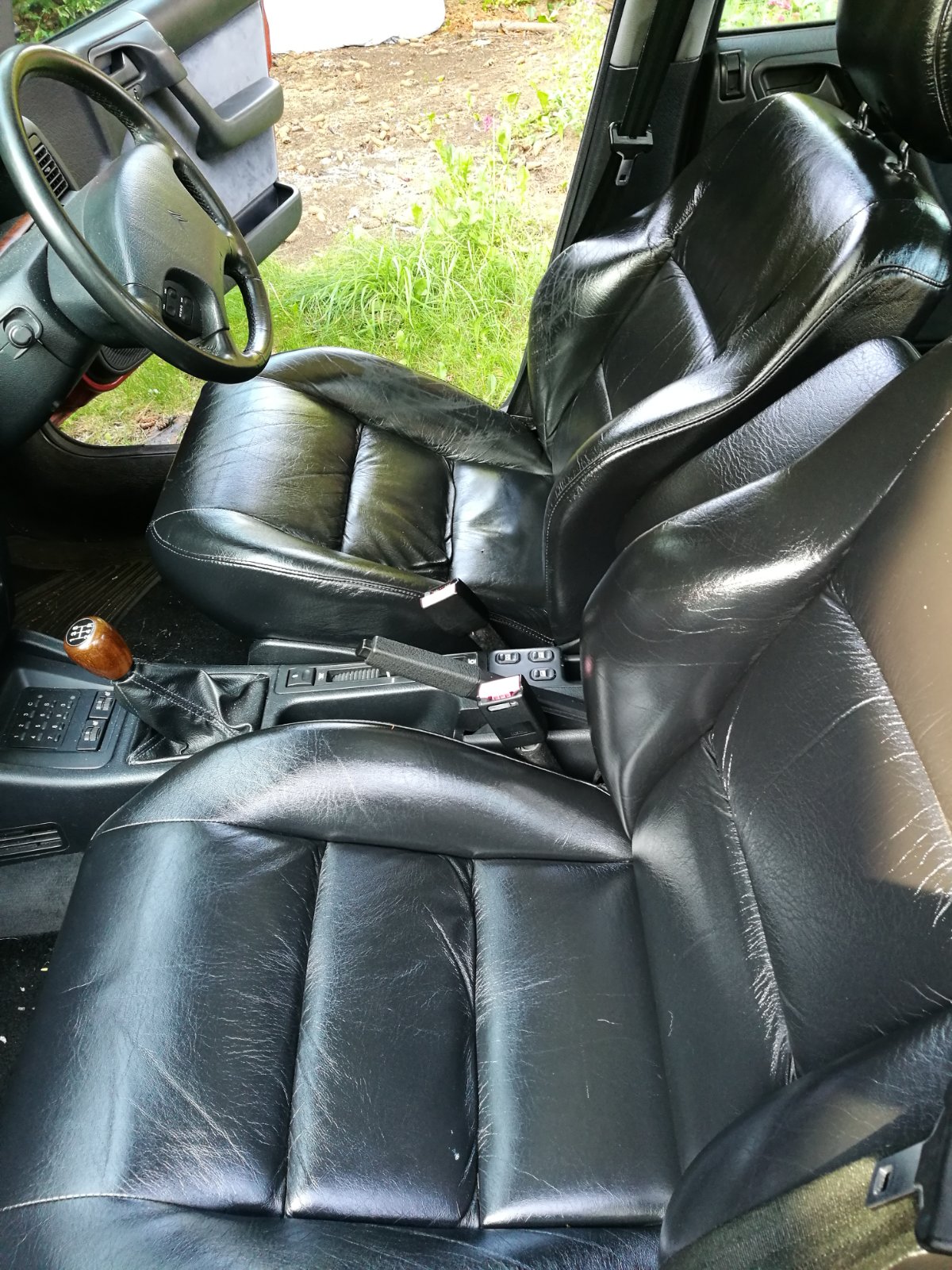

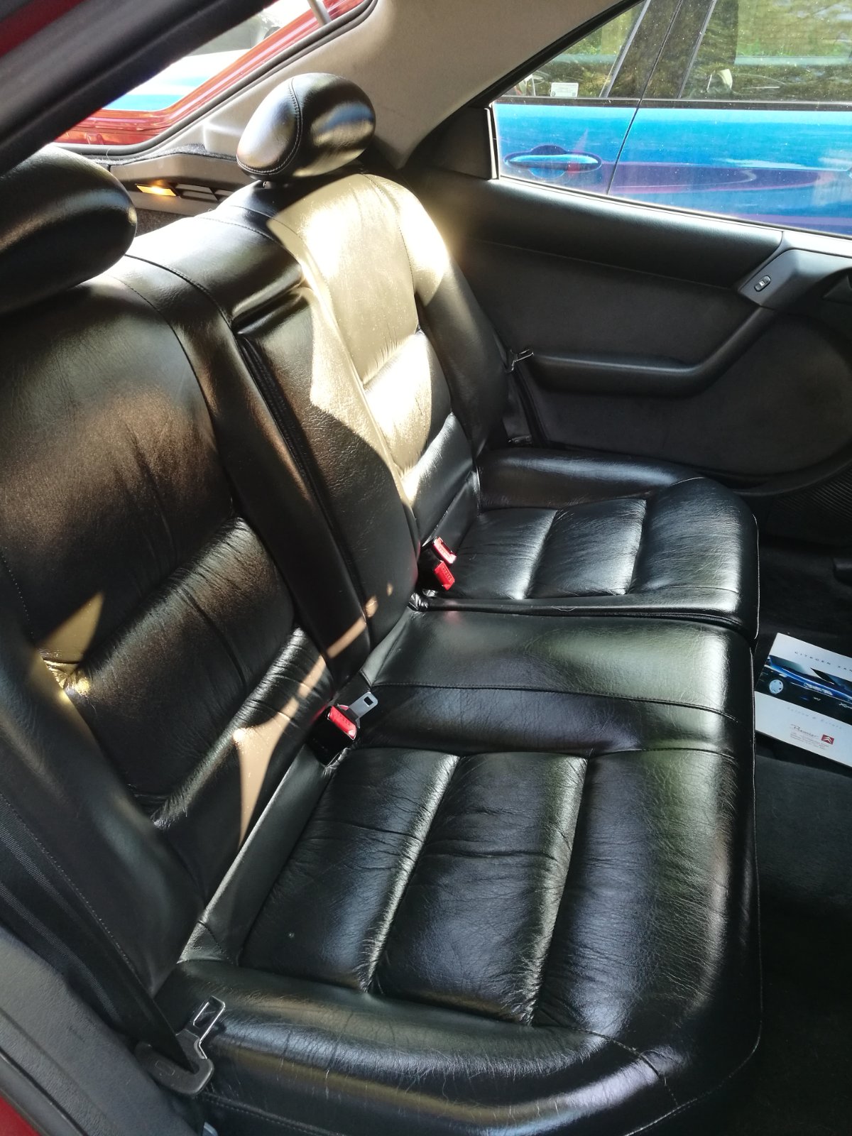

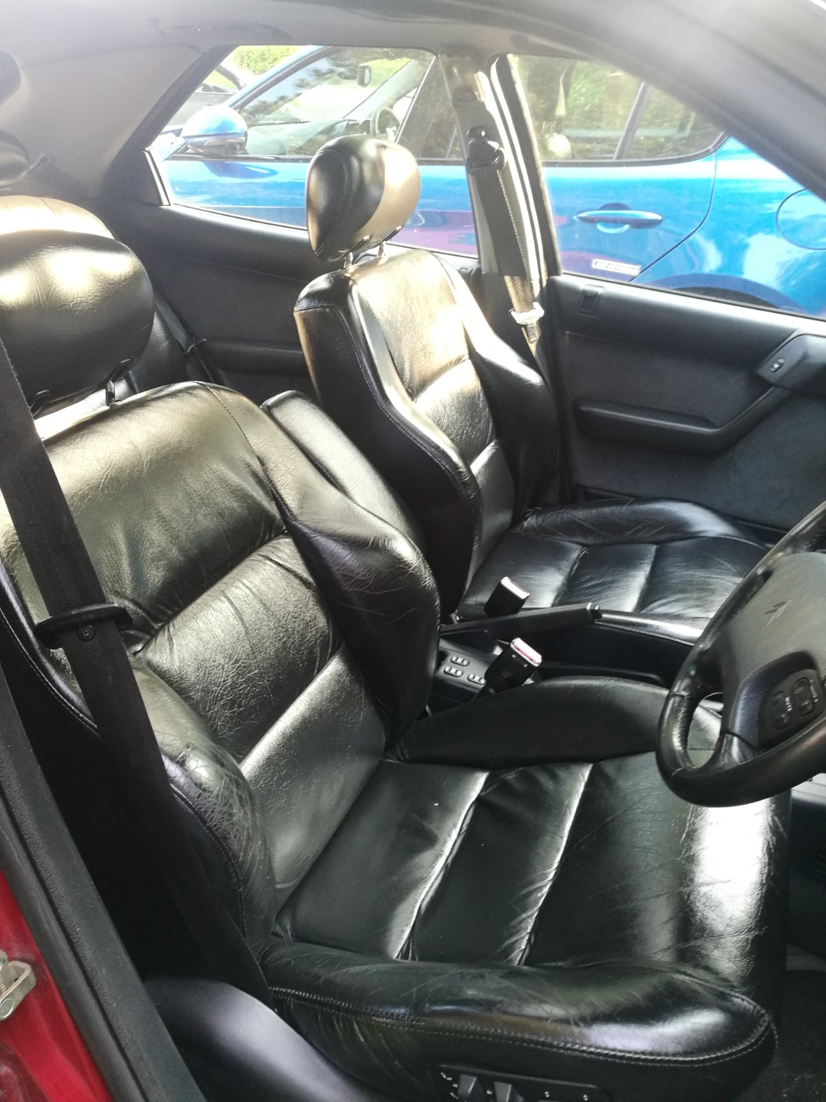

Also got a chance to give the Activa's seats a going over with the leather balm a bit later as it was getting a bit dry again.
Rest of the car still needs a good valet...but it definitely helps!

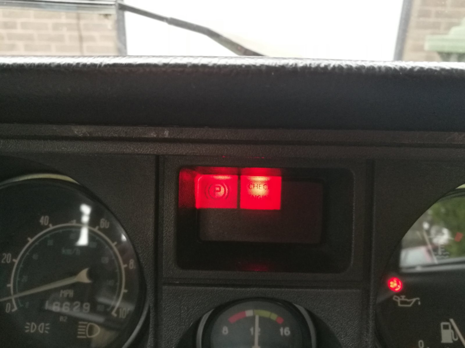

Here's a photo I'll leave you with - those of you who have been following things will know that my old ECU in the Lada resulted in no working check engine light.
Okay...we now have a working check engine light. This isn't that big a thing...the big thing is that it also means that I now have a working onboard diagnostic system.
So while it has resulted in a couple of fault codes being logged, I now know what the fault codes are! 13 - no oxygen sensor signal. Fair enough...was half expecting it to be stuffed given what the old ECU was doing. 35 - idle speed fault. Okay, that's not one I've had before...will refer to the documentation I think after the obvious cleaning of the idle air control valve and checking that the throttle position sensor is giving a sane reading.
So while we now have a fault shown, it's a fault I can actually work on rather than a vague "it's not running right" which is all I had before!
