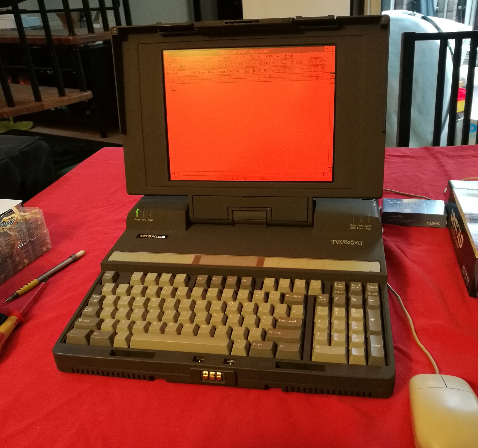

So...Lada. Waiting for the new ECU to arrive. Invacar...waiting for the donor vehicle to become available. Activa...well...working. Only stuff on that I'm really wanting to get done is a darn good deep clean in the short term.
Cleaning a car when it's tipping it down is a pain...so ignored that.
Instead sat down this evening and switched the outside world off for a bit and try to get some work done on a project that's been sitting on the back burner since late 2015.
I really struggle to get stuff done sitting on my modern machine as there are just too many distractions. The old Toshiba however just does what I tell it to, it doesn't try to be helpful or anything.
Wound up getting just over five and a half thousand words bashed out over a couple of hours and actually feel like I've made a decent dent in the project at long last. Feels like I might actually get the thing finished at some point.
The fact that I've still got a machine from 1993 that's still earning it's keep makes me far happier than it probably should do.

Gosh Zel, that Tosh brings back some memories and I was delighted to bits when I saw it for real
The weight of it is epic!
One can easily see why they were christened 'luggables'

Somehow I survived carting that thing most of the way across Aberdeen everyday for a fair chunk of my time at college. Granted I did drive a Lada at the time as well, so upper body strength was pretty much a prerequisite for surviving the drive as well...
Weight wise it's pretty much on par with what you'd expect given what's crammed into the box - essentially a reasonably well specified 386 based desktop for the time.
I've a massive soft spot for portable machines from this era (or any hardware for that matter), so if you ever do see or hear one destined for the recycling bin, save it! They do still turn up from time to time believe it or not.
I really do need to reassemble the Toshiba T-1200... that's a couple of generations before the 5200 above, running an 80C86 at a whopping 3MHz, a 720K floppy drive, 640k of memory (and 512K extended I think) and a 20mb hard drive. It got taken to bits years ago due to a power supply problem (leaky caps unsurprisingly), but never got reassembled at the time.
Much though I enjoy these machines, they can be utterly maddening to work on sometimes...unlike desktops of the time they were often very much not intended to come apart again.

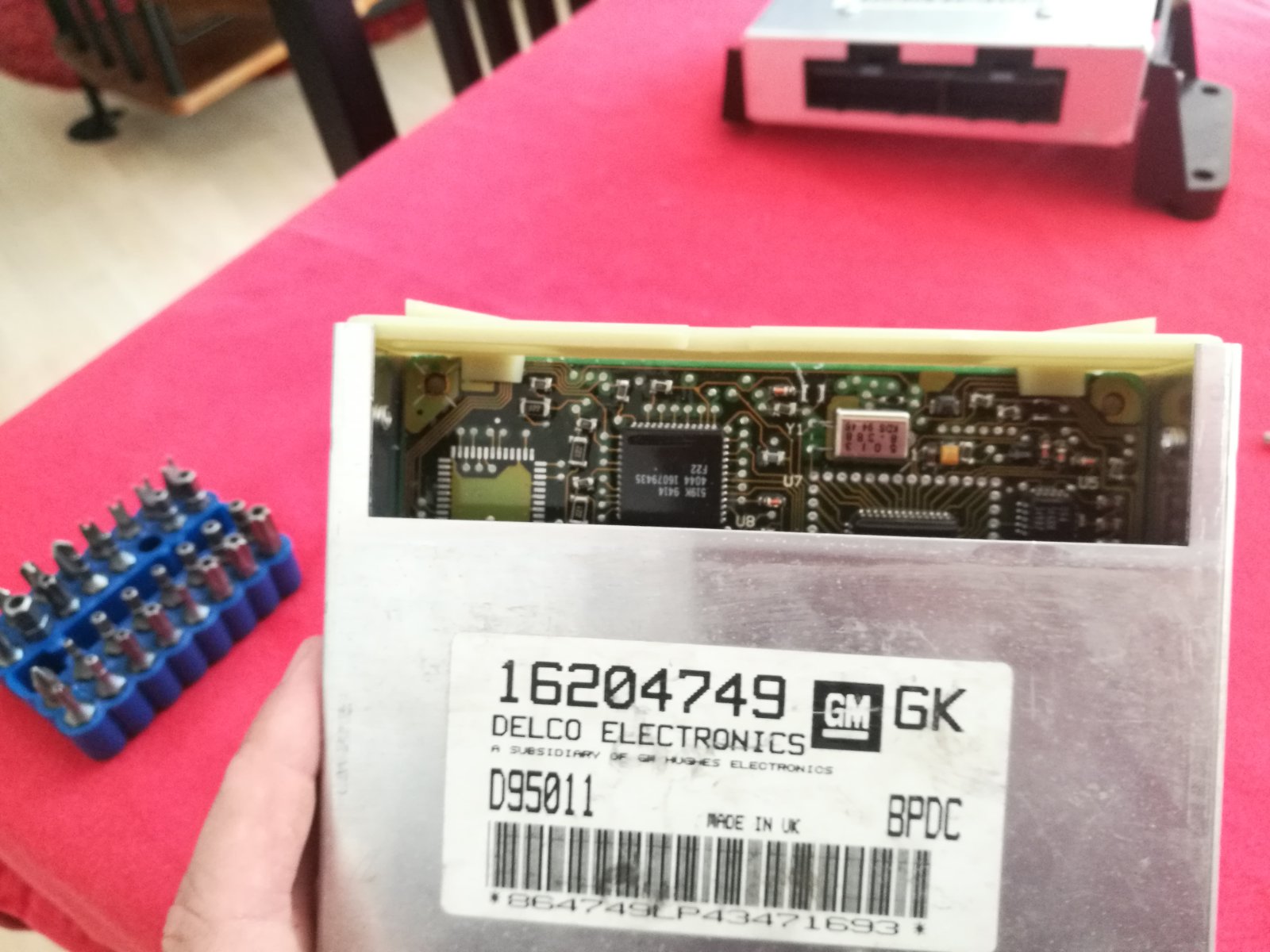

New ECU arrived. Unfortunately it's totally different inside the case, not least in that there's no plug in modules for config data etc...back to the drawing board on that one...unless anyone knows someone who knows anything about 90s era Vauxhall/Opel ECU setups...

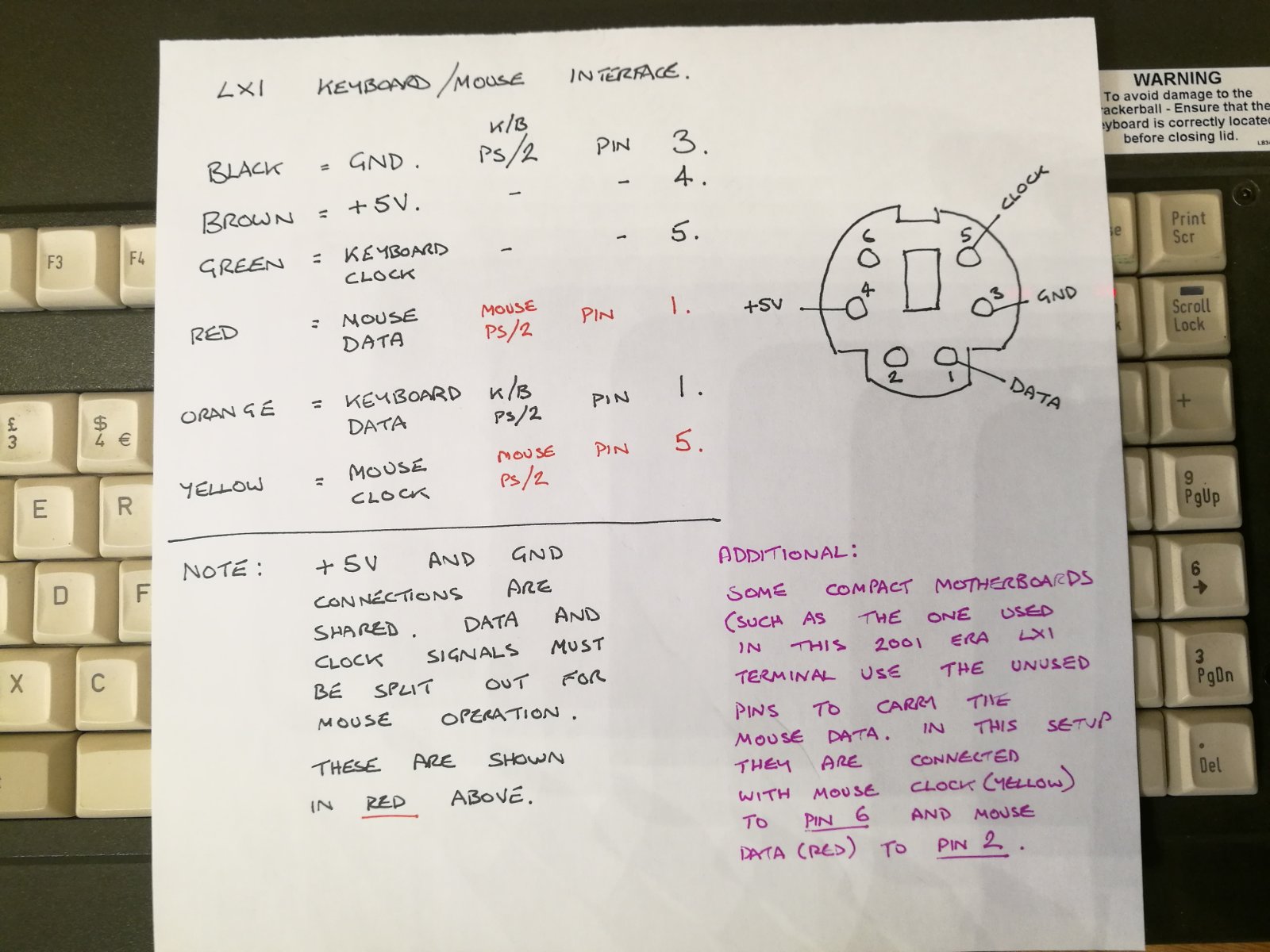

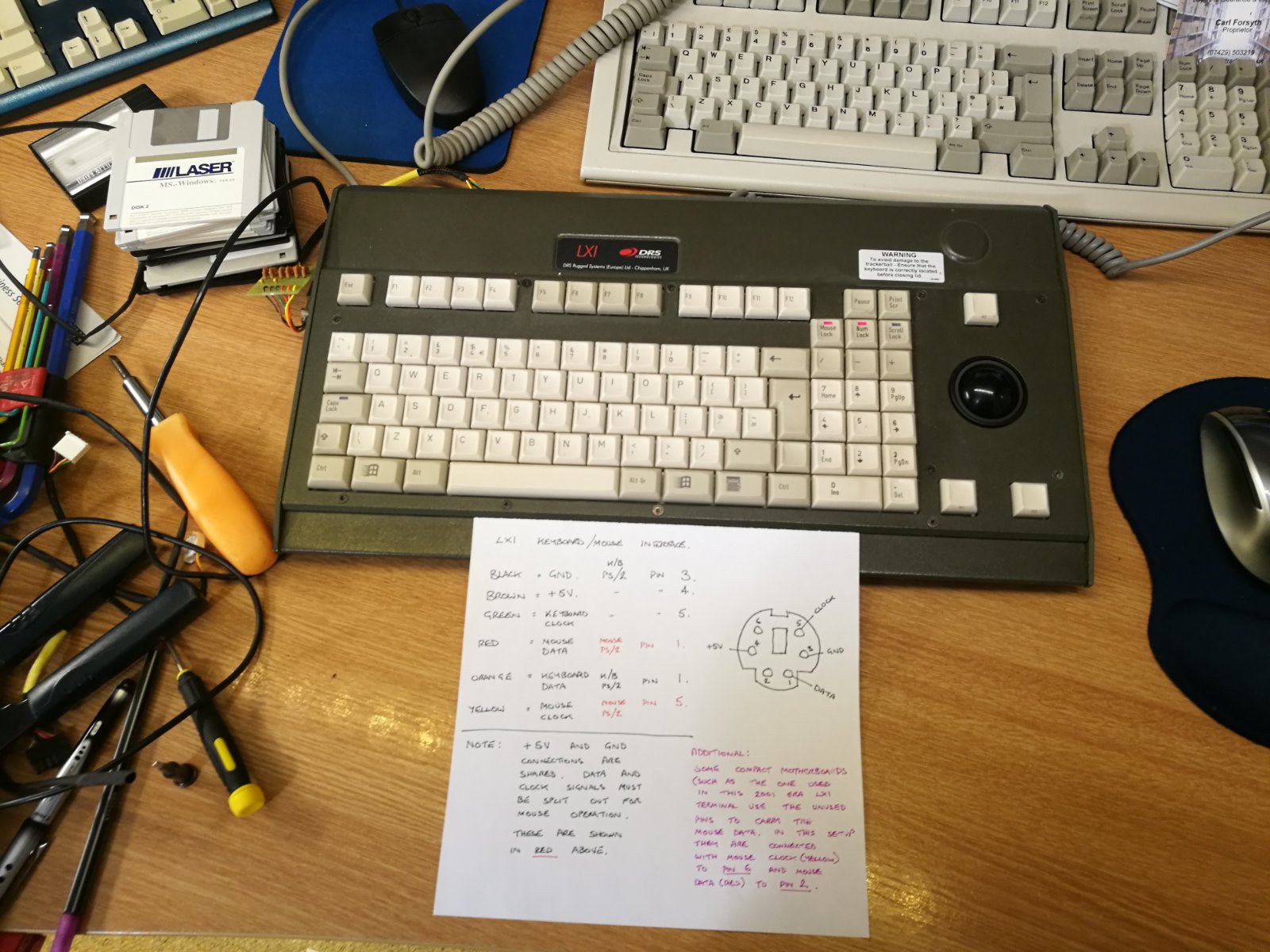

Was determined to get something done today that would actually work, so finally got around to attacking the keyboard/mouse assembly from that DRS LXI ex military laptop I picked up a while ago. I was pretty certain it would turn out to be a perfectly normal PS/2 device based on what it was plugged into - essentially an off-the-shelf multi purpose industrial PC motherboard. Just in a very special case with some specialised expansion boards.
Sure enough, a bit of poking around to reverse engineer it (as I couldn't find a wiring diagram online anywhere) had it figured out.
Totally pointless project...but I'll figure something out to do with it...

I still have one of those Fujitsu keyboards. It got very good reviews from PC Pro (whenever they evaluated a PC with that keyboard it got a mention). They were not cheap (£30, back in the nineties) but very solidly built. I have stripped mine down, and they are not simple. Key cap, key head, spring, spring cup, rubber membrane, contact membrane, and steel backing plate. If you type like you hate the keyboard all you will get is bruised fingers!
When I built my Mums' first PC I suggested she try out various keyboards, to find one she liked. After a while she told me she hadn't found one she could get on with, so I suggested she tried my Fujitsu keyboard. She started using it (tentatively at first, but then getting faster), and the last thing she typed before talking to me was "One day my Prince will come. Heaven help the poor bastard!", and then she asked me if I could still get hold of these keyboards. I said I wasn't sure, and she replied that, if I could not I would need a new keyboard as she wanted THIS one. I was able to get her a new Fujitsu keyboard.
