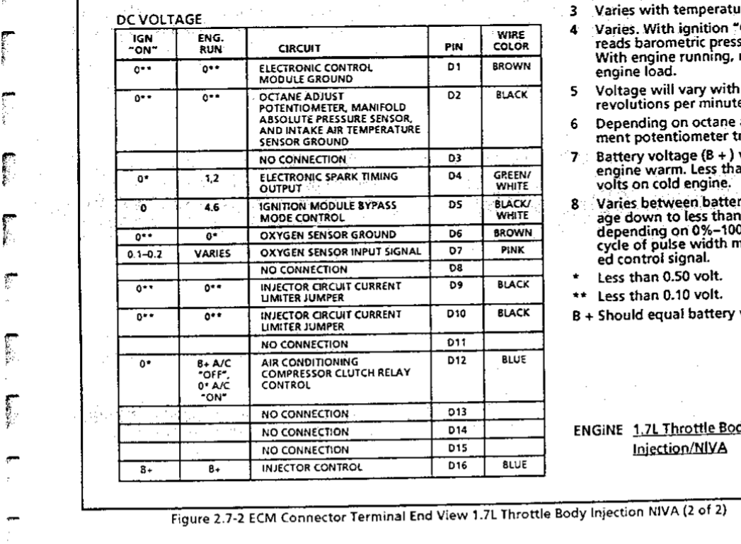

Interesting. Think we may be homing in on the issue. Looking at the terminals for the lambda sensor on the ECU, D6 is the ground terminal and D7 is the signal. D6 is floating resolutely at 1.5V above ground...this should show as no more than 0.1V according to the manual...
If there's a 1.5V offset being applied to all the lambda readings no wonder it's struggling!
EDIT: Having done some further reading showed that terminal D6 should be a solid ground, going via the ECU then straight to the main injection ground point, bolted to the side of the block on the coil pack bracket.
Tying this terminal to ground directly (I'd nothing to lose by this point really!) did change the behaviour of the car, it's now running even *more* rich, and idling like a carb car with the choke left on. No sign of a proper lambda signal, the sense line is just stuck showing 0.7V...again that voltage appearing from within the ECU rather than the sensor itself it seems.
I think we're at the point now that given I know it had other issues as well (by virtue of the dead check engine light) that I really need to track down a known good ECU before I can chase this any further. Realistically I'm just going to be chasing my tail otherwise.
...It's *entirely* possible that I've just successfully found the fault which took the donor vehicle for most of my injection kit off the road originally!

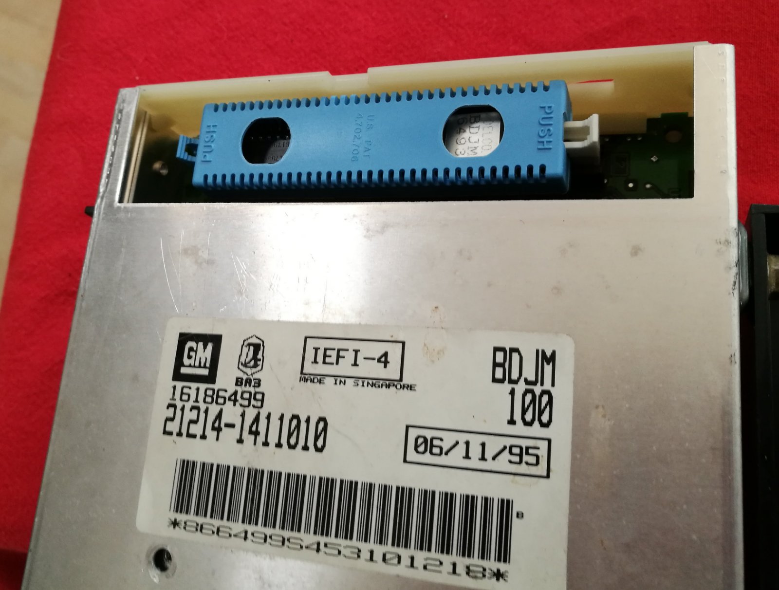

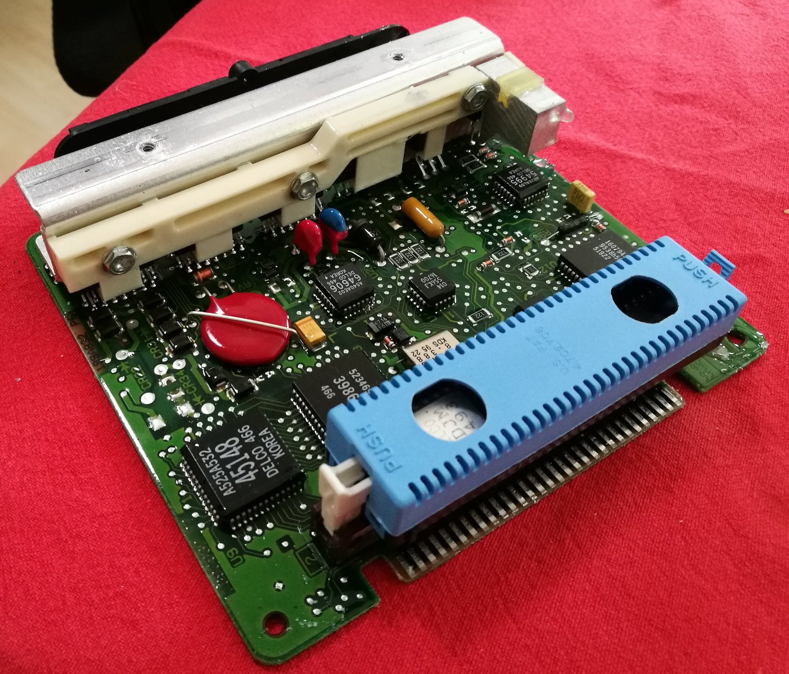

Well, for the sake of £15.99 plus postage, I've grabbed a Corsa B ECU. It should be pretty obvious if I pull the case off if they're radically different.
The manual even states "to allow the same unit to be used in multiple models of vehicle, a unique engine calibrator is fitted..." which adds credence to my theory that they're identical units save for the label on the front and the module plugged into the slot at the top.
This little blue thing I reckon is the important, Lada specific bit...
...and out of the case.

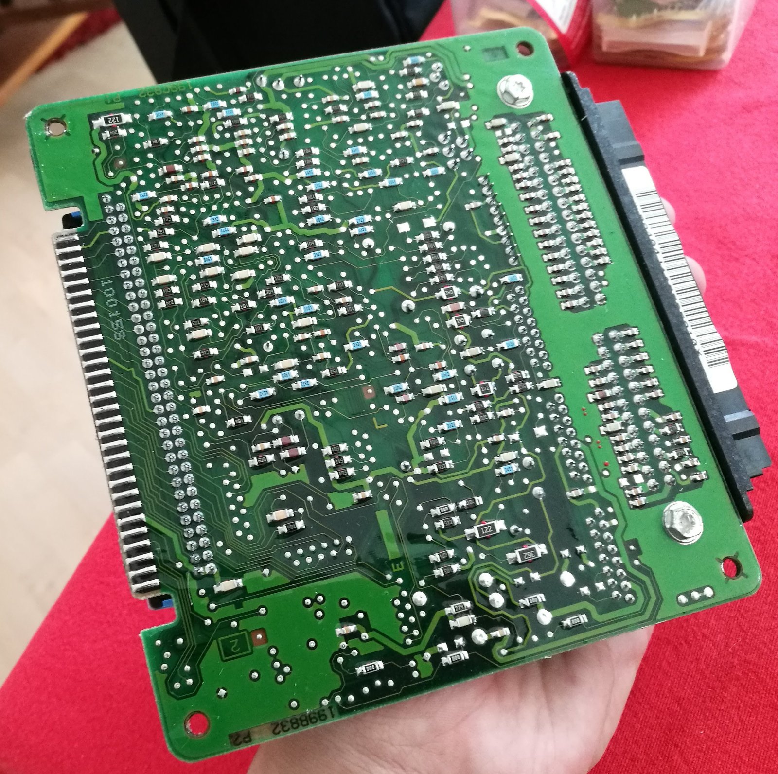

Back of the board. Not much here save for a shedload of bypass caps.

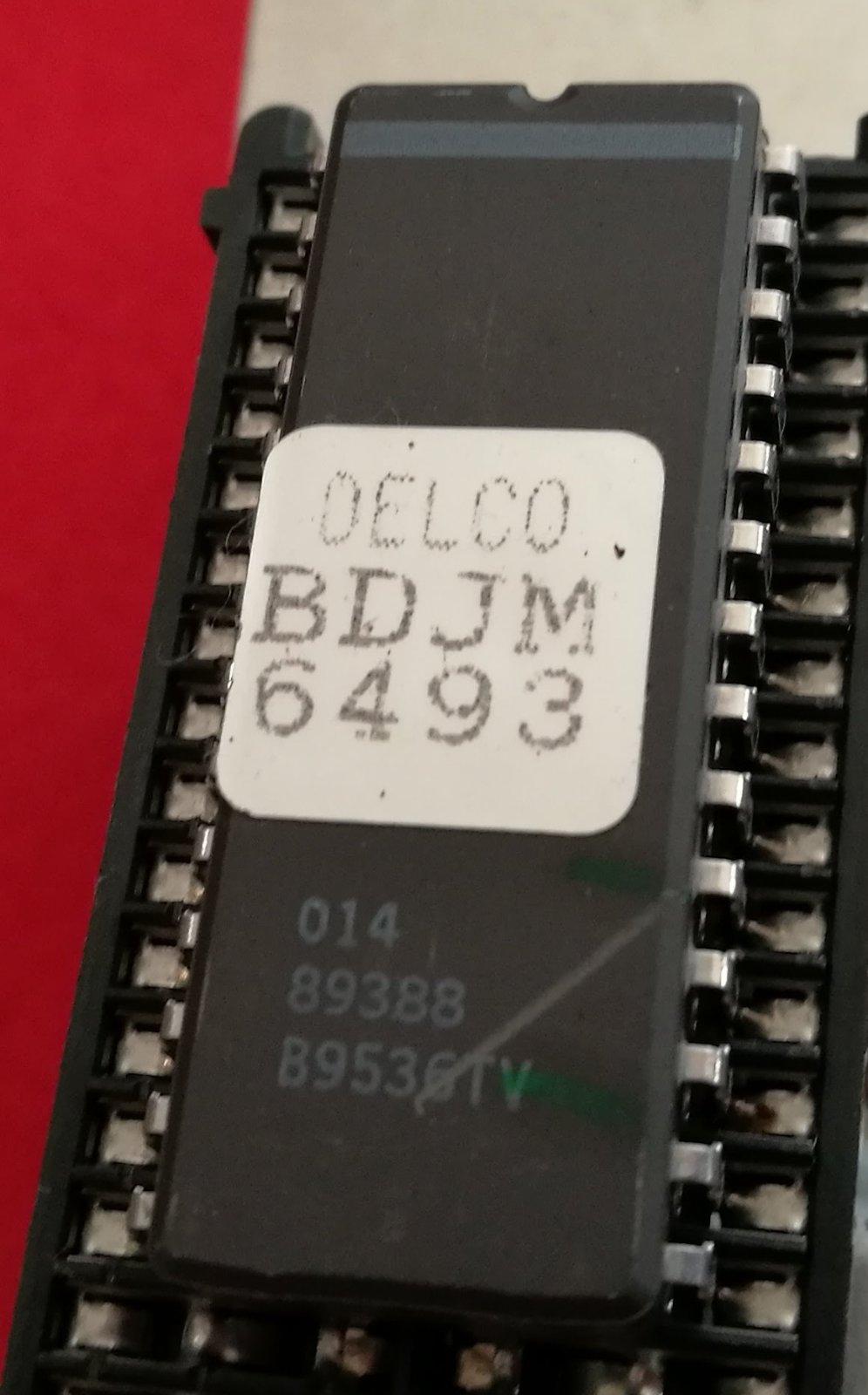

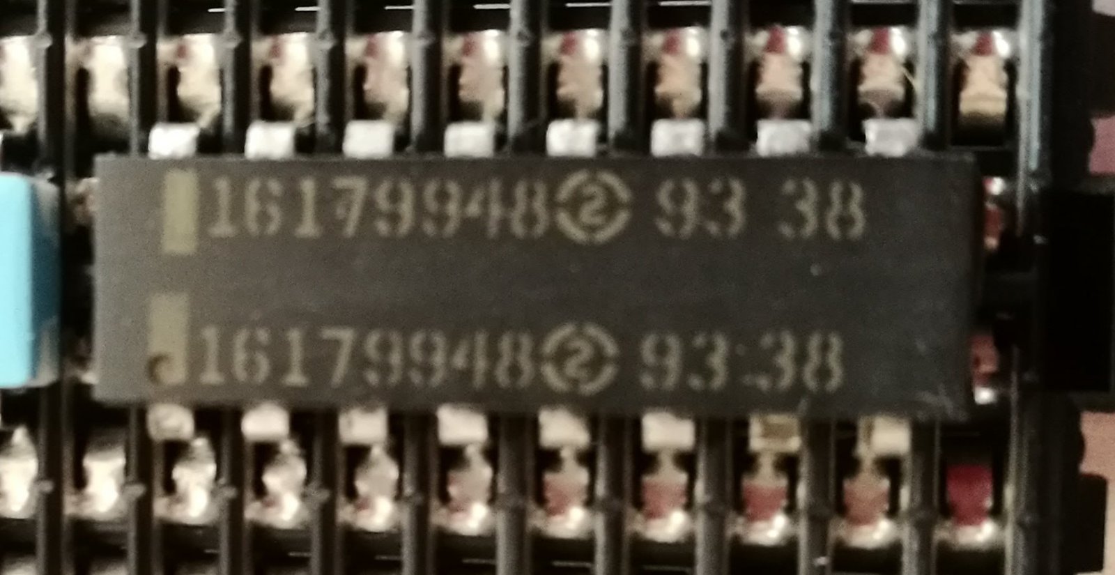

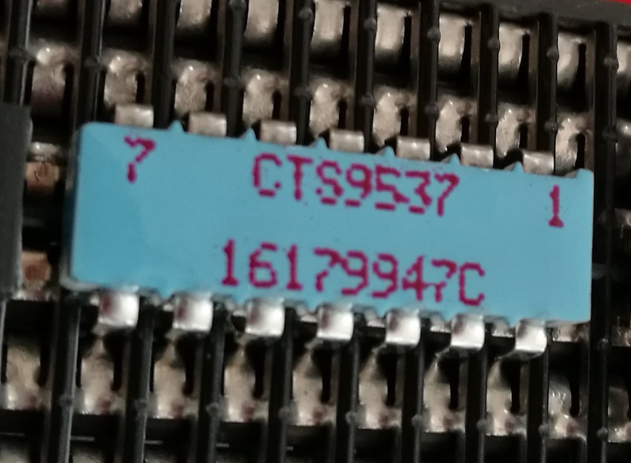

For those into their electronics, here's a closeup of the three ICs in the plug-in module.
If this isn't a PROM of some description I'd be extremely surprised... I'd say this was a resistor network from the package style alone... Not so sure about this one... I reckon the issues I'm having are buried somewhere within the plethora of semiconductors down by the connector sockets, sadly they all seem to have custom part numbers on, which makes it hard to tell what they're meant to be to allow meaningful testing. I hate it when manufacturers of complex devices do that. Yes, HP, I'm looking at you with regards to your 80s era test equipment too.

Re: Zel's Fleet Blog - Xantia Activa, Lada Riva, Sinclair C5 & AC Model 70 Restoration in Progress
Zelandeth wrote: 10 May 2018, 15:30 If this isn't a PROM of some description I'd be extremely surprised...
Yes, I'd say so too
Yes, I'd agree
Not one I've seen but it may be a protection device to eliminate spikes and noise on the incoming signal wires before they reach the ECU proper...
First port of call has to be bad/dry joints Zel...
And then poor earths within the ECU. Also try reseating those three plug-in ICs
Zelandeth
- Posts: 5286
- Joined: 16 Nov 2014, 23:36
- x 1591
Already on that track Jim. The quality of the solder work in there is actually astonishingly good. There really aren't any even vaguely suspect looking joints.
Reseating those ICs has already been tried...I did wonder if it was something that daft as it wouldn't be the first time, sadly I'm not that lucky it seems.
Tracing out the ground paths definitely isn't a bad idea...Will pull the heatsink off when I get a chance and see what we can find.
