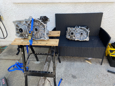

Naughty and (hopefully) innocent gearboxes together for a photo…

Ditto from me Simon, your horse was a much more sturdy and stable beast, than the pic of the first piece against the wall :-D

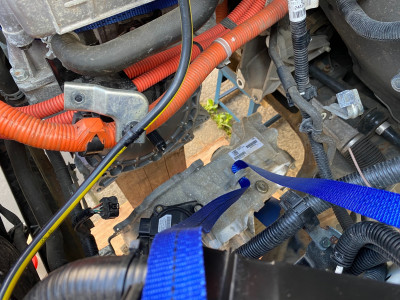

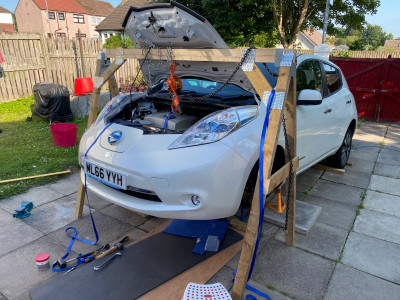

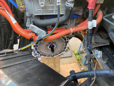

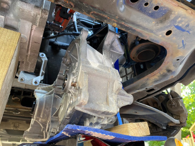

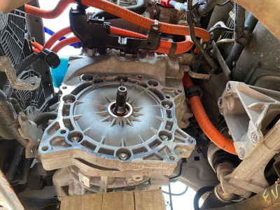

Here's a few photos from today:
Quite a lot of room to work in the "motor bay" on the Leaf. There are only a couple of bolts at the top of the rear engine mount that are quite hard to get to, everything else is straight forward to access.
