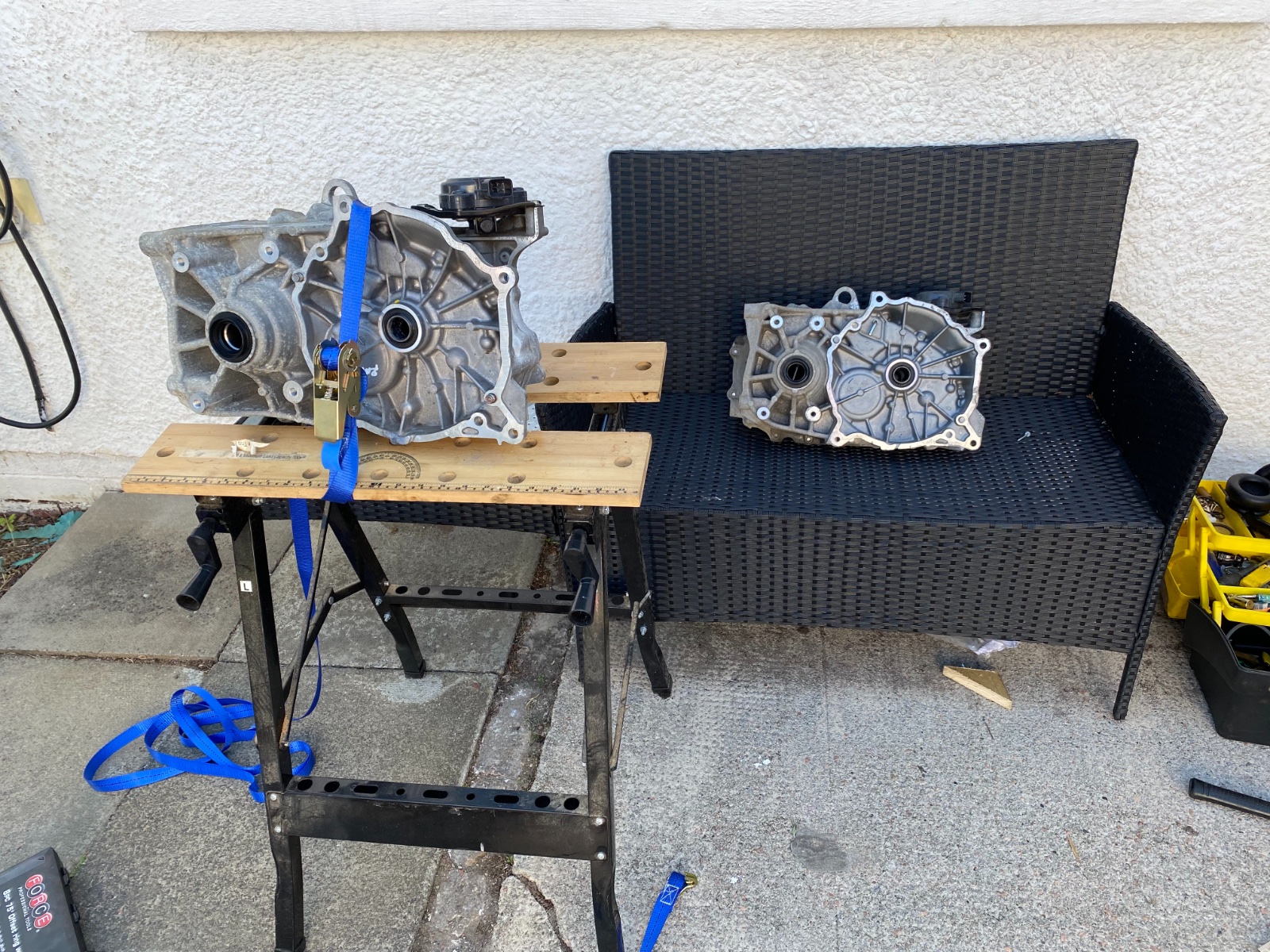

Naughty and (hopefully) innocent gearboxes together for a photo…

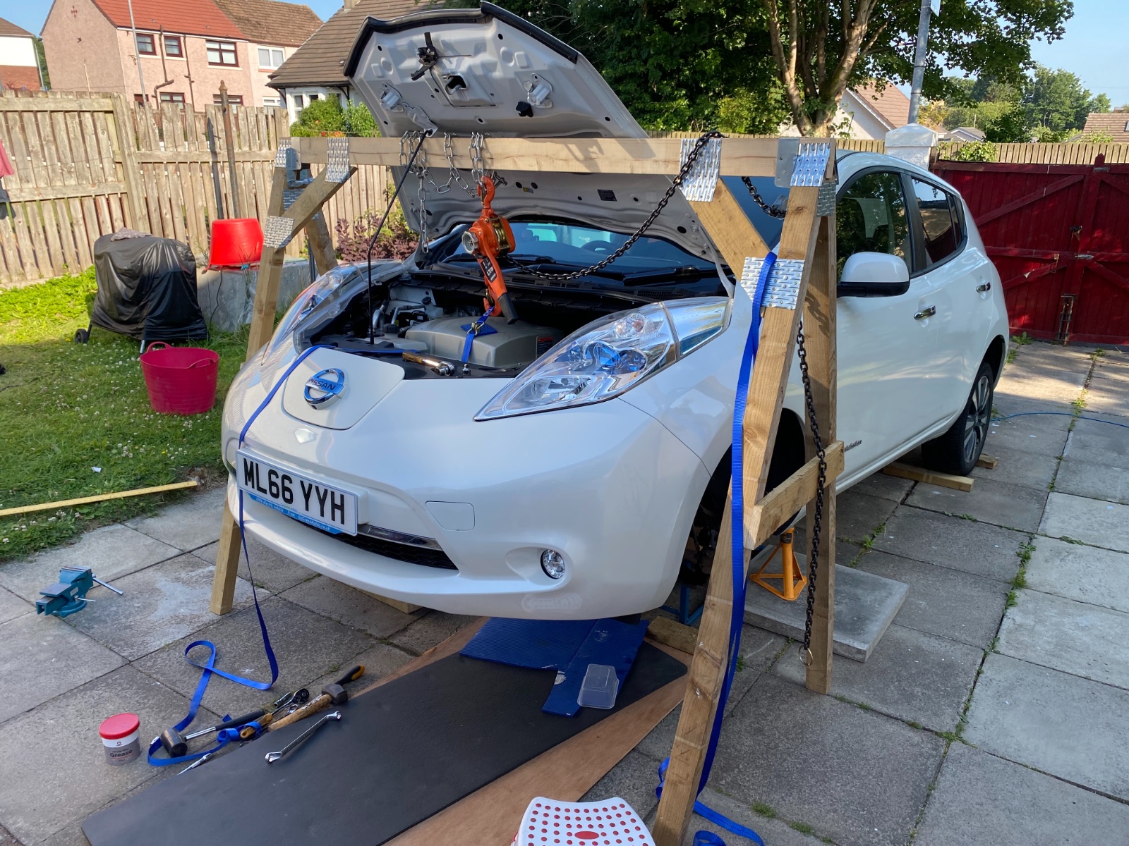

I’ve actually got the new gearbox in already just going around torquing up bolts, refitting brackets etc.
Took far longer today finishing building the support horse than the actual gearbox swap bit. :lol:
The chain winch from above worked a treat.

Ditto from me Simon, your horse was a much more sturdy and stable beast, than the pic of the first piece against the wall :-D

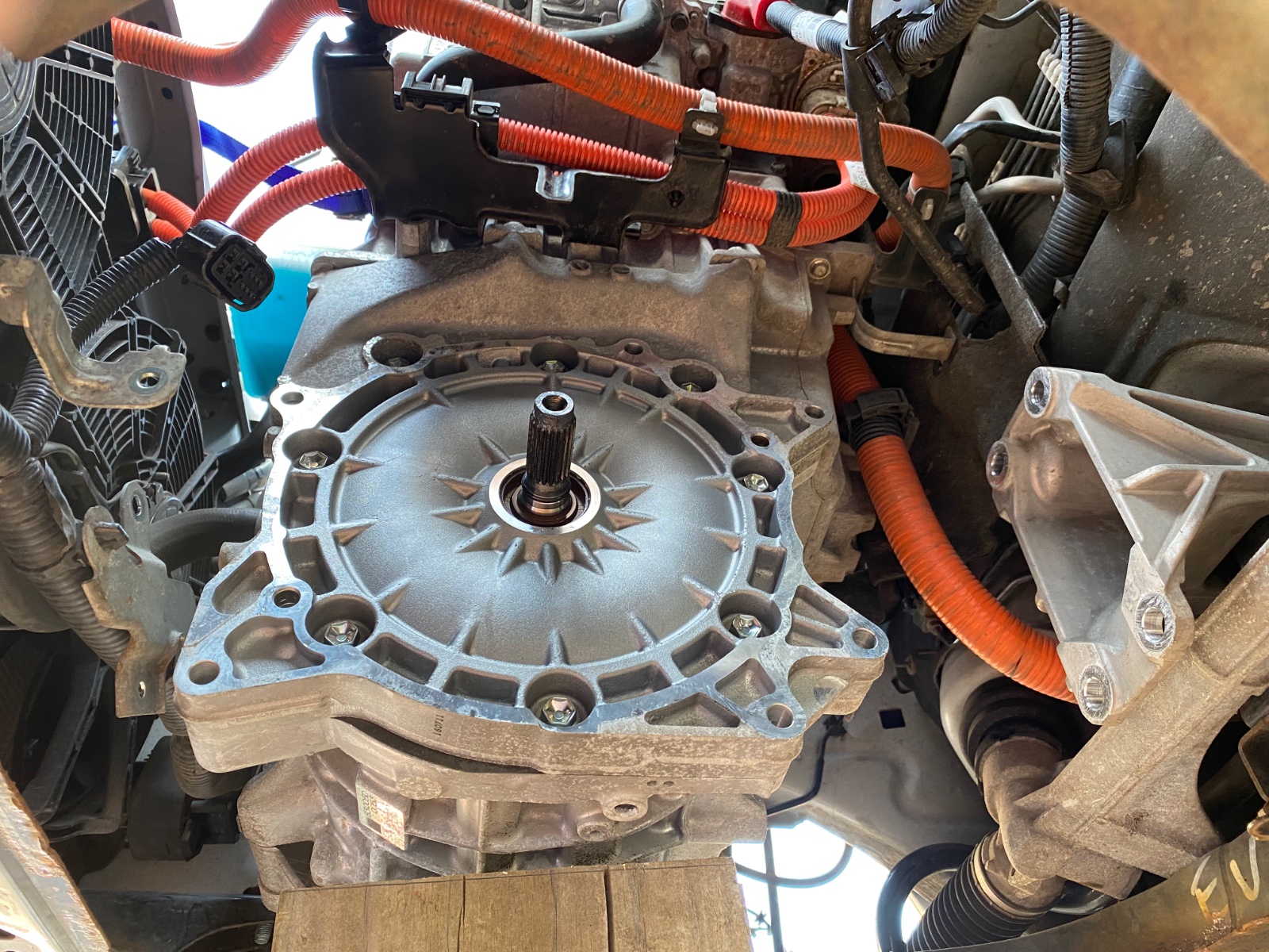

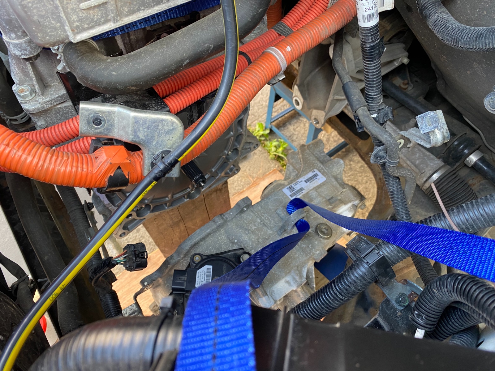

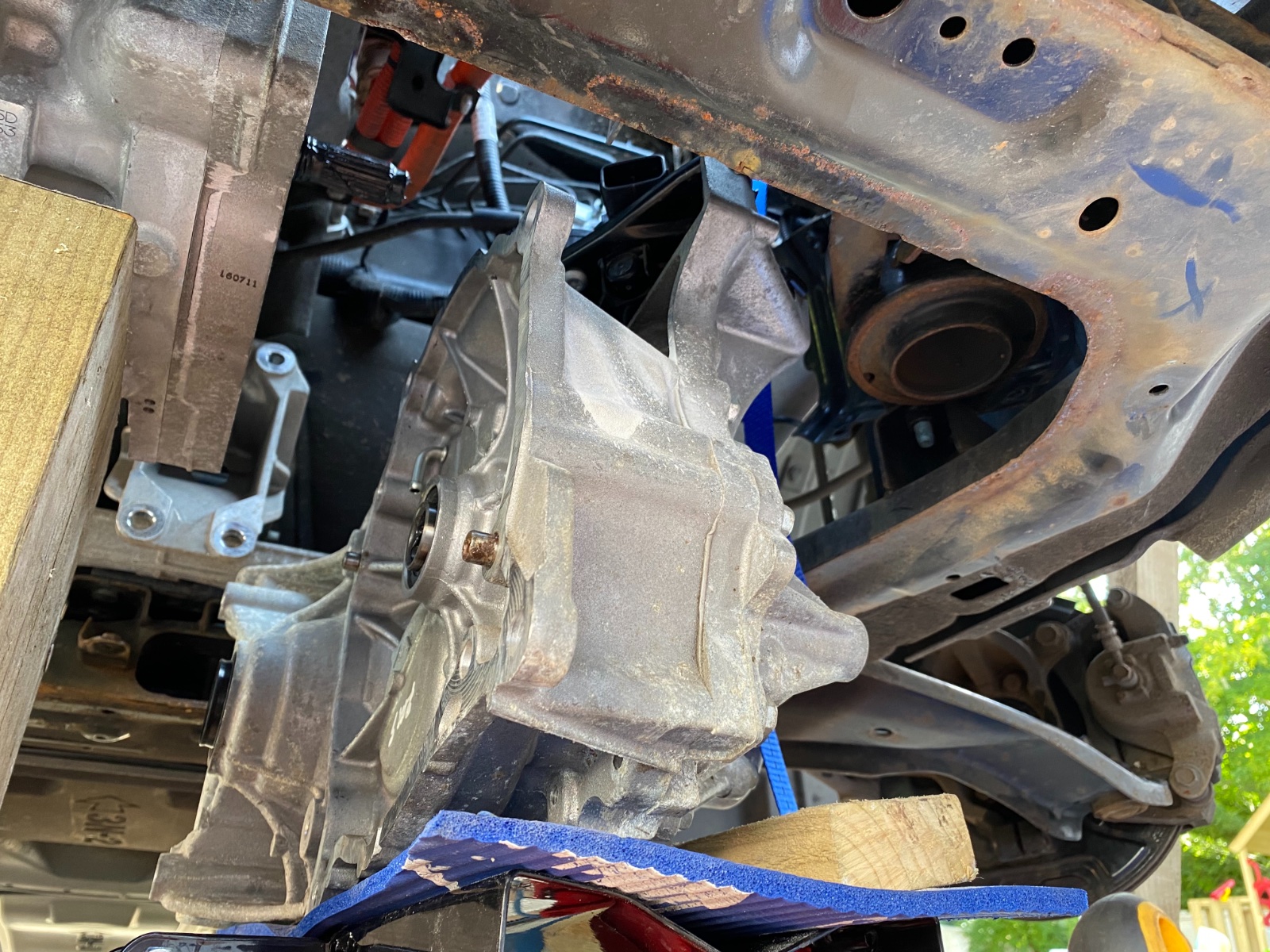

Here's a few photos from today:
Quite a lot of room to work in the "motor bay" on the Leaf. There are only a couple of bolts at the top of the rear engine mount that are quite hard to get to, everything else is straight forward to access.
