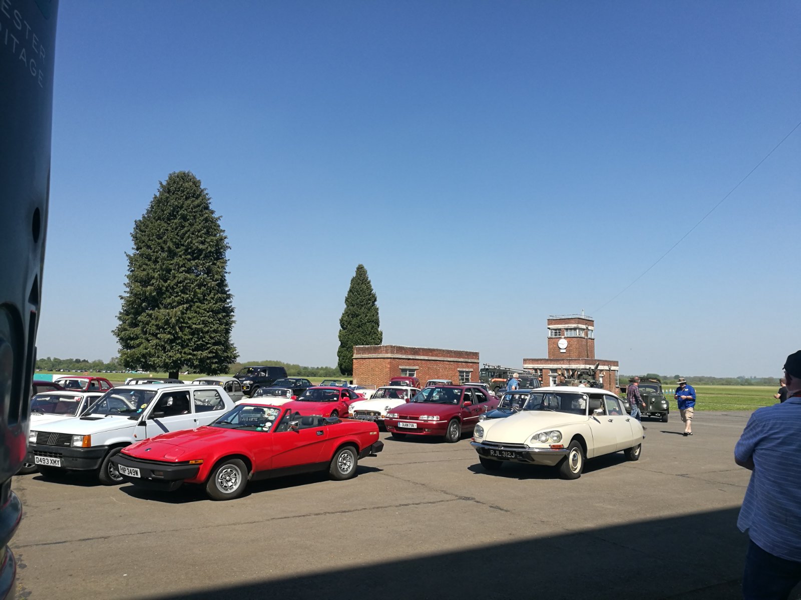

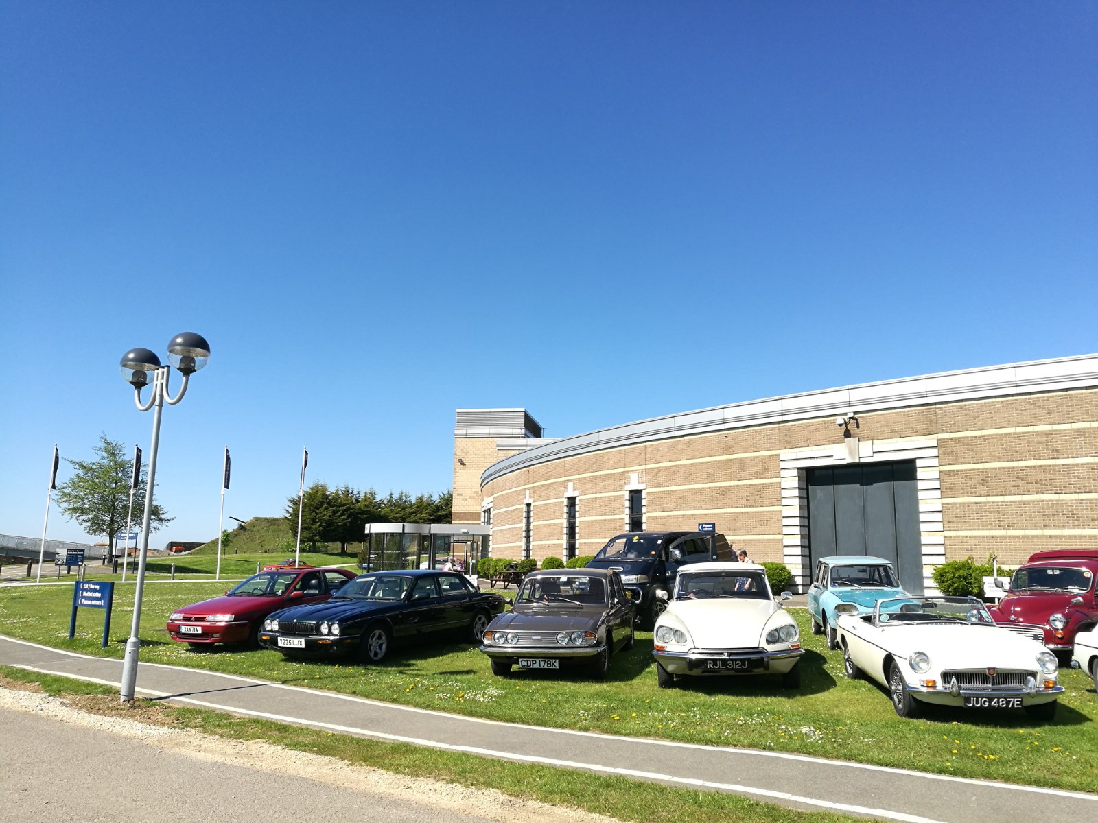

Nice day today for a run out.
Started out at the British Motor Museum at Gaydon...
Then onward to Bicester Heritage.
Had no idea that there was so much heritage vehicle work going on there...the whole site more or less is one giant collection of businesses who do various aspects of vehicle restoration...

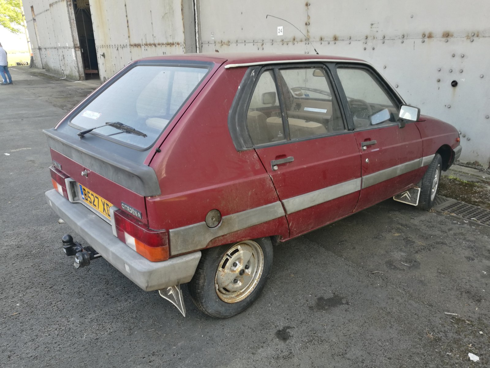

Was quite surprised to find this poor little Visa looking very forgotten in a corner there (which every Citroen enthusiast immediately made themselves conspicuous due to as we all immediately materialised in that corner).
A couple of folks apparently did go off to ask the relevant questions though, so hopefully it will have a bright future. Being parked up in the middle of a gigantic car restoration complex, it's got far better odds than most. Looked astonishingly solid and complete a project.
Never really seen a Visa up close before, quite an attractive and charming little thing.
Almost managed to avoid sunburn...almost! Sadly managed to miss a couple of spots with the sunscreen.

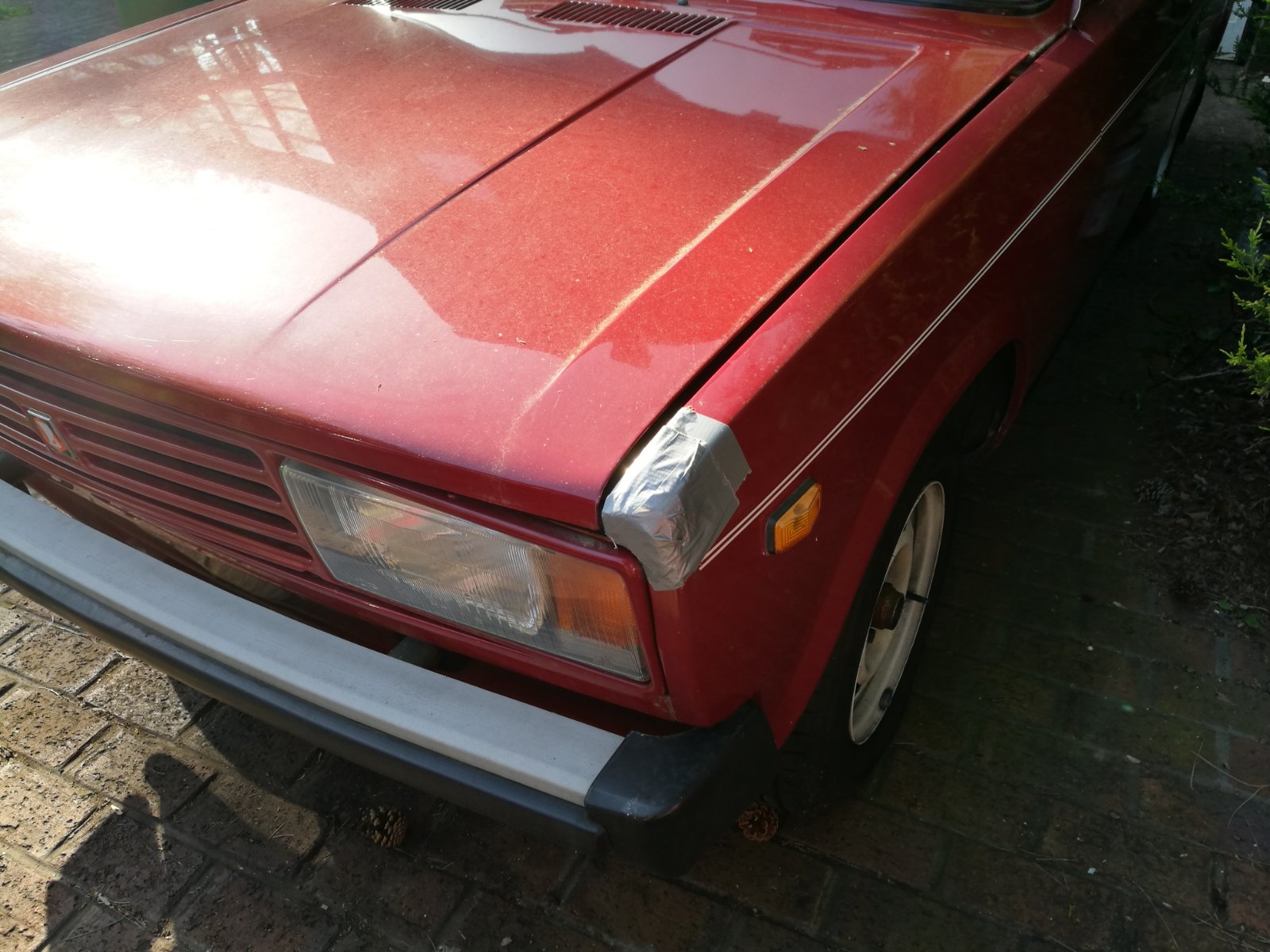

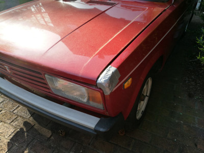

Lada is in for the MOT tomorrow, so had a check over. Cable ties the fuel lines to the vapour line (which is firmly affixed to it's original fasteners) so they don't wobble and can't wander anywhere near the suspension.
Added some very period appropriate bodgery to the nearside front wing top to deal with the sharp edged rust hole left after a kid from the school poked it.
New wings are going to go on shortly after the test I've decided. Will be a pain in the rear to do on the drive, but I just can't justify throwing £1500 at a body shop for it. Will probably get them to do the paint though.
Missing an exhaust hanger on the back box annoyingly. Don't have a suitable one in stock, so will see if I can find one in the morning, if not it's not a hassle to fit and take back. To be honest, the whole exhaust really wants changing anyway...so that might just end up being part of the same task. The one right at the back has split in half and has been held on by a cable tie ever since I got the car too...

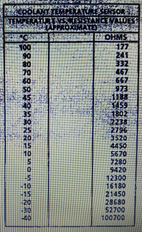

I have just done some temperature checks, and it looks like it's definitely reading out - 90C should be 241R, and I've got 200R on the actual sensor...so I think the sensor may be struggling. Going to have a rummage to see if I've got another suitable one floating around, if not I'll either get one ordered in...or improvise a "compensation" adjustment shunt resistor!

Have had a play around, and putting a lower value (but still feasible) resistor in place of the coolant temperature sensor doesn't seem to make as much difference as I'd hoped. The values quoted I've always been told are distinctly approximate anyway. I'll have a rummage through the manual tonight to see if I can get an actual hard number on what range is acceptable at what temperature.

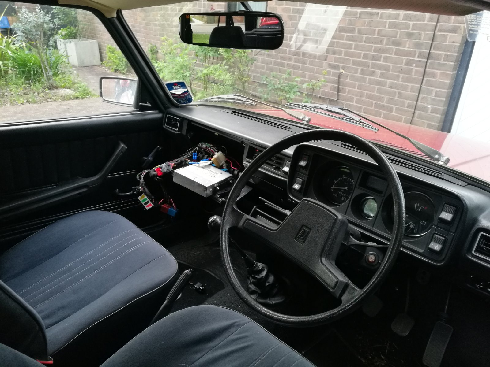

Next up, now I've dug the ECU out again is to get the meter onto the lambda sensor and make sure it's doing its thing, as the signal path isn't accessible at the engine end now I've got the proper sensor in there.
