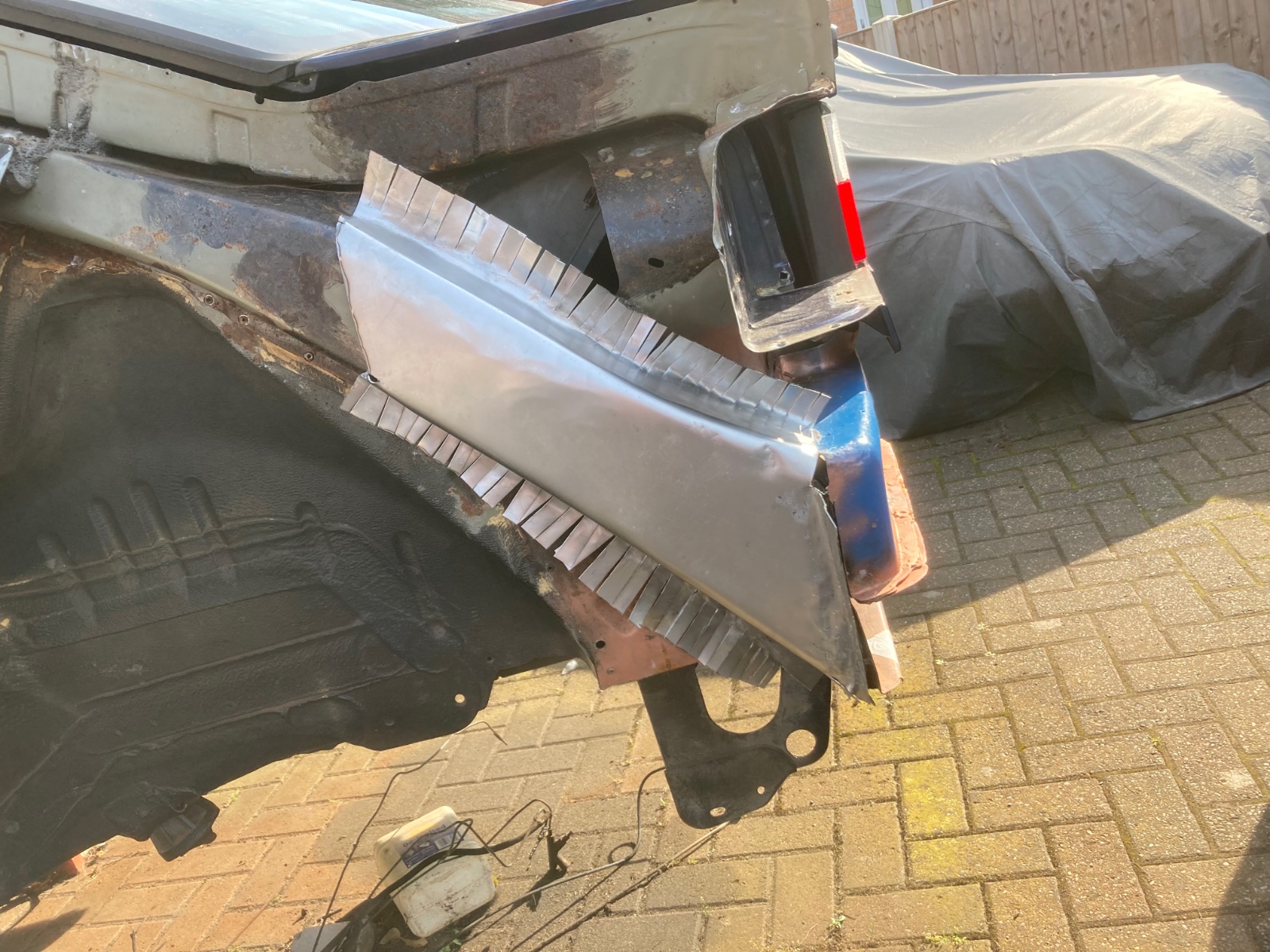

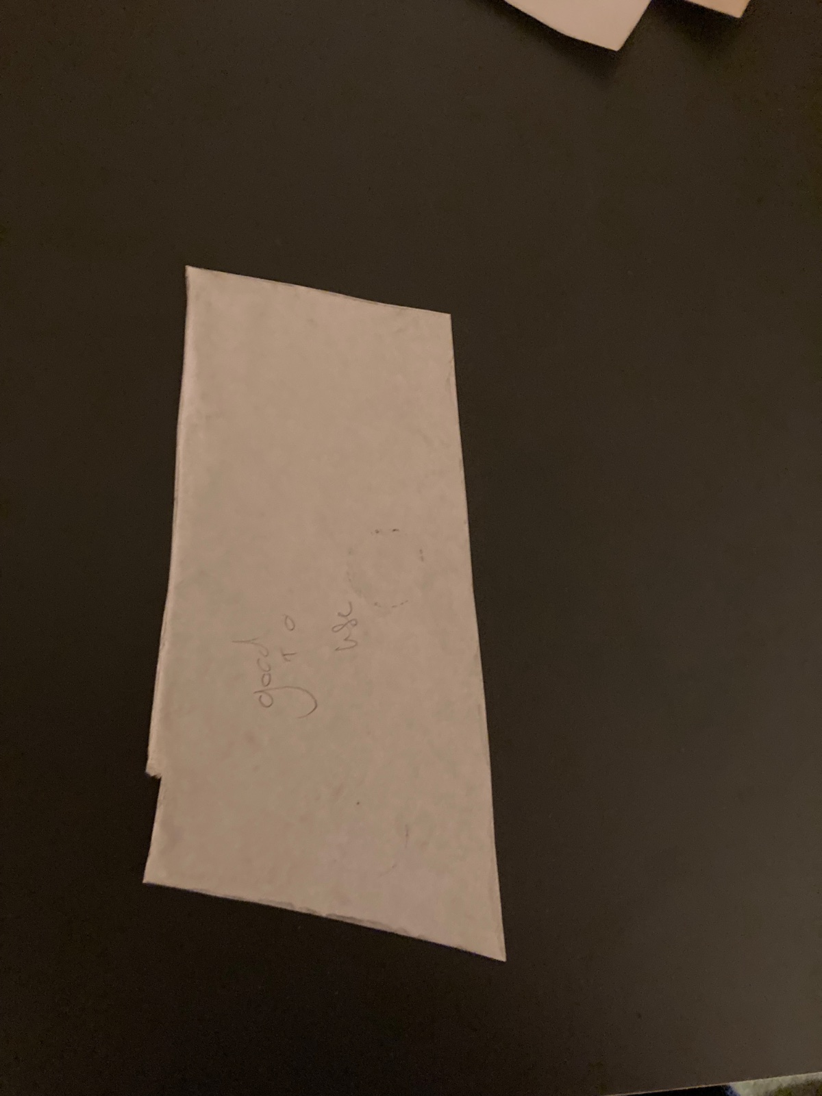

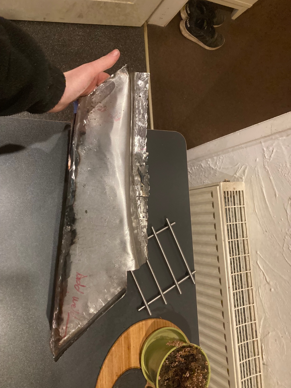

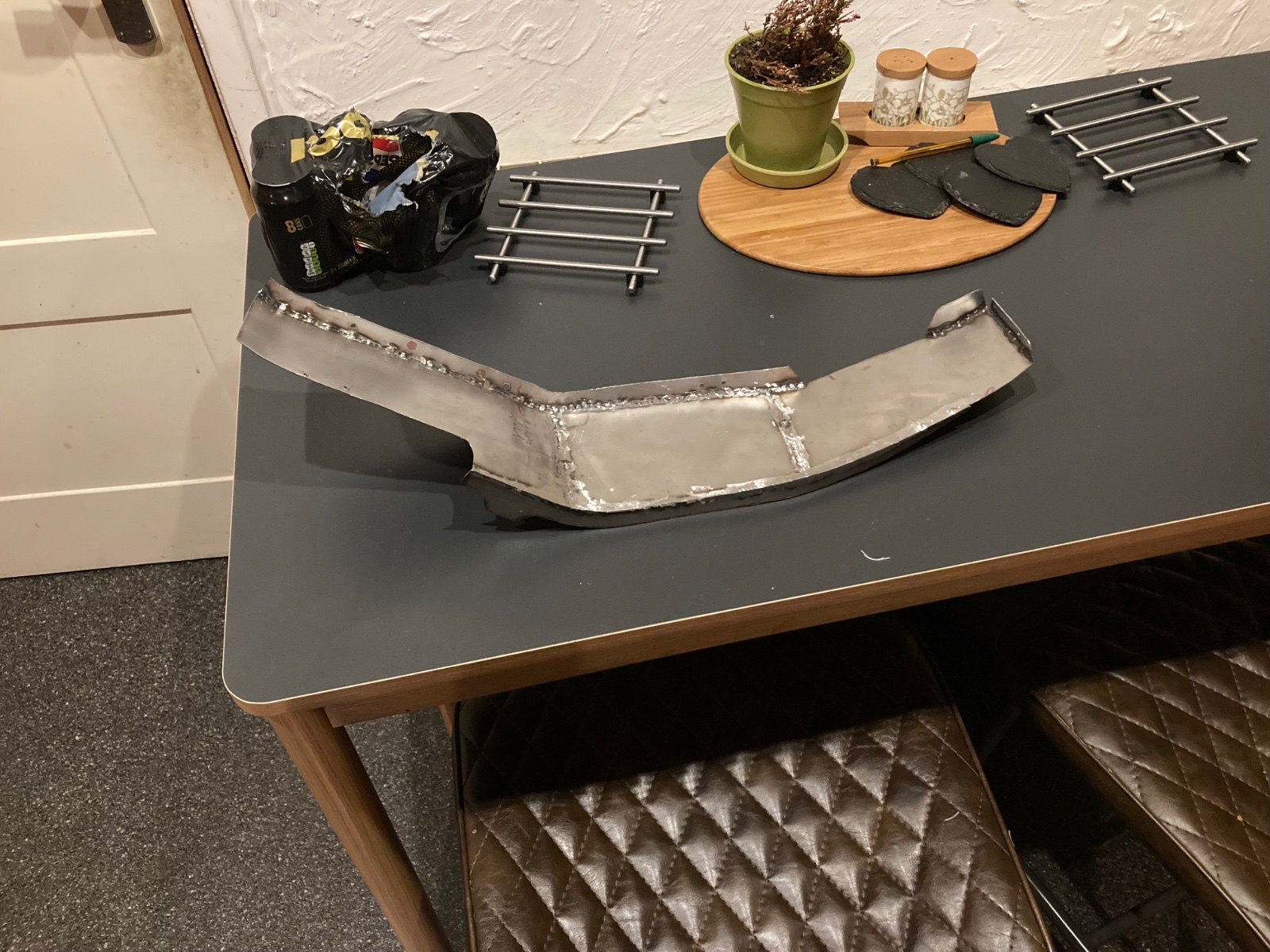

hey everyone I hope you are all well I have some updates on the work I have been doing, i have been tackling the main structural piece that goes behind the wing and the the piece that is in the wheel arch, I cannot buy these pieces so I have resorted to making some of my own, the first stage was doing a bit of reading about mental work, and I then made a
Masking tape
Masking tape
and a buck of the original piece I wanted to replicate and bashed the steel into shape I needed to make some pie cuts to allow for the curved
Metal piece
Metal piece
although it doesn't look exactly like the original thing im quite happy with it and it is very strong :)
Part 1 fin
Part 1 fin

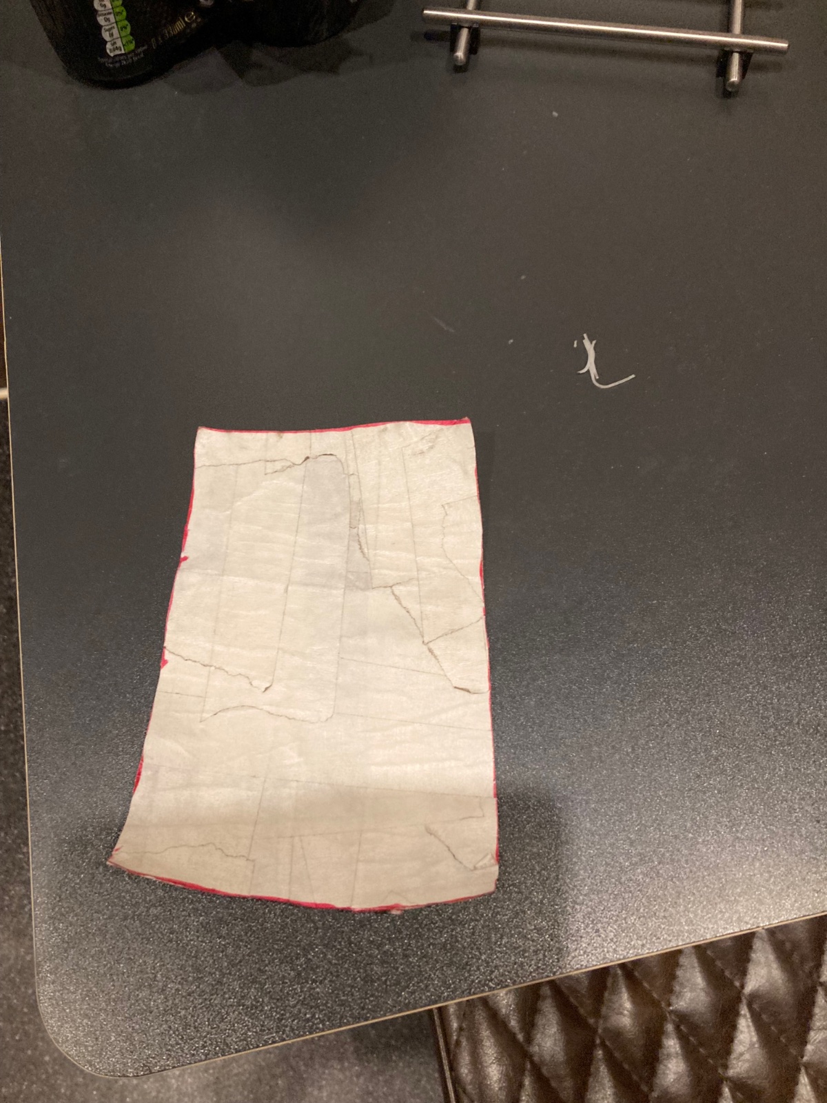

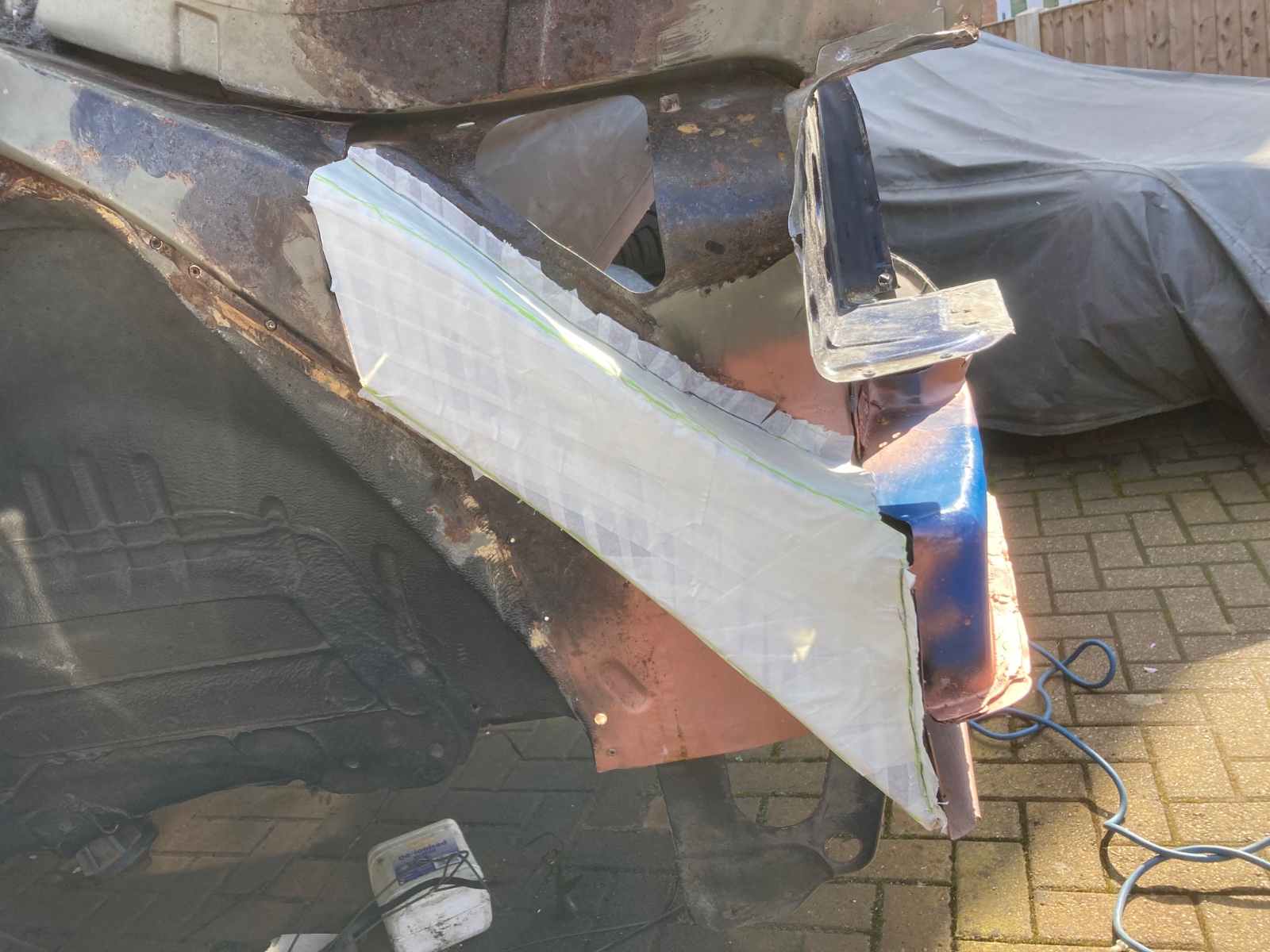

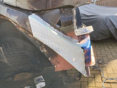

the next piece I needed to make was the one in the wheel arch I tried to patch the original some time ago, but looking back at my original repairs they don't meet the standard I want to put on the car the were a lot of holes in the metal that would have just rusted back through so I decided I would make one from scratch. the first thing I needed to do was for a template so I built these out of masking tape
Paper template 1
Paper template 1
Paper template 2
Paper template 2

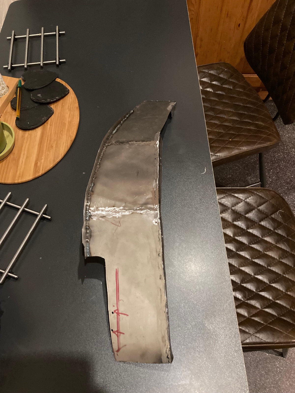

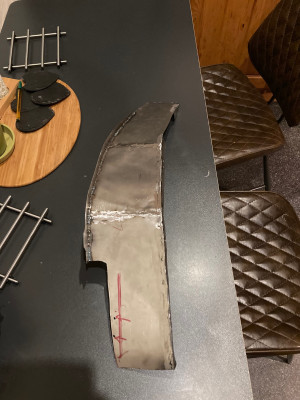

and this give me the rough shape , so I could trace it onto sheet steel Citroen used 0.6 mm steel quiet unique and I had to source it form a specialist and I made it in 3 sections and welded it together and this is the result
Metal Peice 2 (pic 1)
Metal piece 2 (pic 2)
it needs a bit of finishing but it fits like a glove so im happy with how it came out in the end, thank you all for reading I hope you enjoyed :)
