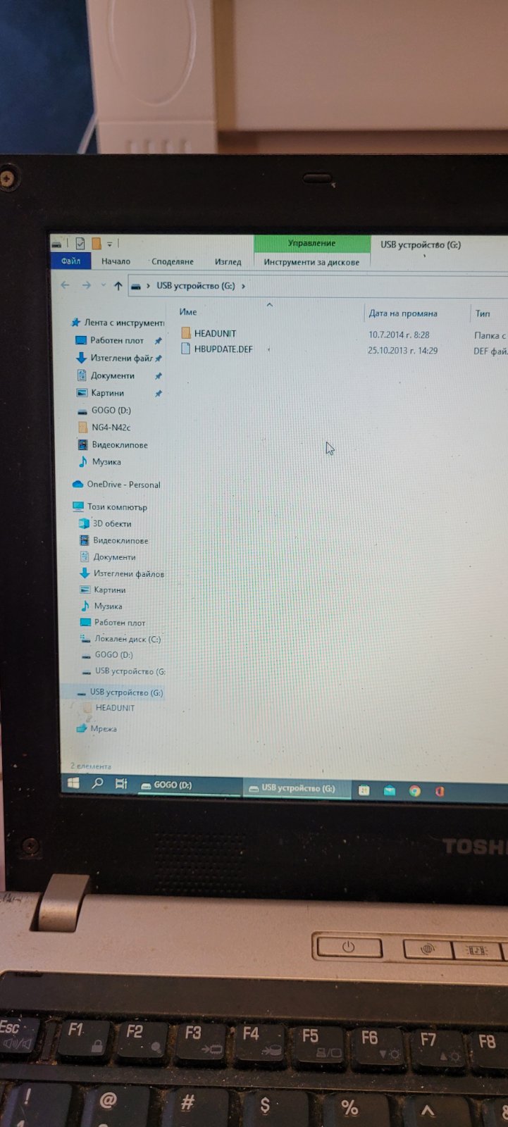

Hi again Mark, i try your firmware but still the same. I try with 2 diferent media all of them formated FAT32 not quick and result is the same, the update didnt start. Any advise ๐Ÿ˜๐Ÿ˜
x 6948
Re: Guide to Replacing the NG4 Navidrive 3D Hard Drive with a CF Card
Ok 1) explain to me what you are doing step by step from getting in the car and 2) please provide a screenshot of the files on the USB.

1. Start engine
2. Factory recet
3. Change language
4. Insert USB
5. Waiting ๐Ÿ˜๐Ÿ˜๐Ÿ˜

Well why are you doing a 'Factory reset' each time? There is no need to do this if you are reapplying the firmware. This just adds complications and may cause the system not to update as you are doing a reset each time. Nowhere does it say to do this when updating the firmware.
1) Leave the car 10 minutes with all doors closed and locked to let the BSI sleep.
2) Unlock the Car, get in and start the engine.
3) Get comfortable, open any windows before starting the update. DO NOT operate any buttons or controls when updating - it can cause interruption.
4) Wait for the NG4 to start up.
5) Then insert USB into the centre arm rest USB socket and wait.
6) The screen will read the USB and ask if you want to update the firmware.
7) If it does not do this, remove the USB, wait a minute then re-insert and wait another minute.
If it does not read the USB and ask if you want to do the update, then there is a problem reading the USB or it is not communicating with the USB.
To check this, try a USB key with a few MP3 files on and change the media source. Will it read, display or play the files? If not, then that is your issue. You may have a loose quadlock connection or cable at the back of the unit.
The same files from the firmware can be burned onto a CD_R (at lowest speed possible 4X if you can). Make sure you finalise the CD-R.
Follow the same procedure above, but insert the CD instead of the USB and that should start the update.
But I really think your issue is electrical if it is not powering or communicating with the USB to be honest.
