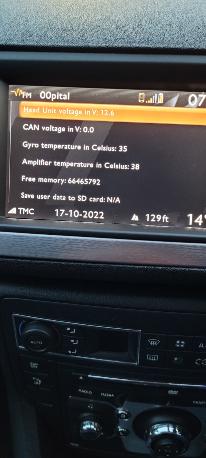

Thanks for the reply Mark, I downloaded the software from the peugeot forum. I read everything there and checked for hidden files. Today I entered the hidden menu and go to sistem then information . Strange is that the CAN voltage is 0.0. I dont know it is corect or no.

I'm not sure about the reading as on the top reading it says there is CAN voltage to the Head Unit itself (NG4) of 12.6V, so not sure what the second CAN parameter is related to...
There are plenty of possible fault codes that can be obtained with Diagbox, and the unit can be tested for operation, but not much else about the solutions.
