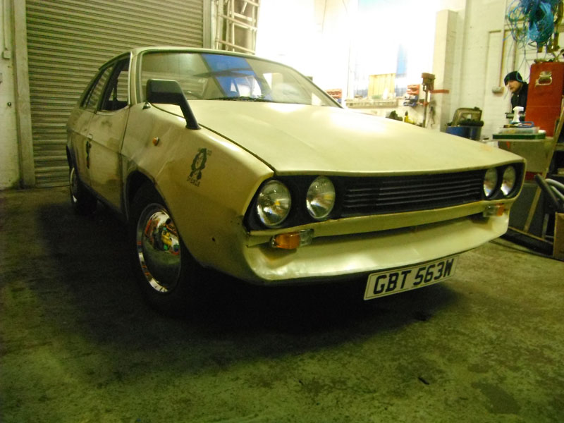

In the meantime, since I finally got someone to come out and pump my suspension up which is the last big job, my attention has been diverted by something decidedly British that I've owned for five years. Really very close to going for an MoT now, just chasing a fuse-blowing electrical gremlin mostly.

Yes Ducellier became quite a universal fitment. I'm fairly certain they were used on the Metro and probably more.
Good luck with the Ambassador/Princess.

I like the princess
