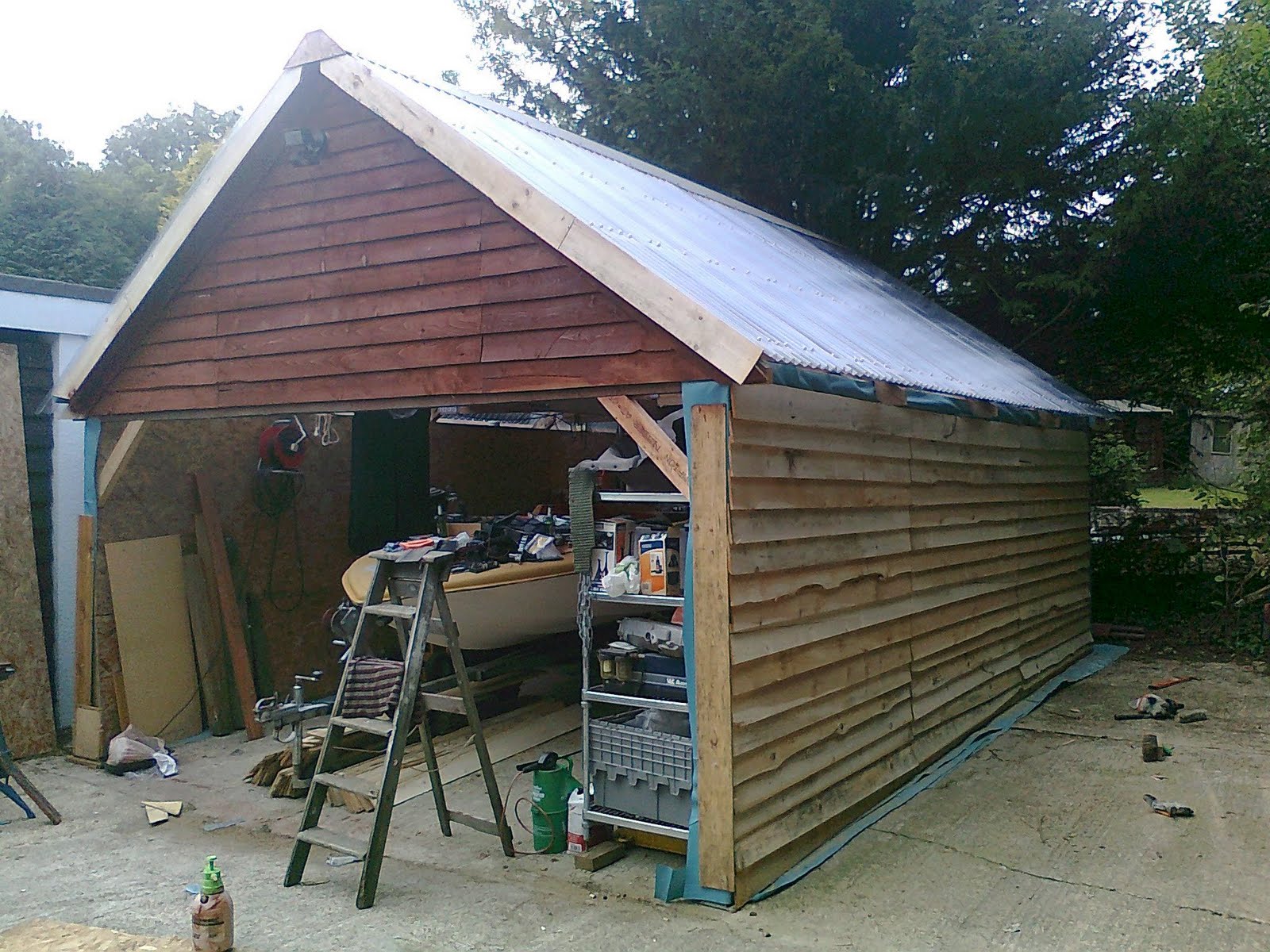

http://3.bp.blogspot.com/_2fj8MH_LeQ0/T ... to0029.jpg
added some cladding to the side of the workshop :) have stained all of it since then.. Mike your security light is there :D

Looking really good, John :) I'm glad to see the light's been put back into service.
