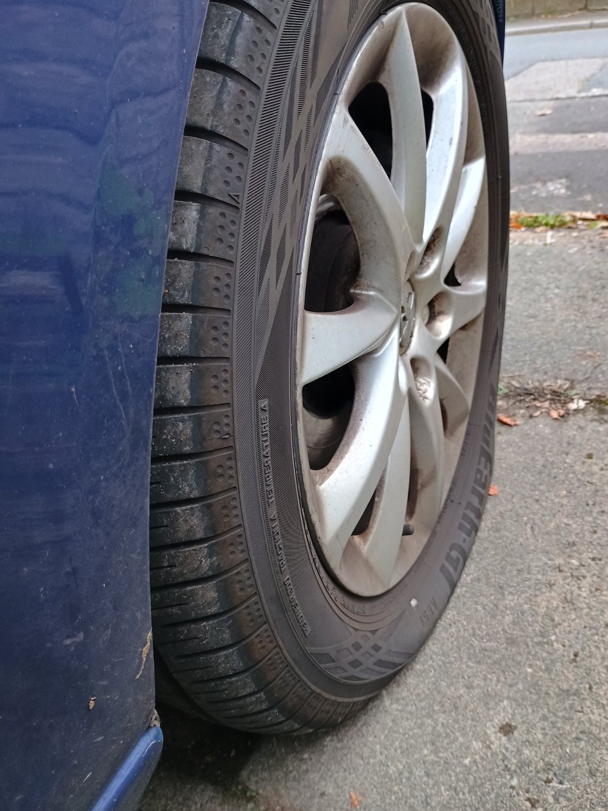

Oh....
Less than half a bar (about 5 PSI)
Can't see what's caused it
Posts: 5324
Joined: 25 Apr 2022, 09:03
x 2347
Unread post by MattBLancs »
Wheel off, pumped up to 3 bar, close inspection all around the perimeter, sidewalls and listen if the valve is hissing.....
... No idea!
Dropped off at local tyre place for puncture repair, hopefully they can dunk it and spot some bubbles. Fine yesterday morning, flat today!

Posts: 5324
x 2347
Huskyxantia wrote: 14 Oct 2025, 18:45 Think you caught that just right Matt. Post your findings when you get them
A lucky day I think!
Whipped the wheel off at lunchtime, puncture fixed:
Corrosion between tyre's bead and the rim. Odd it's gone from fine to "goes flat overnight" but fingers crossed their diagnosis proves correct!
I've put the wheel back on again this evening (just before we lost the light)
Hoping it's looking nice and round in the morning [-o<
£20, which a short but of research suggests is cheap for a puncture repair nowadays (think last repair I had was £10, but thinking about it - that was probably 20 years ago! Had a few punctures since then but all either unrepairable or not worth bothering (as tyre fairly well worn))
:-D
Posts: 21194
x 8126
My man does the plug type repair for a fiver, clean and reseal foc!! :-D
Posts: 5324
x 2347
mickthemaverick wrote: 14 Oct 2025, 19:48 My man does the plug type repair for a fiver, clean and reseal foc!! :-D
That's cheap Mick,
Though wouldn't have done the trick for my corroded rim bead issue. :rofl2:

Posts: 55108
x 8401
I had similar on my Picasso a couple of years ago, the tyre place reseated the tyre, cleaned up the bead seating, popped a new valve in and touch-wood, it's been good ever since.
Done FOC as they know me as a regular customer...
