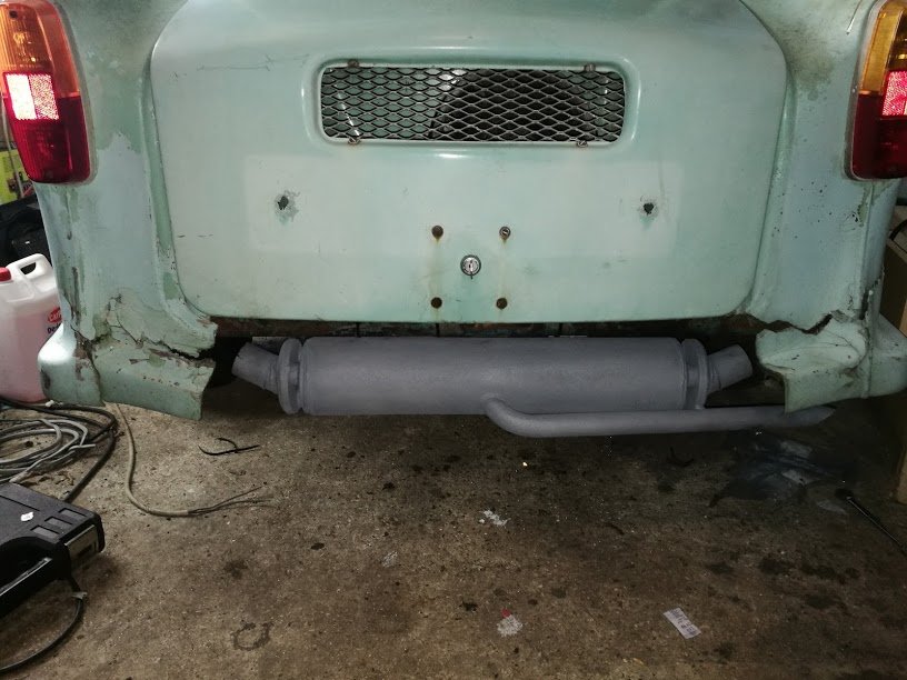

Edit: Very quick evening update. Reattached the now cleaned and painted exhaust to the Invacar.
Have also bent the mounting tabs on said exhaust straight again so it sits squarely rather than applying undue pressure on the downpipes.
We'll see if this high temp paint actually cures properly unlike the last lot which just wiped off! The whole lot will be essentially invisible behind the rear apron once the bodywork is sorted out, but given that these exhausts aren't exactly ten a penny, I'd rather offer it what protection from the elements that I can.

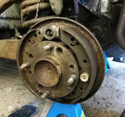

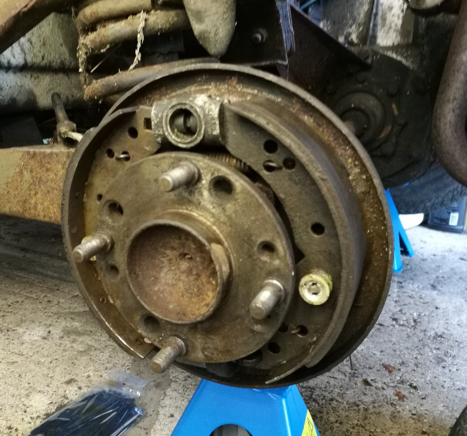

Next up was to investigate the odd scraping noise coming from the offside rear wheel. Actually turned out to be used error - this idiot had put the return springs on the wrong side of the shoes so they were touching the hub. Putting them back on the correct way around was exceedingly fiddly, but not really difficult as such. Definitely one of those things that is probably easier once you've done it a dozen times.
This is also the side that's been leaking - but the cylinder is bone dry now...will keep an eye on it. It'll be changed likely before the road, at £12 each it's not worth not doing.

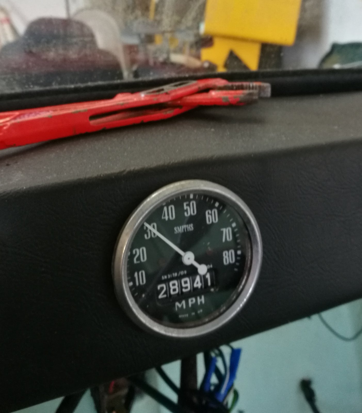

Next up was to engage drive, get the revs up and see what happened. Answer was a huge cloud of dust and cobwebs being ejected from the drive assembly directly into my face. Oh, and the speed coming up nice and smoothly, bit of resonant vibration at a couple of points (from the belt which I know is a bit loose), but nothing untoward.
There's a notable change of the note at 45mph, which is when the system is meant to drop into a "direct drive overdrive" mode, which it seems to be doing. Great. Cranked the revs up a bit further, and briefly had an indicated 65mph on the speedo, at which point yet more crud was blown out. I caved at that point as the levels of noise in a small garage were reaching biblical levels, and I really didn't want the car to vibrate its way off the axle stands. Fundamentally though, the variomatic system seems to work as intended. Rear brakes too, even if they're not perfectly balanced yet.
Not really done much today aside from testing something, but it feels like progress.

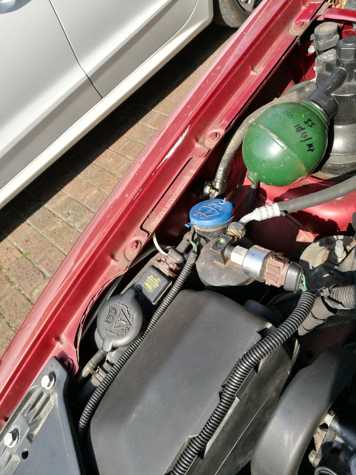

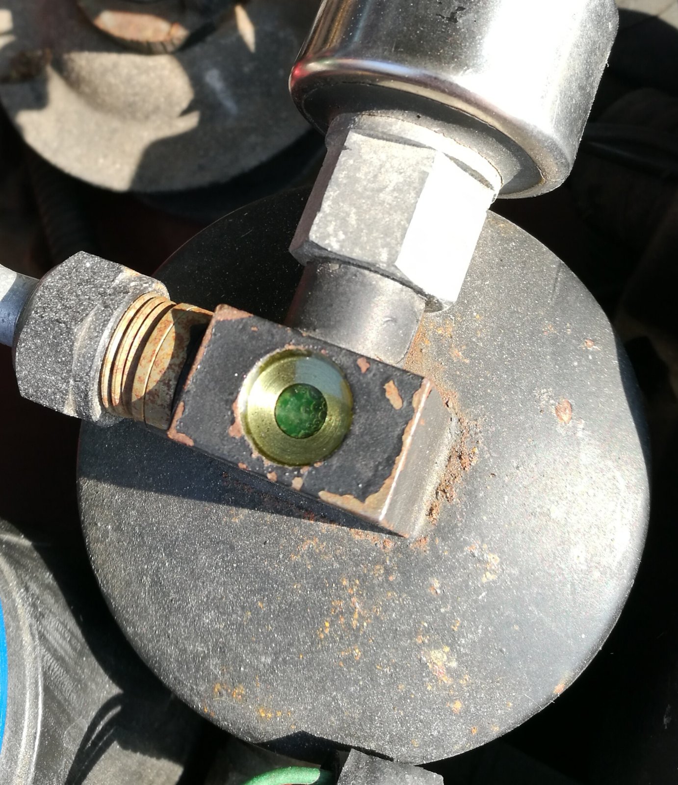

Activa now has fully working air conditioning again. Always a nice surprise on a vehicle this age when it passes the leak down test...
Didn't get a chance to look at the gauges before they took it off the machine, but based on the temperature of the various lines and the temperature drop across the evaporator, it seems happy enough.
