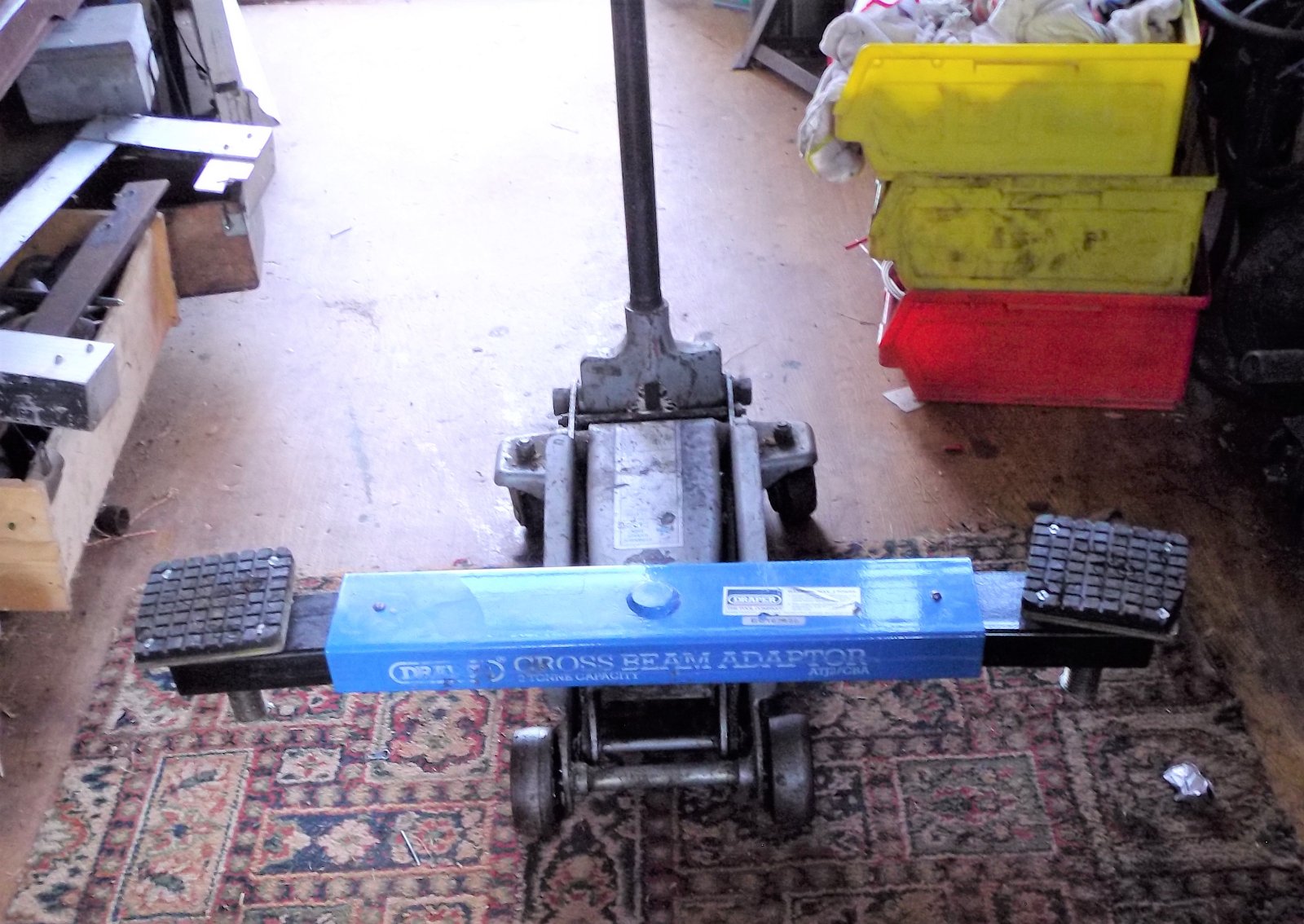

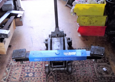

I know Mick discounted Draper but I have this which is a very useful add on.

Just to clarify, I don't have a problem with Draper in general, I just found their hydraulic seals unreliable so I stay away from any of their hydraulic stuff. I have numerous other tools from them like ball joiont splitters and spring compressors etc. all of which are fine. Sorry if I painted the wrong picture there!!

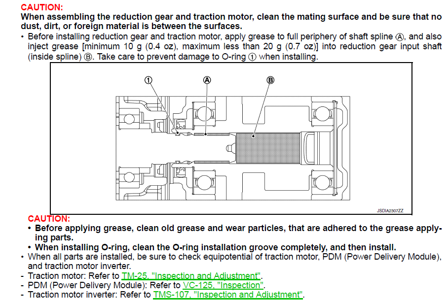

Does anyone know what kind of grease should be used on the driveshaft splines where they go into the gearbox ? For the splines on the CV joint going into the hub Nissan say to use Molykote M77:
https://static.nhtsa.gov/odi/tsbs/2017/ ... 2-9999.pdf
However this seems quite expensive! What do people use ? I'm conscious of the fact that any surplus grease on the splines on the inner joint will find its way into the gearbox so you don't want a grease that is abrasive in any way...

Assuming the connection into the box is 'wet' i.e. the shafts run in the gear oil, then nothing - just shove the shaft in. Usually the bearing surface diameter is much bigger than the spline diameter, so as long you guide them in they don't snag the lip seal.

Well I can look in one driveshaft entry hole and out the other side with part of the differential in view in between so I guess that makes it wet ?!RichardW wrote: 15 Jul 2021, 16:27 Assuming the connection into the box is 'wet' i.e. the shafts run in the gear oil, then nothing - just shove the shaft in. Usually the bearing surface diameter is much bigger than the spline diameter, so as long you guide them in they don't snag the lip seal.

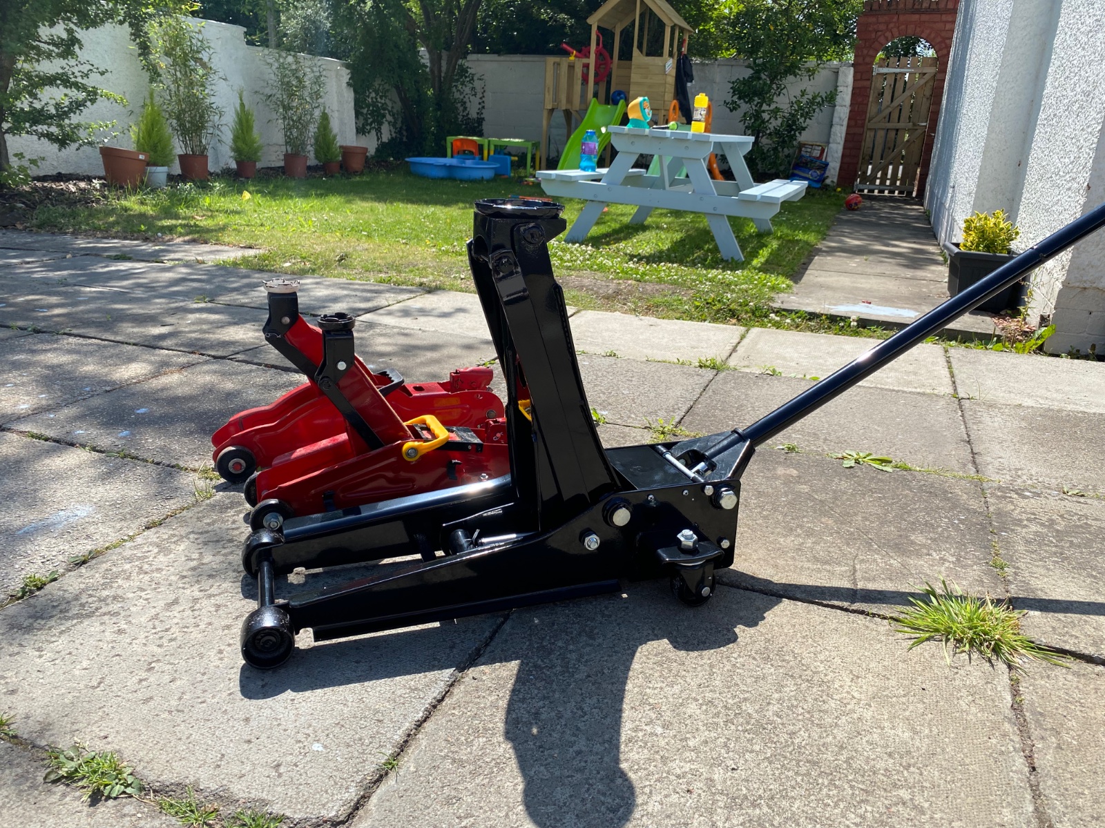

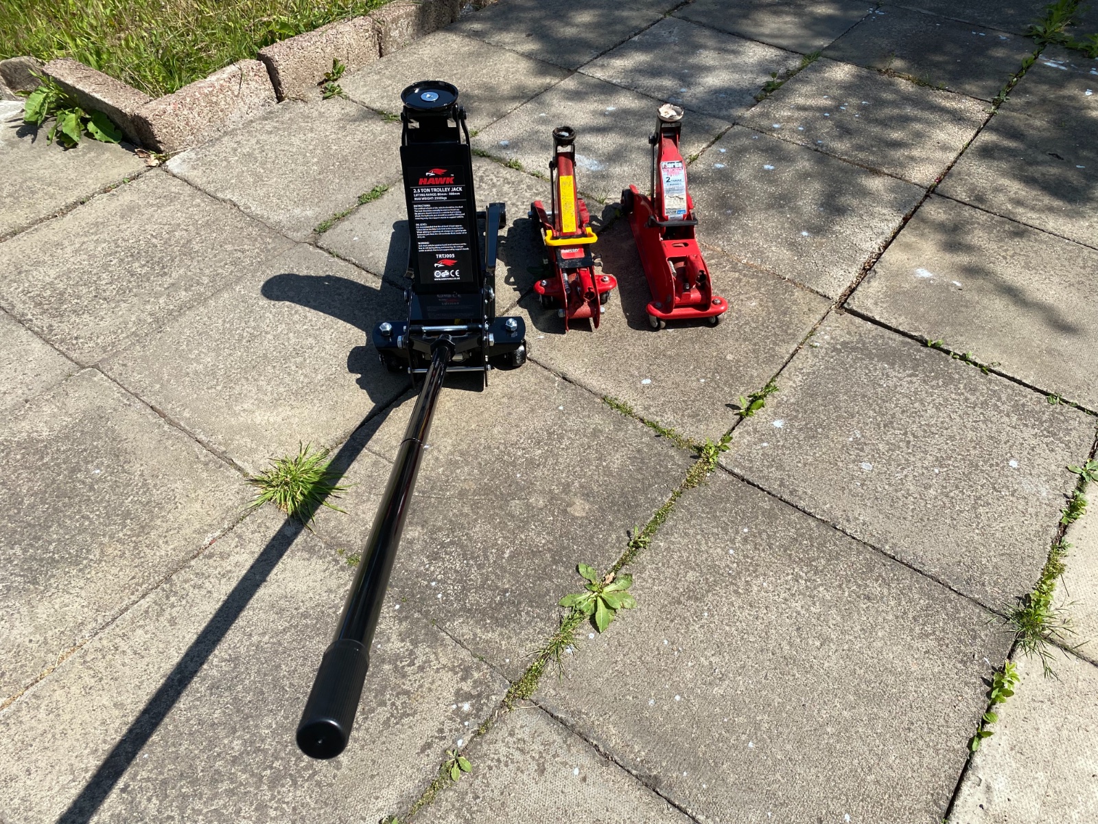

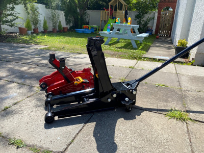

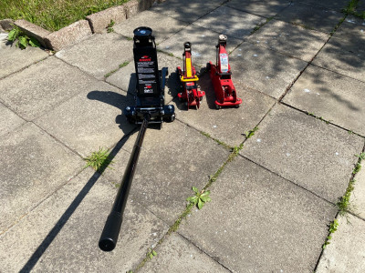

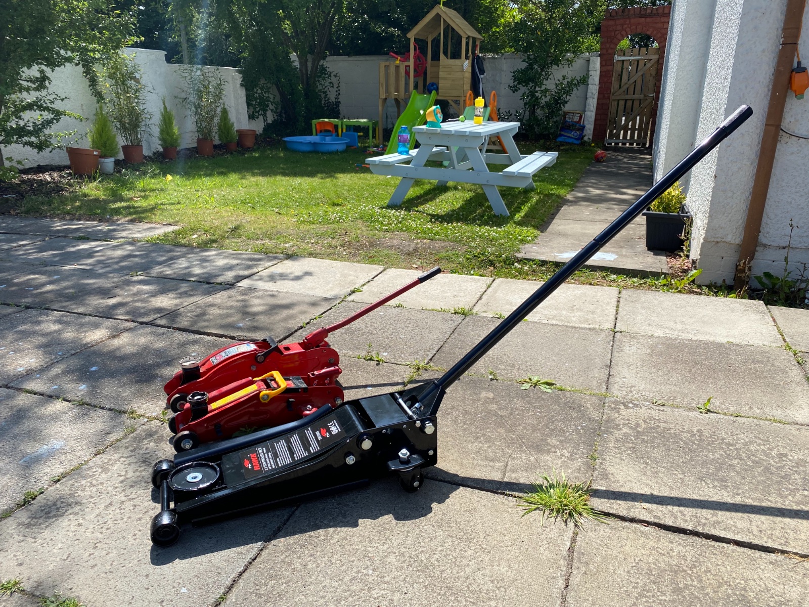

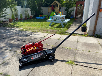

This will make life easier than the old jacks
Goes lower, goes much higher, much more reach under the car, much longer jack handle (which is still removable) so easy to use, deflation integrated into turning the handle, and it's VERY heavy and wide so should be quite stable. I think it's around 35Kg.

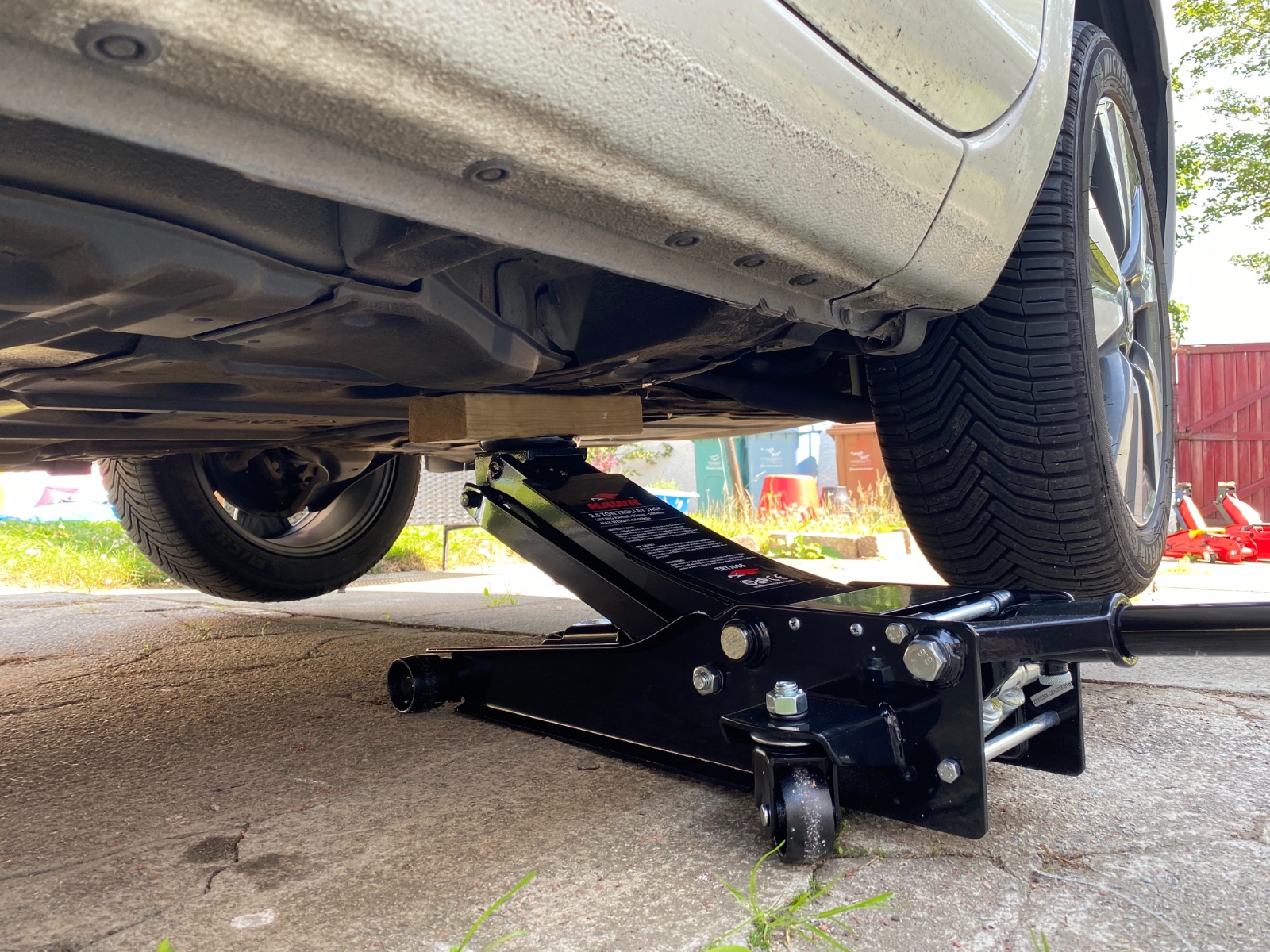

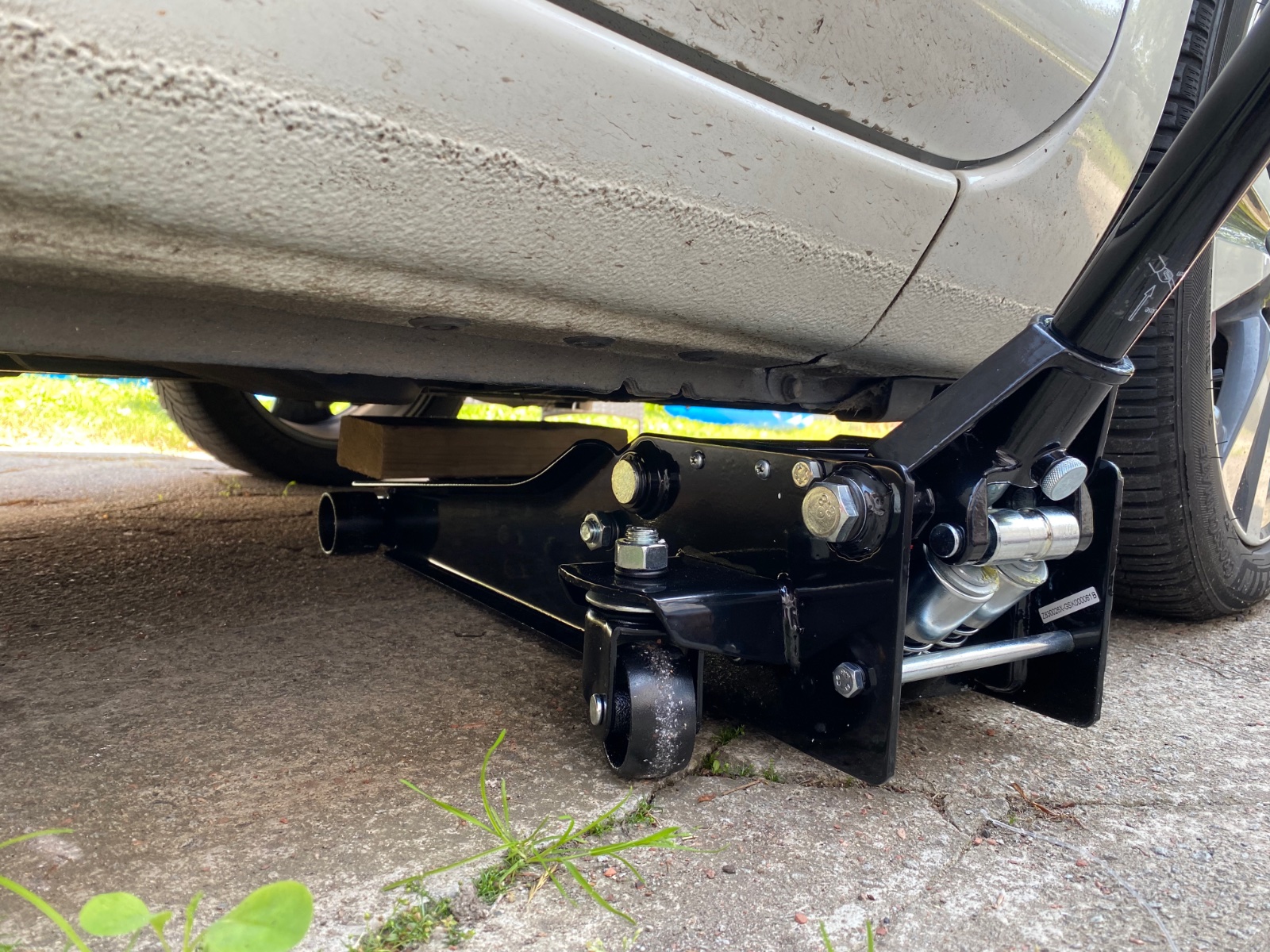

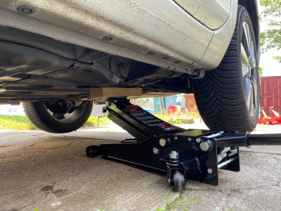

Gave the jack a dry run on the Leaf. The Leaf is a lot more difficult to jack up than the Xantia because you can’t raise the suspension and the ground clearance is lower than even normal ride height on the Xantia. (About 19cm)
Also the optimal jacking points under the subframe are a lot further towards the middle than the Xantia.
So I couldn’t get my older jacks under the car with a block between them and the chassis, and they also couldn’t reach the best jacking point until I'd already jacked it via a sub optimal location with a 2nd jack...
The new jack slides under with room to spare even with a 2x4 block and can lift both front wheels off the ground from a single jacking point without having to juggle axle stands and jack positions. Brilliant! Wish I’d got a bigger jack years ago…it would have made a lot of previous car jobs a lot easier and safer!

Looks excellent Simon, you can't beat a really tough Jack (or so Vera Duckworth used to say
). Looks like the job is getting easier with every post!

I'm trying to source some oil for the gearbox for the Leaf but I'm struggling to identify what the 3rd party equivalents are for "NISSAN Matic S ATF", which is ridiculously expensive even though I only need 1.4 litres. I'm sure its just some kind of Dexron type ATF oil but I'd like to be more confident of an exact specification, as replacing a faulty gearbox and using the wrong oil seems like a bad idea and asking for trouble...
Does anyone know a good third party lookup site that will give me actual specs of the oil so I can find the right stuff ?
Also in regards to grease for driveshaft outer joint splines - Nissan specify Molykote M77 which is also ridiculously expensive and not easy to source - but as far as I can tell its just a molybdenum disulphide Lithium grease - does anyone know an equivalent to this?
The service manual also appears to be saying to grease the motor input shaft spine in the gearbox generously, but does not as far as I can find so far state what kind of grease to use - whether to use general purpose Lithium grease or Molykote:
