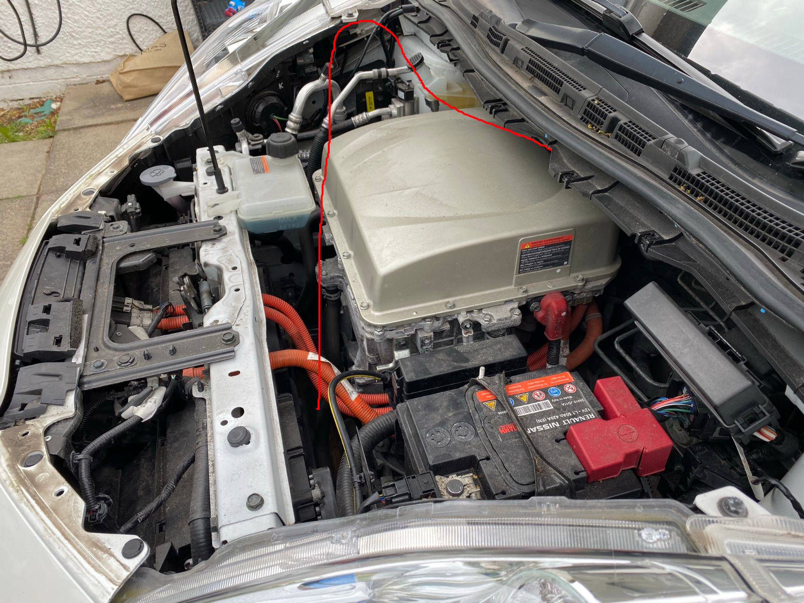

I'm seriously reconsidering doing this myself. Nobody seems to be interested in doing this job and/or they want to charge a fortune on top of transporting the car...
Lowering it out the bottom with a jack seems to be the only way - I was taking some measurements tonight to try to figure this out.
The ground clearance of the subframe on the car when it's standing normally on the ground is just under 200mm. The gearbox is about 300mm "tall". (it lies on its side really)
I have two jacks at the moment but they are quite small, they have a minimum lift height of 160mm and maximum lift height of 320mm - so a travel of only 160mm, which is nowhere near enough.
My existing axle stands have a minimum height of 280mm and maximum of 400mm. Another option for propping up the car securely is my wheel ramps with a large wooden sleeper block on top under the body/chassis area behind the engine bay.
I think I would need a table jack which would go down to 100mm or less, and up to at least 400mm preferably more to have any hope of doing this on a driveway.
I'd also need an extra pair of axle stands to prop up the motor. If I also had the chain lift from above I could reduce the requirements of the jack somewhat - the jack could support the gearbox while being unbolted and moved to the left of the car, then the chain lift could be attached to the eye hook once the gearbox was clear of the rest of the stack allowing the jack to be removed and the gearbox lowered to a skid on the ground without the jack.
Even if I have to buy a bigger jack, it might be worth it for future use - both my jacks are not really adequate for general use anyway - their minimum height is too high to easily get under the Leaf with a spacer block, and they don't have enough lift range, making some jobs quite difficult as I have to keep swapping between jack and axle stands to get the car high enough.
I have quite the list of things I'd need to do this job:
Definite:
* Moly grease for the splines
* Two new driveshaft seals (should I replace the seal on the motor input spline as well ? Not sure how easy that will be to get out or whether it should be fine, I also think it's above the oil level in the gearbox)
* New hub nut split pits - I've already had them off and on once, doing it again they're likely to break when I bend them
* Bottom hub balljoint nuts and possibly track rod end nuts - not sure what size either are
* Extra pair of axle stands - I have four now but only two have flat tops for supporting the structure of the car and they're a bit marginal in size and reach.
* Low profile higher lift jack
Possibly optional:
* Chain lift (can get one for about £42 that looks suitable)
* Build a saw horse to sit over the car to attach the chain lift to - have the wood already
Anyone any thoughts on this ? Am I overlooking something ? I'm getting a sinking feeling that doing this job myself might be the only way unless I want to really pay through the nose and/or have a long wait. I'd rather put the money towards equipment I can use in the future like a much better jack, more axle stands, chain lift etc than spend it all on a one off repair.
To help with getting things the right height I do have several large wooden sleepers and a big pile of driveway slabs - both of which could have axle stands etc on to help adjust the height of everything.

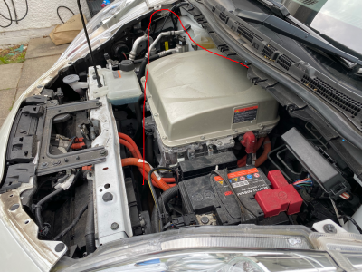

Nice to visualise the scene of the job just for the rest of us taking an interest and hopefully offering a bit of support. Is this the scene where the job is most likely to be done
Your slope doesn't appear like the North face of the Eiger from the photo and it looks a good solid surface. I've seen worse places to tackle a bit of vehicle maintenance like the unmade road outside mine!
Just a question of getting the car 100% safe and high enough to give room for access to those mountings at the back without your head being within a couple of inches of the underside of the car. The slope may even be an advantage with the front end towards the bottom.
Total belt and braces needed on the support however is fathomed to do it of the stack and the box and the car. Here the slope may be a disadvantage with stands needing a level surface for max stability.
Nicked the pic from earlier in the thread, hope you don't mind.
