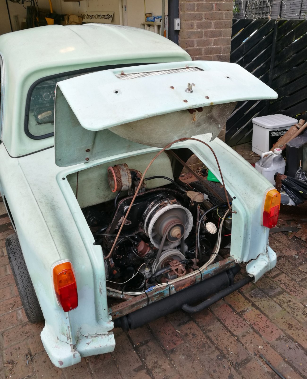

Couldn't resist getting the Invacar out for a bit. Gave it a bit of a run around the drive, and can confirm that the speedo does indeed work. This "enthusiastic" behaviour and exercising of the brakes however then immediately swilled more gunk out of the bottom of the fuel tank, and I spent some considerable time trying to figure out why I wasn't getting any fuel into the float bowl.
Turned out the little screen filter in the top of the carb was full of rusty gunk. Now, these are far too big bits of crud to have got through the fuel filters or the screen in the fuel pump...so my guess is that they've been dislodged from the pump itself due to the higher fuel flow rate because I was actually using the throttle under real load for the first time.
Cleaning that out restored normal behaviour again, though if I were going to be using this fuel tank long term I think I'd just pay to have it professionally cleaned - I can't imagine it being that expensive. As it is, it'll not be getting used long-term, so I'm just going to keep an eye on things.

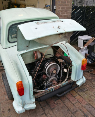

I also got fed up of tripping over the engine cover stay, which seems to have a talent for managing to get in the way irrespective of where I put it in the garage...so I solved this problem by reattaching it to the car.
That does a good job of suddenly making it look significantly less incomplete.
Can see why people often remove them when working on the car though - the cover doesn't open very wide - and the huge cool air inlet duct means that the first time you try to duck under the thing you inevitably whack your head on it.

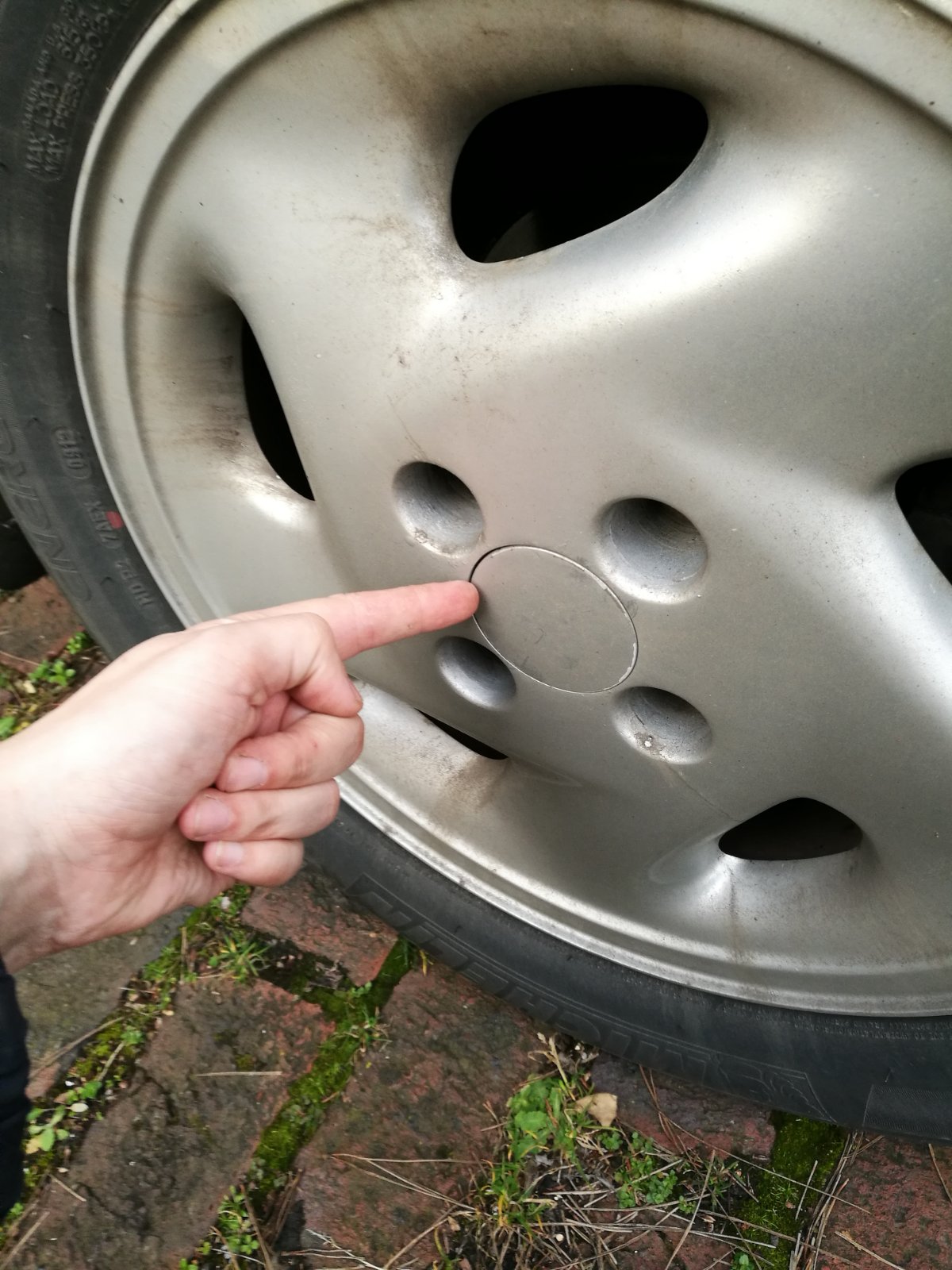

Being such a lovely afternoon today, I couldn't not make a point of having all the windows and sunroof open all the way when I went out - finally kicked into making a tip run by virtue of the fact that the oil bottle into which I drain everything was full so I needed to empty it. So loaded up a plethora of other stuff that had been getting stacked in the corner waiting to be taken in as well.
Couldn't fail to notice two things. Firstly was that driving along without a perpetual "squeaksqueaksqueaksqueak..." is far more pleasant. Secondly was a light tapping noise coming from somewhere towards the offside rear. Sounded very much like ratting brake pads, but didn't stop when the brakes were applied. Hmm...Made a note to myself to investigate when I got home.
Cause was actually nice and simple for a change!
Slightly loose wheel centre cap. There's just enough free movement in it (about 0.5mm) for it to rattle. I'll have a closer look a that at some point in the near future, guessing removing the centre cap is far easier with the wheel off first.

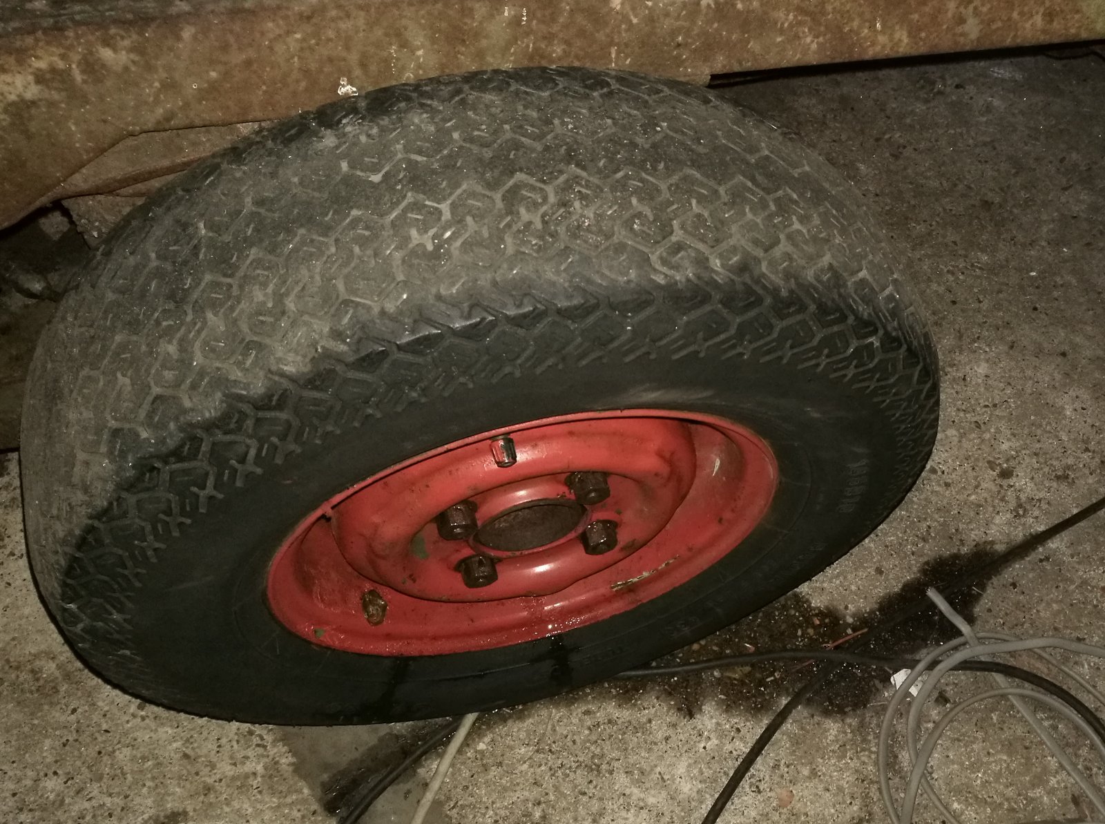

On the subject of wheels, I apparently will indeed need a new wheel cylinder for at least one wheel on the Invacar, as evidenced by finding this when going into the garage to get something out of the freezer at the back.
Ah well, at least they're cheap!
