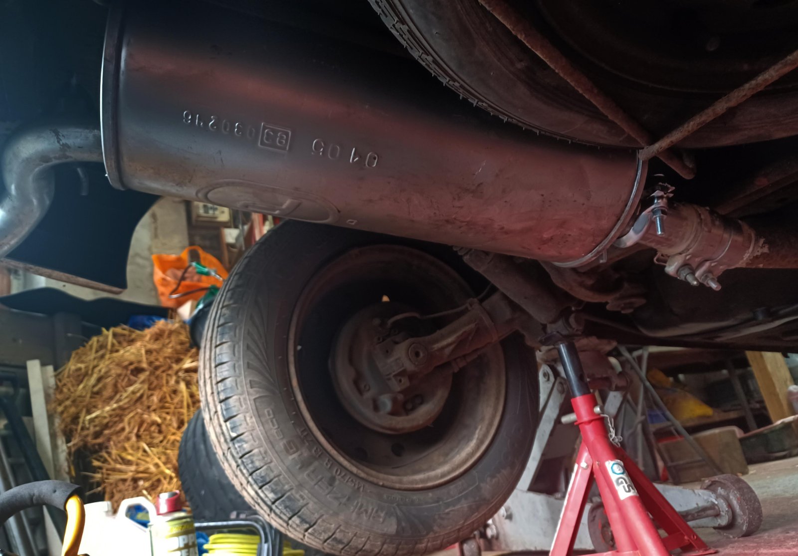

New back box was needed on the AX before its MOT......... I had to use a "joiner pipe" with a flair on it as some bright spark had cut the original pipe and welded a section directly into the back box pipe/neck !....Not wanting to take every thing off and weld it I used a stainless steel joiner clamp to secure the new section on so I could use the correct clamp (flair-2-bulb) for the back box.
Box was sourced from Poland and aligned really well where the tail pipe comes out from under the bumper.
Daffodil does not fart like an old sailor after a night out on the real ale and pickled eggs any more .......

Excellent :) Good to know it fits well... I may get one in stock for Bluebell...

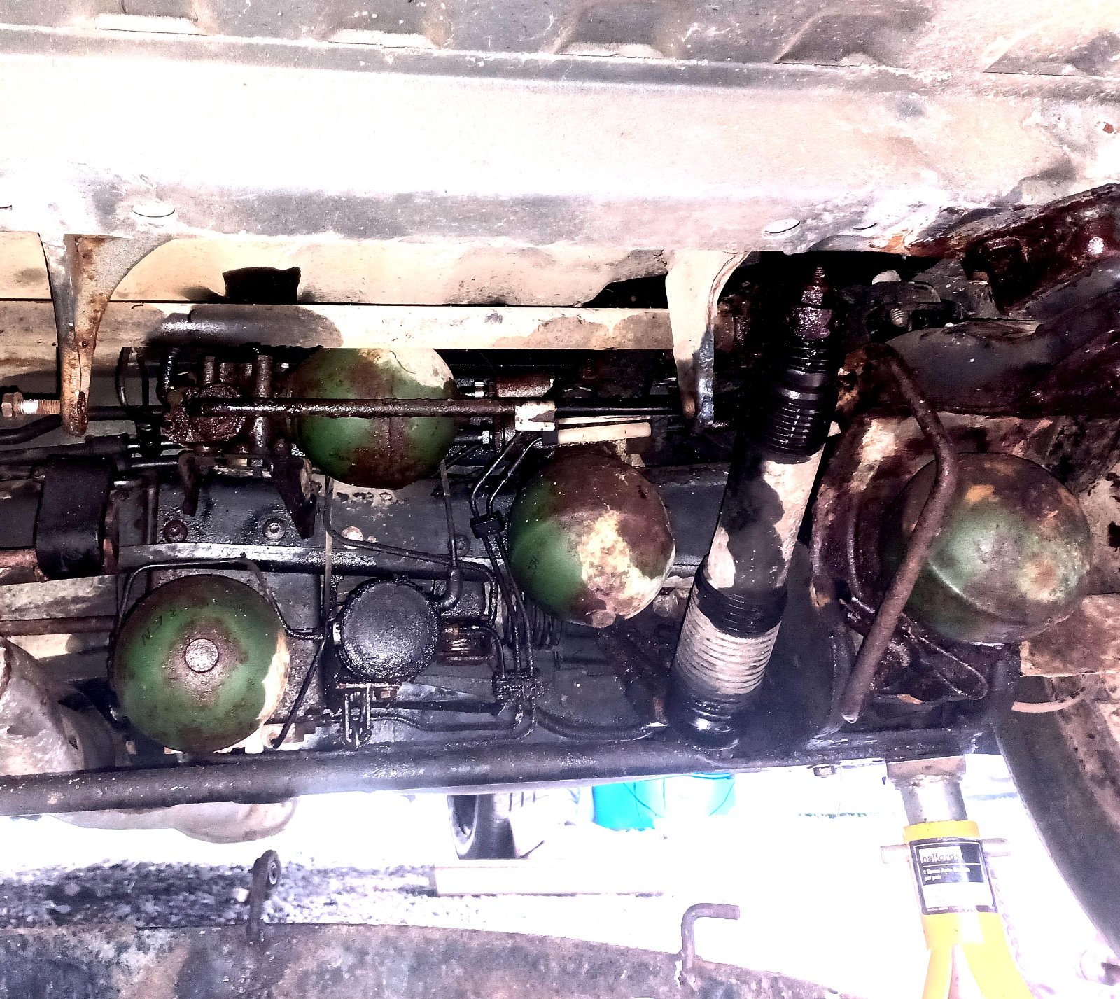

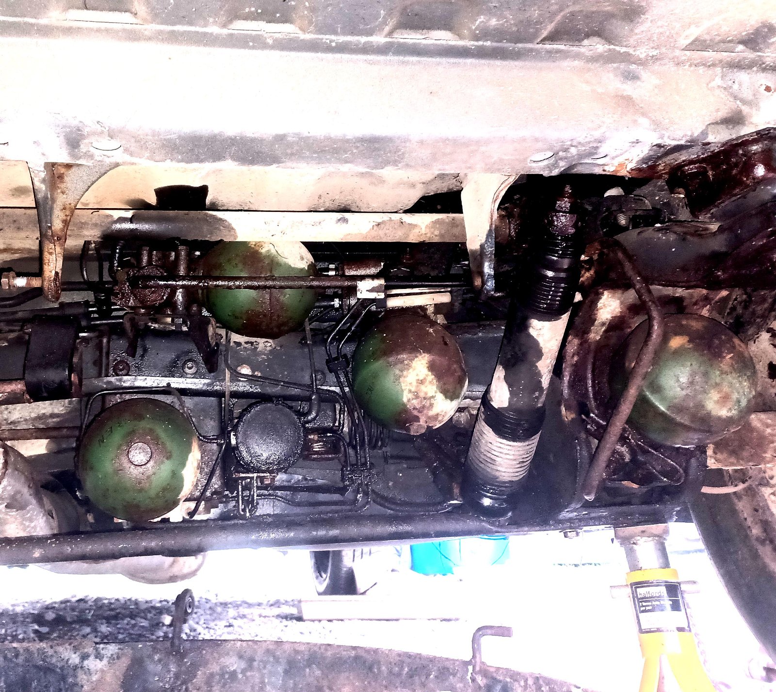

More prep work on the TaffyTiva............
Jacked and levelled with axle-stands so I could remove the spare and its tray.....excuse the oil staining as I applied loads of penetrating oil before I took the photo (dogh!).....I used a whole can !
However I could not see any wet patches or staining before I applied it. This mat be a good sign or it may have dried up over the years it had stood. All rusty looking areas have been hammered to check depth of corrosion, it all seems to be surface only so far.

Looking good Alasdair :D
