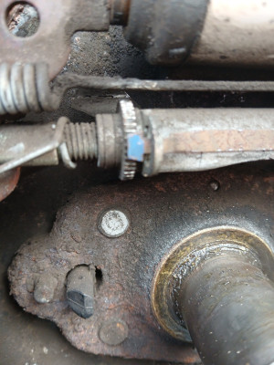

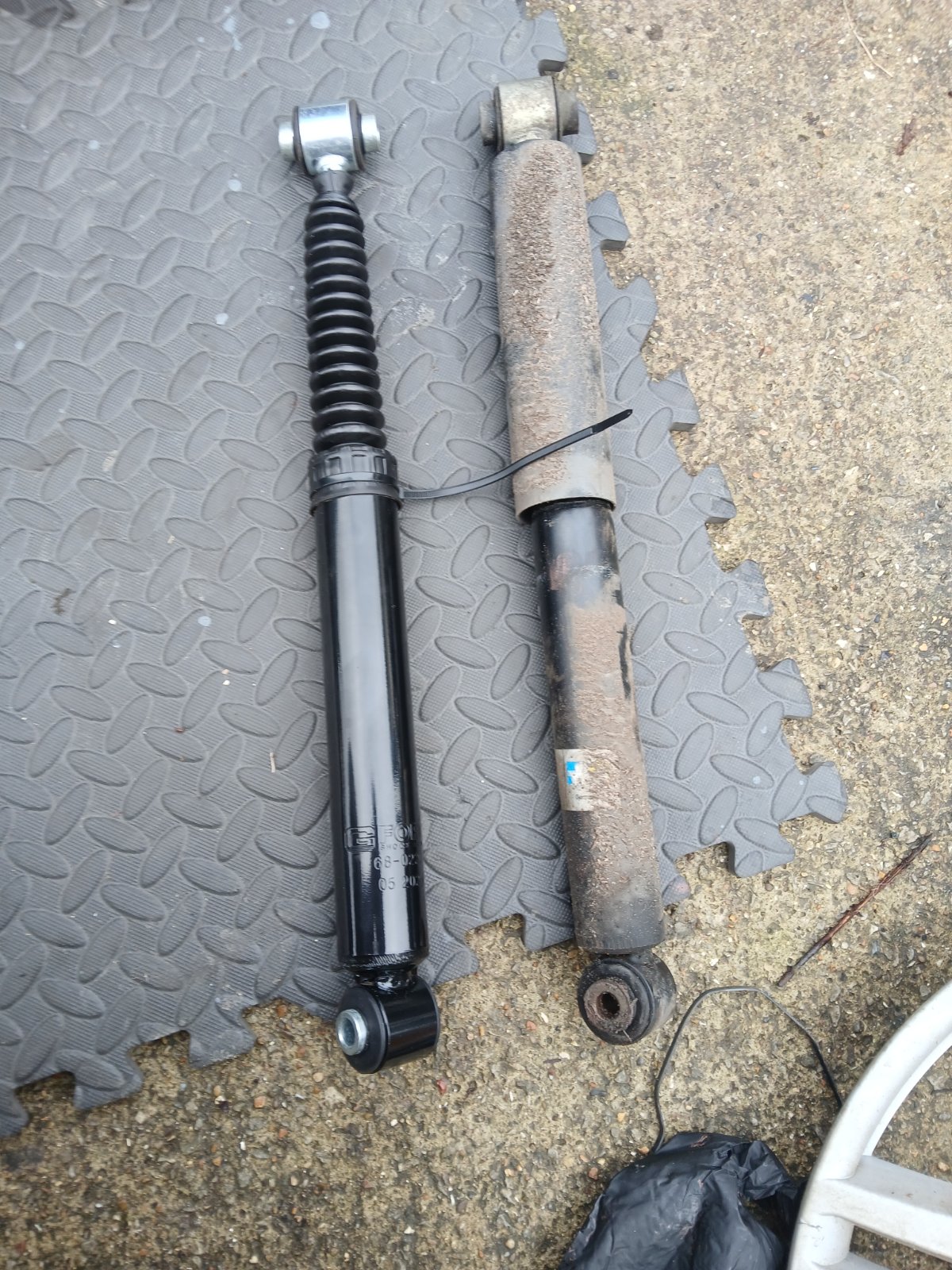

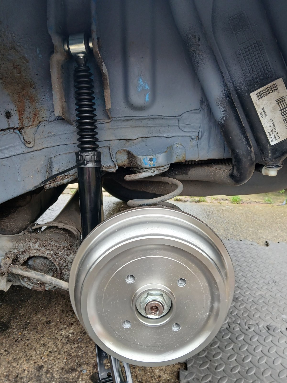

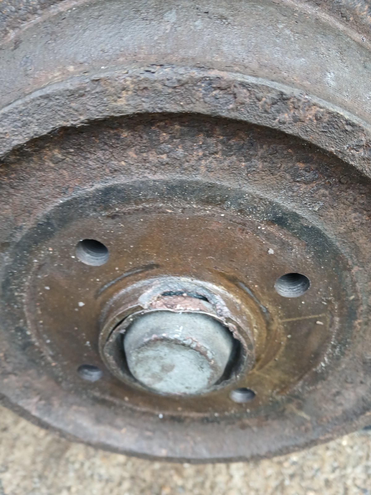

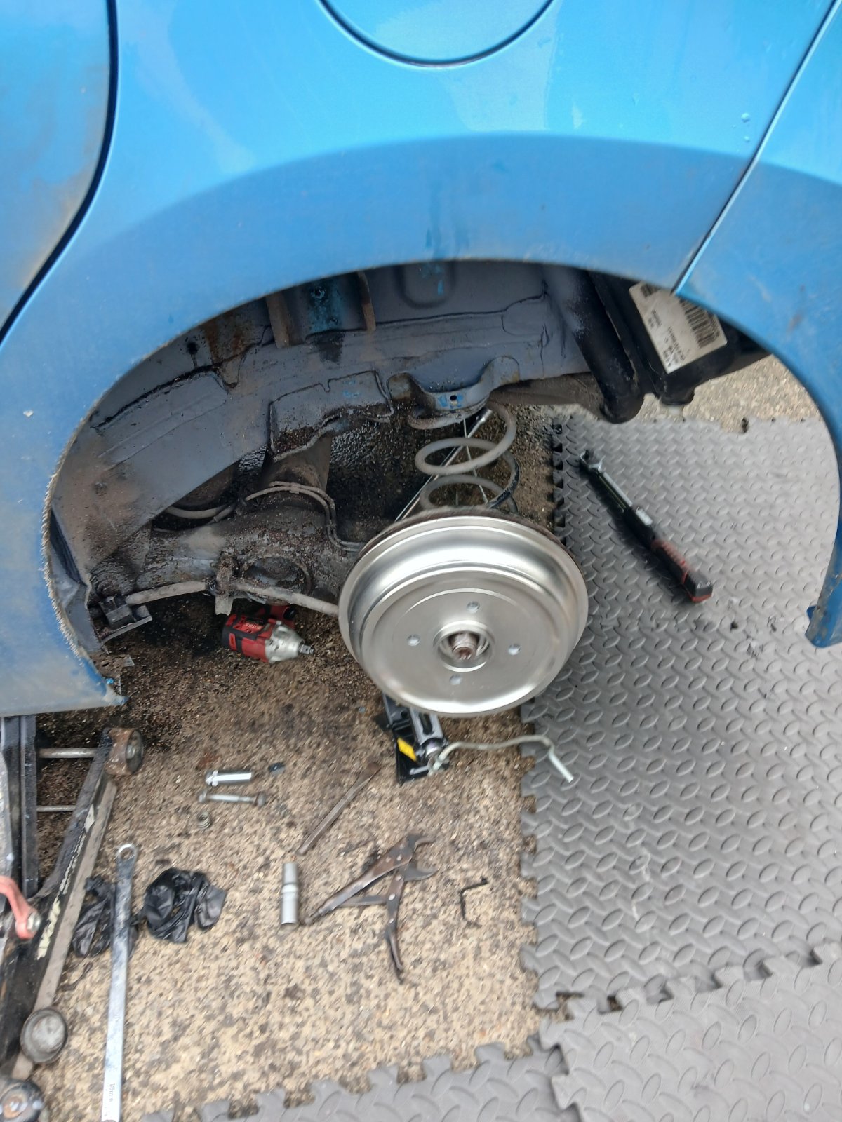

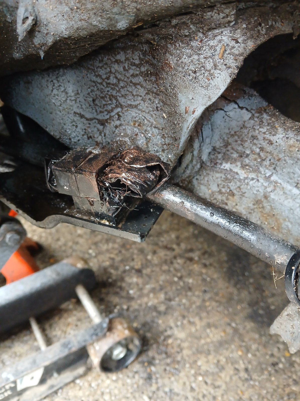

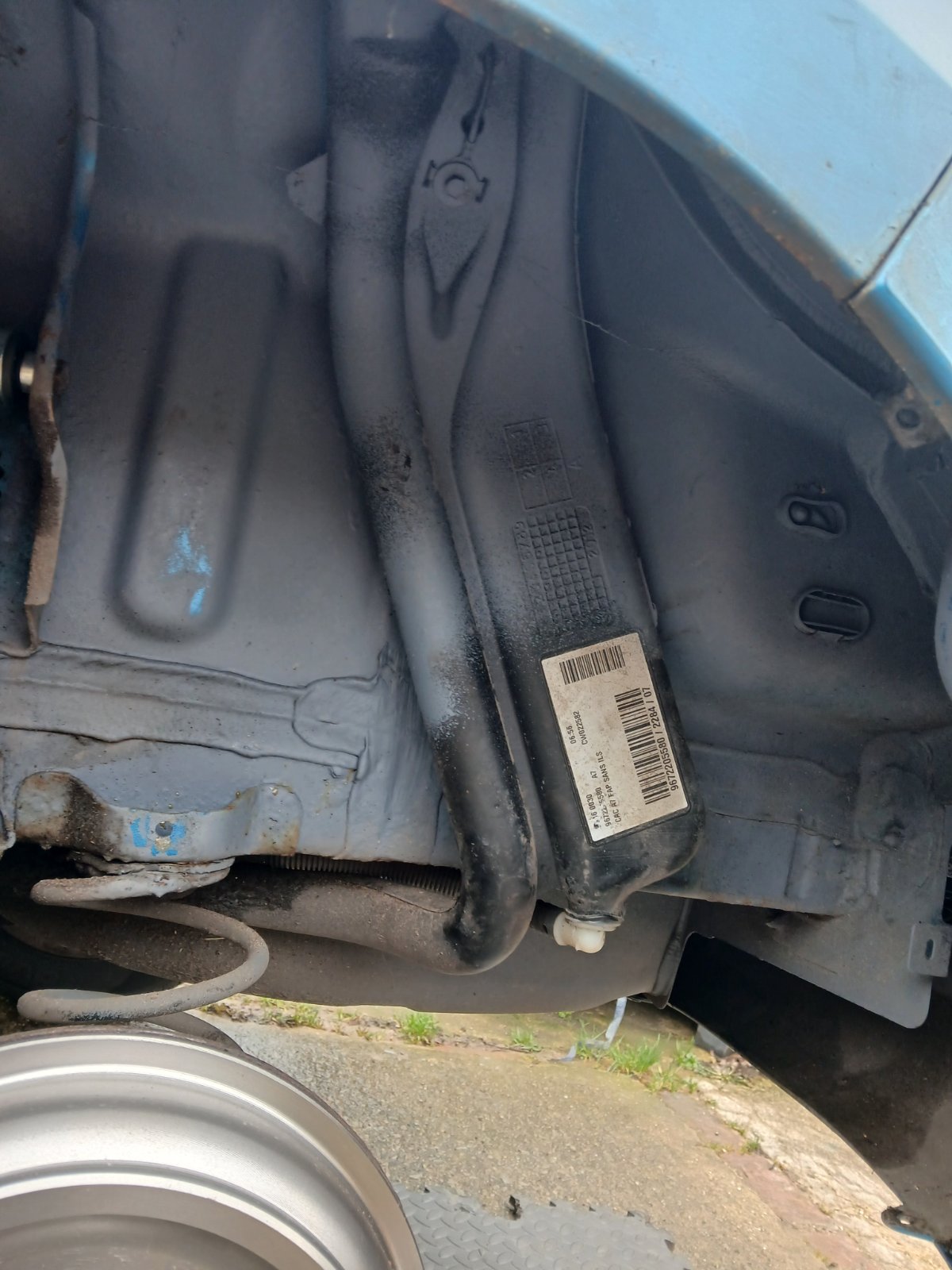

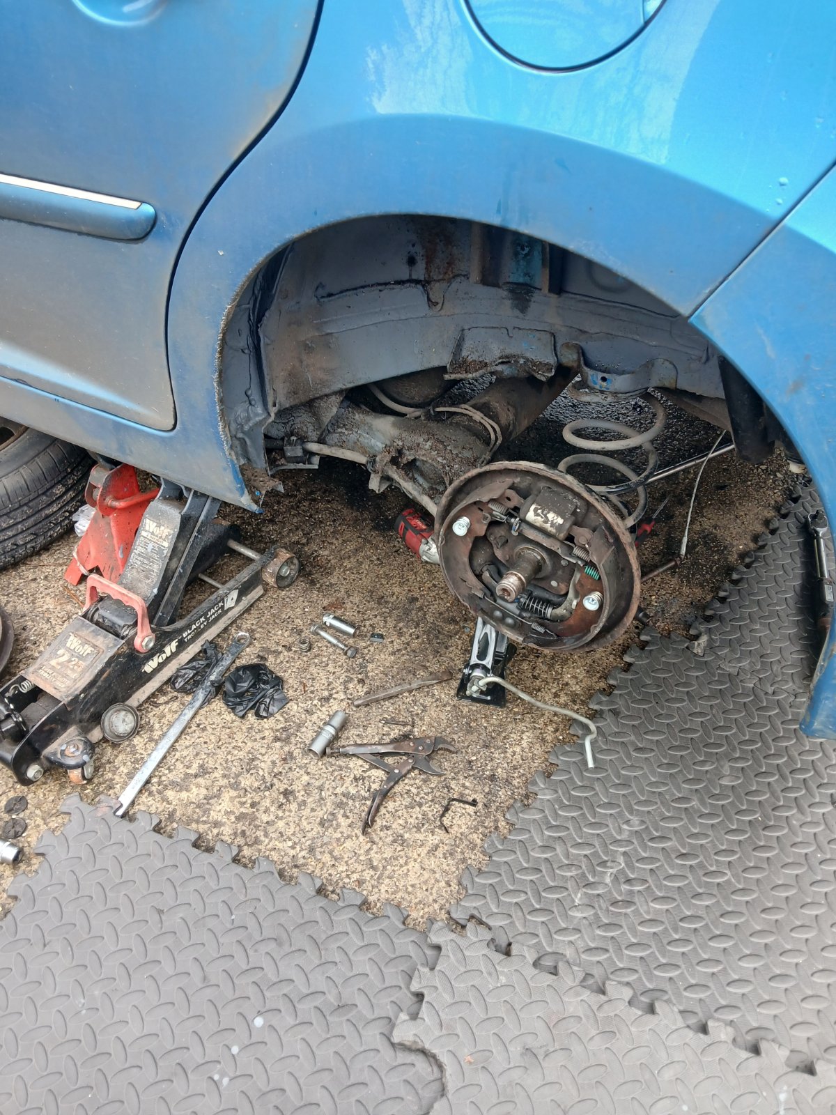

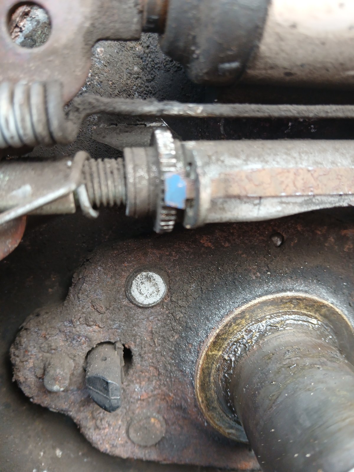

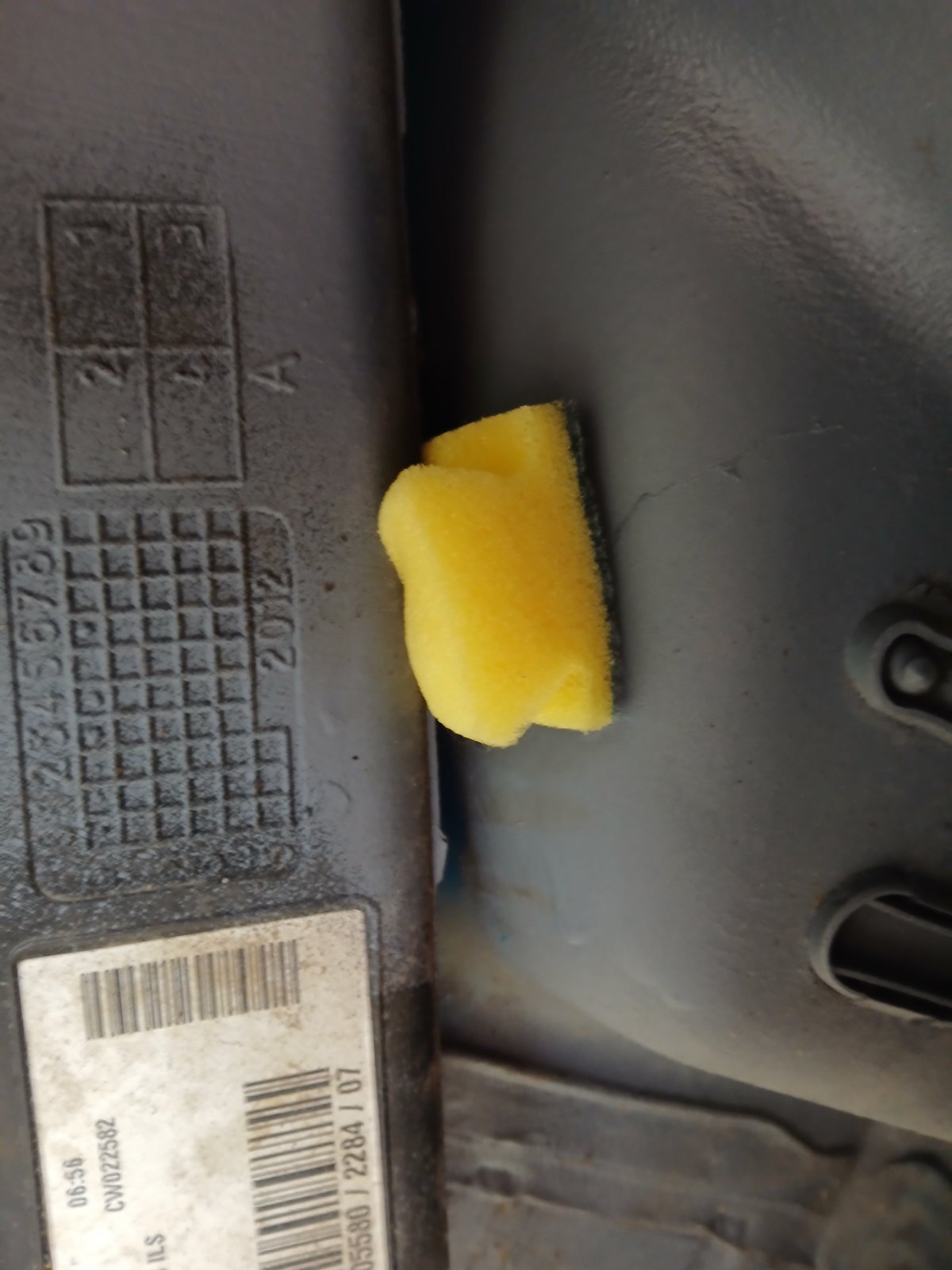

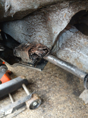

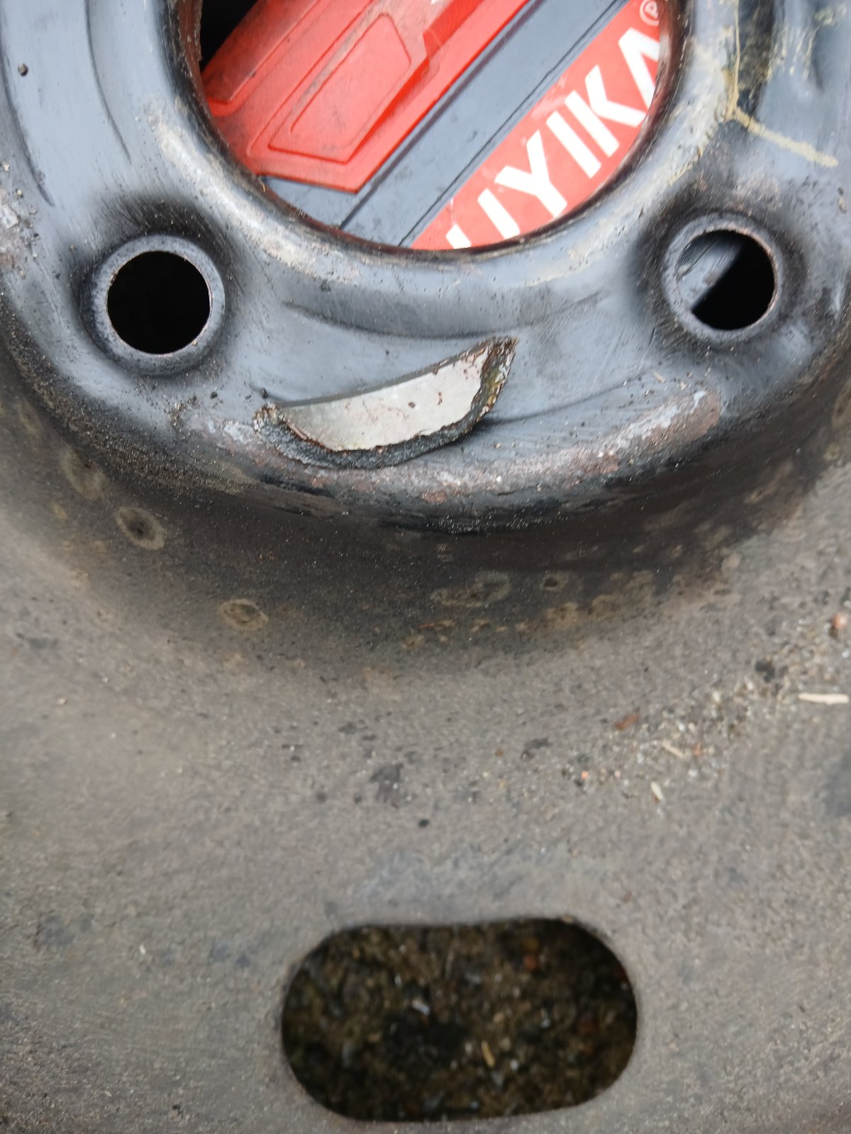

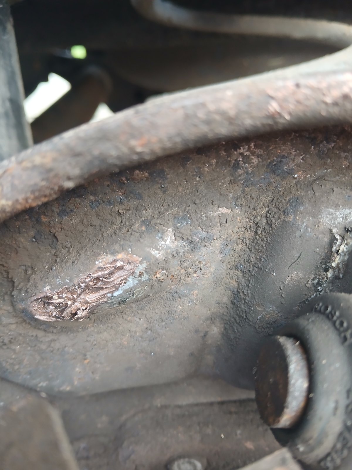

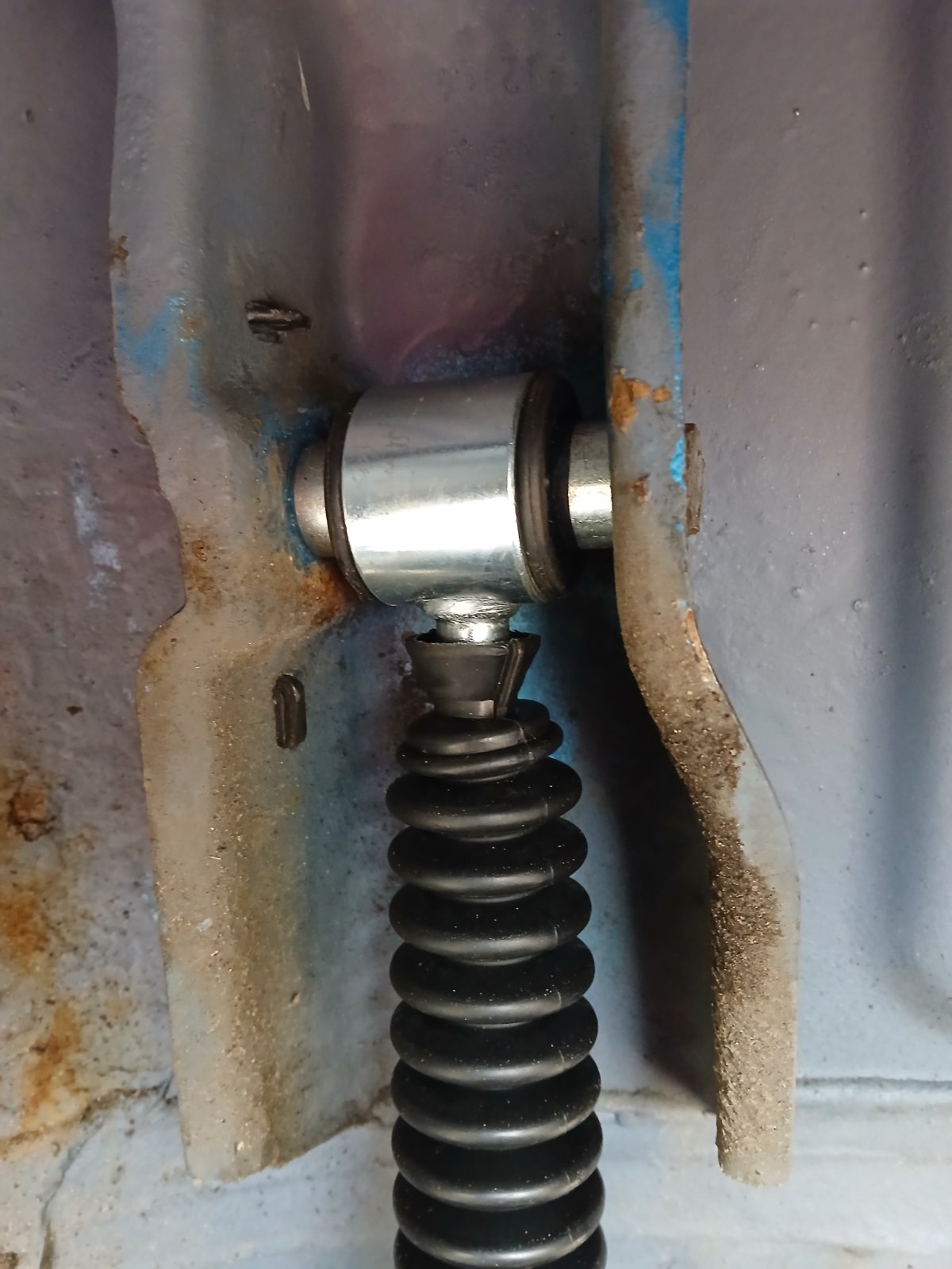

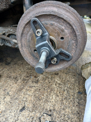

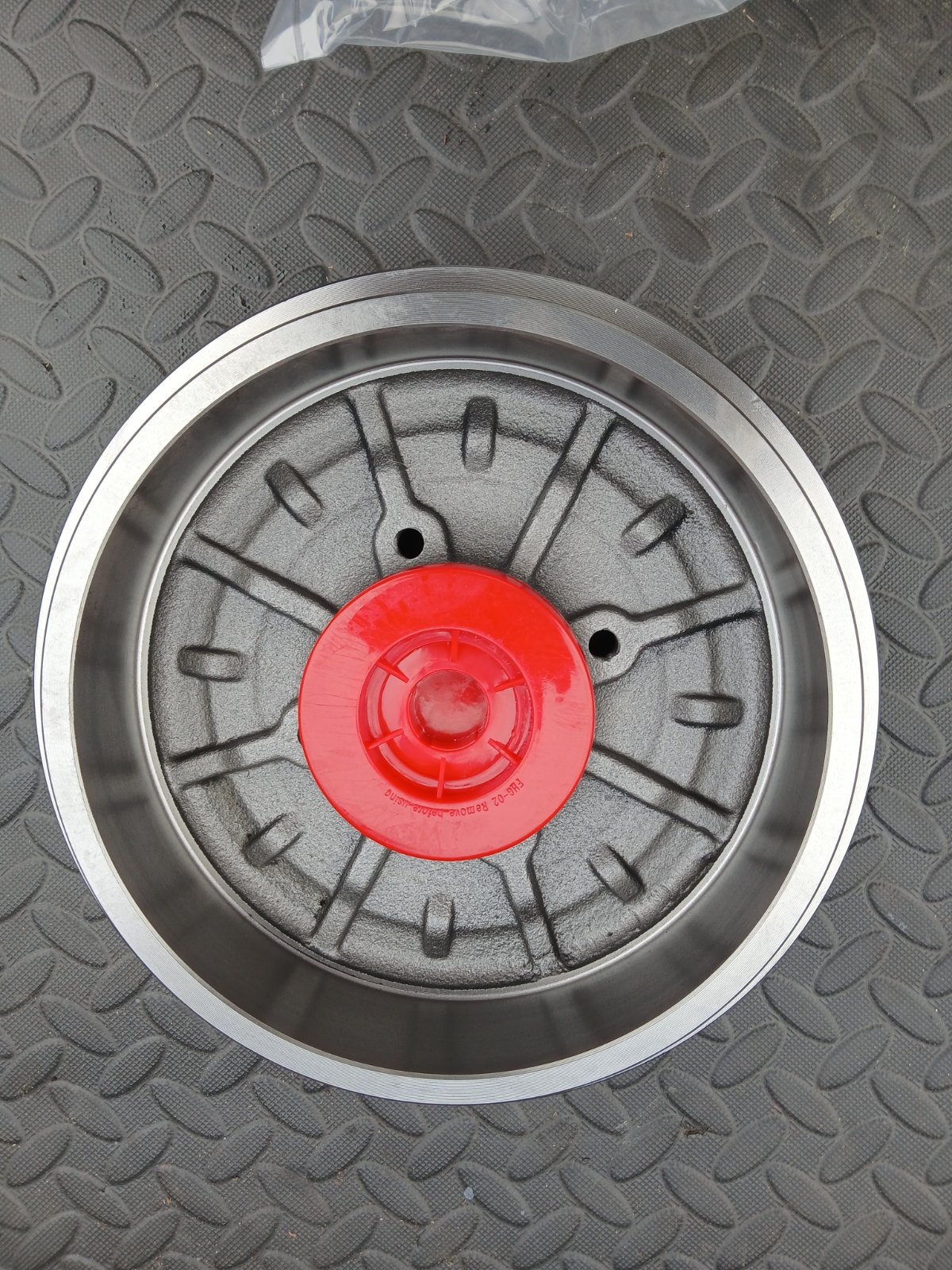

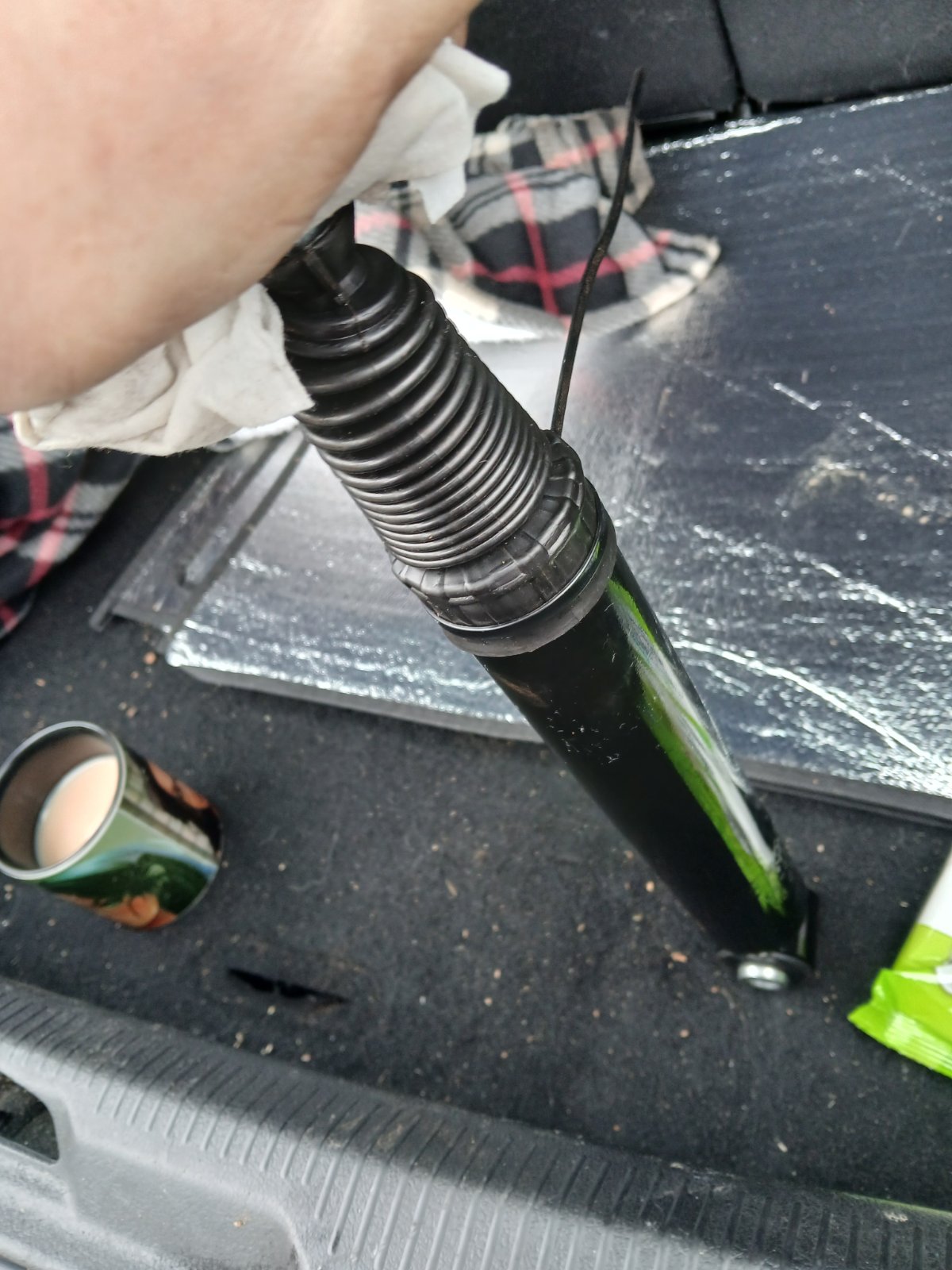

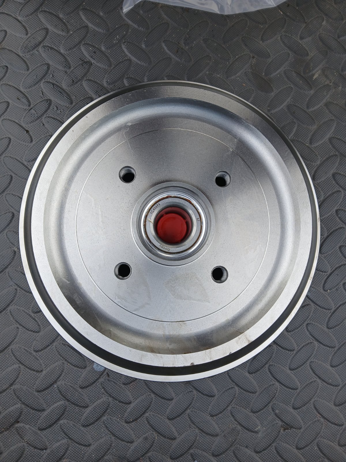

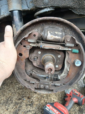

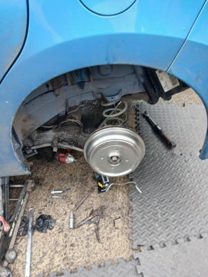

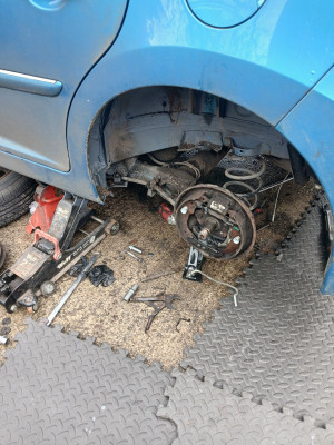

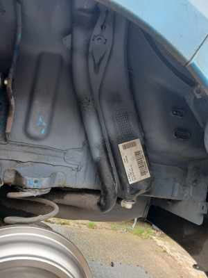

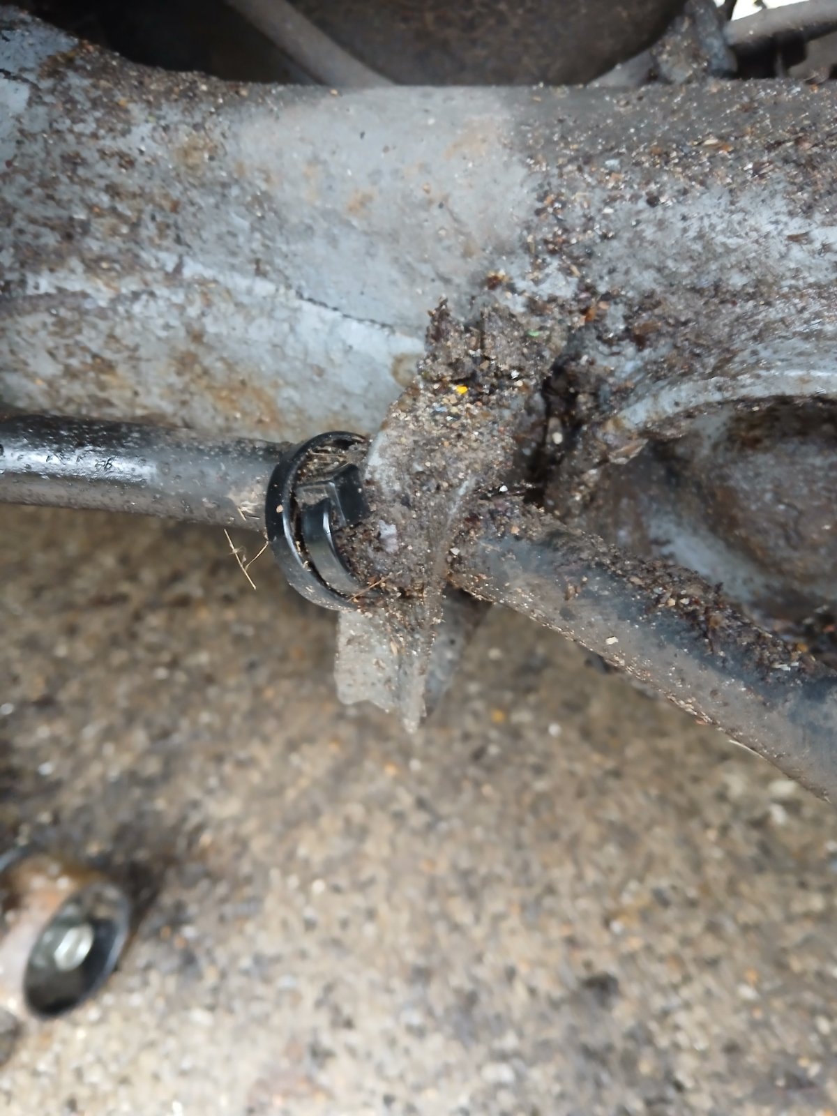

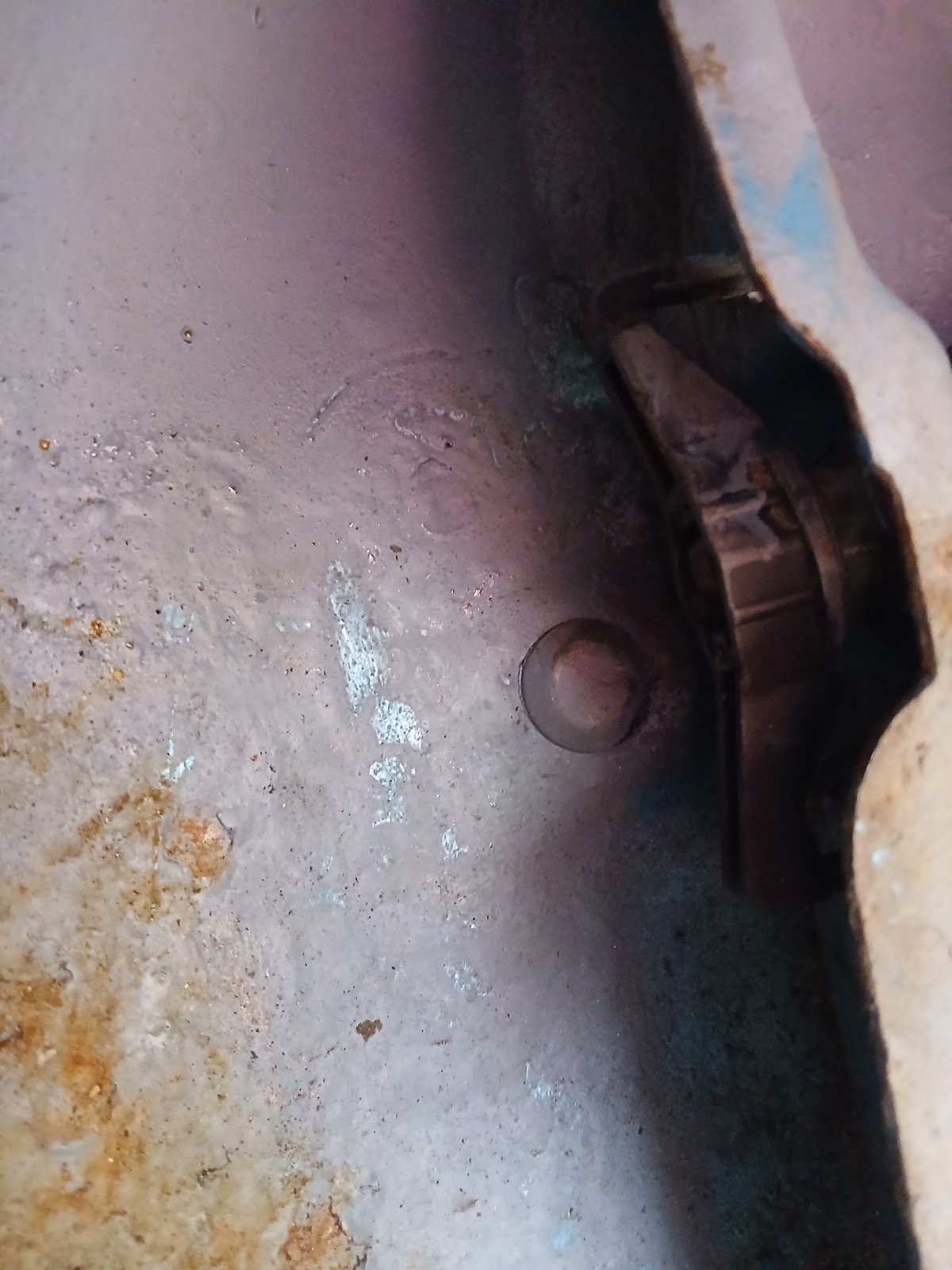

10am till 1pm and a dry day which saw me finally put brand new shocks on the rear of the 207 plus a new brake drum as well. Photos in no order , yellow sponge wedge between filler kneck and car body and the handbrake cable on the rear passenger side i used a lump of copper grease and the old work gloves as a type of packing to eliminate the possibility of that making a noise too.

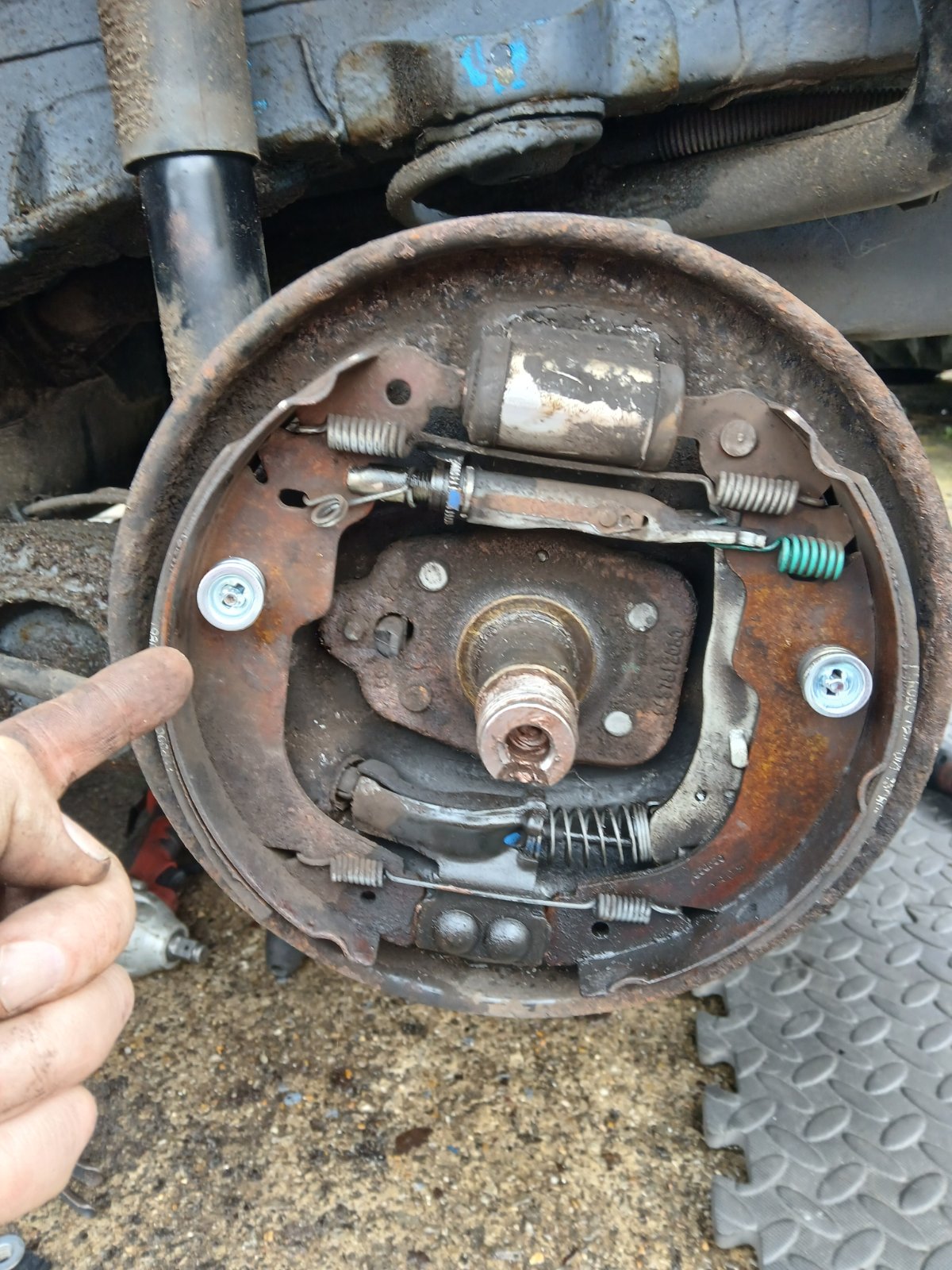

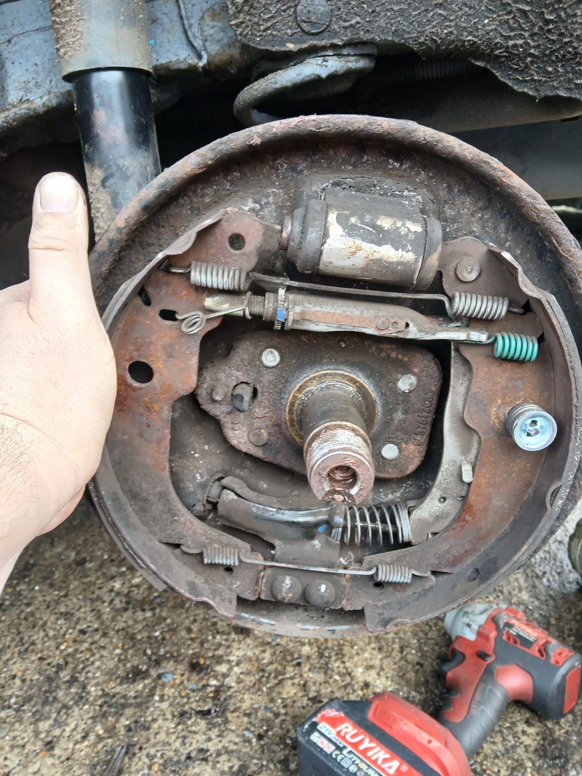

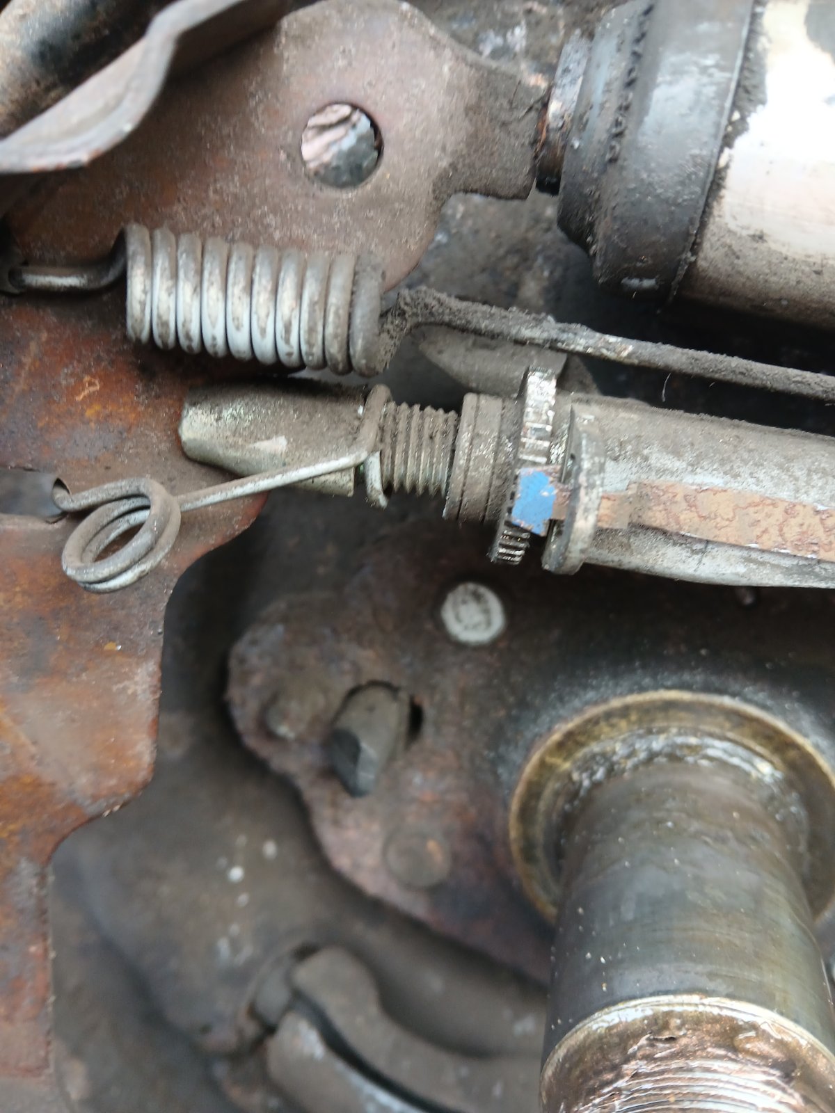

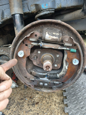

So if you look at the photo collection I took some of the adjuster on the brakes to try show there is no hole behind to gain access to adjust them.

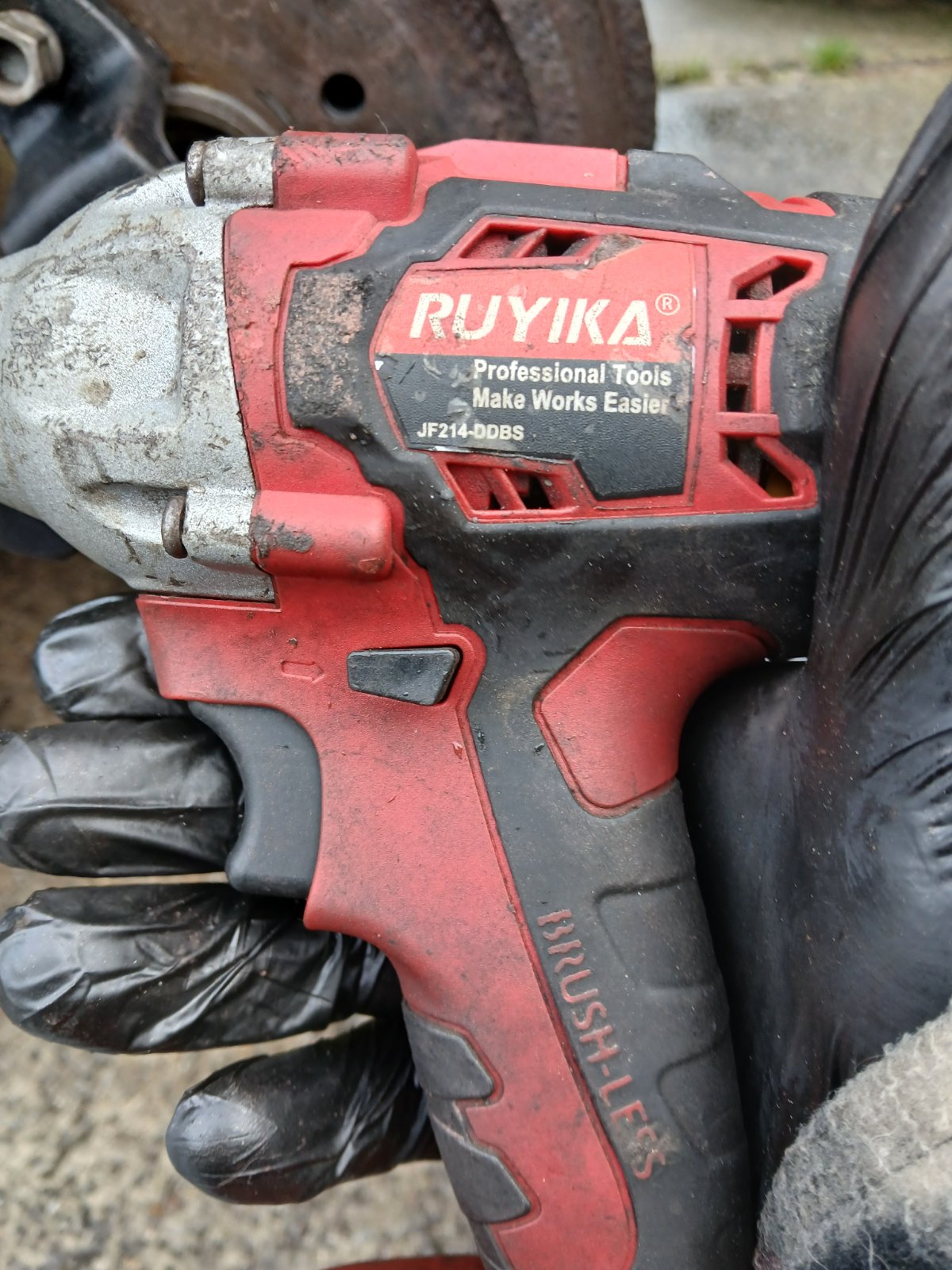

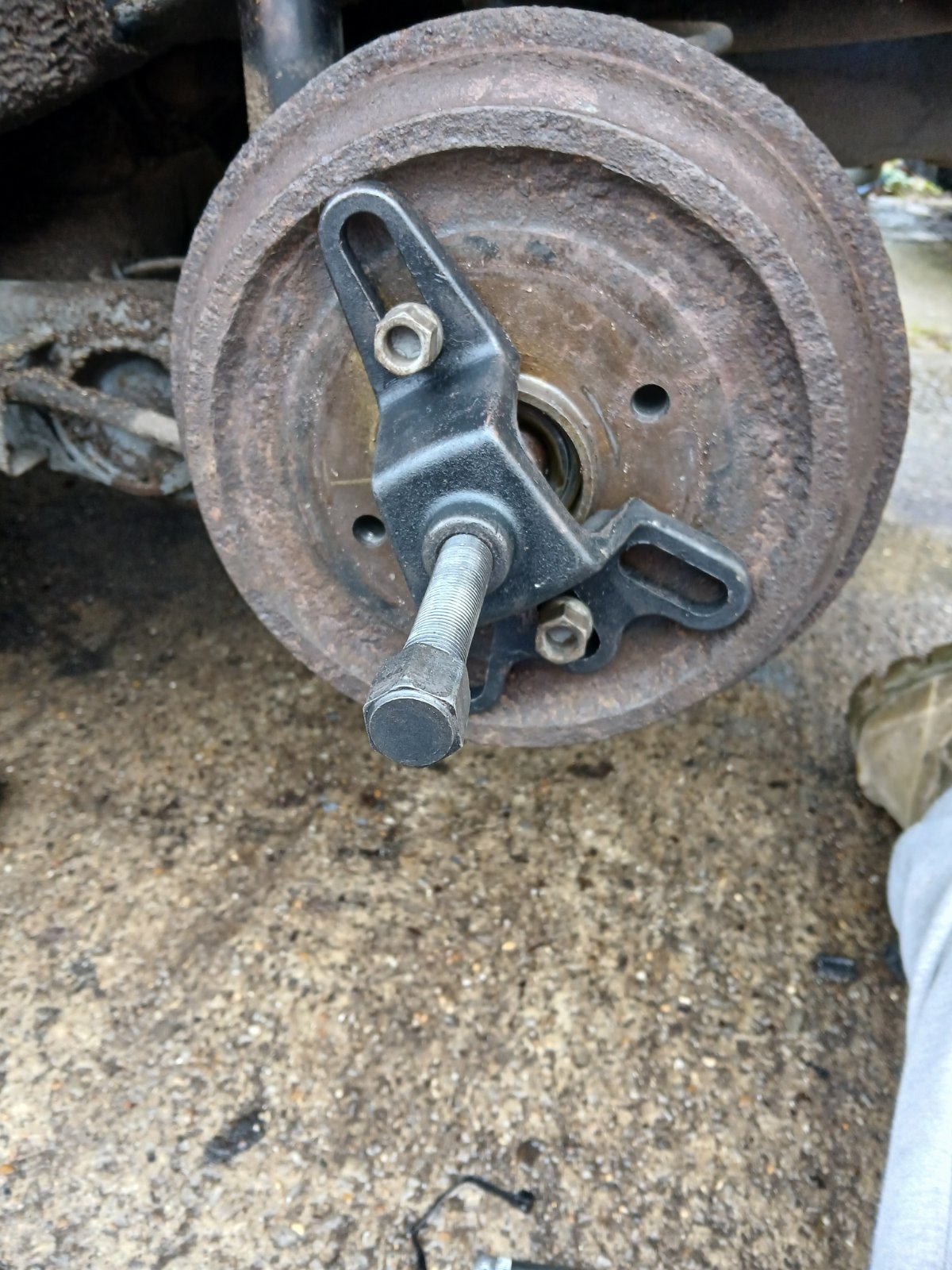

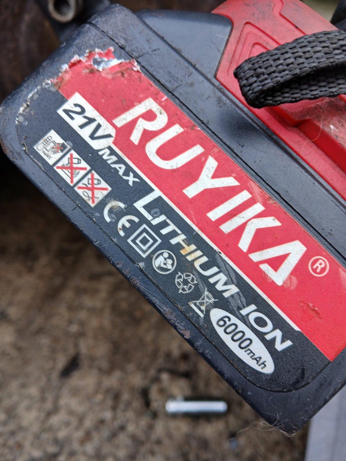

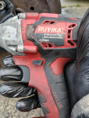

Also was greeted buy the broken piece of original drum when I took the wheel off. Picture of my little impact gun it's good but can't do hubnuts

Today's results
The ride definitely feels better than ever however that knock is still there but nowhere near as regular as it was . One point for about 5 miles there wasn't a peep. Time will tell. At least I know it's all new in the passenger rear.

Good work Husky!
Think that drum spigot has had a good wack to crack a chunk off like that!
Would be tempted to seek out some new hub cap/covers, the one pictured looks a bit mangled to me.

Thanks Matt, Belive it or not the old hub was damaged by the new hub nut cap which came with the new wheel bearing as I was tapping it in place off it flew ... much to my annoyance, this is why I purchased this new one and fitted it today . But I think I will invest in a couple of new ones.
Husky.

When I put the new caps on I use an old bearing shell against it and tap that with the hammer. If it is tapped in the middle it simply gets squashed against the axle/nut and then grinds down as the drum turns putting metal shavings inside (as I found out). To peen the hub nut I use a couple of hammers, the ball of one against the nut and then hit this hammer with the other.
You have probably done it but I put copper grease on the adjuster threads so the cog can turn easily.

I even put a dab of copper grease on the backing plate where the shoes touch just to make sure it was nice a slippery for the shoe to have movement without to much friction

Yes a good idea that. I try and tap around the edge but something the right diameter (bit big for a socket) to drive it down evenly is just the thing.PaulC5 wrote: 13 Feb 2026, 22:22 When I put the new caps on I use an old bearing shell against it and tap that with the hammer. If it is tapped in the middle it simply gets squashed against the axle/nut and then grinds down as the drum turns putting metal shavings inside (as I found out).
Oh! My understanding is you should never bang two hammers together - both hard, they can eject chips at high velocity!To peen the hub nut I use a couple of hammers, the ball of one against the nut and then hit this hammer with the other.
Yep me too, everything gets a smear of the stuffYou have probably done it but I put copper grease on the adjuster threads so the cog can turn easily.
