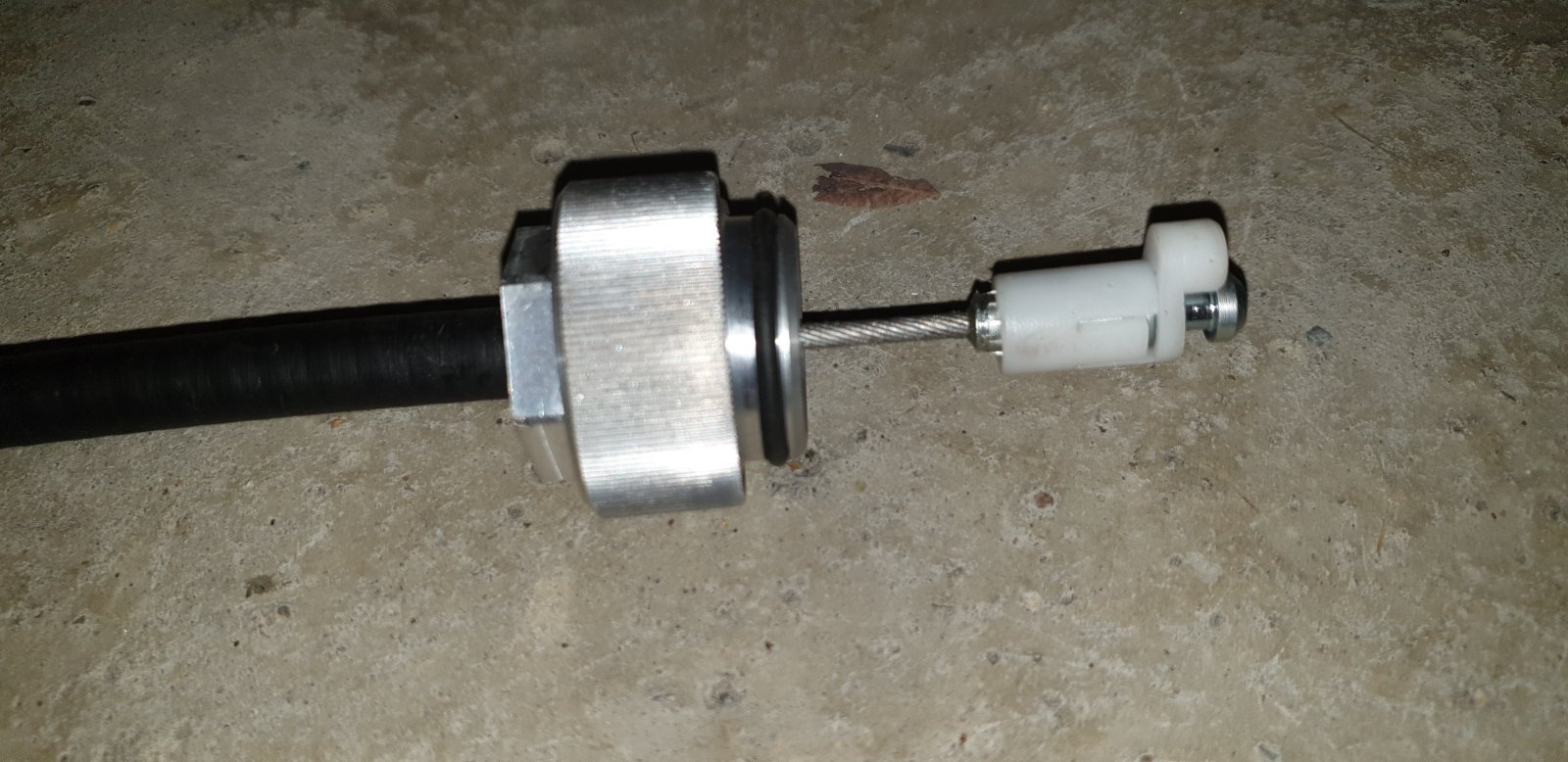

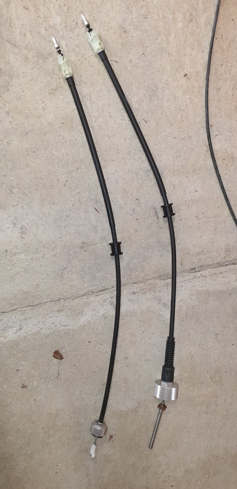

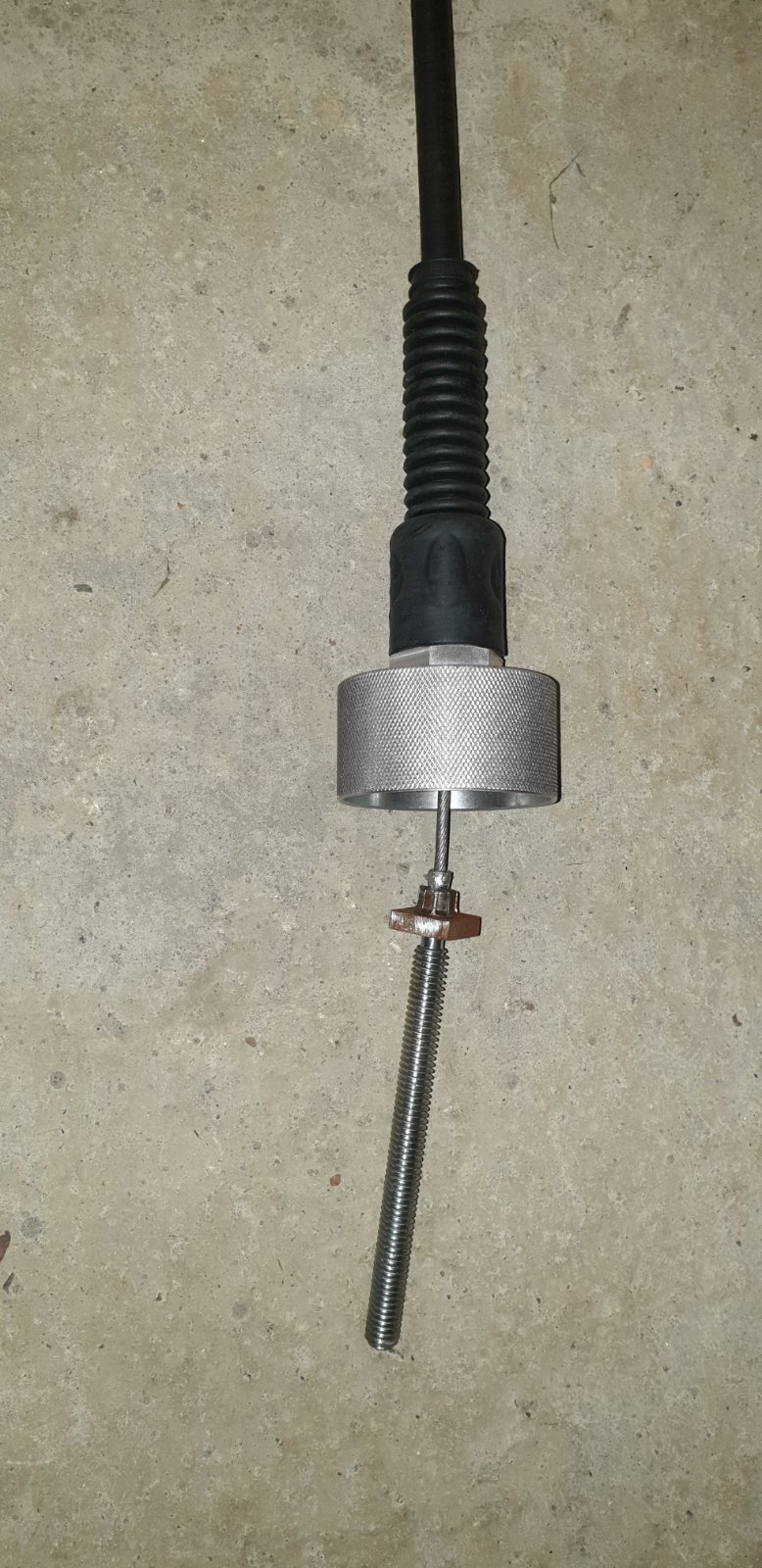

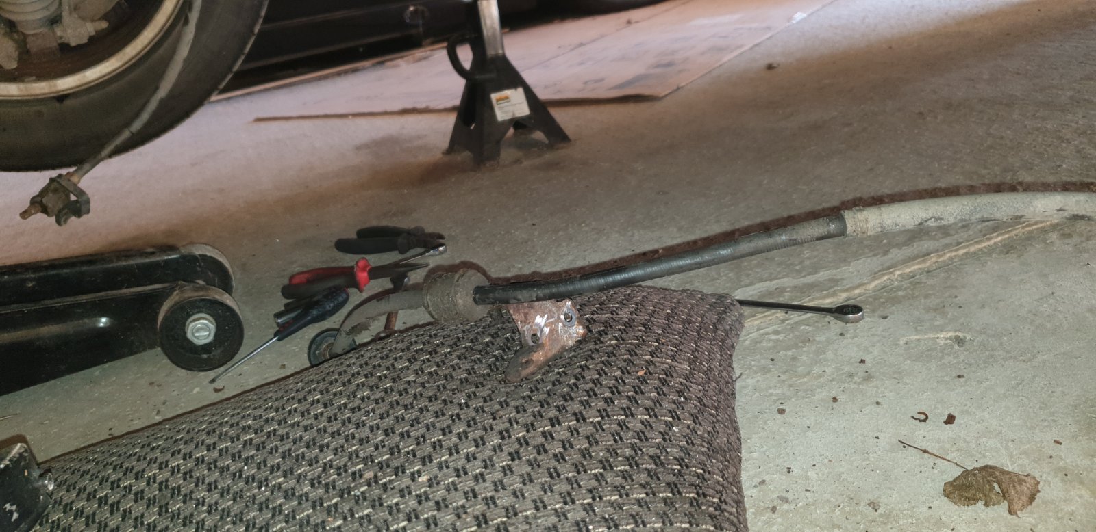

From a kind forum member, these are the new electric hand brake cables I ordered.

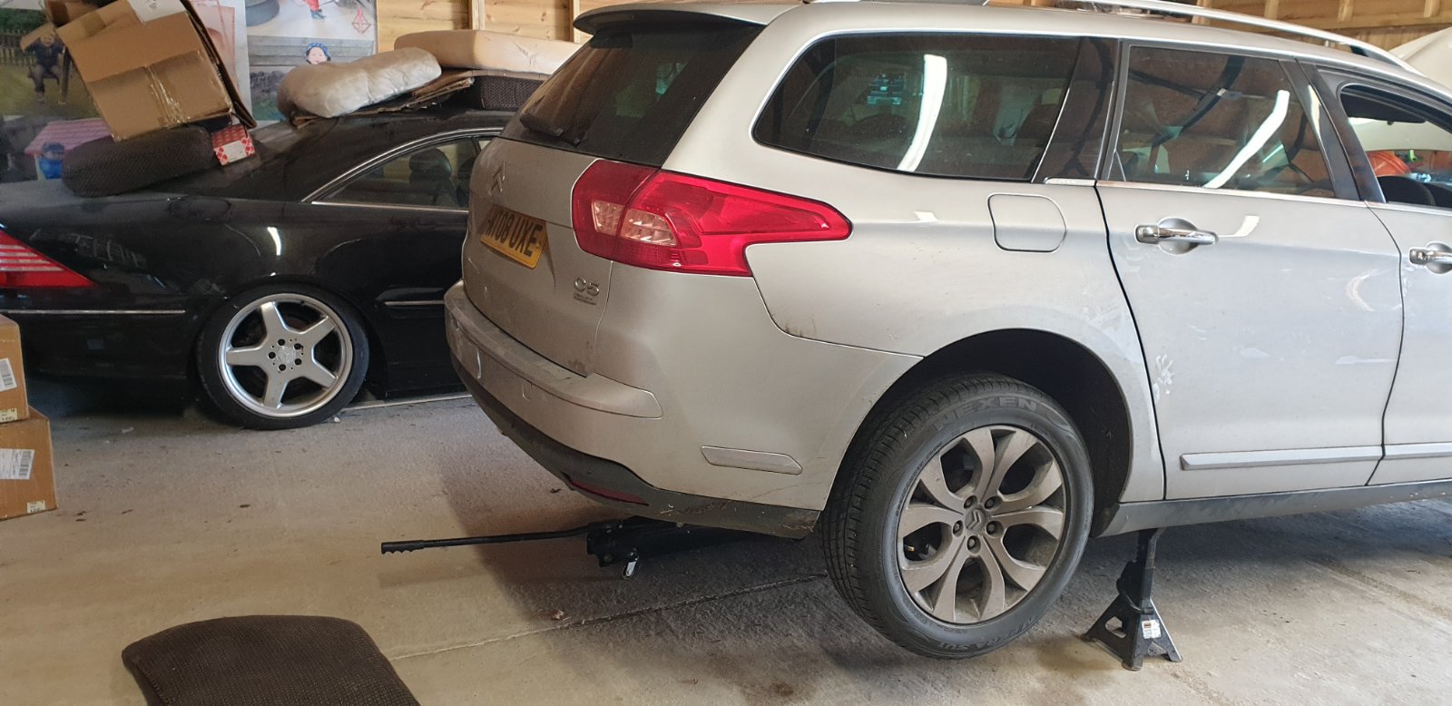

At the weekend I jacked up all four corners of the C5, ready to change the hand brake cables.

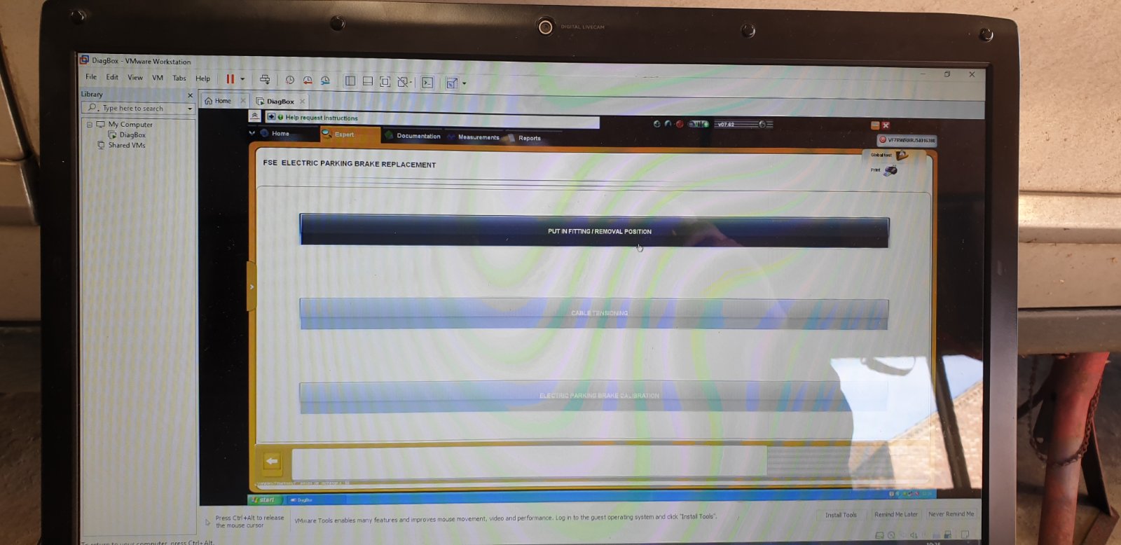

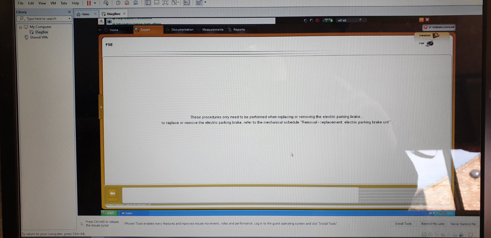

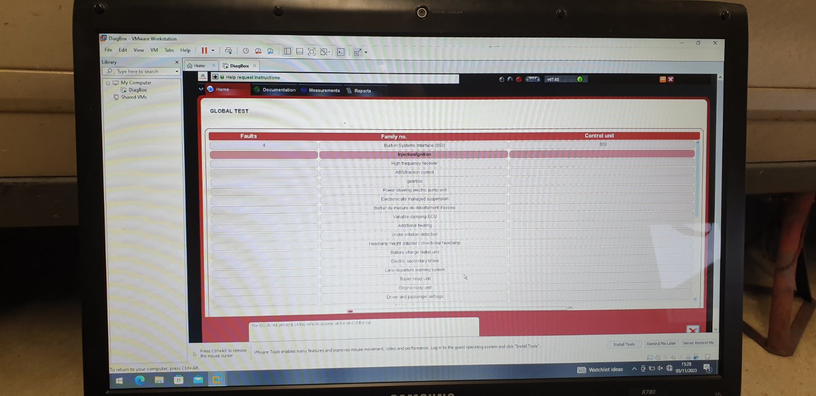

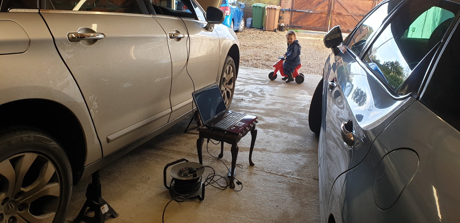

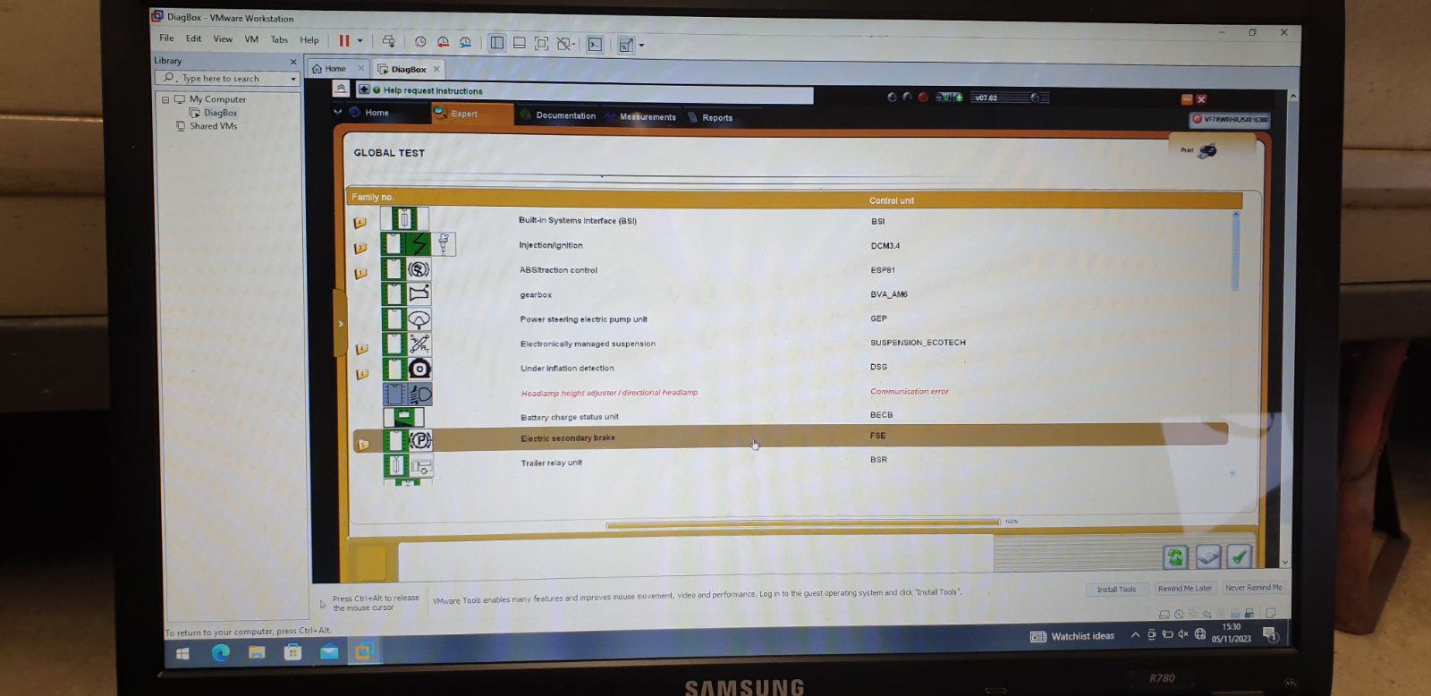

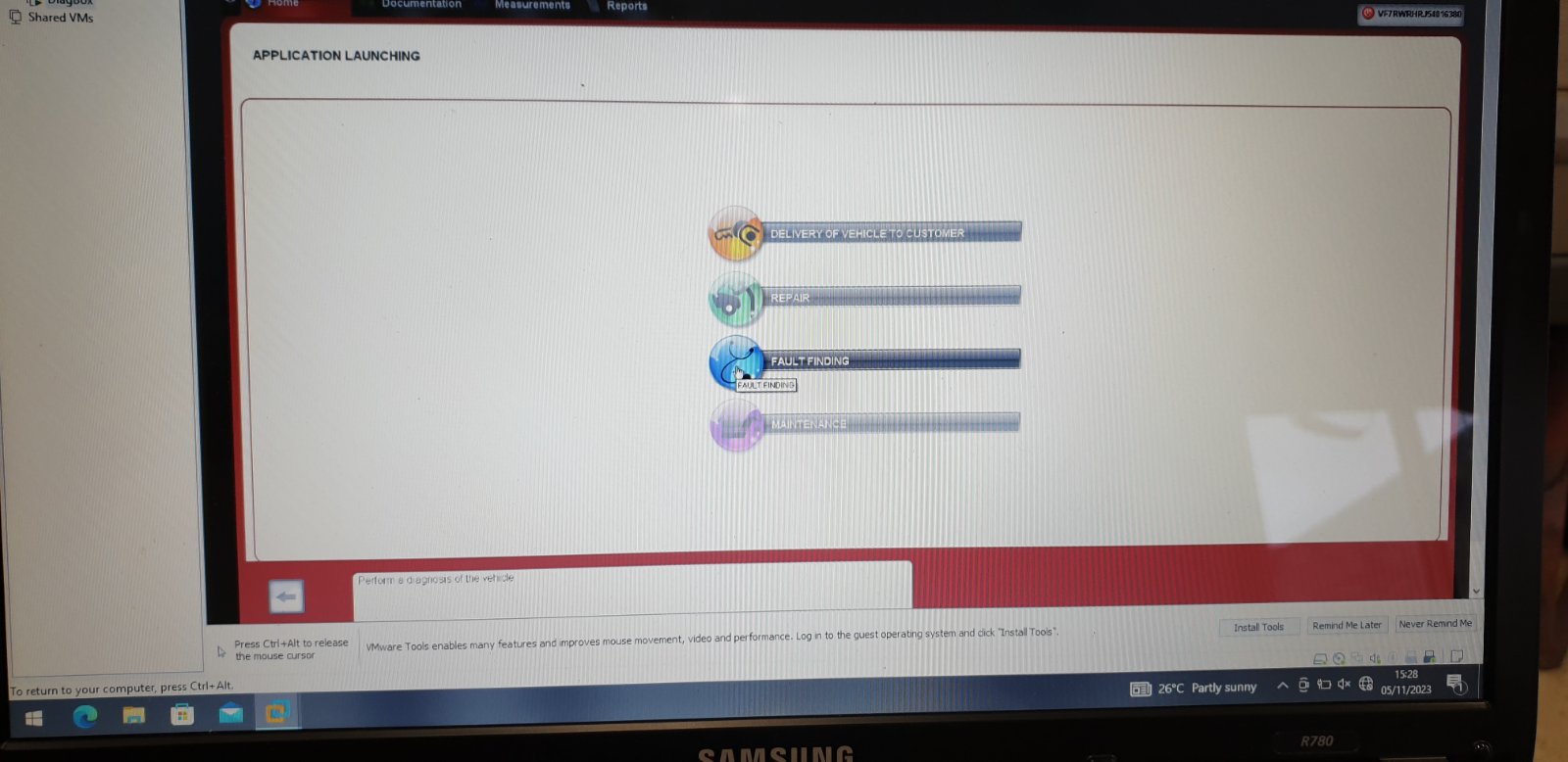

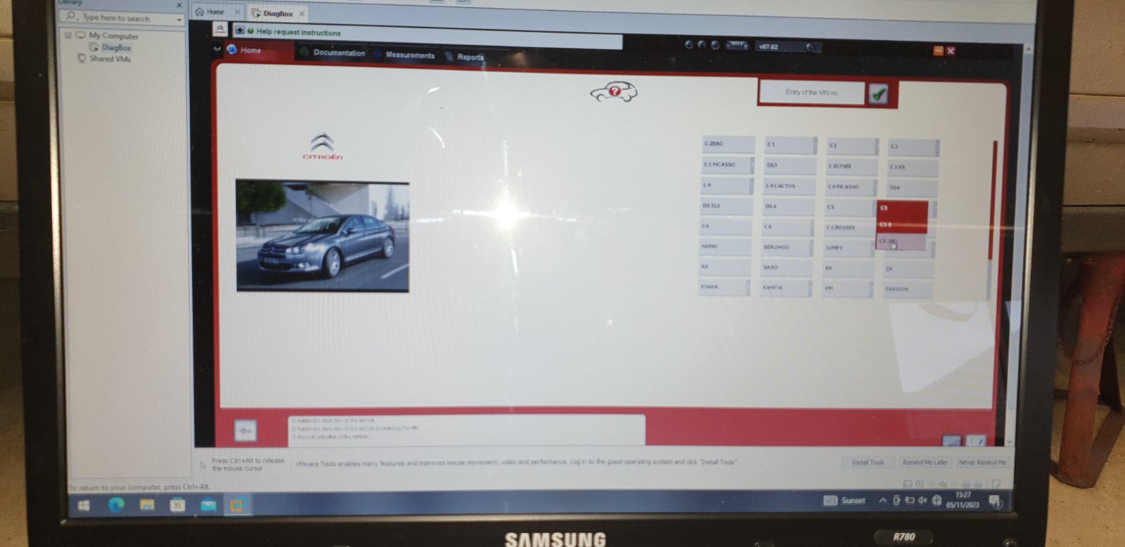

Set up a command station where I could administer the Dogbox diagnostics.

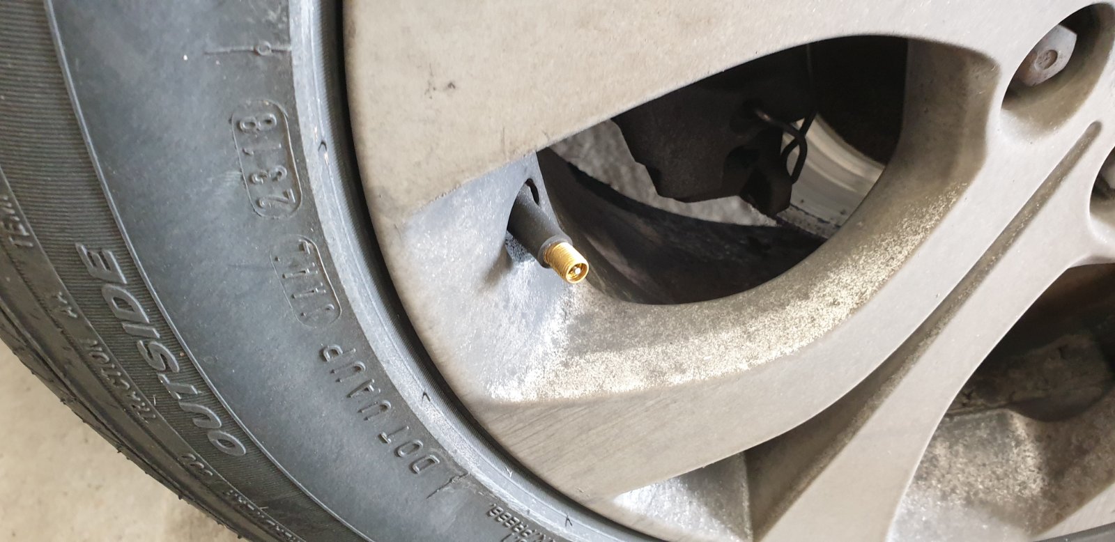

Annoying to discover I have lost a valve cap somehow!

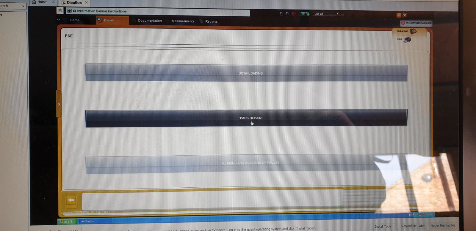

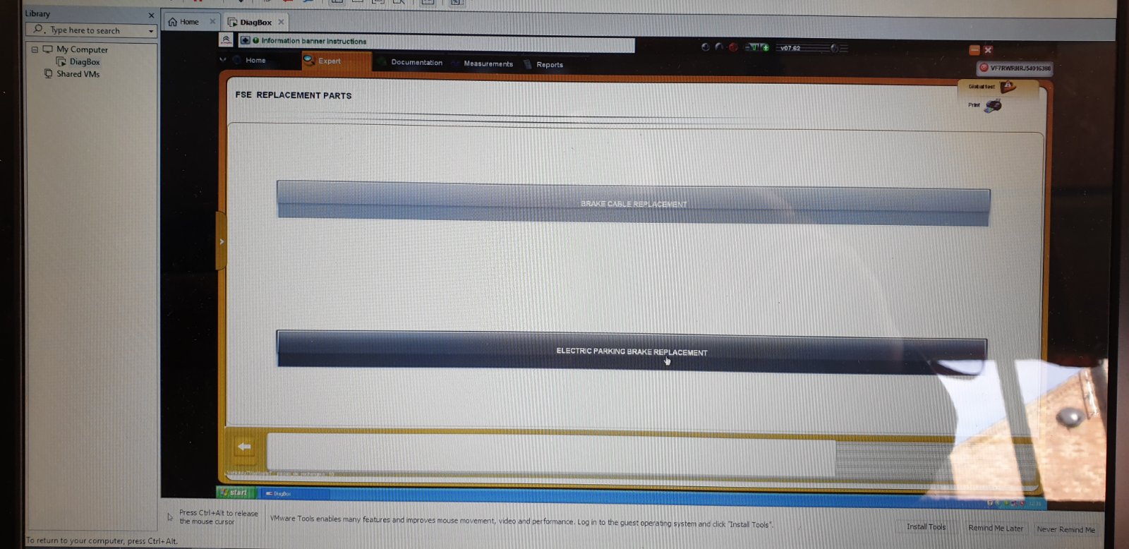

So... back at dog box, I selected the car.

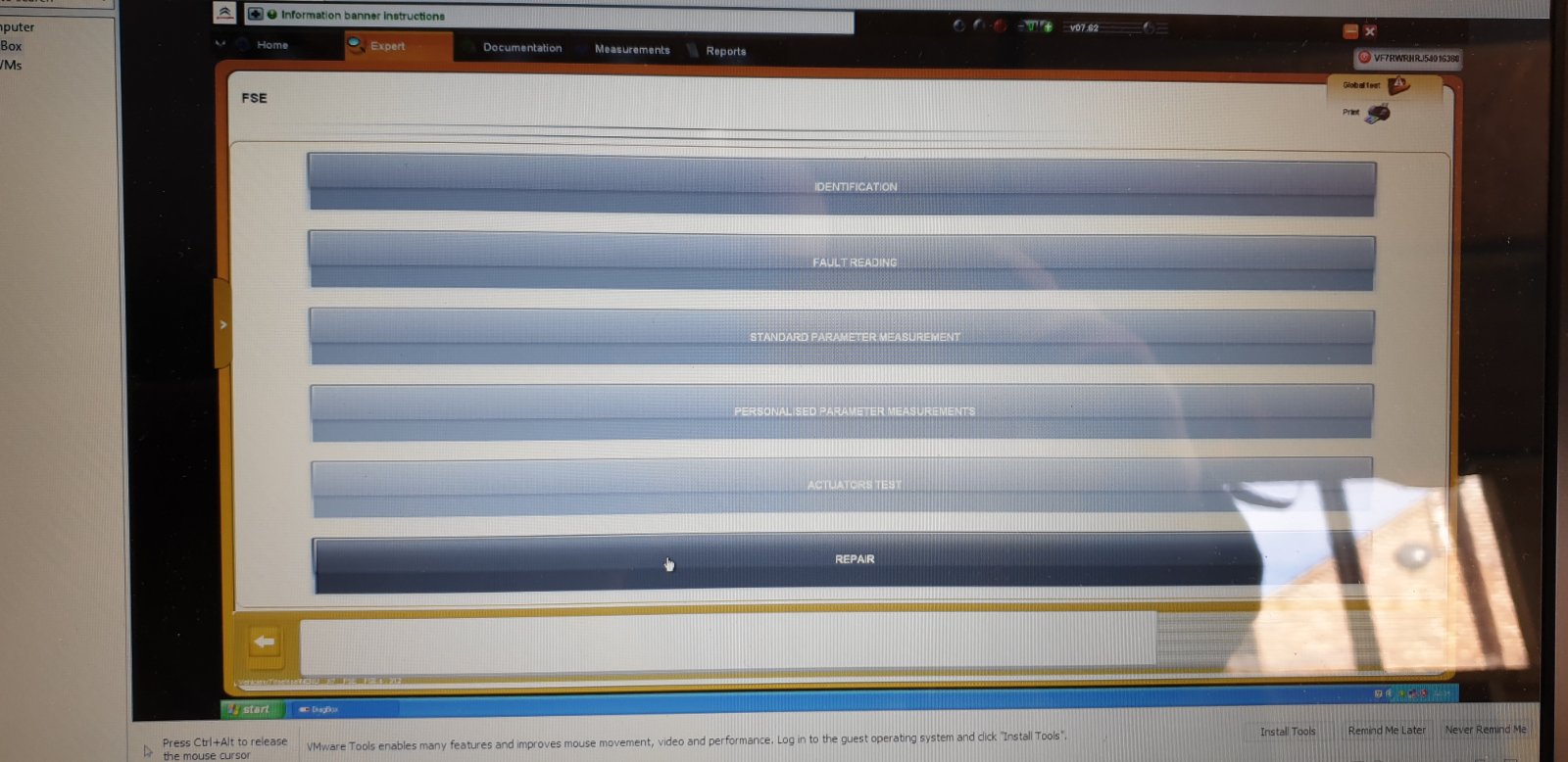

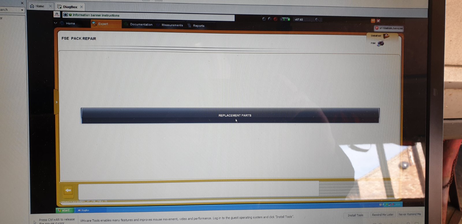

When connected, I ran the "Fault finding" routine, where Dogbox scans the car.
Selected the Electric secondary brake.

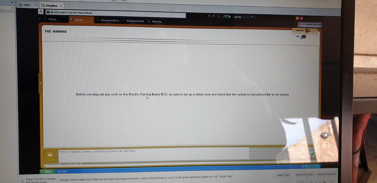

Through the warning...
Select "Repair".
Then "Pack repair".
Then "Replacement part".
"Electric parking brake replacement"

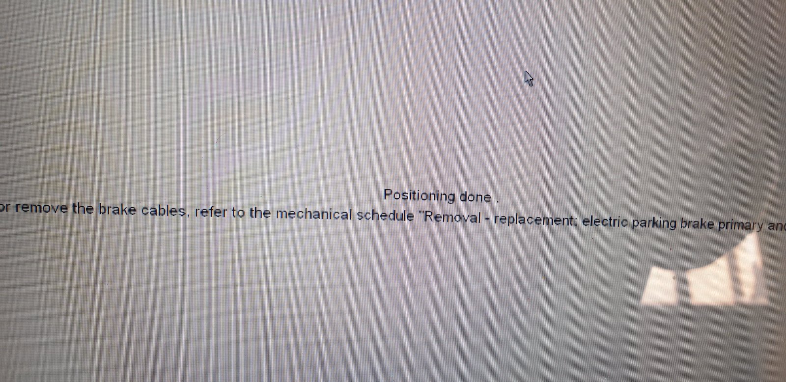

...another warning...
Then I selected "Put in fitting / removal position"...
A few seconds later... all done.

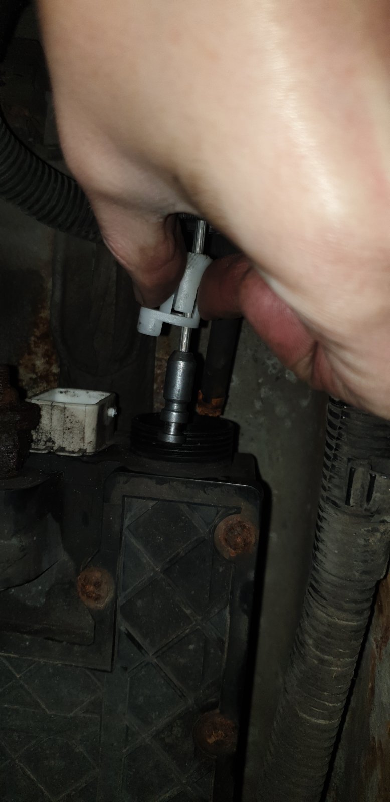

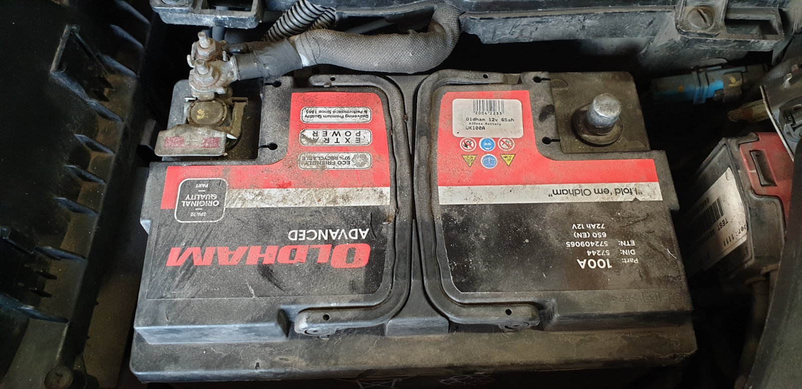

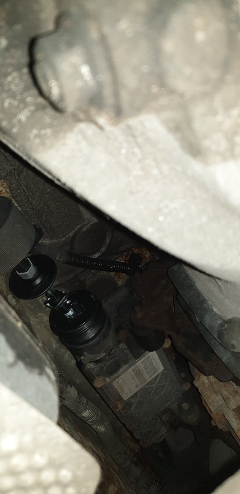

With the brake cables fully released, I disconnected the battery to avoid the car moving the brake back again...

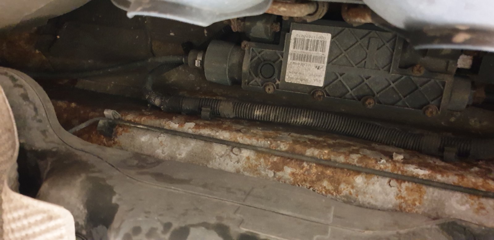

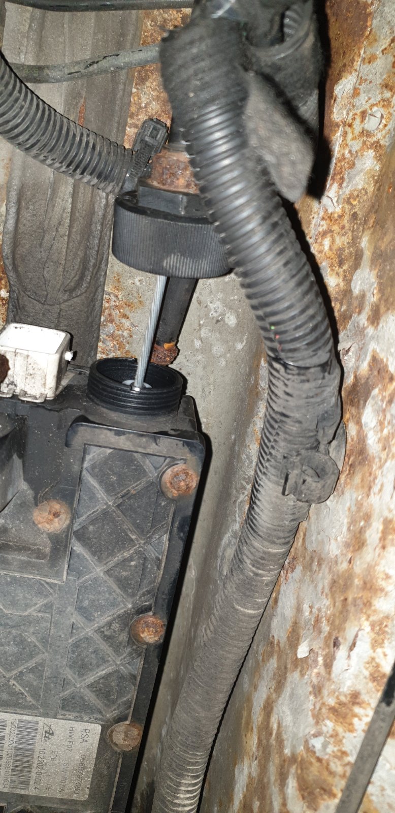

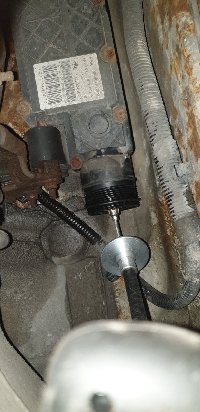

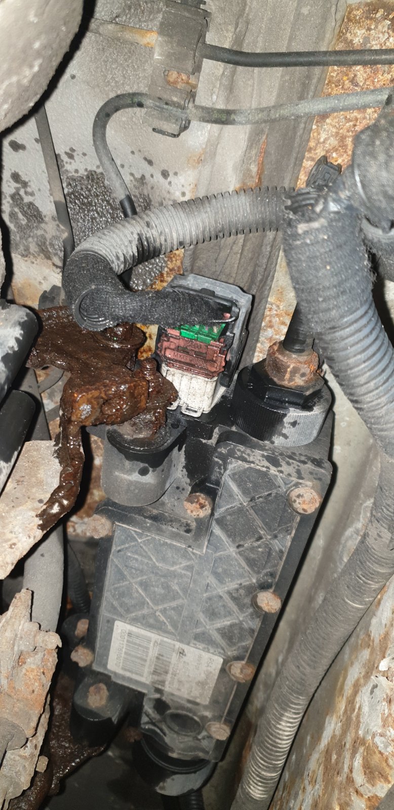

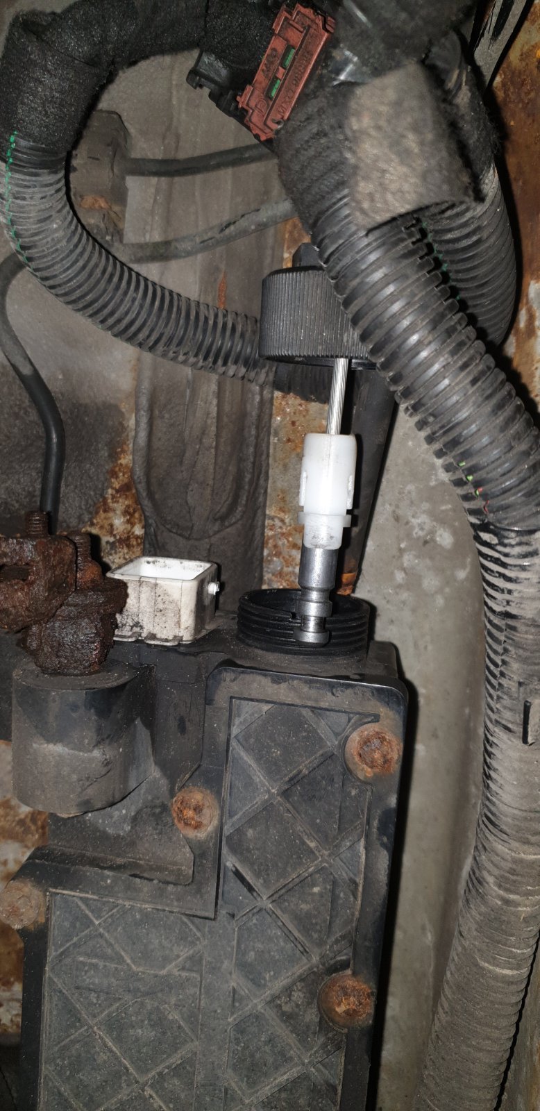

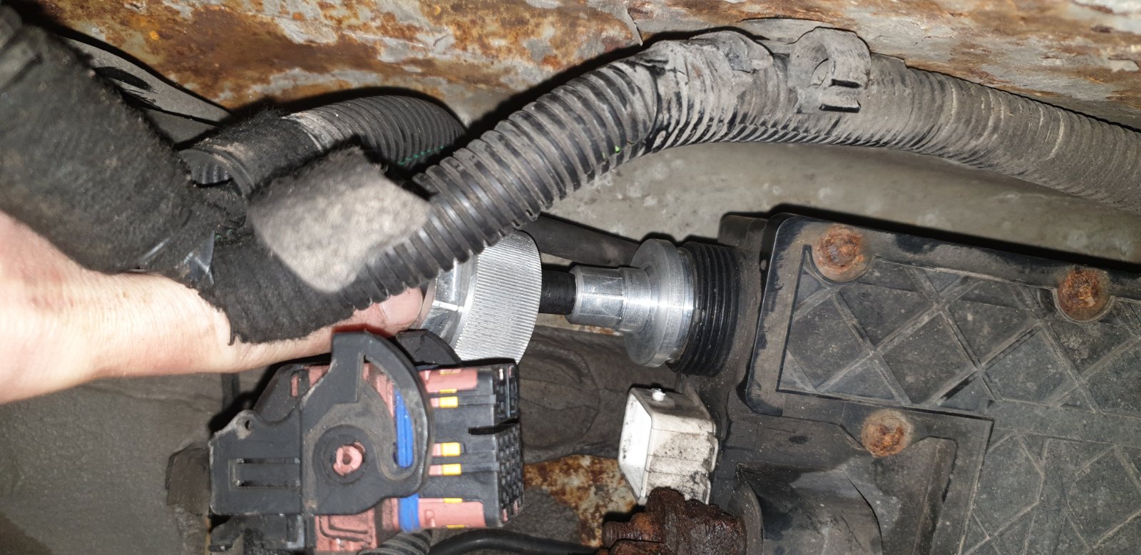

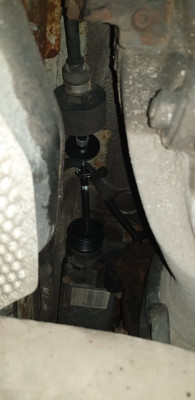

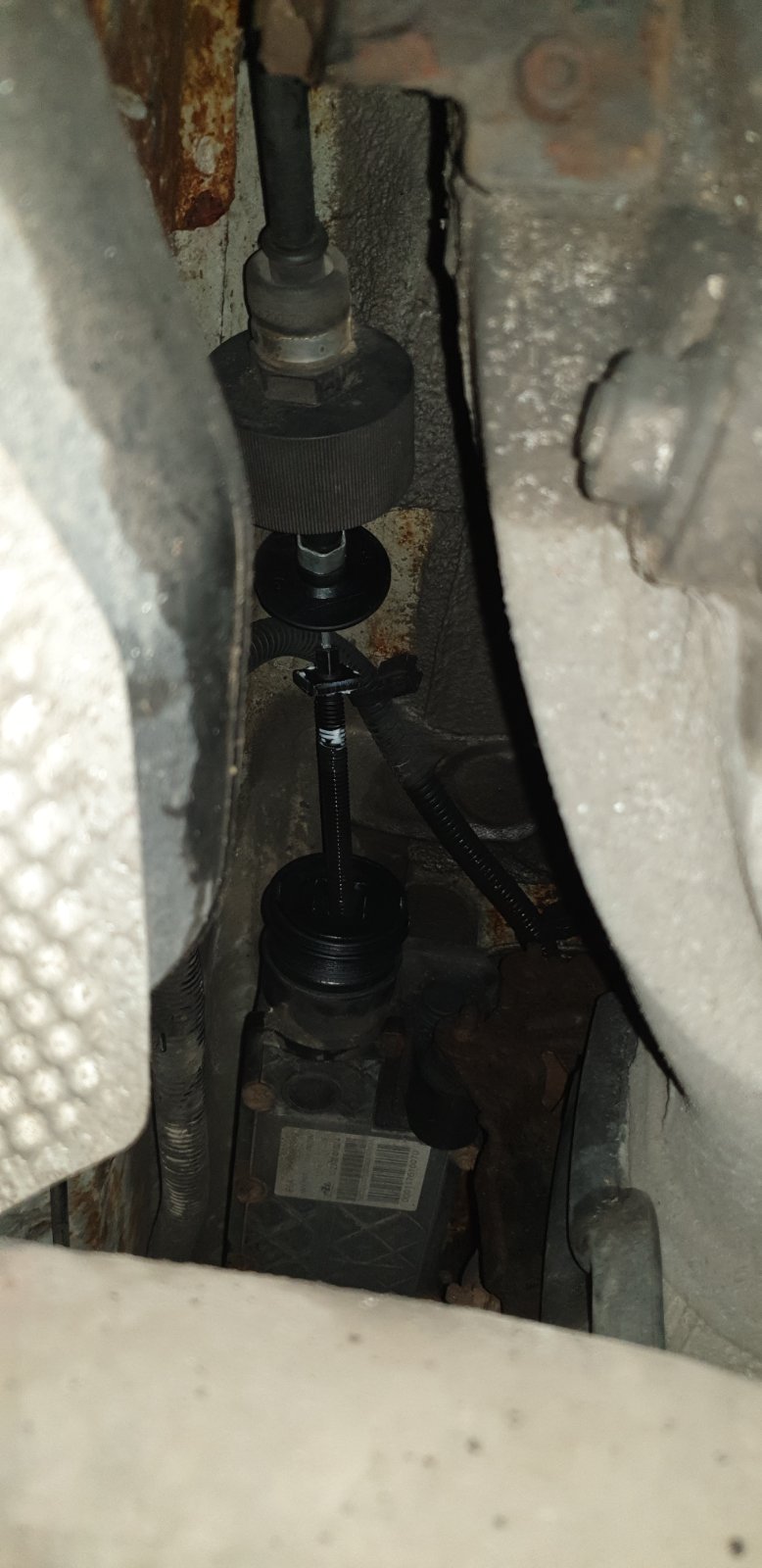

The parking brake motor is located in the open, easy to find in front of the rear axle.

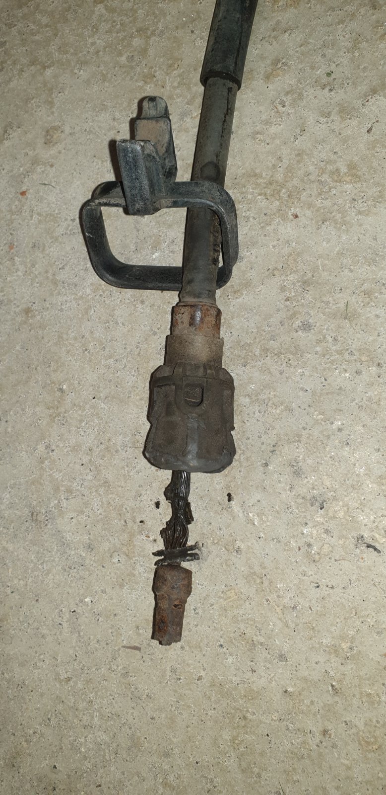

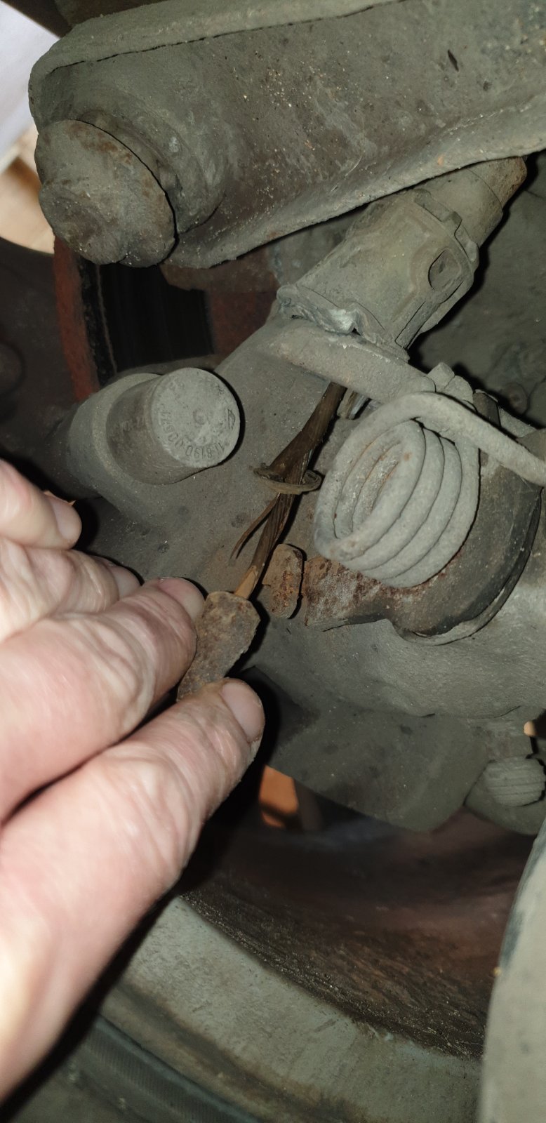

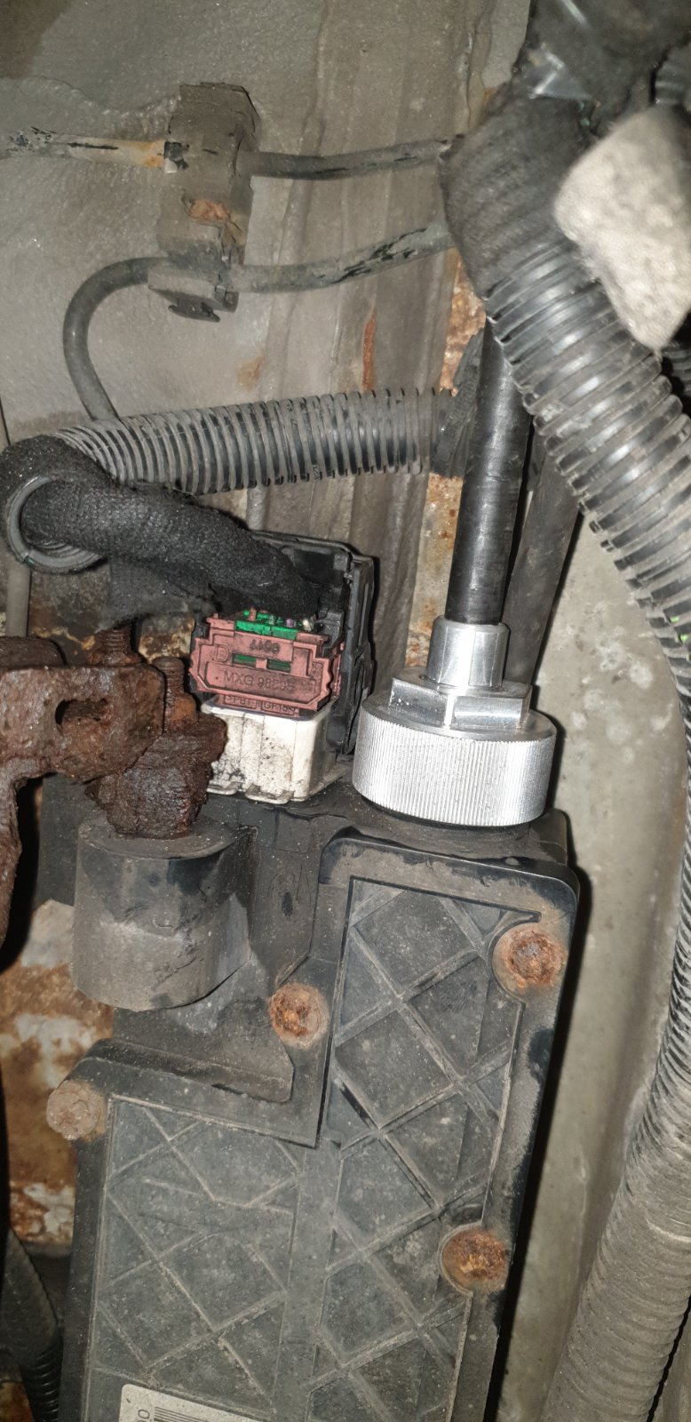

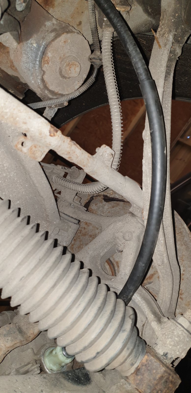

Located the end of the brake cable on each side.

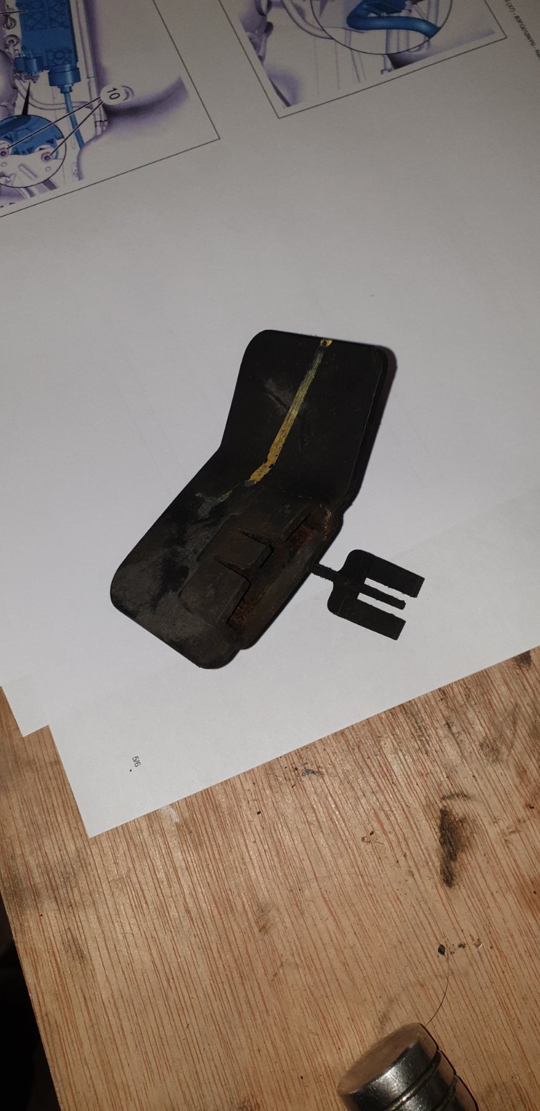

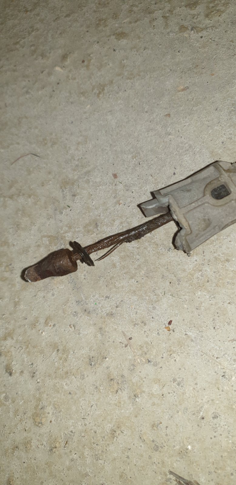

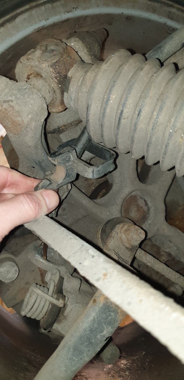

The plastic brackets broken both sides.

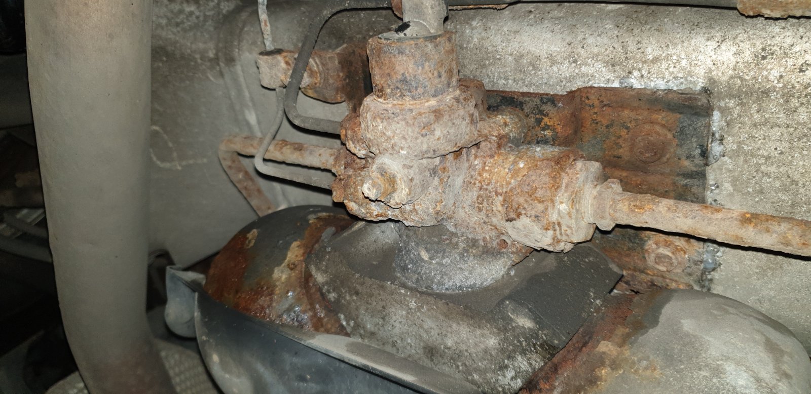

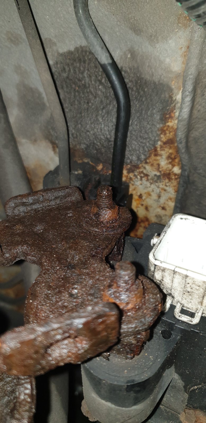

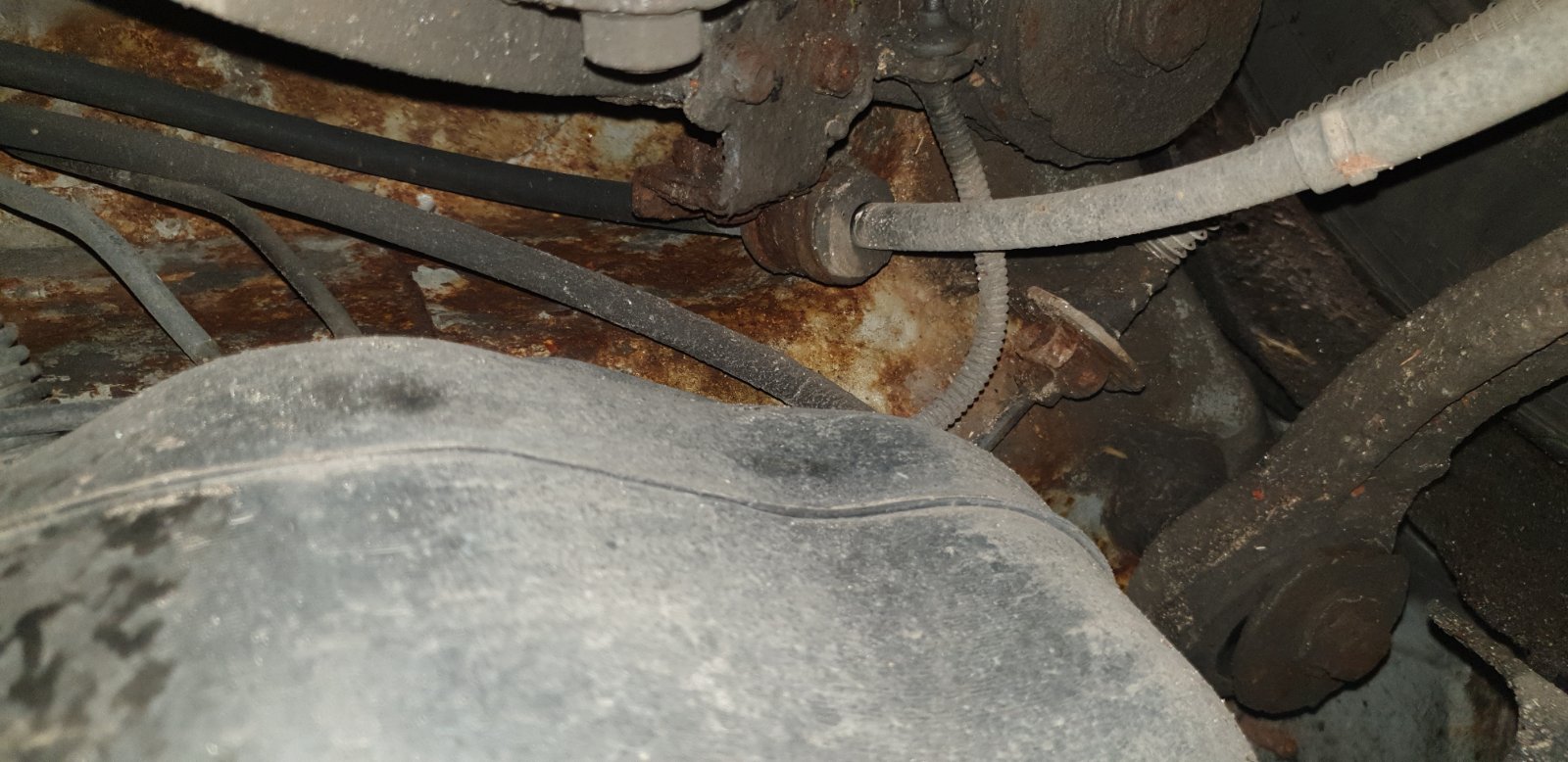

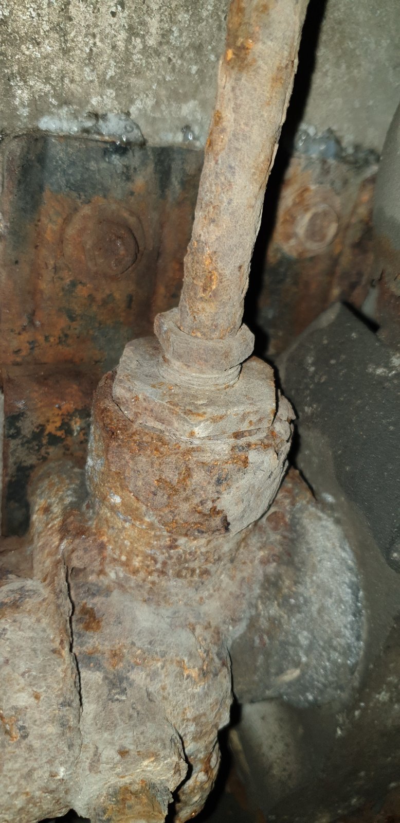

My goodness is it rusty in here - I'm interested in what others think... is this normal for a 15 year old car?

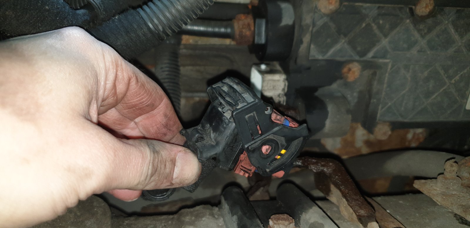

I removed the electrical connector bracket on the parking brake motor, it just pulls off.
Sprayed up the nuts with Plusgas... though part of me knew it was a waste of time seeing the rusty state of them!

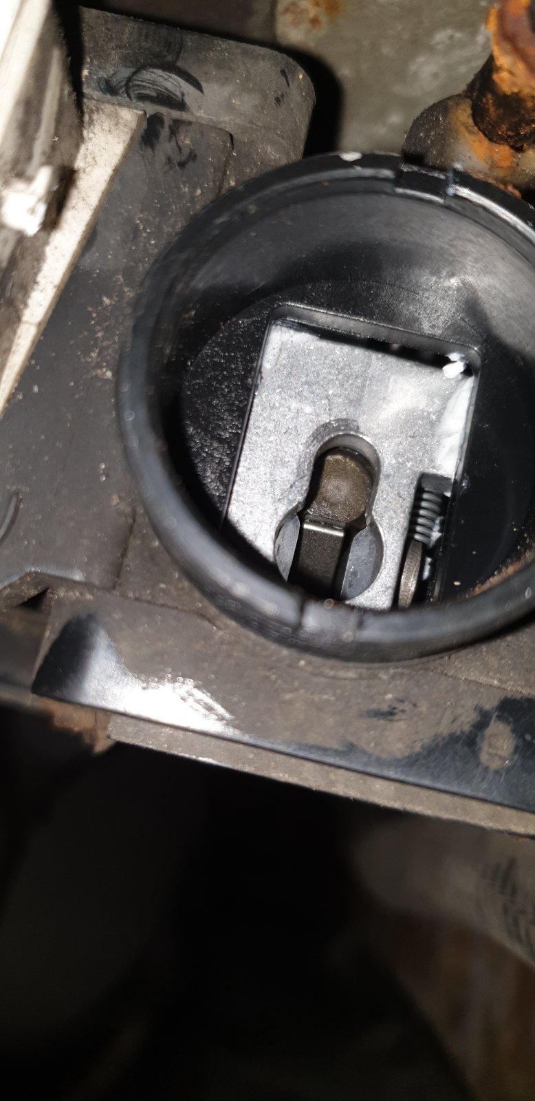

I popped off the plug, this has a rotating slide, and you need to push a button on the top (which you can't see!) to release it...

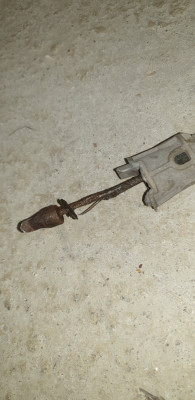

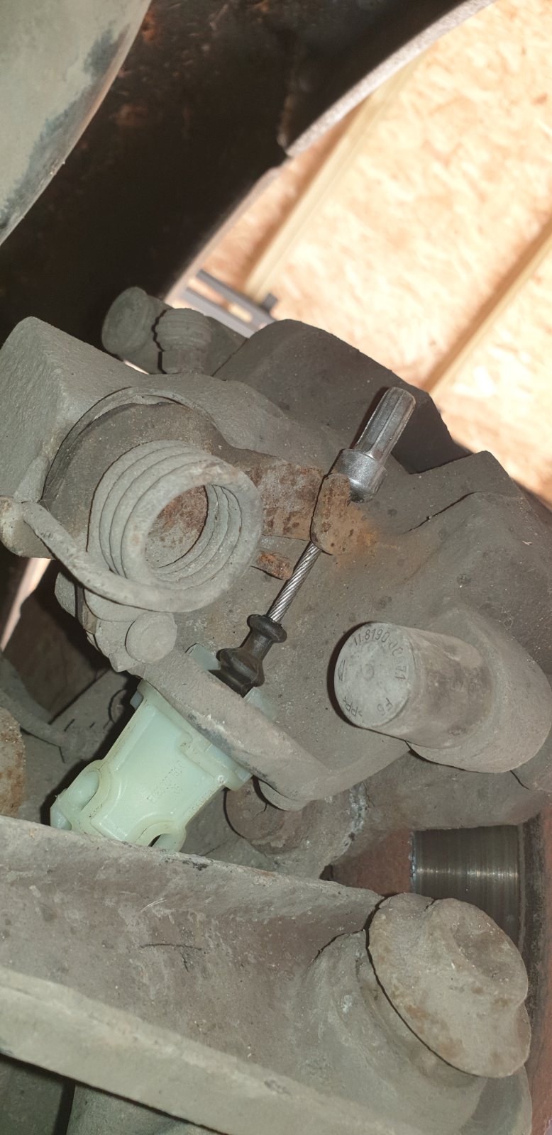

Took a look at the nuts... but with no effort they just crumbled and rounded off. They were crispy and made of rust!
So it was clear the brake motor was not coming off without a lot of destruction...

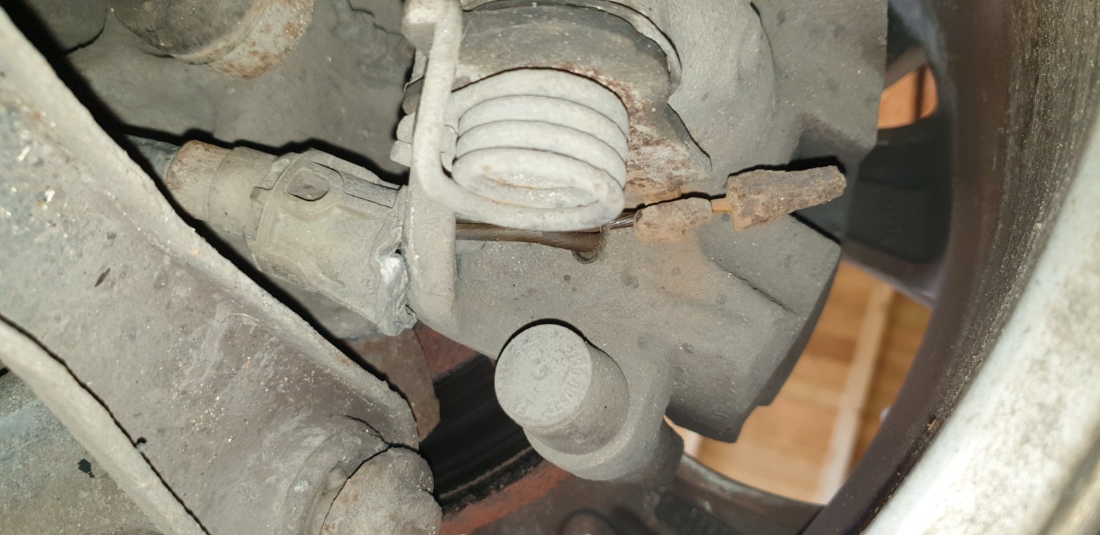

I decided to see if I could change the cables in situ..?

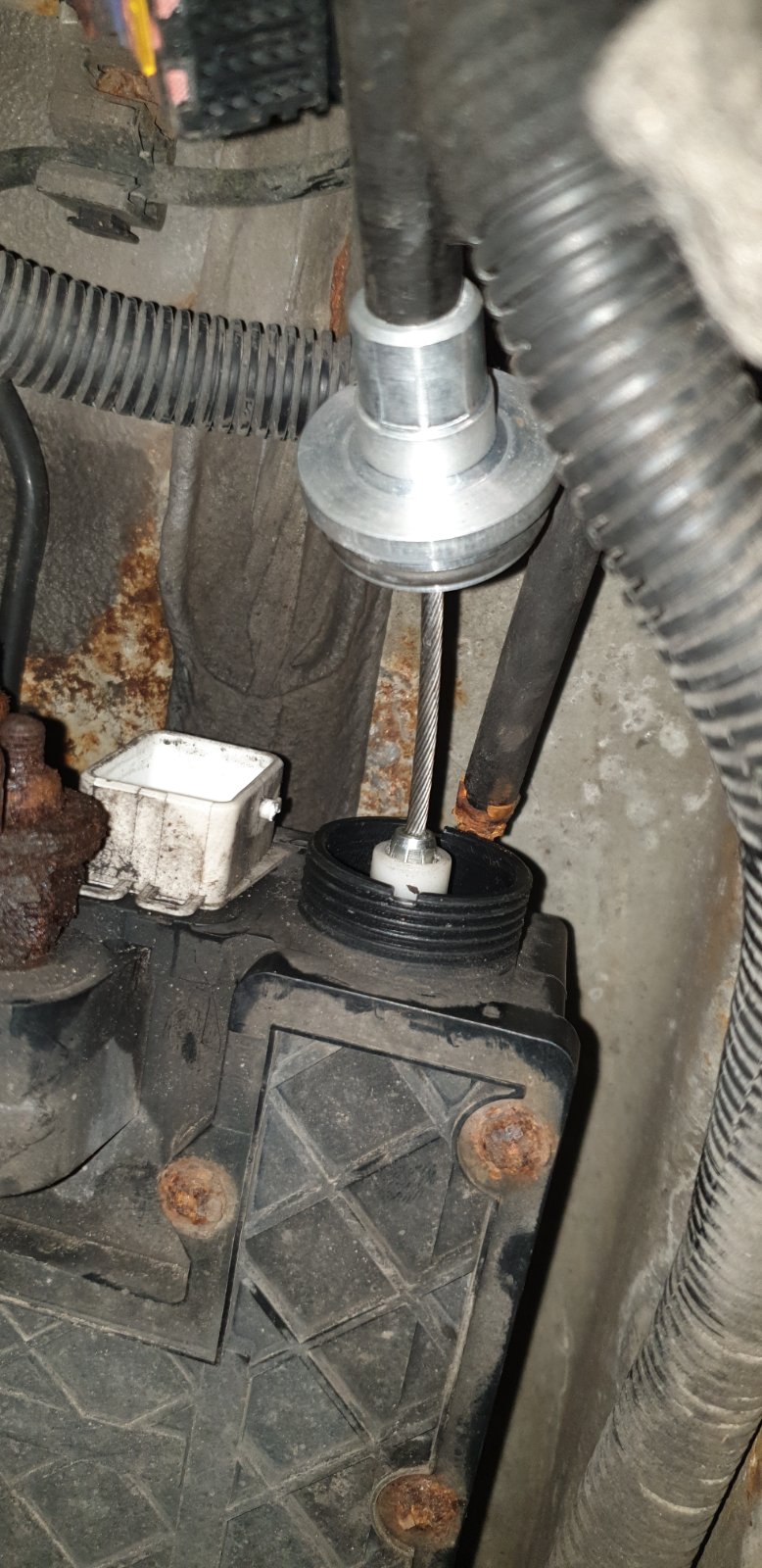

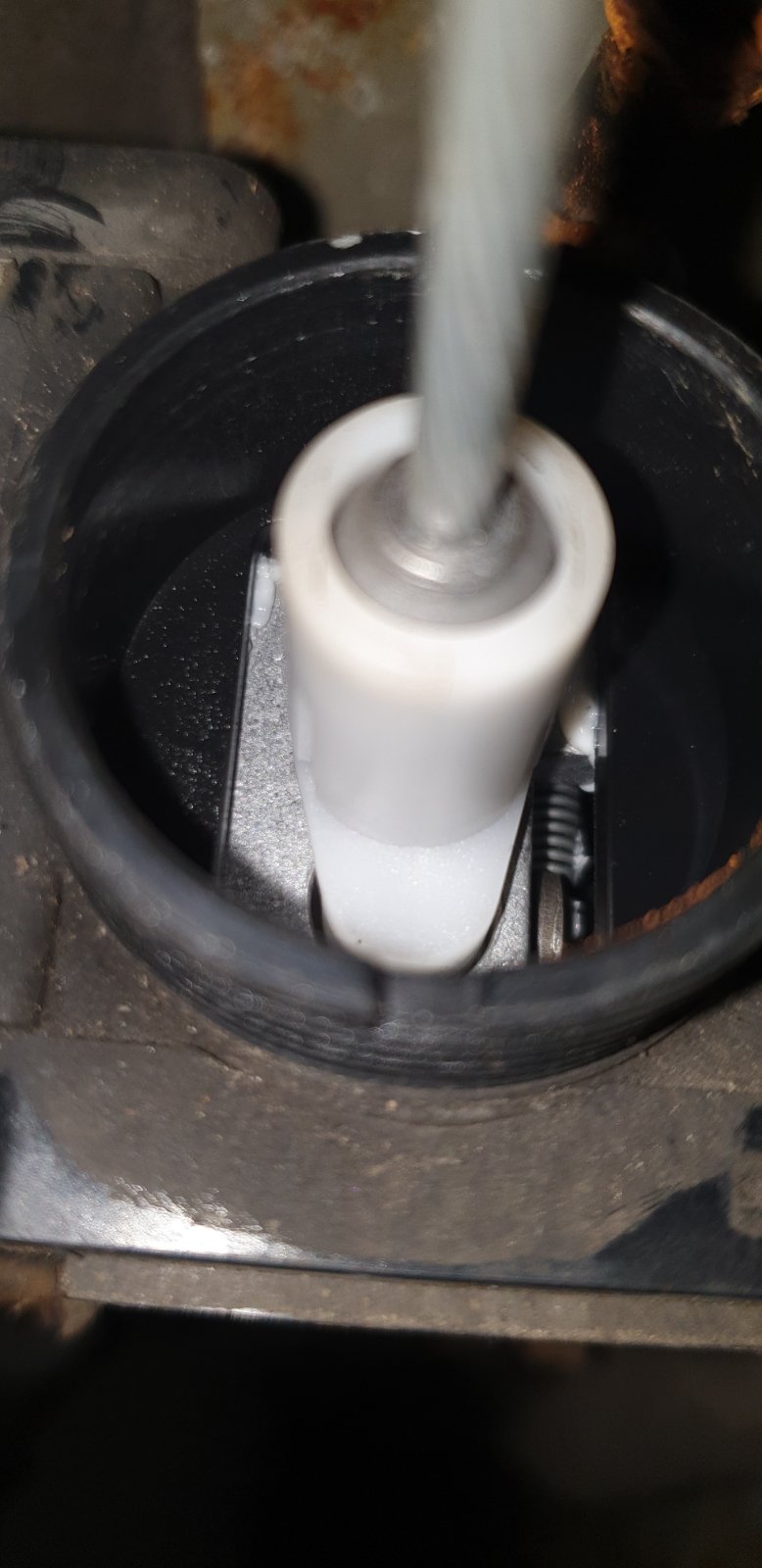

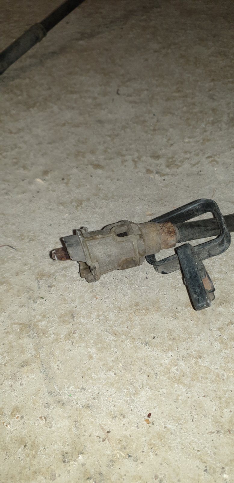

I unscrewed the plastic end caps, using mole grips to loosen them.
The shape of the plastic ends holds the catches in place within the parking brake assemble.
These can be unclipped by wriggling them, then slid back.
Then you slide the cable end down, and it pops out.
Leaving the open end, where one can pop in the new cable end

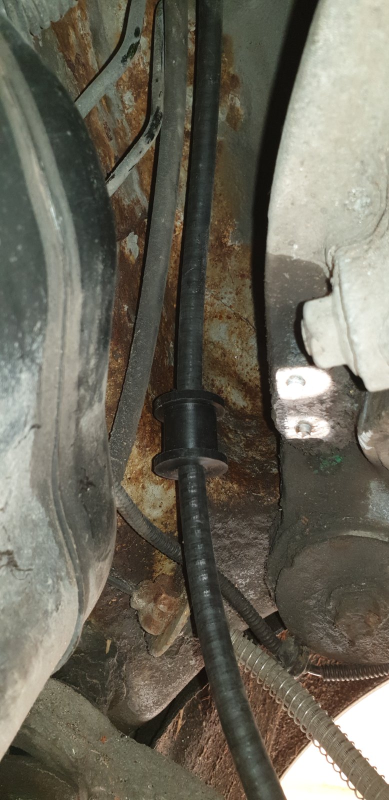

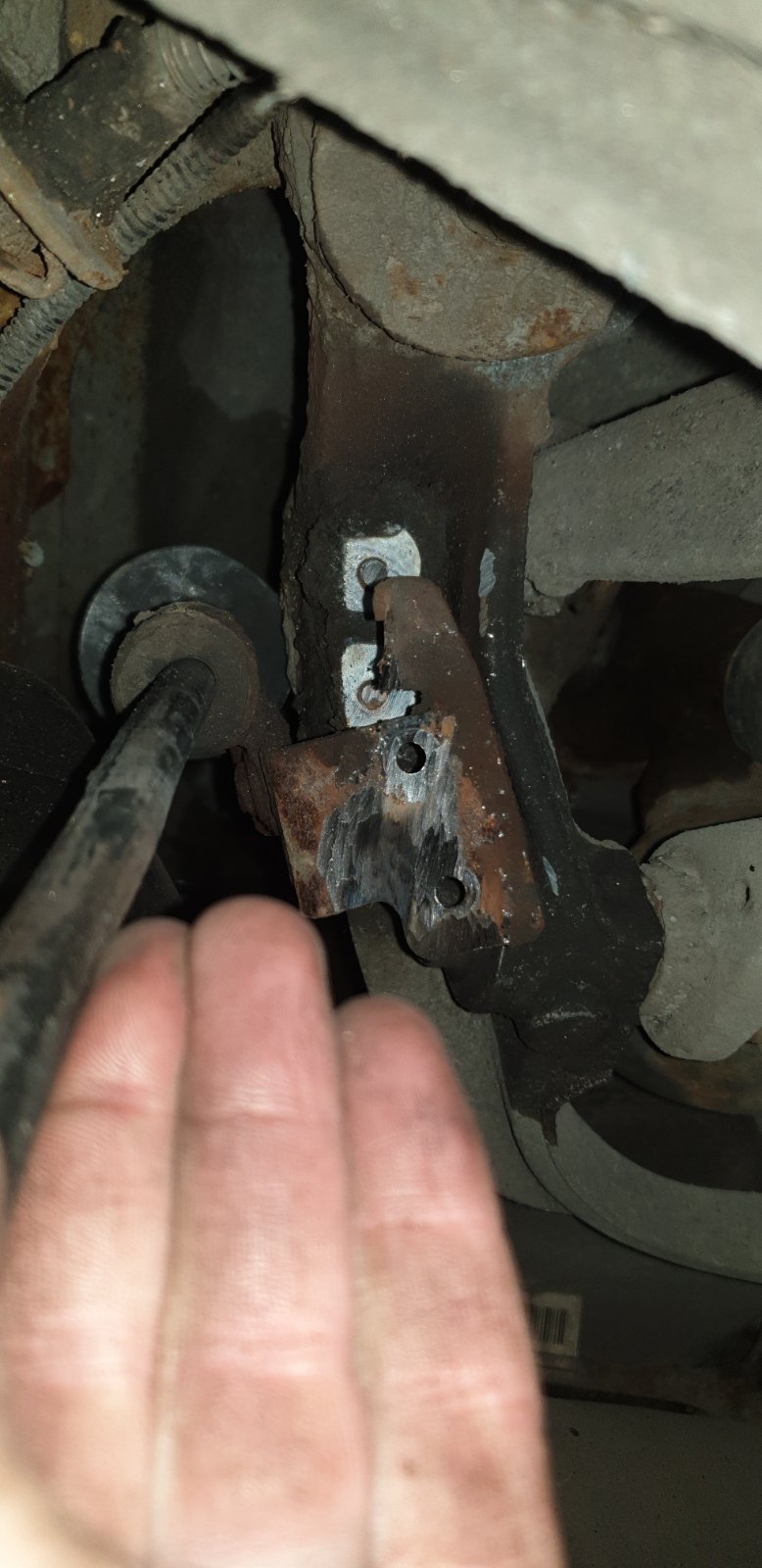

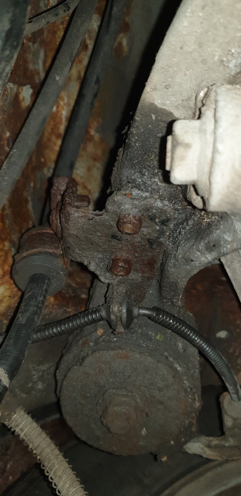

My next issue is the brackets holding the mid section of the cables...
The bolt heads were completely crispy, and round, no tool could remove them sadly.
So of course I used the grinder on the bolts...
New cable fitted by sliding into the groove in the motor assembly, then clipping in the plastic bit.
Then I fitted the ends caps, which are aluminium on the new cables. I also popped the electrical connector back in.
Then clipped in and fitted the end.
...and thats the right hand side done... though there is no longer a bracket to hold the middle still. I'm not sure how I'm solving this riddle...
After releasing the plastic end cap, the left side cable on the other end just pulls out.
Another crispy set of bracket bolts...
Out comes the grinder again.
Wow those ends were pretty awful...
Slid the new cable in.
Secures the new cable at the left wheel.
So that both new cables in... phew!
I reconnected the battery... then...
Back in Dogbox... I do a Parking brake calibration... and hear some whirring. But though the calibration is successful, the brake cables do not work!
The cable ends don't even move...
Select "Repair".
Then "Pack repair".
At this point I have ran out of time, as we are due at a Halloween party for Aston and Spencer...
So I have a non-working handbrake for now
I suspect the left side cable end hasn't threaded into the parking brake motor, and I'm hoping I can force it in by pushing the right side in to release the left cable end, then rotating the left end to thread it in...

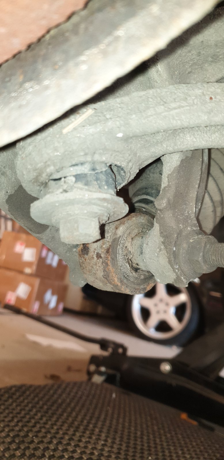

So while I was poking about at the rear wheels, I thought the rear bushes looked a bit odd...
The right hand side.
Does anyone know is it normal for the arms to sit at that funny angle at the connection?
I'm wondering if replacing a few more bushes might be a good idea, as I notice on very rough roads there are still some "knocks" that don't sound right to me.

Not very surprised those Allen head rusty stumps didn't co-operate! C5 do seem to get pretty rusty down below, normally seems to be "visually horrible" rather than "structurally deficient" end of the scale other than, as you've found, sometimes for fixings which often seem to have too little of the head left to unscrew easily.
I thought mine was pretty rusty, but from other's photos - particularly Jaybruce's C5, I might be on the better end of the scale surprisingly.
I'd wire brush, phosphoric acid (or Kurust or similar treatment products) then slap on some brush paint to anything I get near really. (But generally can't help myself in that regard. I have greased a jubilee clip in the past, just "have to fix stuff" when I encounter it!)
Mine is black so I use cheap "gloss black metal paint" from builders merchant. Don't worry about the colour match on the underside, just try and protect it.
Suspension bush does not look right to me, will try and get a photo to compare when I get chance (note likely Sunday at earliest)

Sorry Matt - I should have mentioned I have the procedure for the change of the handbrake module. But Citroen assume you change the whole thing, not just the cable, hence that's the bit I'm a bit unsure of.
I think I know whats wrong though, and these videos of a similar unit helped me to understand how the handbrake motor assemvly works.
