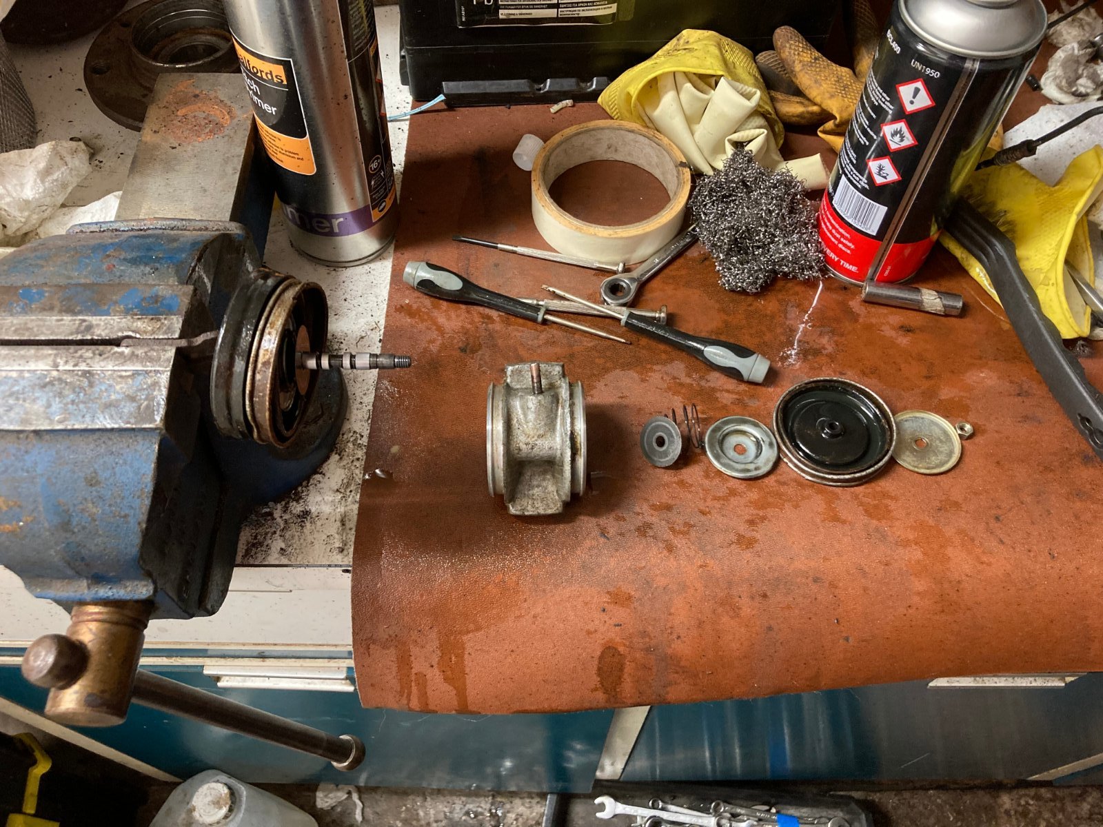

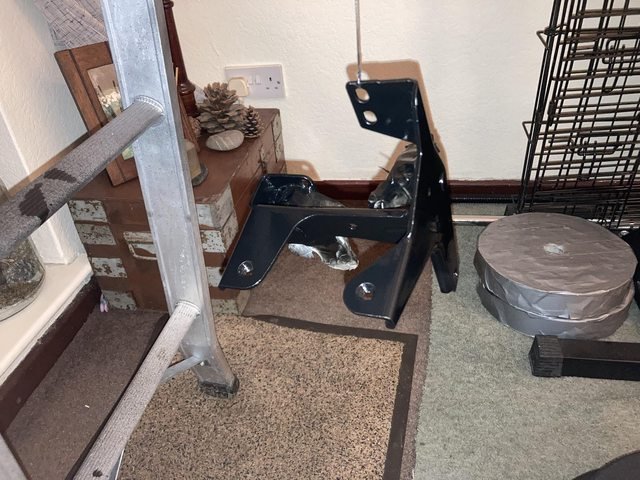

My bad guys I meant to say id finished the height corrector but was wondering if anyone had a guide for the controll block
but thanks anyway.

Re: xantia rescue

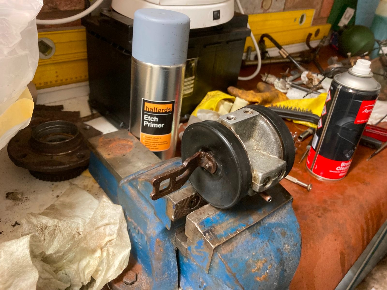

I was gonna save them for later but heres a couple of pics of how it got on

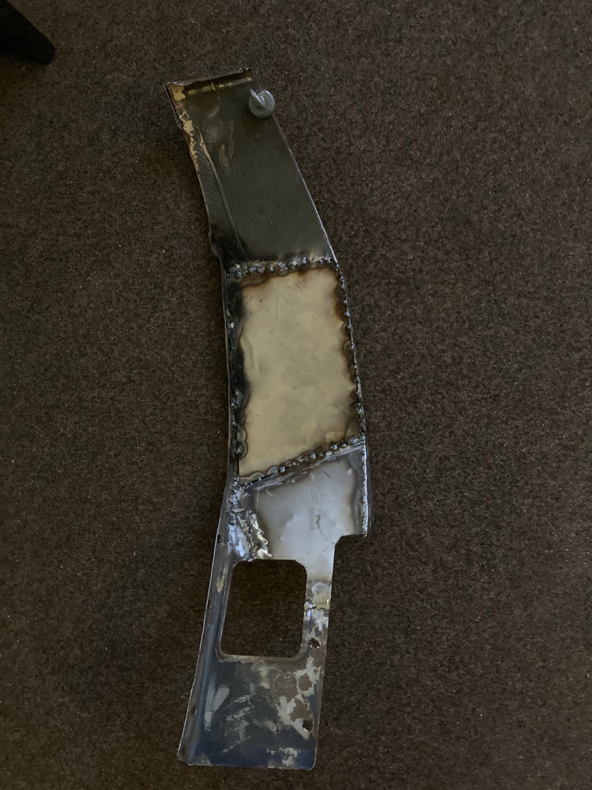

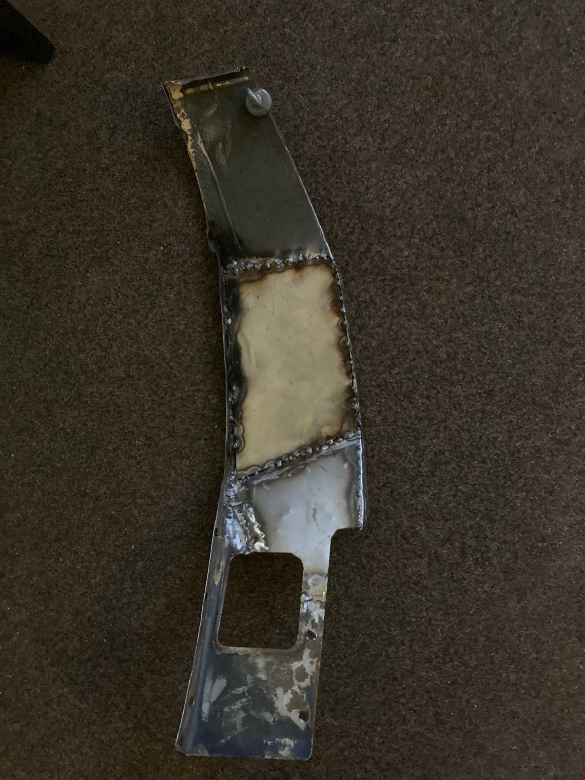

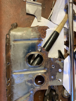

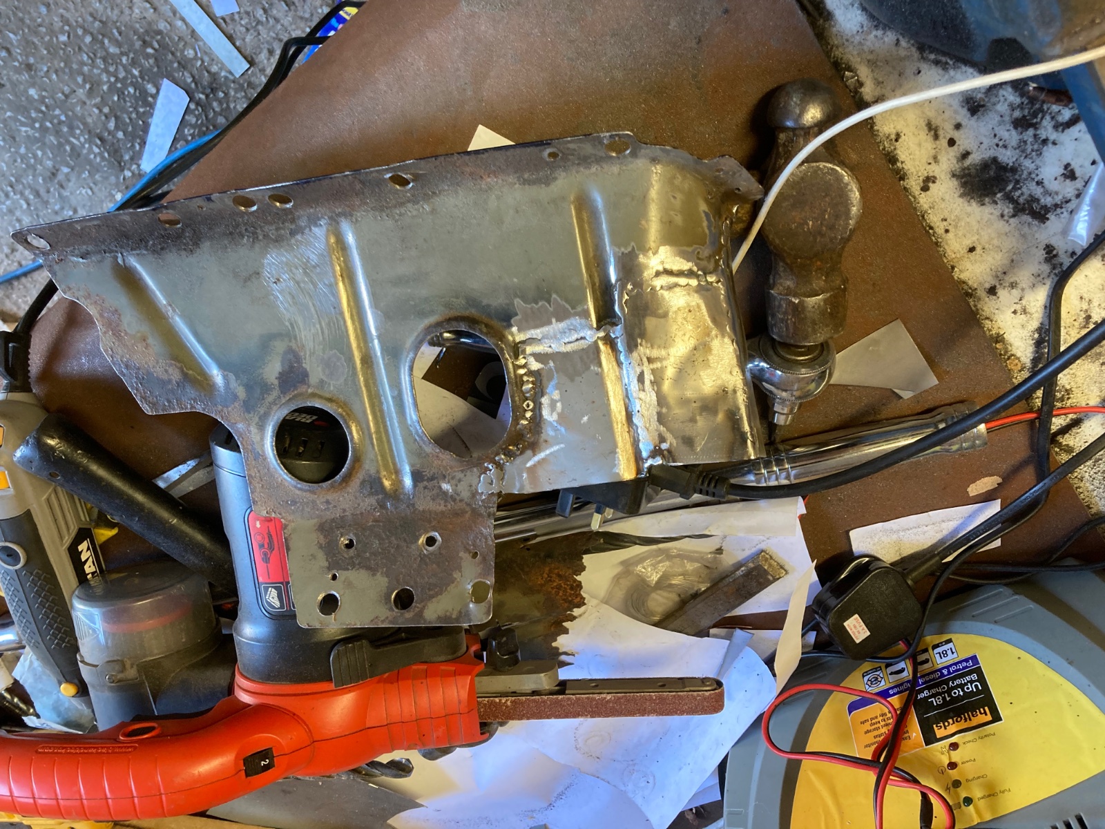

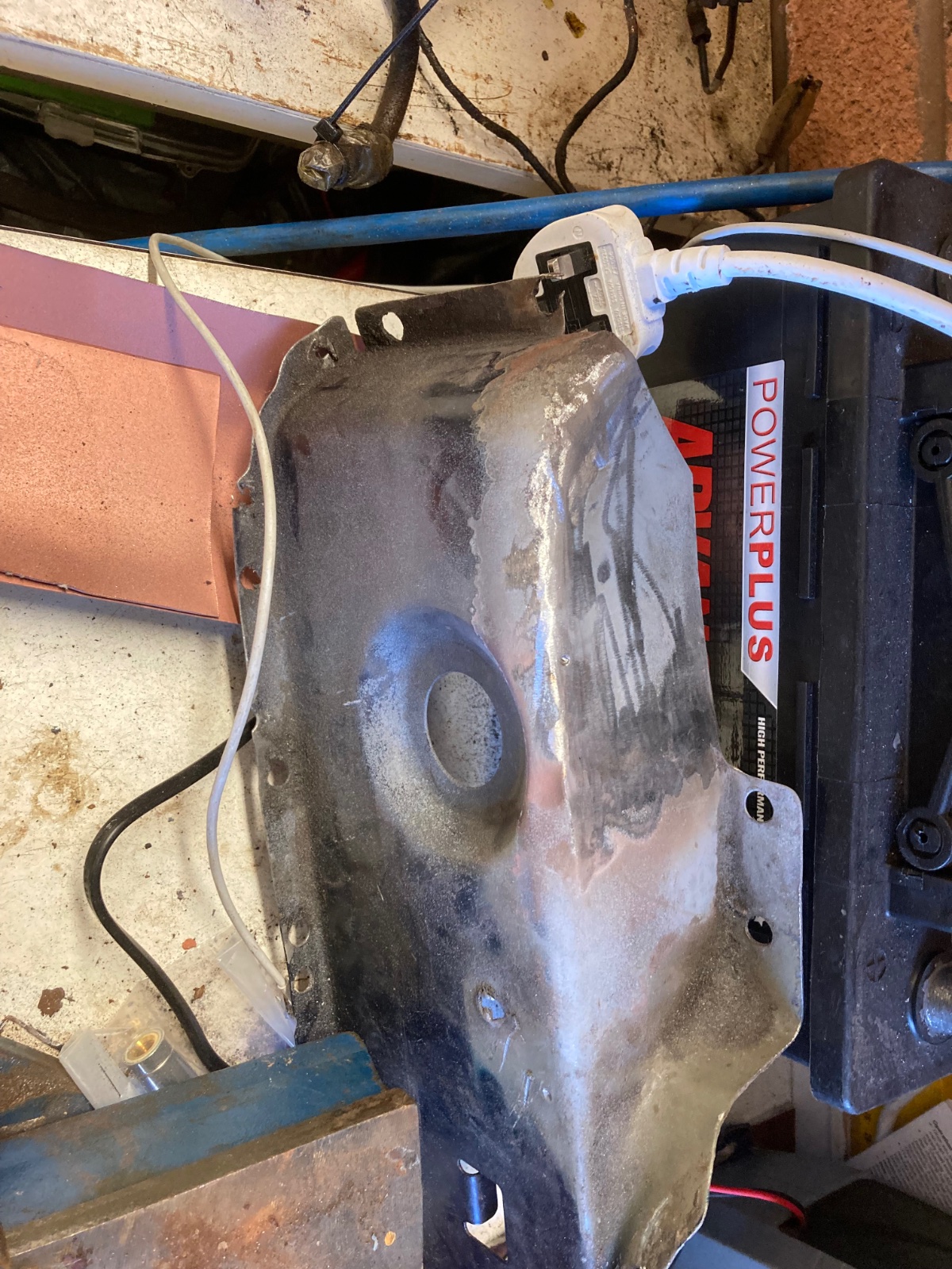

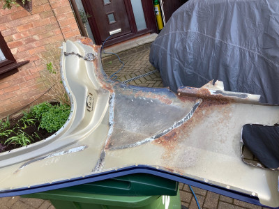

hey everyone i hope your all doing well,sorry for the long time not posting i said id post when i next made big progress but i just kept pushing back my goalpost,but i think you might like the work anyway even if its not all been complete.
the main target ive set has been plugging some of these rust holes that make it qualified to be called a sive and taking of the underseal
ive bought myself a welder and have been learning to weld as i go along ive welded in a few peices the progress is coming along even if it is not doing so quickly
i will be back again soon for another update as well. i hope you have enjoyed it, thanks Scott

Good to see you're persevering with this Scott - I'm not a welder although I did attempt some 20 years ago, yours looks a pretty good effort for a beginner

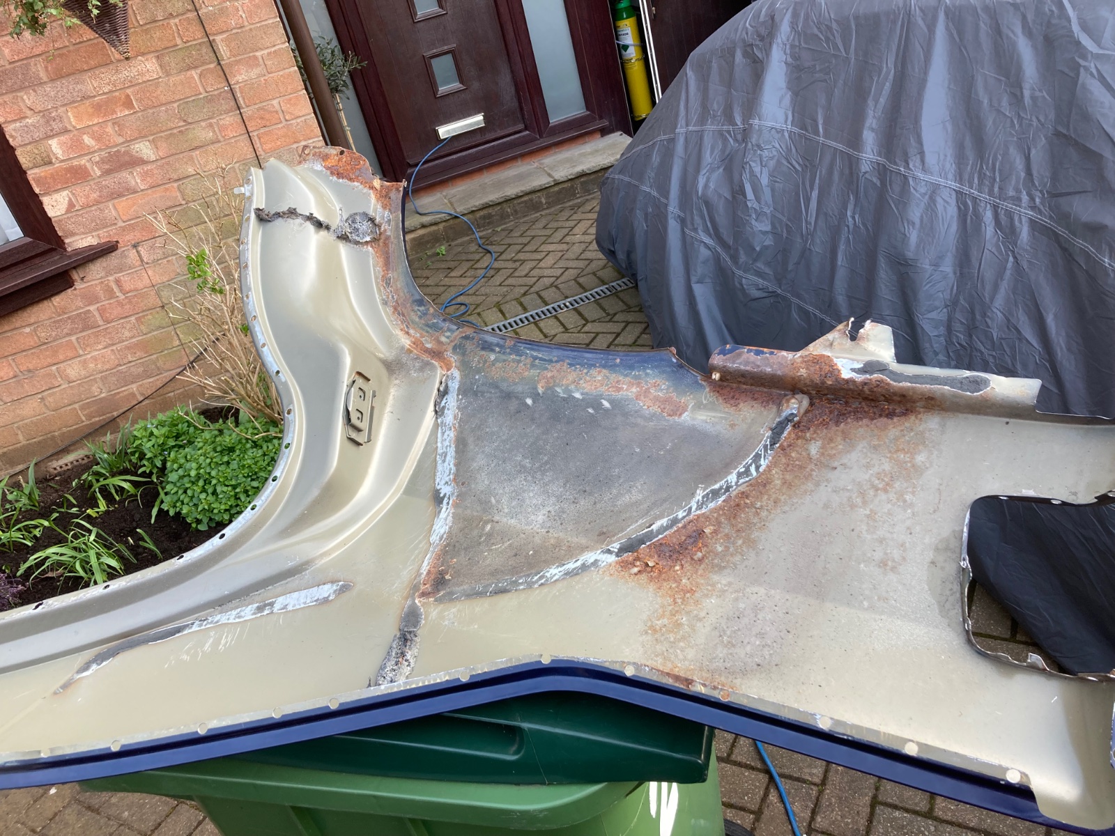

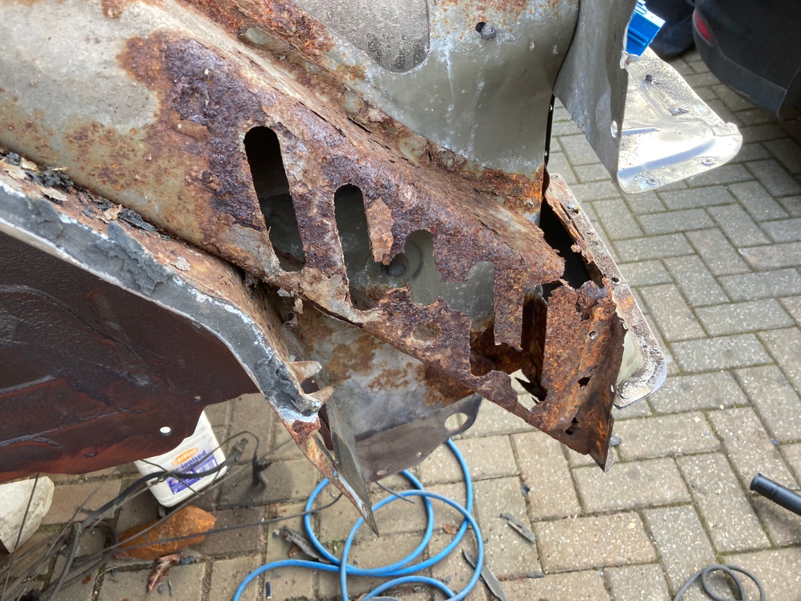

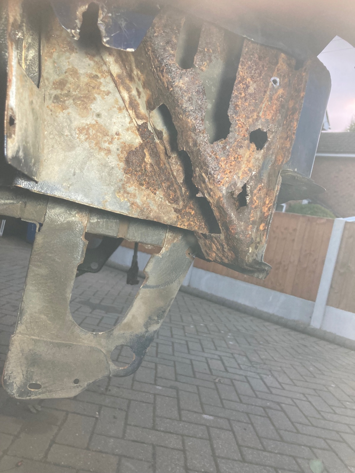

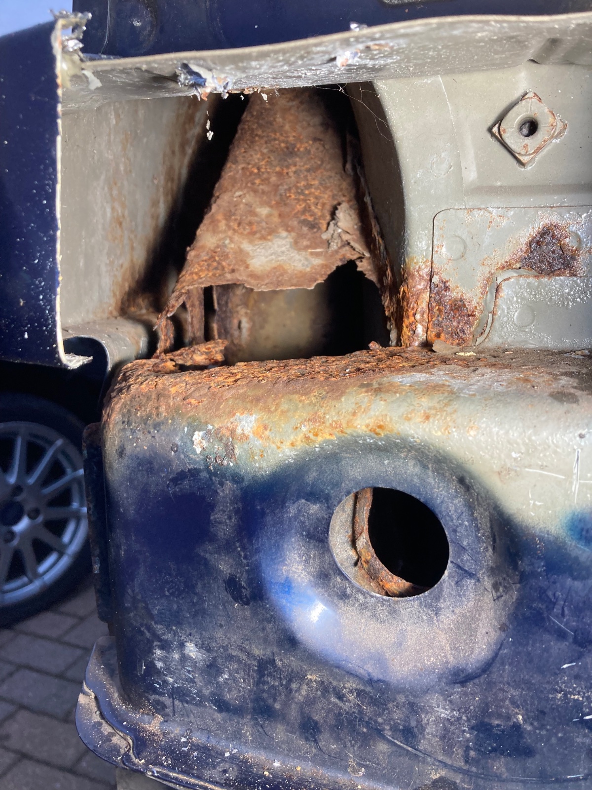

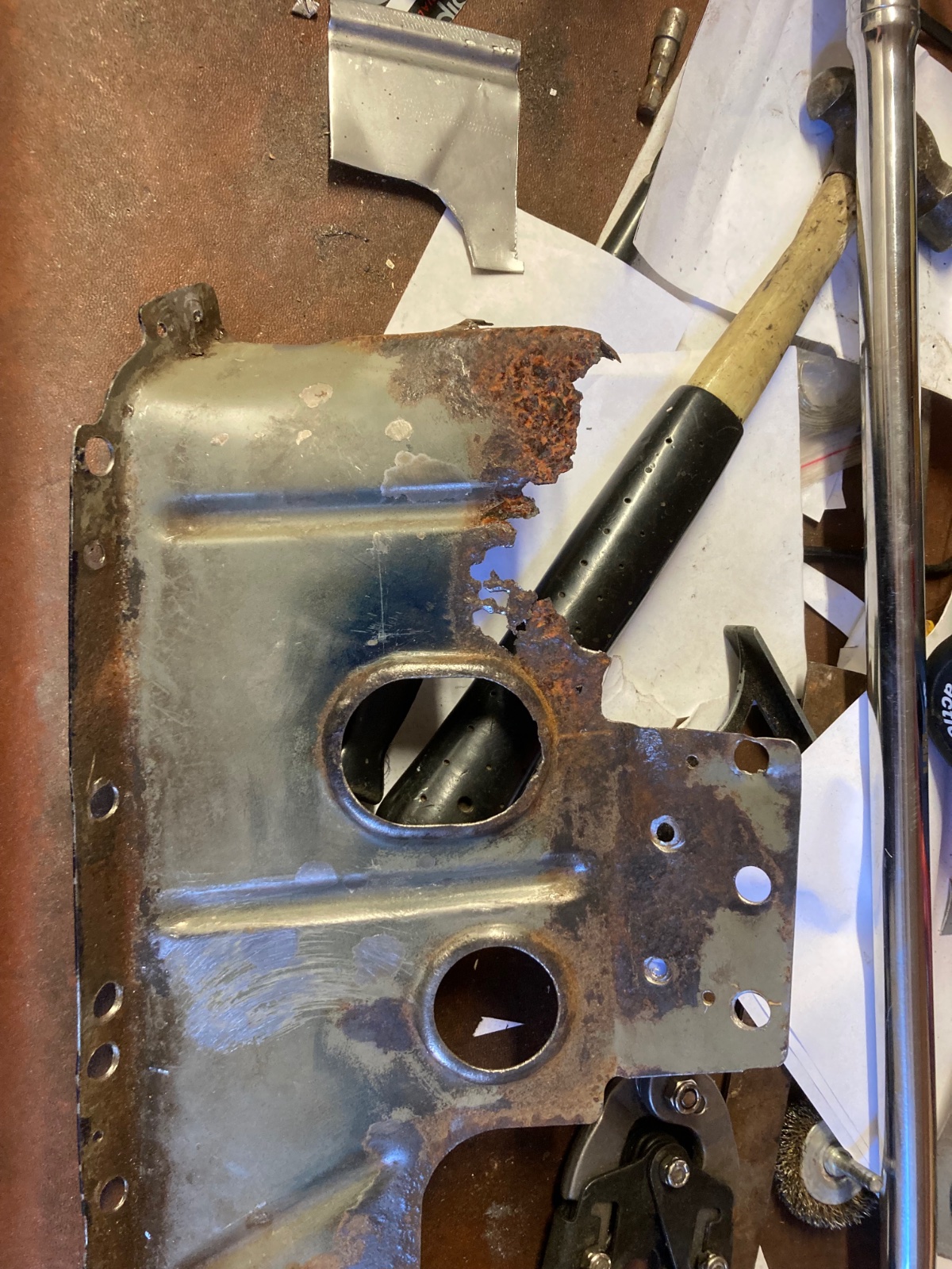

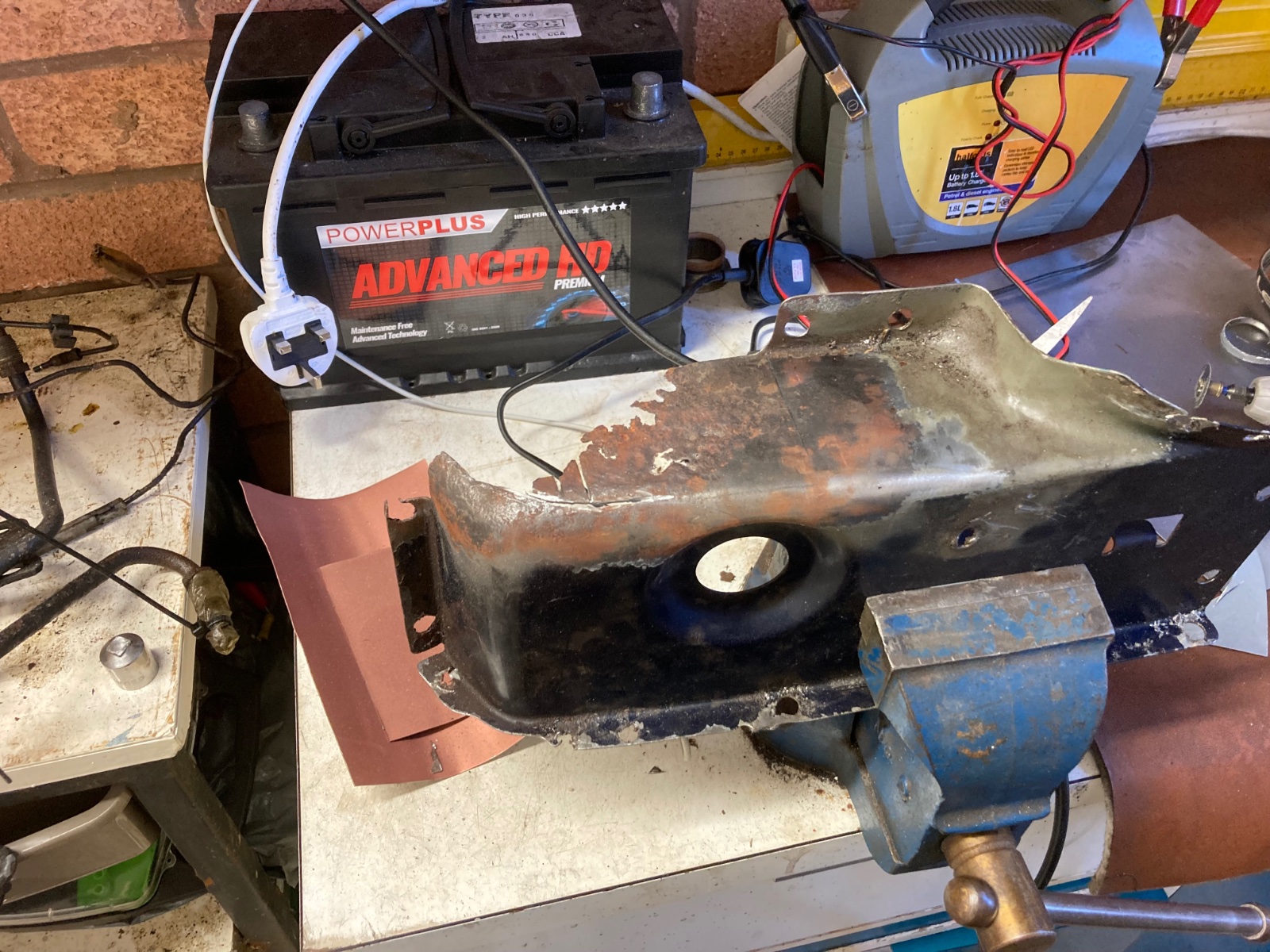

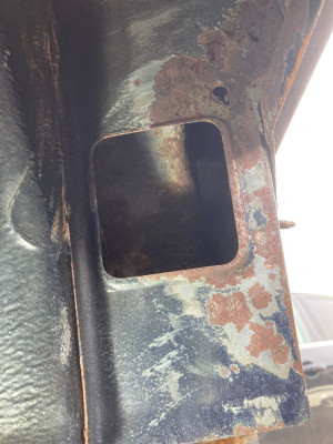

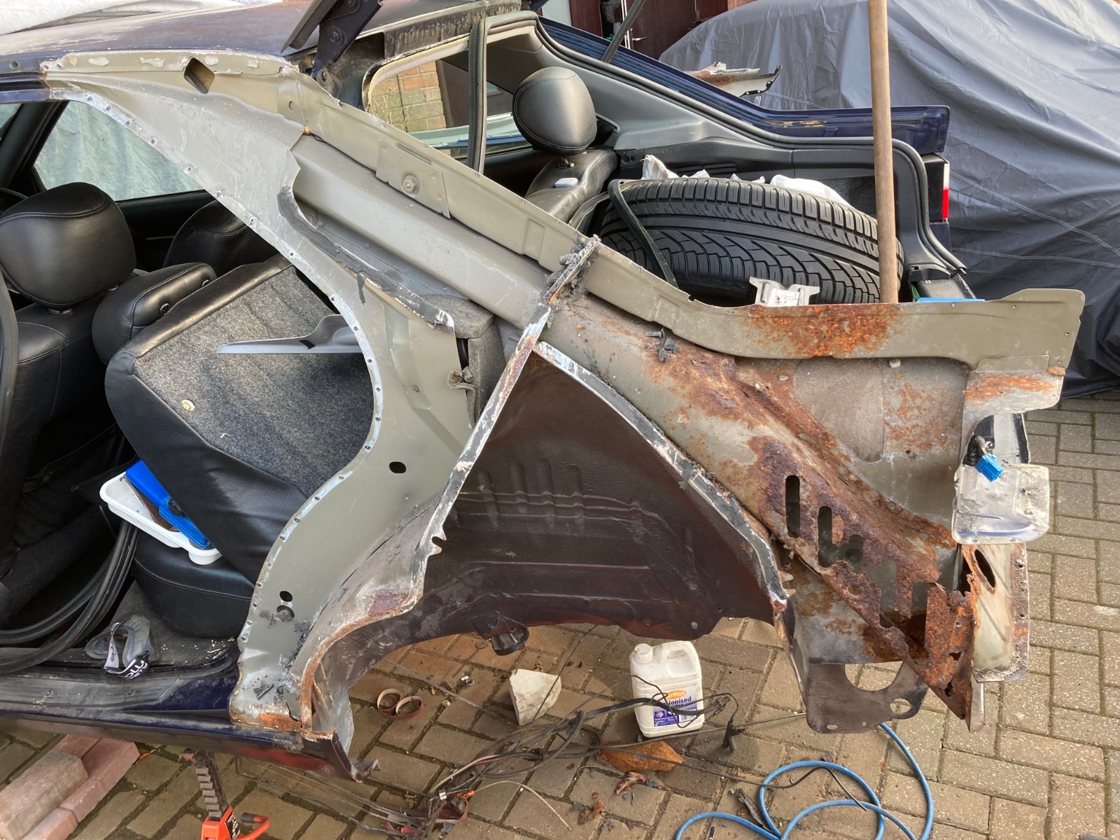

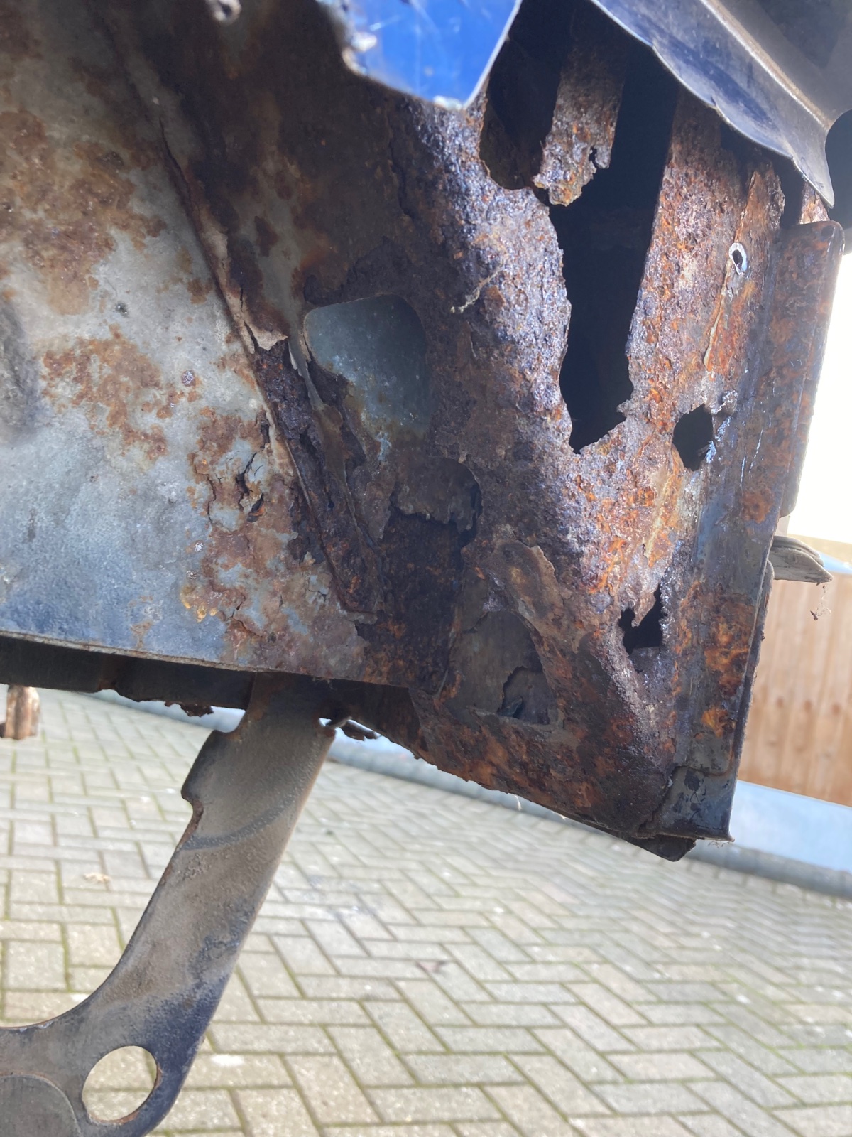

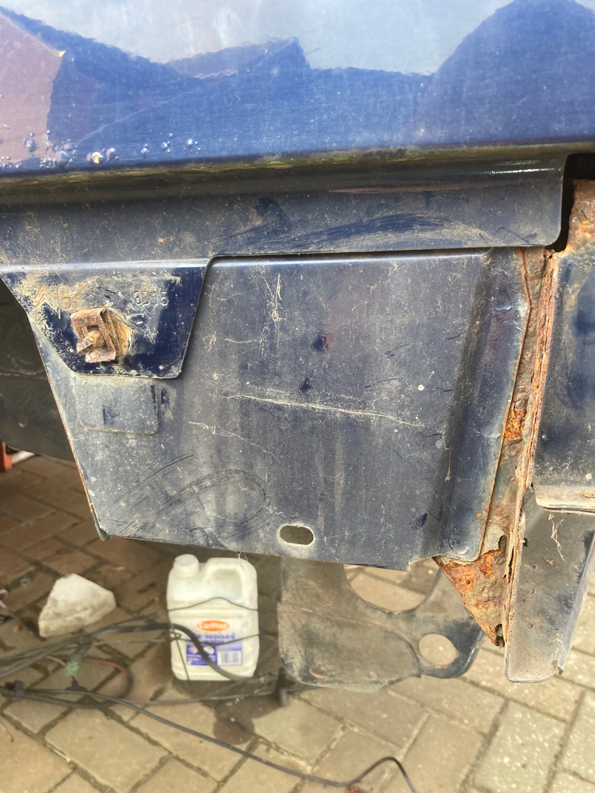

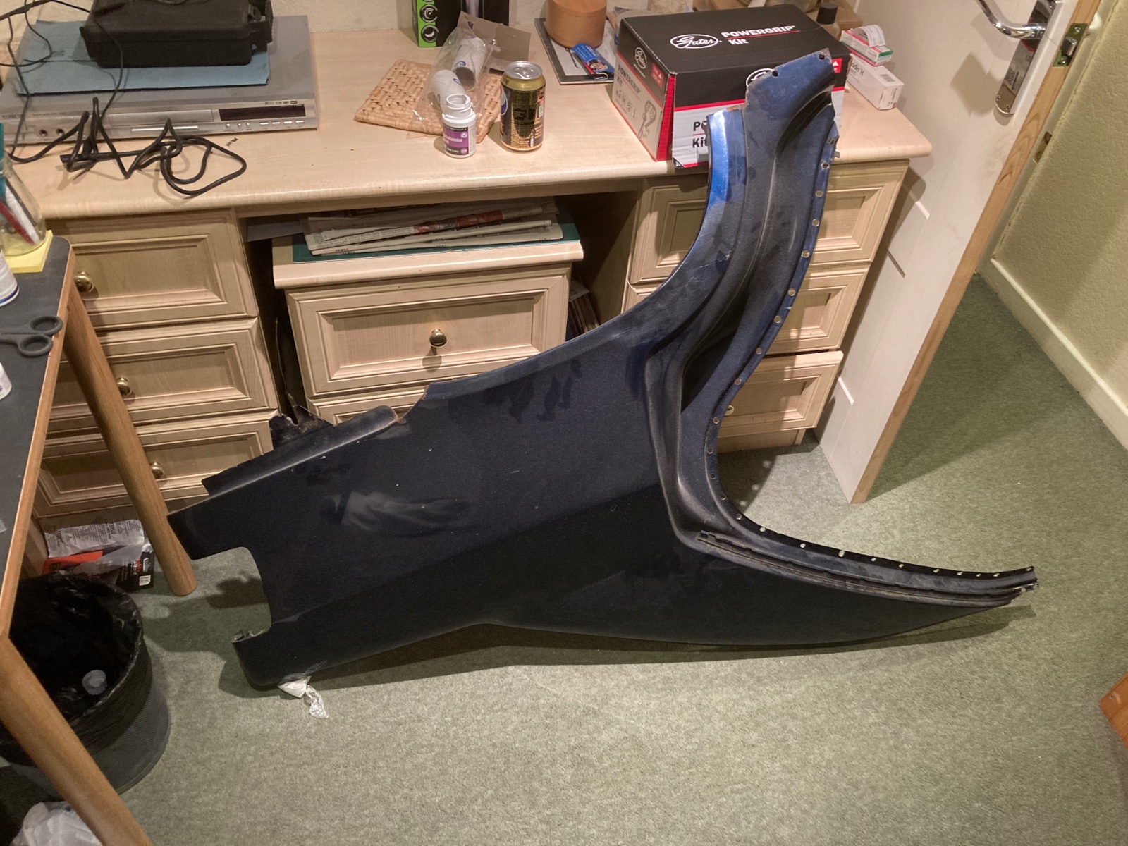

hey everyone thank you for all the kind words of support, ive been reading tham all and i really appriciate them, im sorry everyone for not uploading for a really long time i kept telling myself i would upload a update when i felt i had made some real progress but every small step forward i never thought was enough but now looking in hindsight i have still done a fair bit of work and learnt a lot of skills in the processes
to start i finished off the sill work as from my last post so i moved on to looking at the rust behind the wheel arch(gulp
) i was in for a suprire, i took of the bumper and decided i would go from there tjis is what i saw

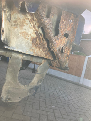

the result was worse than i had expected, so if i wanted to tackle the structural issue i was going to have to take off the wing the wing is not like the front where you are able to unbolt it it is welded on so i had to drill out about 60-70 ish welds until i got this one wing that now currently lives in my room and is a great toe stubbing device when walking in the dark at 2 in the morning

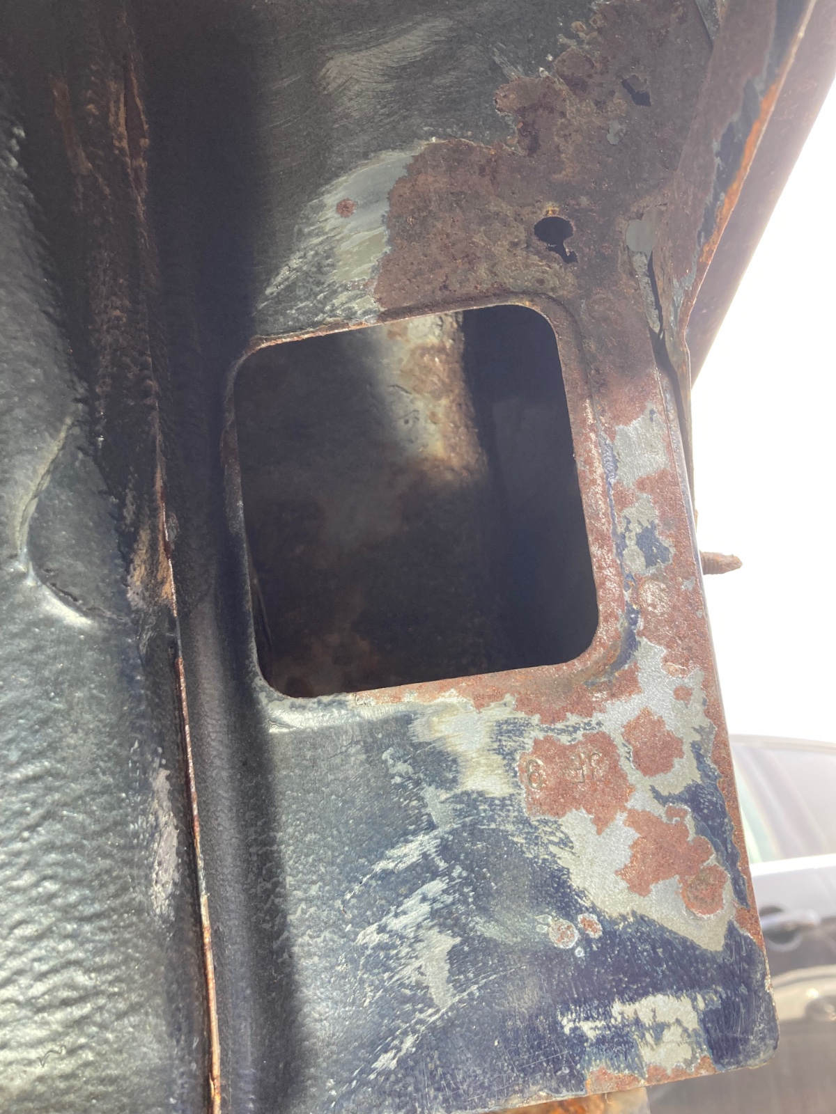

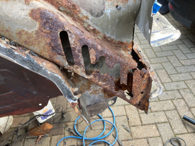

from here that gave me a great picture to see where i was at ( ironically i didnt take a picture of the car at this point) all of the individual structural parts of the rear chassis where completely rusty so i drilled them all out individually and began on restoring them with some sheet metal and my
welder

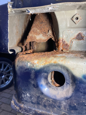

and from there i got to the main structural point of the chassis leg

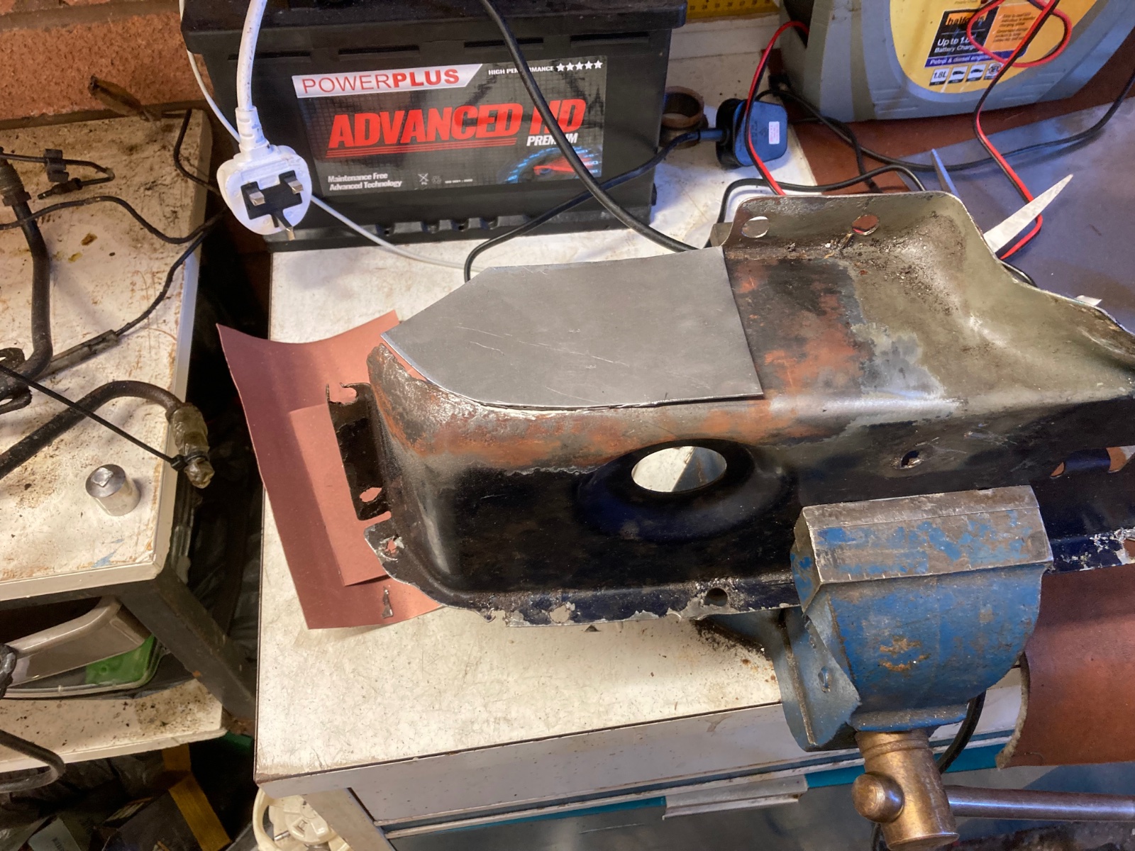

this large rectangular tube section which was completely rusty so that is the present point i am on is using a buck to recreate the shape of the tube to put in new steel .
thank you everyone who has read this and for the patience for me taking so long to upload, Scott
